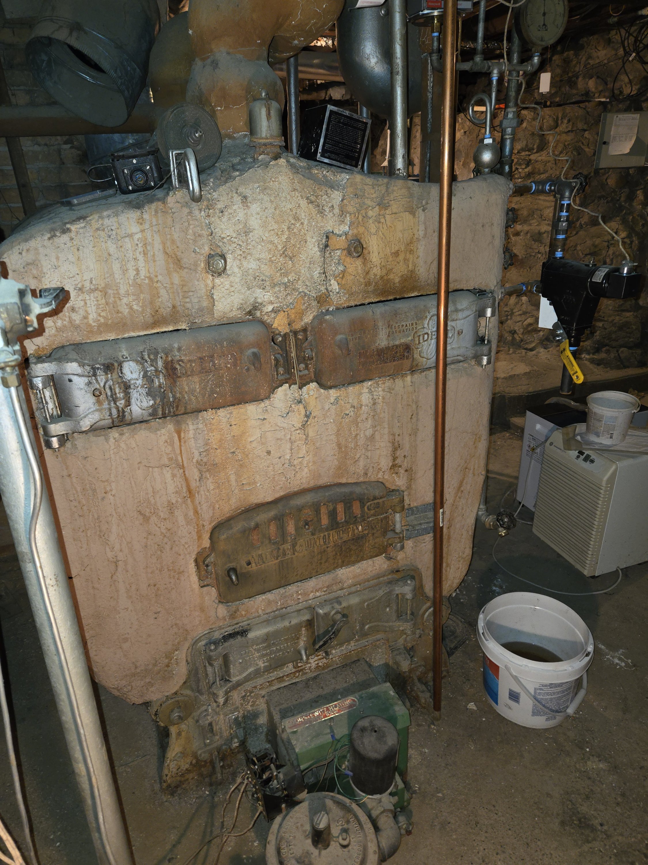

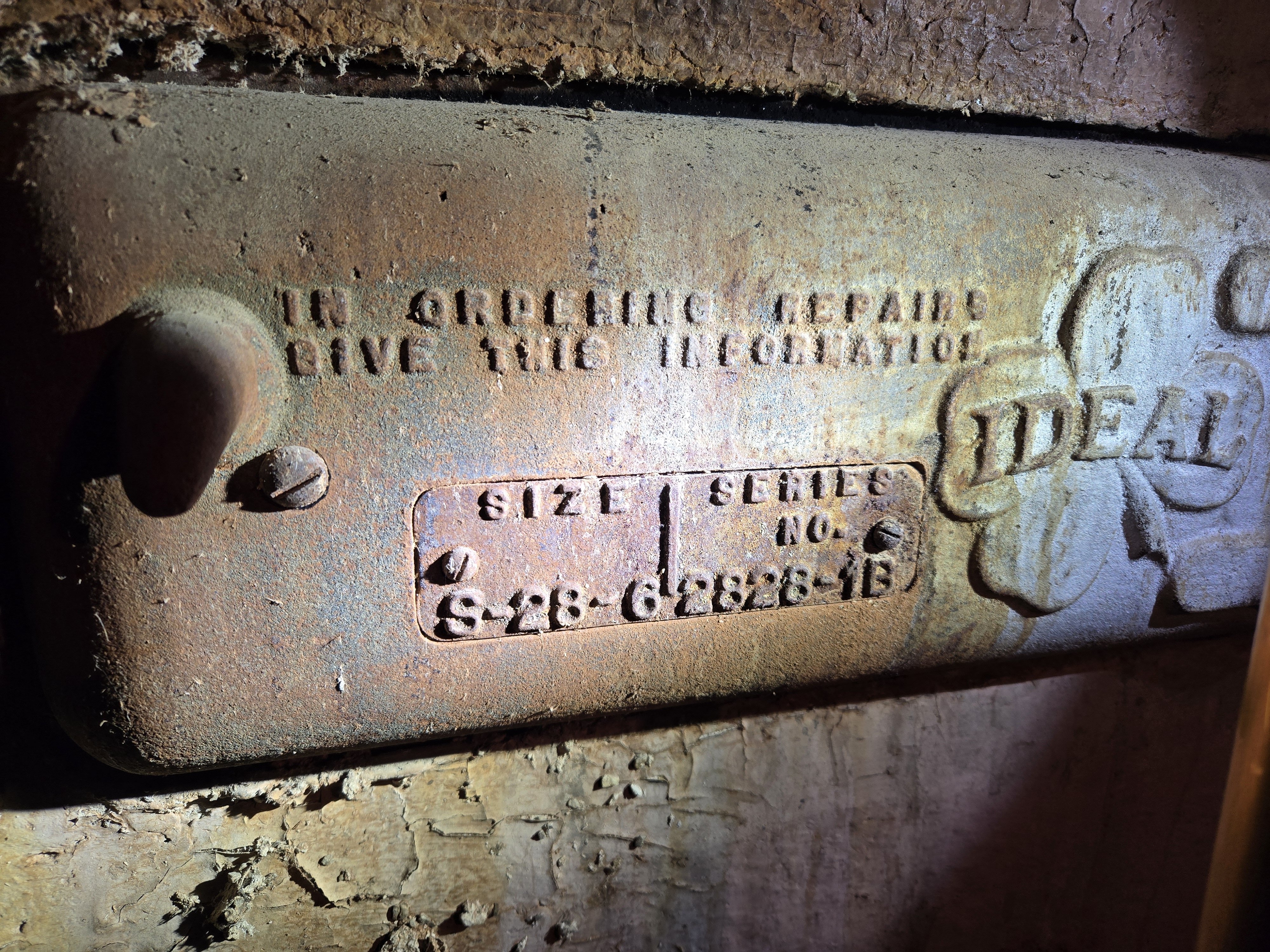

I live in a house built in 1880's. The boiler is original to the home and worked perfectly until last week. I'm having a heck of a time trying to find someone to work on it. I don't even know if parts are available.

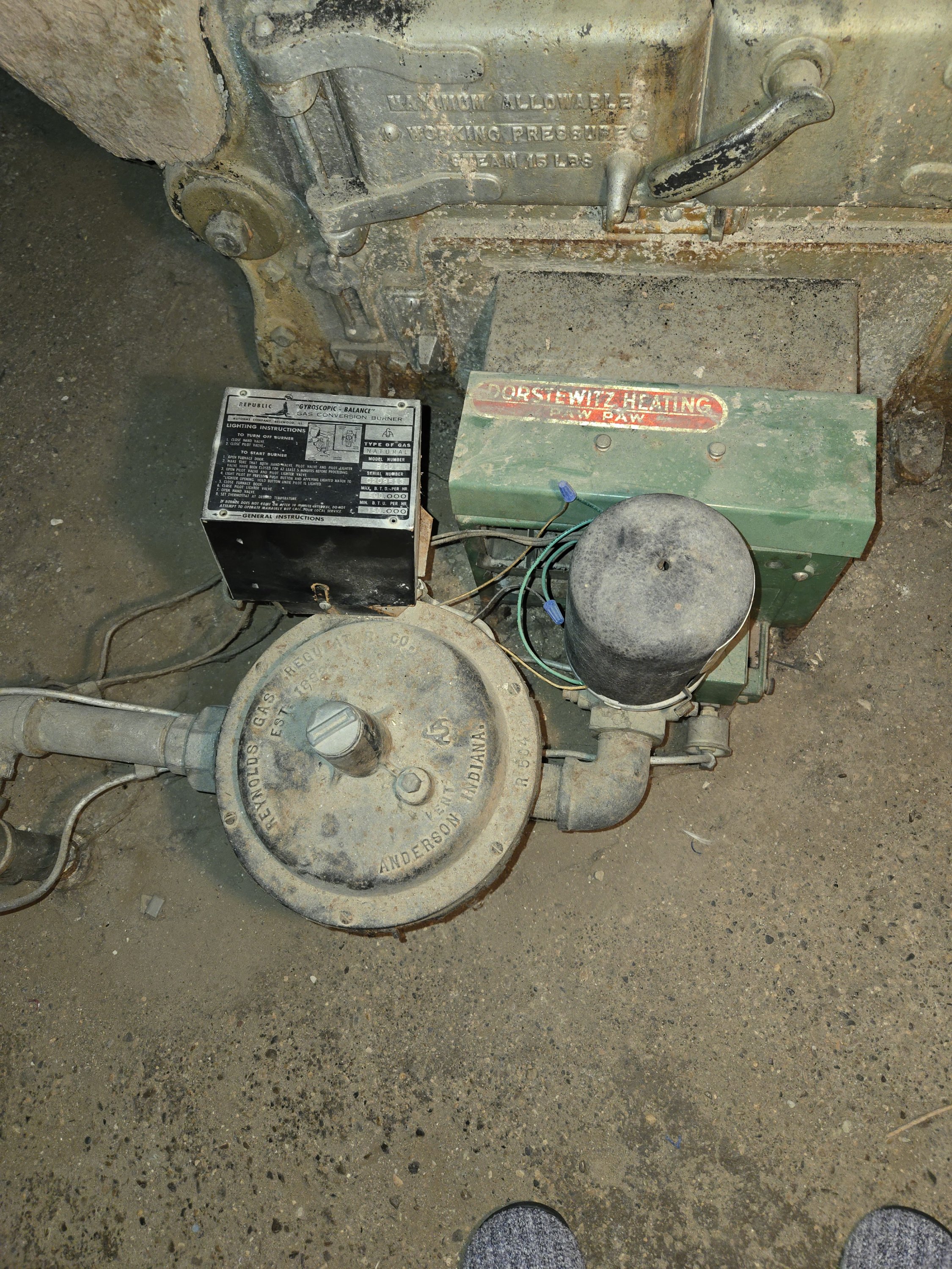

A wire in the gas conversion burner has basically burned up/ has come apart.

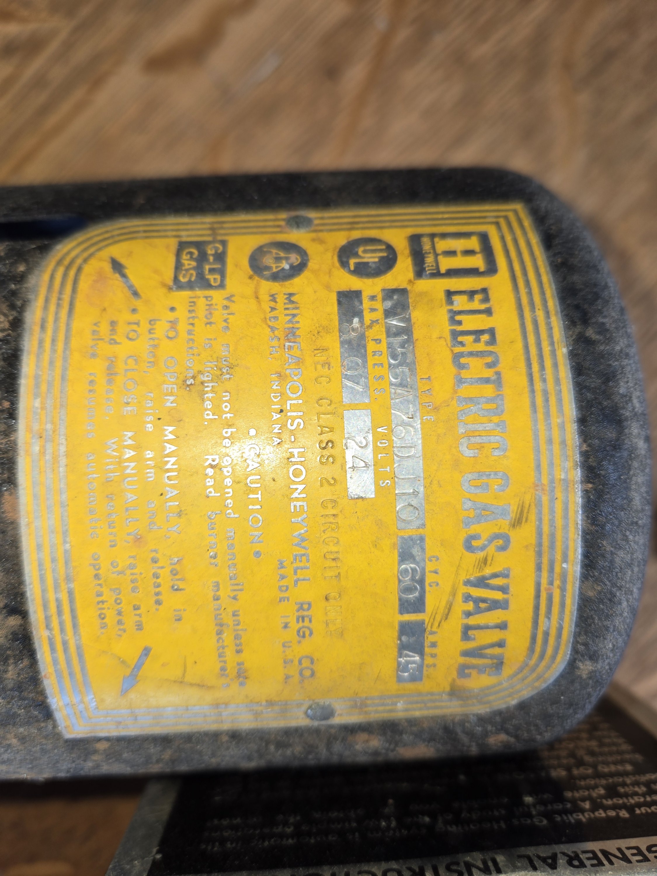

I used the electric gas valve to manually start it, it warmed up the house and turned off automatically like it should. The second time I manually started it, it didn't shut off, the temperature of the house rose above the thermostat setting, and had to manually, turn it off. I haven't touched it since.
So far, new parts are impossible to find. It's been recommended that I upgrade to a new steam heat boiler.
Is there any chance that I can find new parts out there? Where do look?

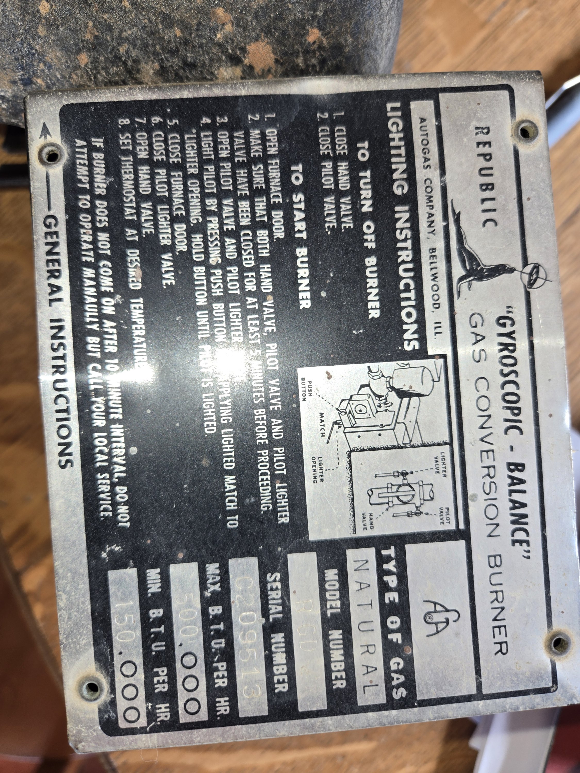

Edit- By manually, I mean that I saw the thing with the yellow sticker on it. The two arrows pointed to a button and a lever. When I pushed the button and pulled up the lever, the boiler started right up like it usually does. It warmed up the house and then turned off automatically, like it should.
The second time I did it, the house just got warmer, ten degrees warmer than the thermostat,s so I pushed the lever back down to the off position. I haven't touched it since.

    What do you mean by "manually started"?
    It should be replaced but someone that understands it probably could fix it. Hutzel had people that understood them 30 years ago, don't know about now.
    If the valve is sticking it could be replaced with a modern combination valve. the whole conversion burner could be replaced with a gas power burner. If a safety/operating control is bad, those are common off the shelf parts for someone that knows steam heating. You should not operate it without being right at the boiler watching the sight glass and the pressure gauge until the problem is identified and fixed.

    That, as ou have surmised, is a gas conversion burner fitted to a very elderly boiler which was originally coal fired.
    Yes, the boiler should be replaced — sometime, and probably only because the efficiency is not very good. In the meantime, however, surely there is someone around who does power gas conversion burners who could replace the burner. It's not an integral part of the boiler — you can remove that burner that's in there and install a new one. It's not a DIY job, however.

    I doubt that you can find the part — athough stranger things have happened.
    What you can find is someone who can take that burner out and put a new power gas fired conversion burner in.

    That boiler was designed to burn coal, and many such boilers were later converted to oil or gas firing. During the fuel-rationing days of World War 2, they were often fitted with baffles to slow down the exhaust gases and extract more heat from them. It would be interesting to see what's inside.
    And ISTR @Tim McElwain has the manual for that Republic Gyroscope burner.

    that appears to be a multi pass boiler, if whoever did the conversion put some baffles in it to slow the products of combustion down it might not be awful.

    I looked at Rina's boiler yesterday. Did an audit of the connected load. It was interesting to me that in the numerous audits I have done this is the first time that every radiator was the same model. And all we had to do was count the sections. She has a connected load of 765 Sq. Ft. So I am looking at the Burnham STMX299. Asbestos is making this a very challenging install and we will have to sort out the most cost effective method as well as the demo.
    I have done a number of conversion burners in my career which goes back 50+ years growing up in Detroit. I have never seen this burner. It is modulating and controlled by a vapor stat. We are looking into the cost of changing out the conversion burner as well. Two pipe system, piped reasonable well for the era of the boiler. Flue needs work and of course a Hartford Loop. The insulation is fairly thick so I am not sure if I am dealing with a 3, 3.5 or 4 inch header. I got burned on job not far from her home that had a 3.5" main and I thought it was 3" It brought the install to a halt until I found the 3.5" fitting I needed in CA. Availability is always the challenge this time of year so we are looking at all the options.

    I hear you on the 3 1/2" pipe. I got messed up with 7" once and thought it was 6". I usually measure the OD of the covering on it and then stab threw it with a sharpened coat hanger. Subtract 2 x the wall thickness of the insulation to get the pipe OD.
    Is there room to install the new boiler next to the old and do the asbestos and boiler removal in the summer?
    Those old Ideal boilers were built like tanks.

    could replace the gas train to that conversion burner with a single stage combination valve and on/off vaporstat and fire it at whatever rate the boiler and system will tolerate.
