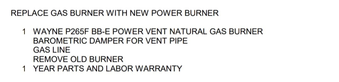

    I have a guy who wants to replace it with a new boiler from that company. But he said he's having trouble figuring out how many btu's I'll need.
    Rina
    mattmia2 Member Posts: 17,905
    that is kind of a red flag unless there is some reason. it would be sized by measuring the EDR of the connected radiators.

    I looked at Rina's boiler yesterday. Did an audit of the connected load. It was interesting to me that in the numerous audits I have done this is the first time that every radiator was the same model. And all we had to do was count the sections. She has a connected load of 765 Sq. Ft. So I am looking at the Burnham STMX299. Asbestos is making this a very challenging install and we will have to sort out the most cost effective method as well as the demo.
    I have done a number of conversion burners in my career which goes back 50+ years growing up in Detroit. I have never seen this burner. It is modulating and controlled by a vapor stat. We are looking into the cost of changing out the conversion burner as well. Two pipe system, piped reasonable well for the era of the boiler. Flue needs work and of course a Hartford Loop. The insulation is fairly thick so I am not sure if I am dealing with a 3, 3.5 or 4 inch header. I got burned on job not far from her home that had a 3.5" main and I thought it was 3" It brought the install to a halt until I found the 3.5" fitting I needed in CA. Availability is always the challenge this time of year so we are looking at all the options.

    could replace the gas train to that conversion burner with a single stage combination valve and on/off vaporstat and fire it at whatever rate the boiler and system will tolerate.
