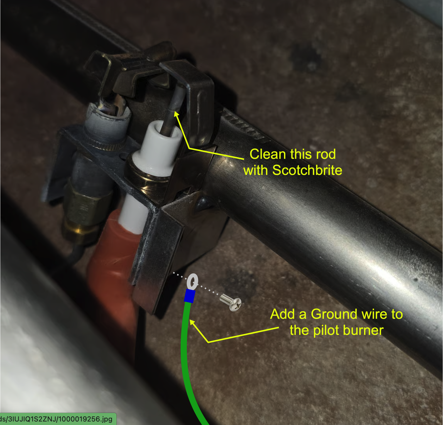

    Sometimes the ignition rod at the pilot is also the flame sensor. All depends on the ignition module and the boiler setup. Boiler model ? The high voltage will jump through contamination but the much more sensitive flame detection may not work correctly.
    It seems the pilot is staying lit when the main burner is going out, which seems to me as odd behavior from the ignition module. The due diligence with a multimeter with a logical process that actually verifies the ignition module is actual defective should be done.
    Also verifying all the electrical connections are physically secure should also be done.
    It now seems like a similar failure to when the old ignition module was changed, which makes me wonder if something else is going on that was missed back then.

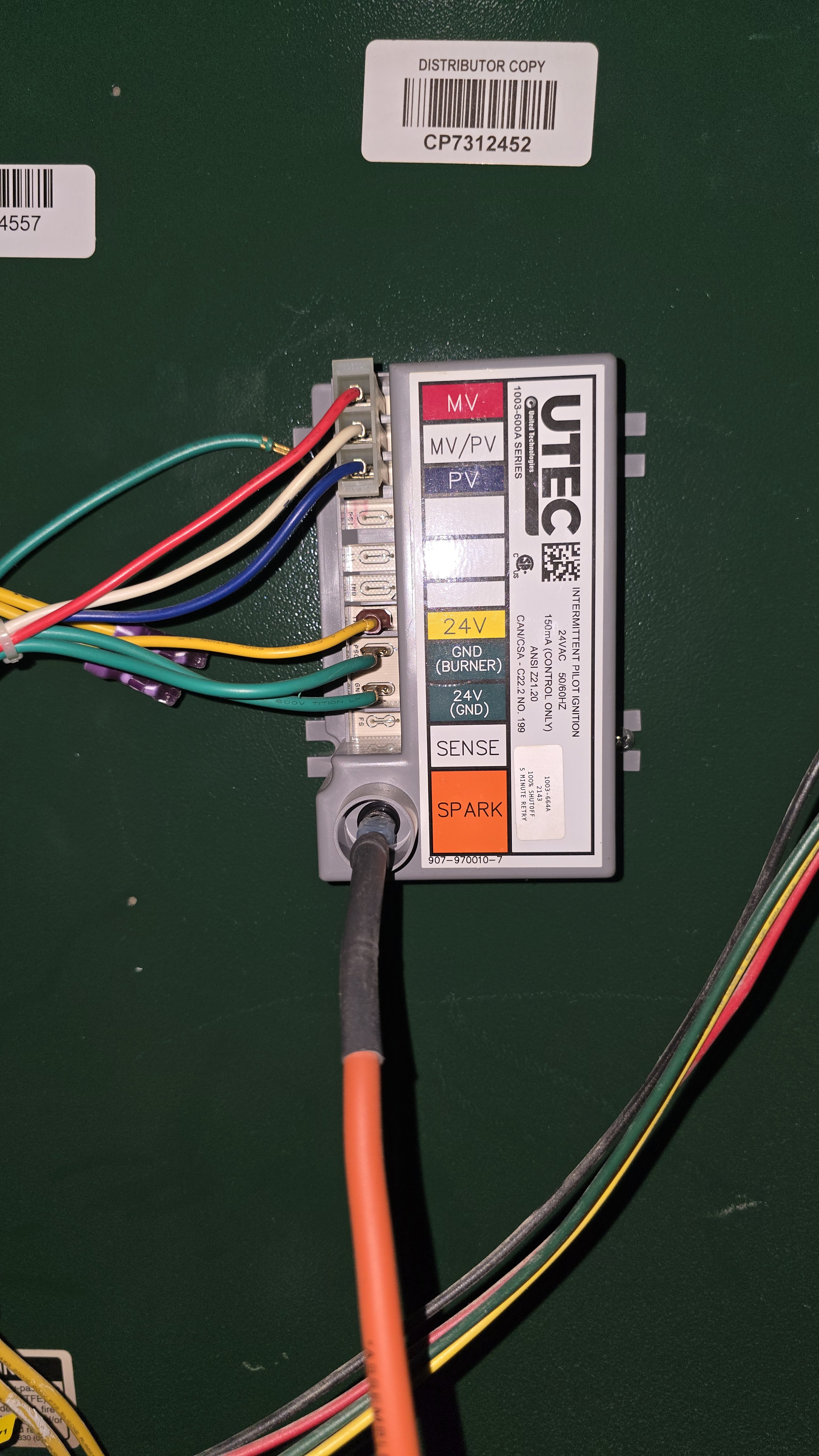

    @109A_5 some pictures to view. If its definitely the ignition module then ill have to start calling around for quotes/diagnostic but I think most things to troubleshoot have been exhausted. We're also going away next week and although it heats in the home may not be able to risk it giving out while we're away with tenants around.

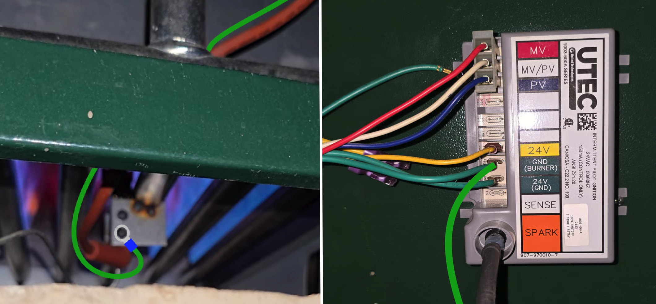

    This failure in the first video and around time stamp 6:23 on the second video remind me of a flame proving signal being lost. More than likely there is a ground path failure in the Flame Rectification path from the UTEC ignition control thru the flame back the the UTEC control That is common when a burner is connected to the rest of the boiler the way your burners are fitted. To be sure the ground path from the burner to the UTEC control is not corroded or compromised I run a physical ground wire from the pilot burner to the GND (BURNER) terminal of the UTEC Control.
    Here is an illustration of the wire in place
    This wire will eliminate any fault with the ground connection present from the burner to the control
