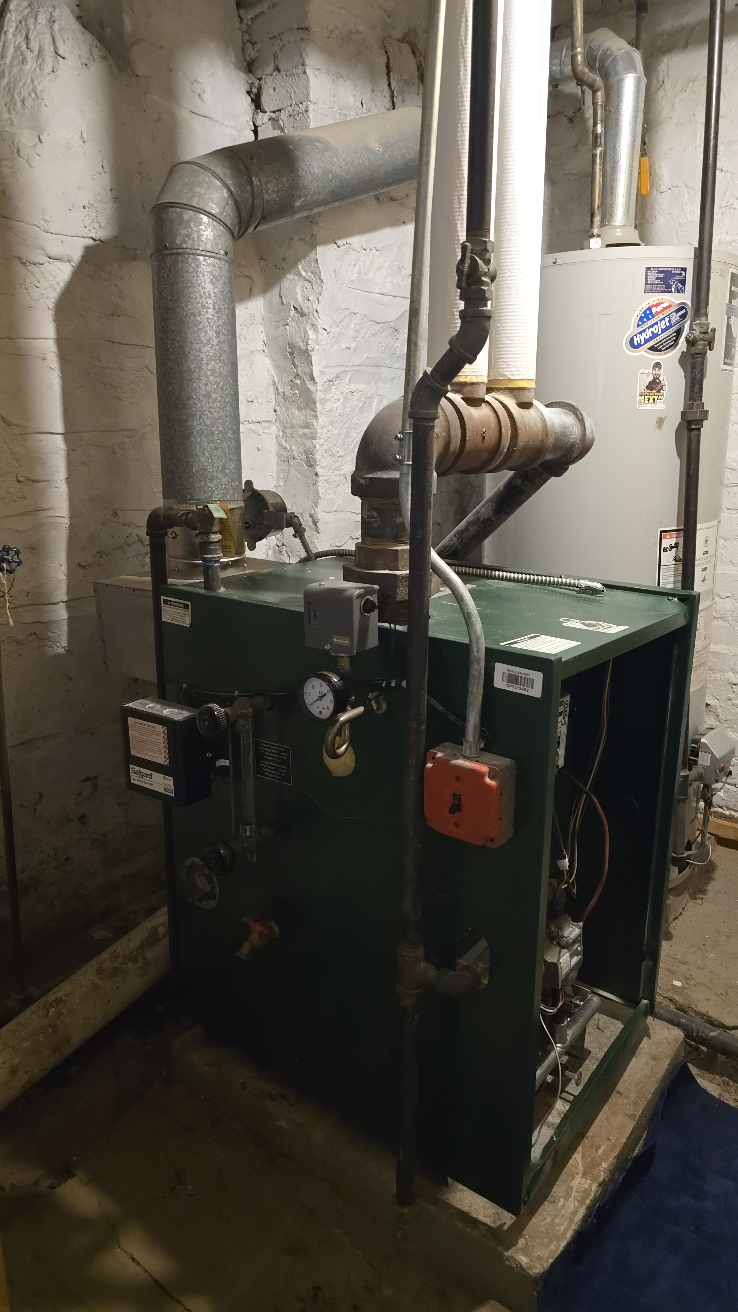

Hi All,
Im the past ive found the experts on this forum very helpful. Hoping again for that knowledge. As the weather starts to get colder its that time for the boiler to turn back on. In the past we've had our issues like not turning on completely leading to a replacement of the ignition box and pilot. This was 2 years ago. This time around we think its short cycling since it does turn on for a 1-2 min run and then it beeps calling for heat , turns on for a under a 1min then off/on all until the thermostat reaches its temperature.
This is a Williamson boiler to a one pipe system , steam gas boiler. We had someone come by to take a look but they didnt feel confident. Still suggest the ignition box ,pilot and gas valve be replaced
So im wondering does this somewhat sound correct. Trying to research short cycling on steam boiler and get lots other trouble shooting suggesting before having to do a complete replacement. I tired uploading the video but its too big. But any other advice would be much appreciated.

    post a general picture, floor to ceiling, showing the controls side,
    post a closeup on the controls and site glass, and gage while it's firing,
    low water cutoff, pressuretrol, may need service,

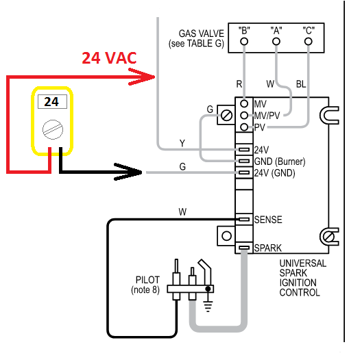

    What looks like the main burner drops out and intermittently the pilot stays lit and/or goes out then it restarts again. I'd verify that the 24 VAC to the Spark Ignition Control module is consistent and stable when the burner drops out. If the 24 VAC is good the Spark Ignition Control module is probably bad again. However before changing the module I would verify the flame sense rod is clean and there is 24 VAC from MV/PV to PV only when the pilot is lit.

    @109A_5 today we tried to clean the pigtail, it wasn't an easy one to take of so had to get a bit creative to get some slug out. Wiped burners off, not too dusty. This boiler doesn't have the traditional flame sensors I see when I search for an image. Its just the pilot like the diagram you added.

    Sometimes the ignition rod at the pilot is also the flame sensor. All depends on the ignition module and the boiler setup. Boiler model ? The high voltage will jump through contamination but the much more sensitive flame detection may not work correctly.
    It seems the pilot is staying lit when the main burner is going out, which seems to me as odd behavior from the ignition module. The due diligence with a multimeter with a logical process that actually verifies the ignition module is actual defective should be done.

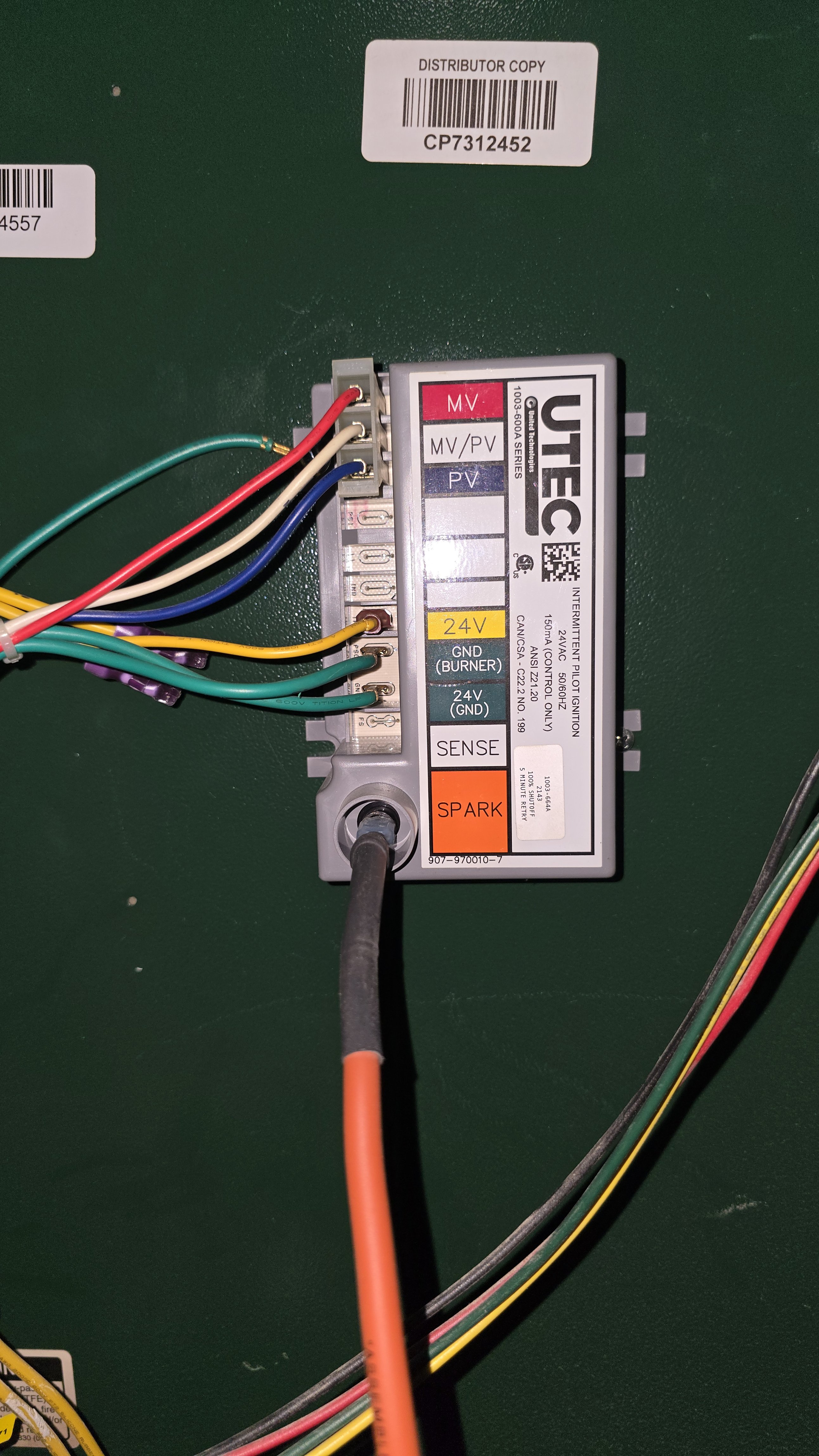

    @109A_5 some pictures to view. If its definitely the ignition module then ill have to start calling around for quotes/diagnostic but I think most things to troubleshoot have been exhausted. We're also going away next week and although it heats in the home may not be able to risk it giving out while we're away with tenants around.

    This failure in the first video and around time stamp 6:23 on the second video remind me of a flame proving signal being lost. More than likely there is a ground path failure in the Flame Rectification path from the UTEC ignition control thru the flame back the the UTEC control That is common when a burner is connected to the rest of the boiler the way your burners are fitted. To be sure the ground path from the burner to the UTEC control is not corroded or compromised I run a physical ground wire from the pilot burner to the GND (BURNER) terminal of the UTEC Control.
    Here is an illustration of the wire in place
    This wire will eliminate any fault with the ground connection present from the burner to the control
