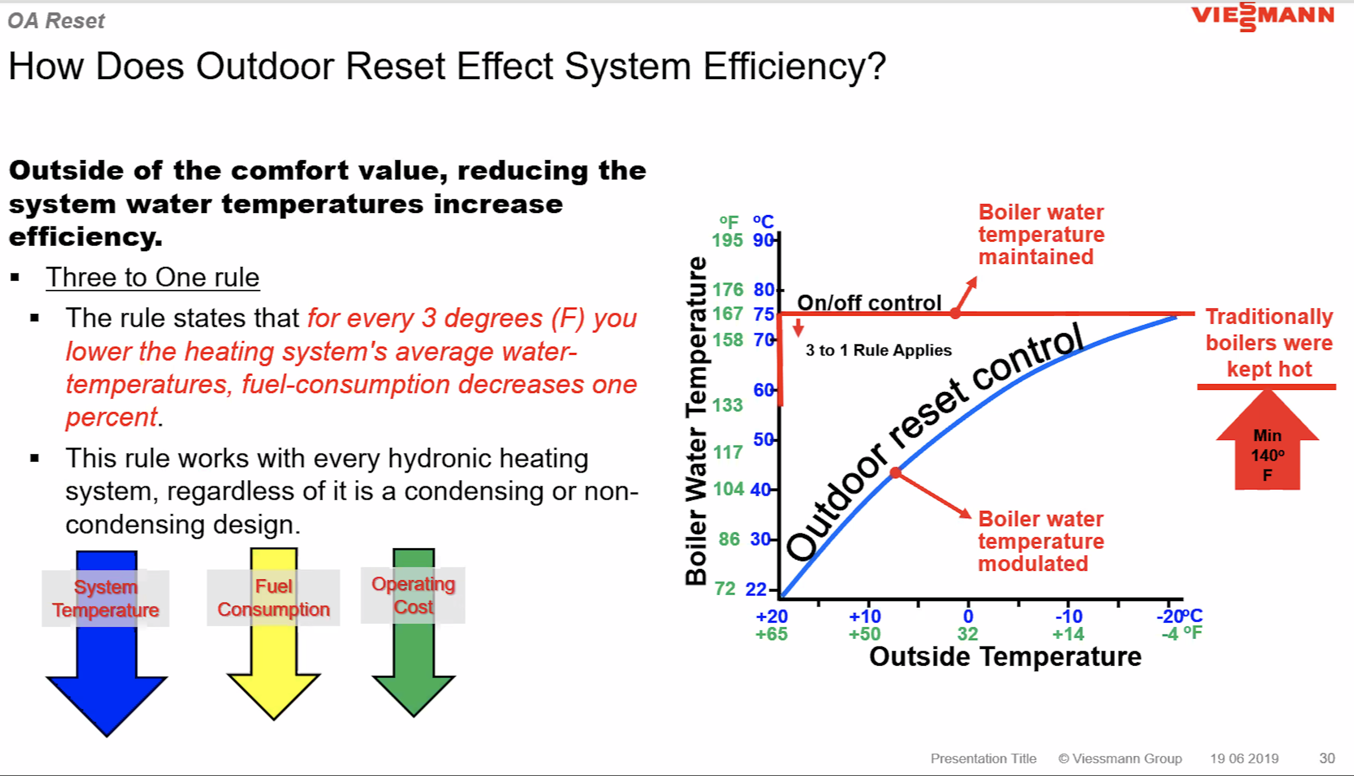

    hot_rod Member Posts: 27,509
    At this point you need to work with the hand you were dealt. Connect a boiler that meets the heat load calculation number. Pipe it properly, good air removal, purge points. etc, etc.
    Fire it up on ODR with design set at 180.
    Does it heat adequately on the coldest, design day? If so, start cranking down the design supply temperature. Get it as low as possible to maintain your desired indoor temperature.
    Enable the outdoor reset function and the boost feature.

  • Charlie from wmass
    Charlie from wmass Member Posts: 4,425
    Running 185 during coldest days and using outdoor reset for the shoulder seasons will still net fuel savings. More heat emitters can be added later to improve efficiency. That is a June project not November.
    I think this Viessmann training slide is accurate in it's projections.
