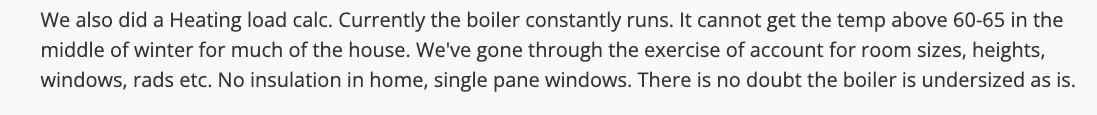

We also did a Heating load calc. Currently the boiler constantly runs. It cannot get the temp above 60-65 in the middle of winter for much of the house. We've gone through the exercise of account for room sizes, heights, windows, rads etc. No insulation in home, single pane windows. There is no doubt the boiler is undersized as is.
    pecmsg Posts: 7,634
    How do you know it’s vastly undersized?

    Many radiators were removed by a previous homeowner who went cheap on a boiler replacement. That old boiler has never been able to keep up with what is in the home, much less adding more radiators in to make up from all the ones he yanked out.

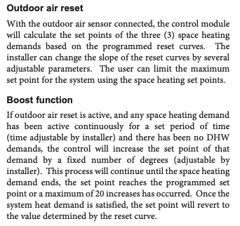

    At this point you need to work with the hand you were dealt. Connect a boiler that meets the heat load calculation number. Pipe it properly, good air removal, purge points. etc, etc.
    Fire it up on ODR with design set at 180.
    Does it heat adequately on the coldest, design day? If so, start cranking down the design supply temperature. Get it as low as possible to maintain your desired indoor temperature.
    Enable the outdoor reset function and the boost feature.

    Now if the system is grossly under-radiated, that will take a different solution.
  • Running 185 during coldest days and using outdoor reset for the shoulder seasons will still net fuel savings. More heat emitters can be added later to improve efficiency. That is a June project not November.
