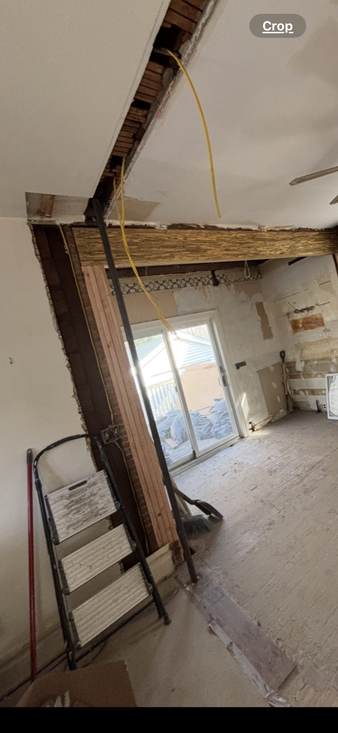

    found a photo of when the pipe was moved. Not sure if this provides any insight. You can see the old pipe running up to the second floor and I believe it elbows to the right to go where the radiator is. The space between the studs where the electrical switch is is where the new pipe was ran, however I don’t have photos of this. Looks like there would need to be 3 elbows in order to connect to the riser.
    Jamie Hall Member Posts: 27,008
    Oh dear. Sounds like you have some "horizontal" sections in the floor upstairs now… and any one of them could be your problem as well. When the piping upstairs was extended to meet the new riser, how was that done? If the new piping was done in copper, is the copper at least as large a diameter as the old iron pipe? How was it connected?
