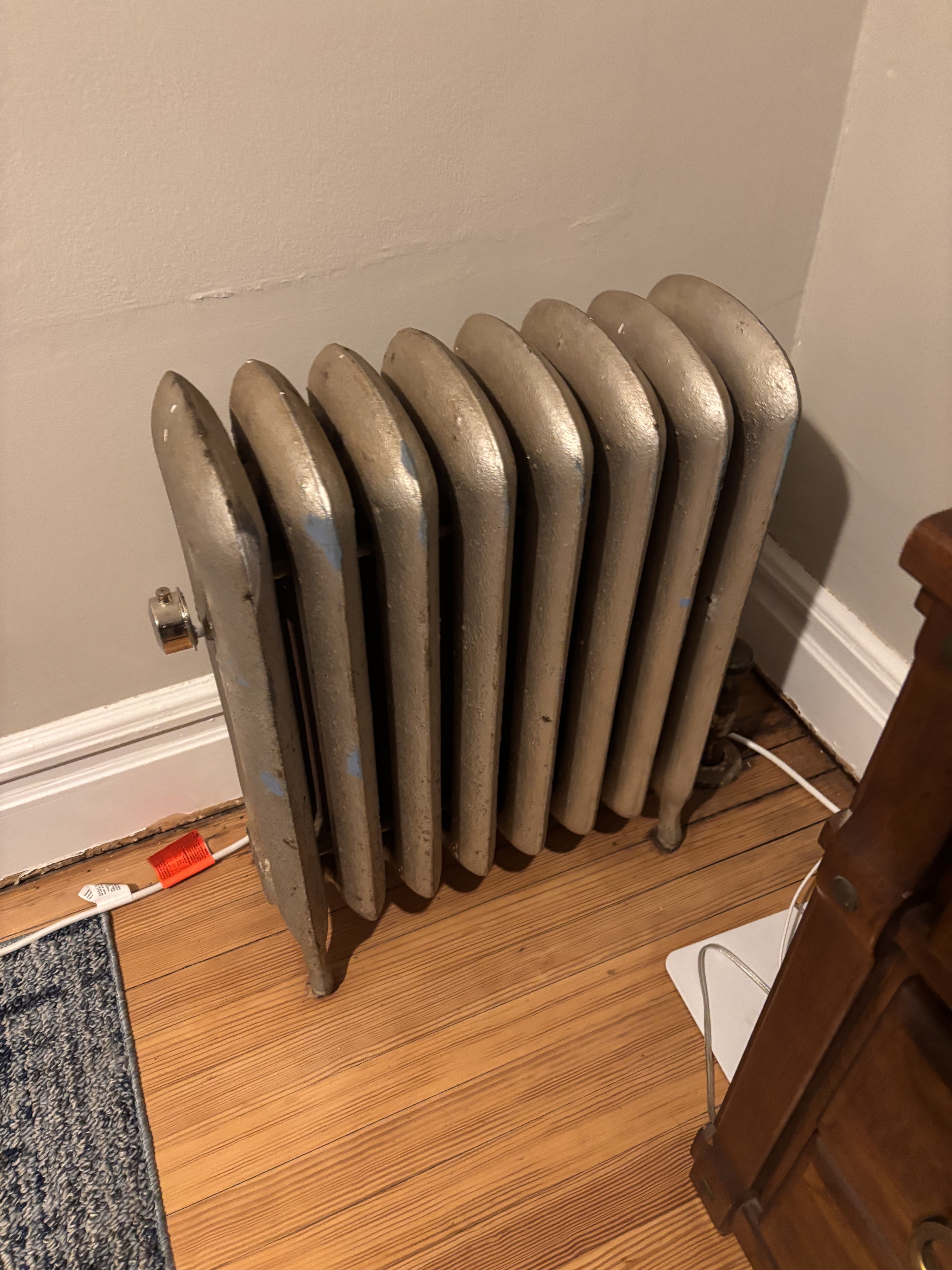

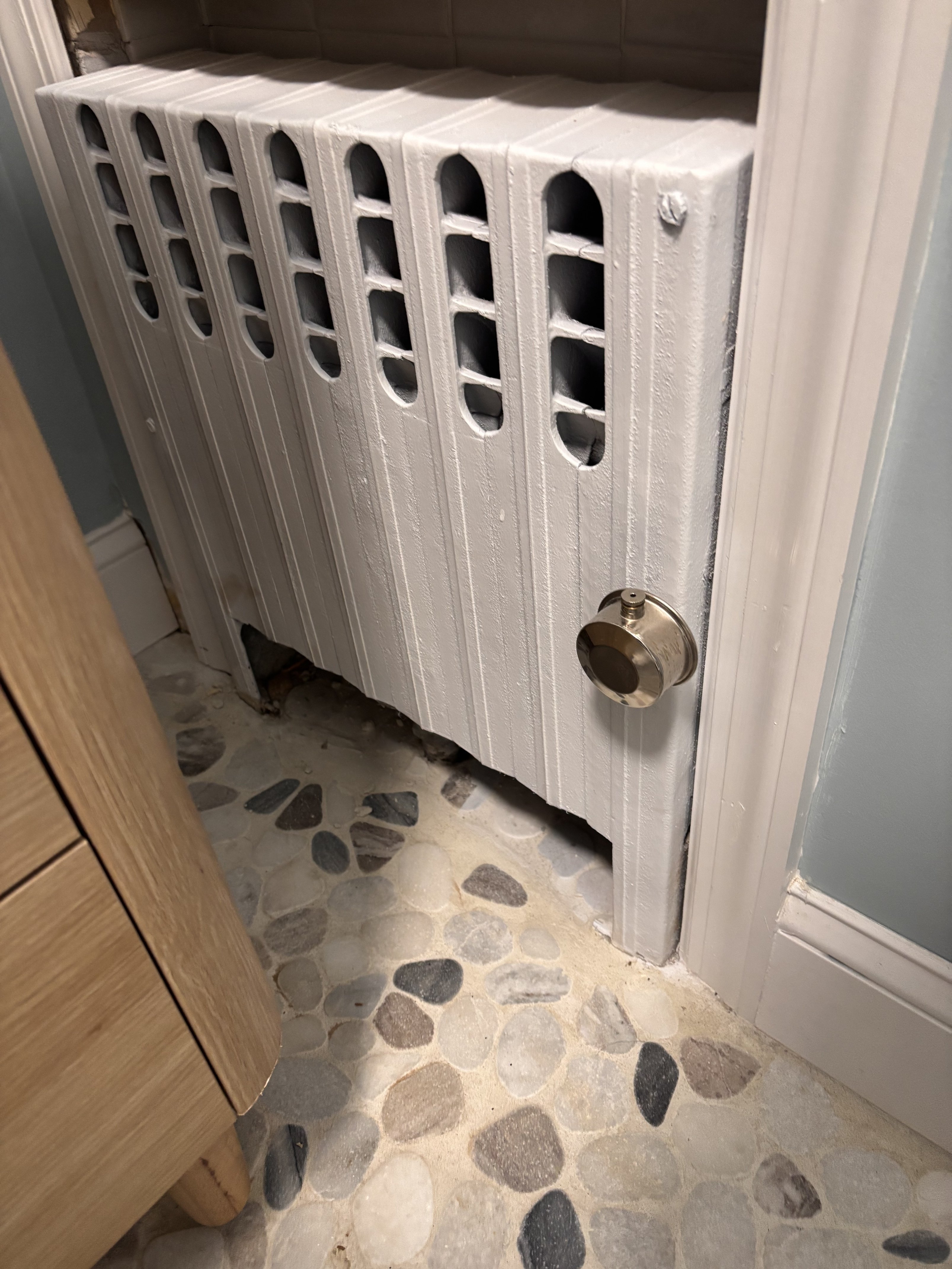

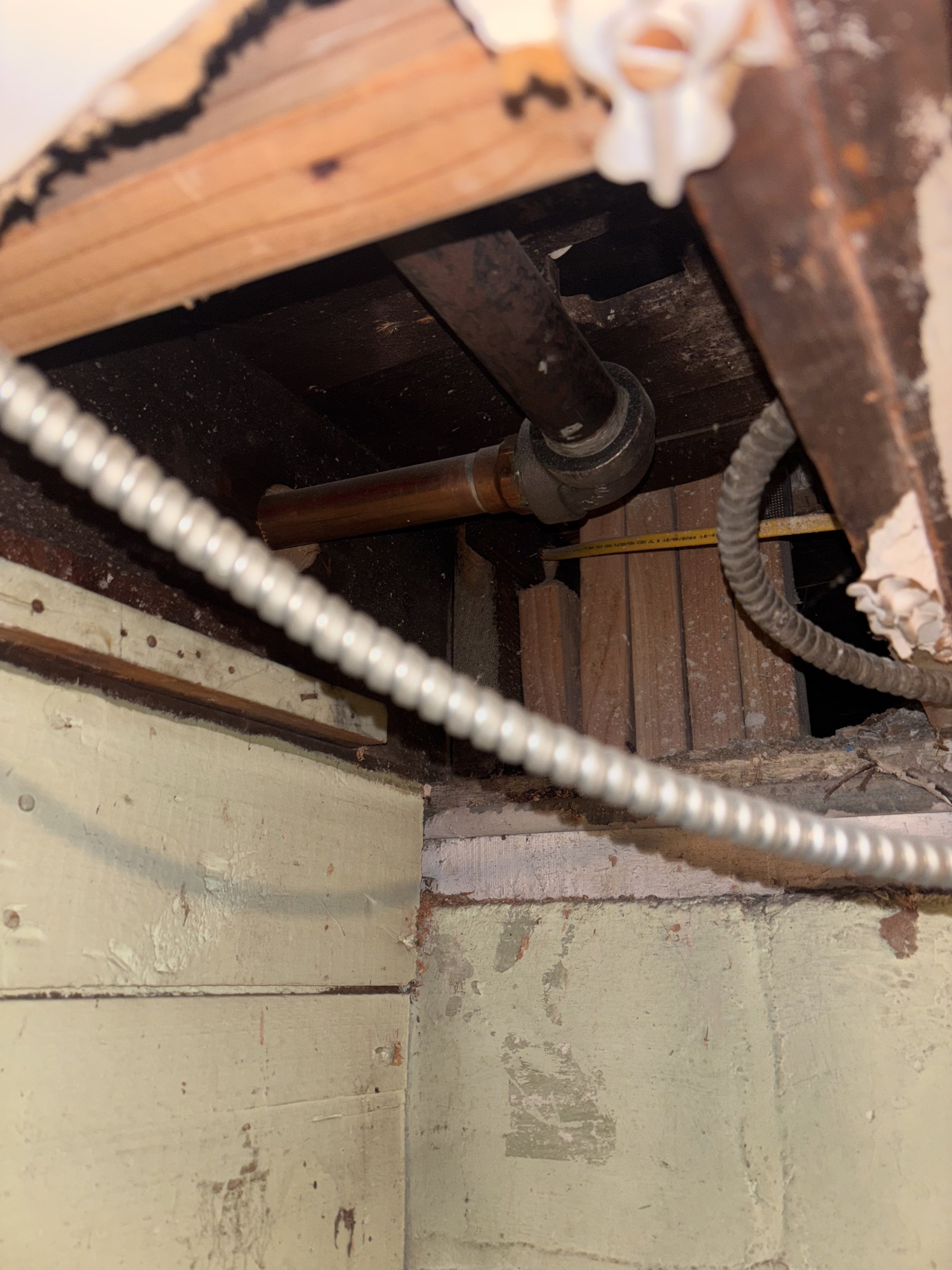

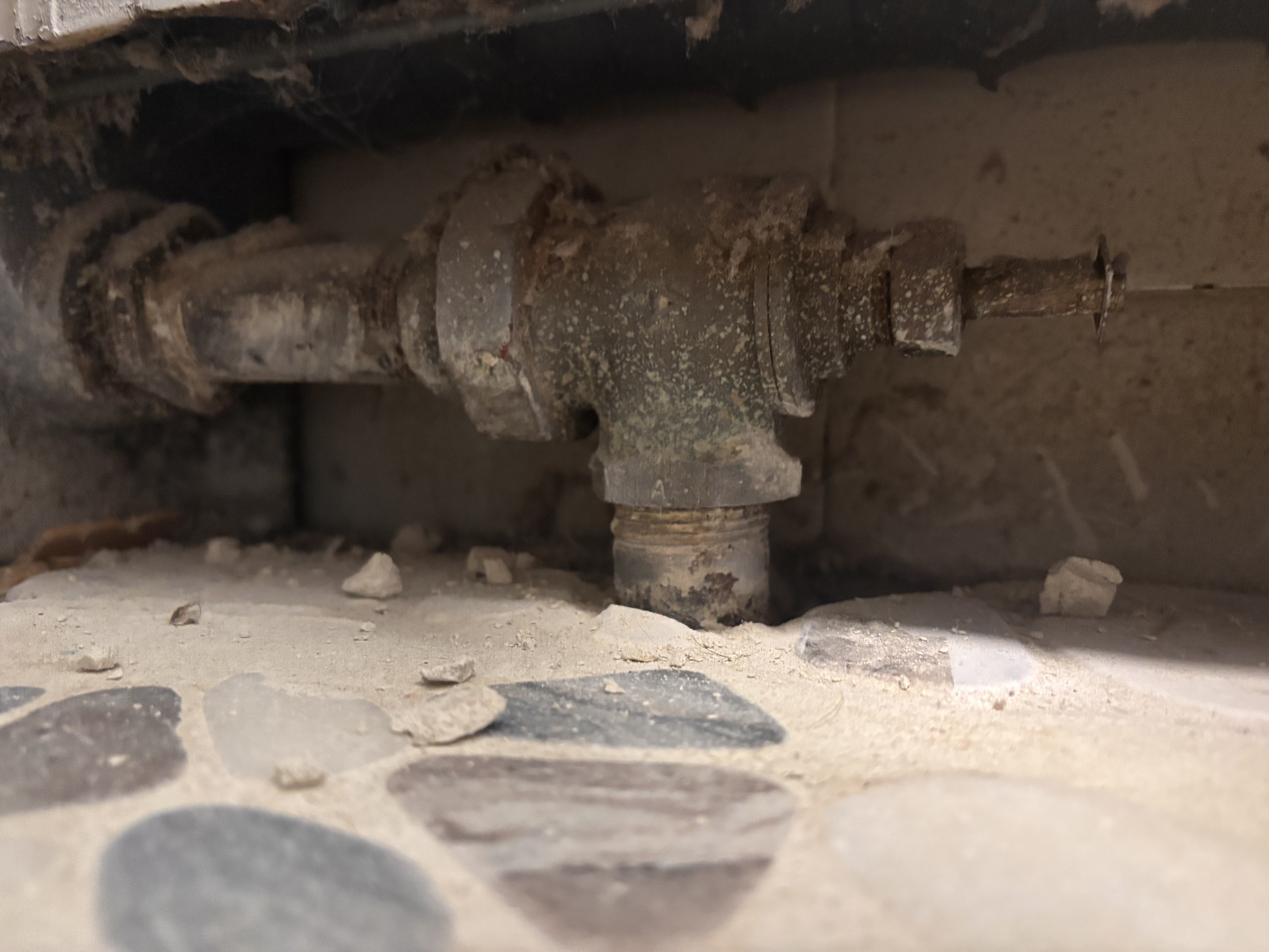

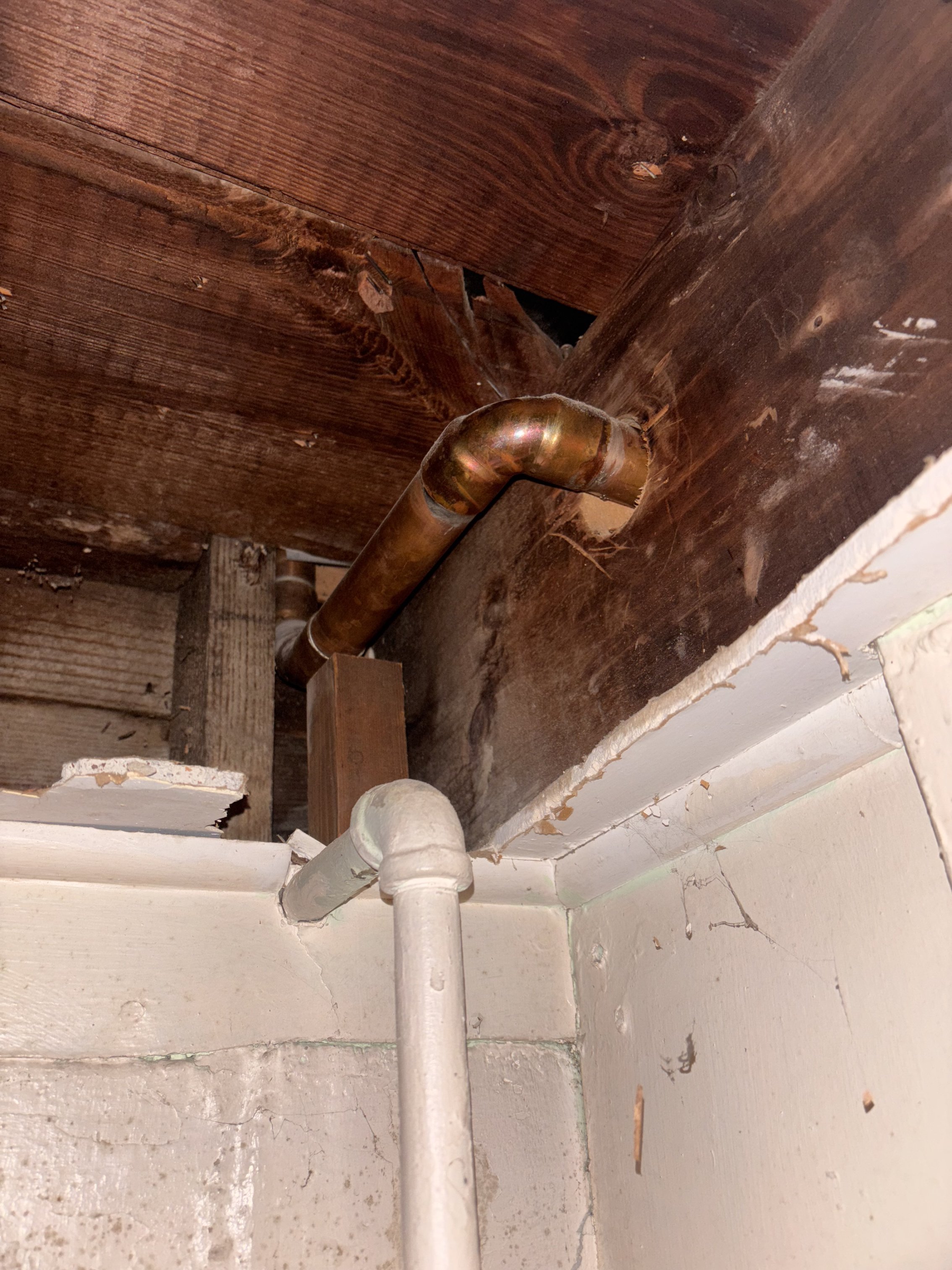

    alextbull Member Posts: 12
    see pics attached
    1: where black pipe went to copper (basement)
    2: copper being rerouted upstairs (basement)
    3: bathroom radiator - this is the one making all the banging noise when heat starts up.
    4: radiator in bedroom. Just on the other side of the wall is the white radiator in the bathroom in prior photo.
    5: I retitled bathroom. Supply valve for bathroom. Is mortar too close to where the radiator comes thru floor it’s not allowing for contraction/expansion?

    Yes. The grey radiator is shimmed towards the supply valve. The white one is hard to get something under since it’s such a tight space.
    what are people’s thoughts on the grout of the bathroom floor being too close to the pipe exiting the floor , possibly limiting the contraction and expansion of the pipe? Make a difference?

    I don't think your grout is restricting any contraction or expansion.

    Can't tell from pics but the copper pipe in the second picture running back to the riser probably is run flat as there is no swing joint. The hammer could be in that location. The bottom of the riser should have a swing joint and be pitched back to the boiler. You can get away with 1 pipe being flat but if you have 2 pipes flat that causes issues especially if the rises goes up a distance as you will get more condensate in the riser flowing down faster on a cold start

    Jamie Hall Member Posts: 27,600
    You have two short horizontal sections of copper pipe there joined by an elbow. Is there a way that you can increase the pitch on either or both of them — preferably the second one in line? I think that that is where your problem is, and the story goes like this: steam starts into those pipes and then up the riser. It condenses, as it naturally will, in the riser and drips back down to the bottom of the riser — and then tries to flow back to the boiler through those two horizontal sections. But — steam is trying to go the other way, at speed, building waves or even slugs of condensate which hit the two elbows.

    Check the pitch first before you get carried away. I could be wrong — I have been before. On a short section of pipe like that I'd want to see at least a half inch drop back towards the main.
