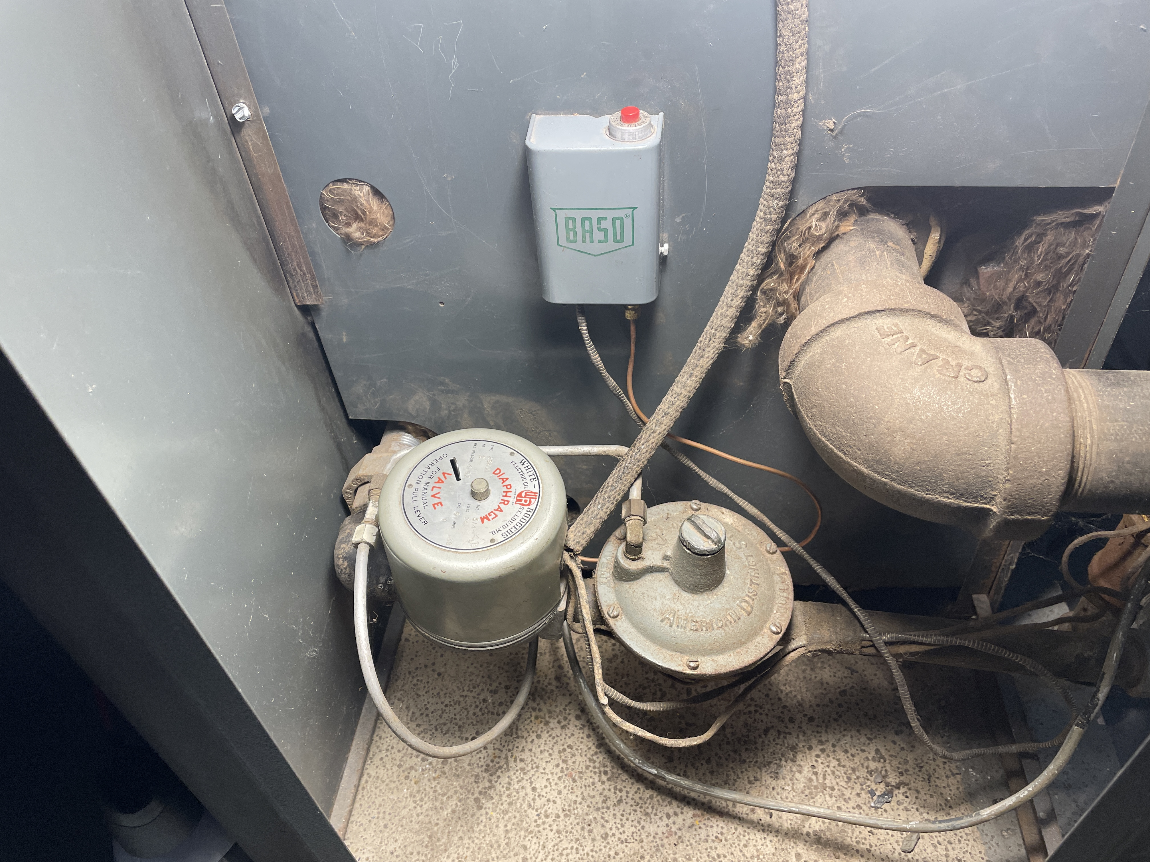

This doesn't happen every time, but it has been happening more frequently lately. The radiators heat up and the gas continues to heat the boiler even when I turn off the thermostat. If I don't notice that the gas has not turned off, the radiators will continue to heat up to very high temperatures and sometimes the water pressure will build up and the hot water relief valve will open at 30psi and dump some water on the floor. Most times I can turn the thermostat on and off and have the boiler turn on and off so I don't think it's an issue with the thermostat.
There is a mechanical pull switch on the gas valve that allows you to open and close the gas manually. I noticed that this can sometimes stick open if it's pulled all the way out. I cleaned it with a swab and some wd-40 and acetone and then oiled it lightly. If I pull and let go of this switch it springs back and closes the valve but if I pull it all the way it sticks open. So, I'm concerned that it's still going to stick open. Does anyone have ideas for other things to try? Are these parts something that can be serviced and tuned up or is it just too old and no one will work on it? I have more pictures and a video if needed.

    That is a very dangerous condition. You need to immediately turn off the gas and electricity to the boiler & call to get it serviced before you end up killing yourself or someone else.

    Are there people who can service the components of such an old boiler? I assume it was made in the 1950s and these parts are no longer available. I suspect if I call a technician they will just want to replace the whole boiler. Since I cleaned the sticky solenoid switch it has cycled on and off several times on its own and is working fine, but I would like to have a professional tune it up if I can find someone who knows how to work on something this vintage.
  • ratio
    ratio Member Posts: 4,259
    It'll likely possible to replace the gas valve & ancillary parts with modern components, but it may take some looking to find the right person to do it. Try the "Find a Contractor" link in the blue bar above.
    Given the age, replacement might be the correct answer.
    You still shouldn't operate it until it has been serviced. Gas stuck on is a serious failure. If the pressure relief fails, a boiler explosion is the next step.

    Shut it down. Will most contractors replace it……..Yes because we do not want to accept the responsibility and liability associated with that antique, especially if it was in my own home!

    Replace the old gas valve and regulator with a modern combination valve.

    Basically don't operate it until you replace the gas train with a modern combination valve.

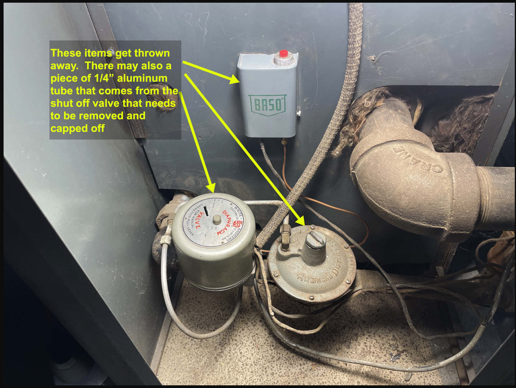

    If you have this information ready for an experienced gas heat technician, you can ask them what it might cost to remove the old standing ignition parts and install this electronic ignition kit to make the old boiler more reliable. https://www.supplyhouse.com/Resideo-Y8610U6006-Intermittent-Pilot-Control-Conversion-Kit-for-270000-BTU-Units
    EdTheHeaterMan Member Posts: 12,448
    edited October 2025
    If you have this information ready for an experienced gas heat technician, you can ask them what it might cost to remove the old standing ignition parts and install this electronic ignition kit to make the old boiler more reliable. Y8610U Kit
    It will replace all the parts in this photo
    There may also be a 1/4" aluminum pilot tube that comes from the manual shut off valve the will need to be removed and capped off. This is the Cadillac repair, however there are less expensive repairs available. Just remember the price you pay at SupplyHouse.com is the wholesale price and if the contractor provides you that kit. It will be marked up and include labor to install the parts. It is a time consuming job and will also need additional parts and fittings to make the piping connections. The professionals are entitled to make a profit on both the parts and labor they pay the technician. So don't be shocked at the total price. Safety with a guarantee is worth the cost in my opinion.
