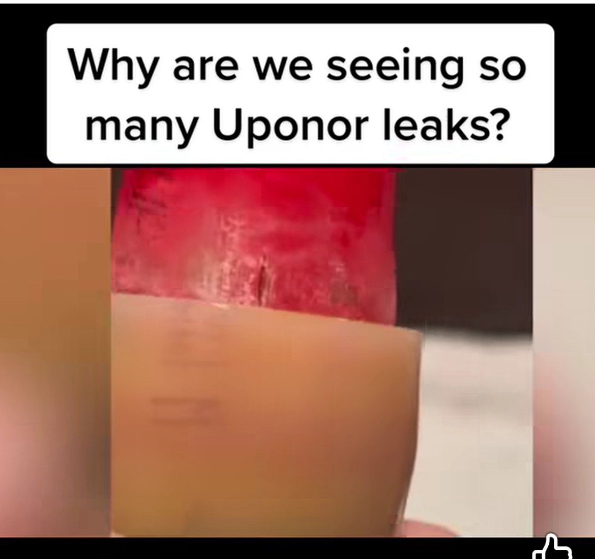

    you could also do what i did with pex expansion tools, i bought the off brand manual tool but bought the name brand heads thinking that most of the precision is in the head
    hot_rod Posts: 28,204
    i asked REMS about using other brand tongs in mine, or mixing expansion heads in other tools
    Officially no, unless they were tested and listed together to be compatible. ASTM F-1960
    Perhaps all the expansion pex failures are related to mismatched tools and heads?
    mattmia2 Posts: 17,995
    i had one leak before i read the instructions again and realized it needs to be rotated. maybe the auto rotators are failing or people are removing them.

    We've been selling uponor in northern michigan basically since they had a rep here. I've seen 2 "failures" the first installer didn't mind the min pipe distance to fittings and stuck the expander in the 90 that was already installed, 2 weeks later several thousand gallons dumps into a ladies apartment at a senior living facility (she was super nice, even baked us cookies since she knew we were coming to look at it) the second one was a mystery when we looked in the field. we sent the pipe back to uponor and they cut it open and kind of laid it out flat, you could see the grooves from the expander head were only in one cross pattern, we investigated the customers tool and sure enough the thing did not rotate itself! it was plain as day to see when they cut open the pex
