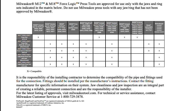

Here is Milwaukee's compatibility chart and disclaimer about mixing brands.
As @Derheatmeister mentioned the fitting manufacture could void warrant if an approved "calibrated" tool is not used. I suspect failed press joints are often related to improper tool maintenance and compatibility, as well as operator error?
I wanted to get some Milwaukee compact jaws for my REMS. The manufacturer recommended against it.
