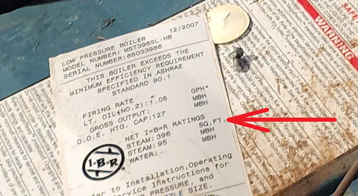

    I'd do an EDR (Equivalent Direct Radiation) survey and compare that number to the Sq. Ft. on the boiler's rating plate. Your boiler may be oversized, it may be more oversized since you removed a radiator.

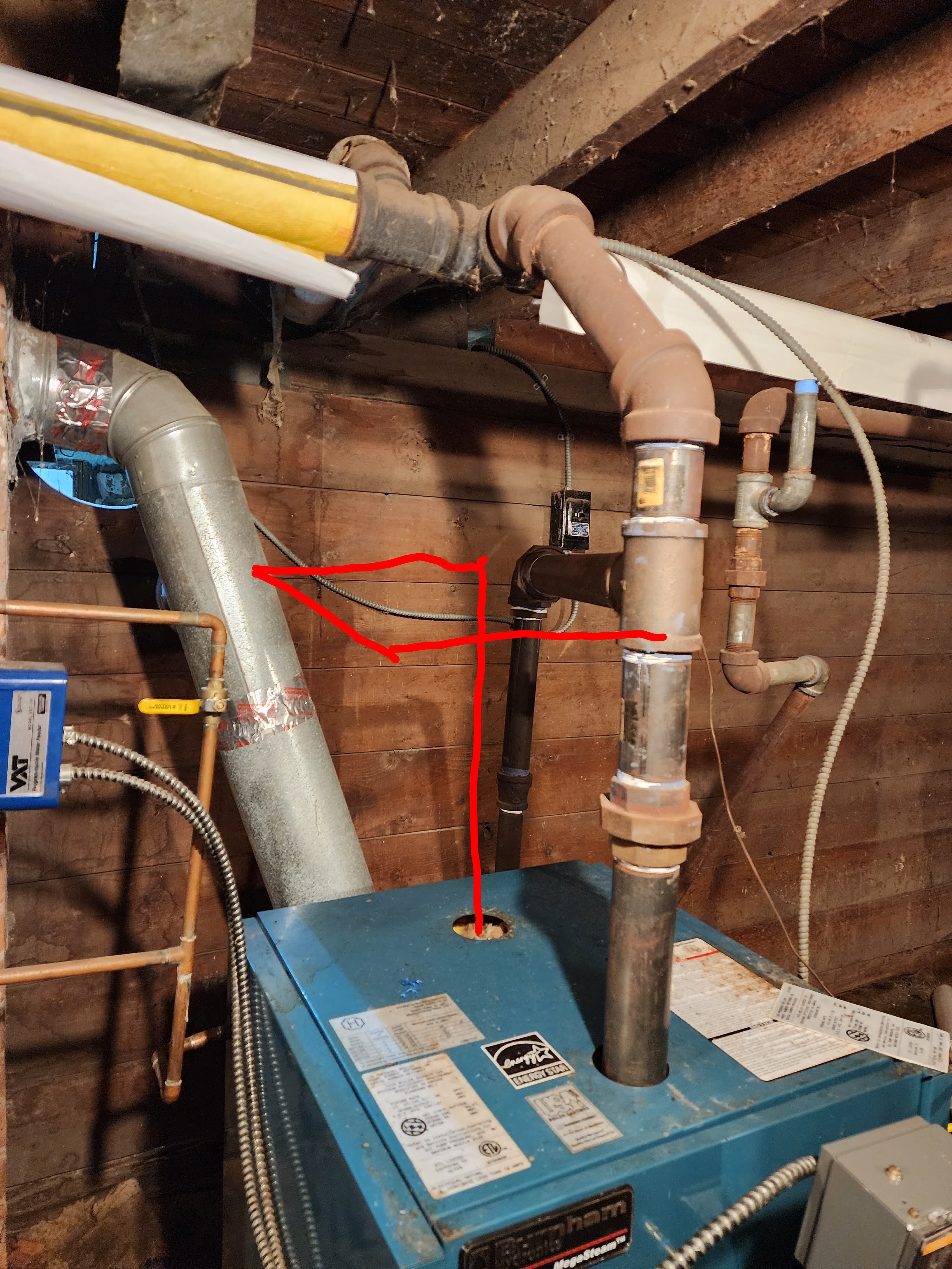

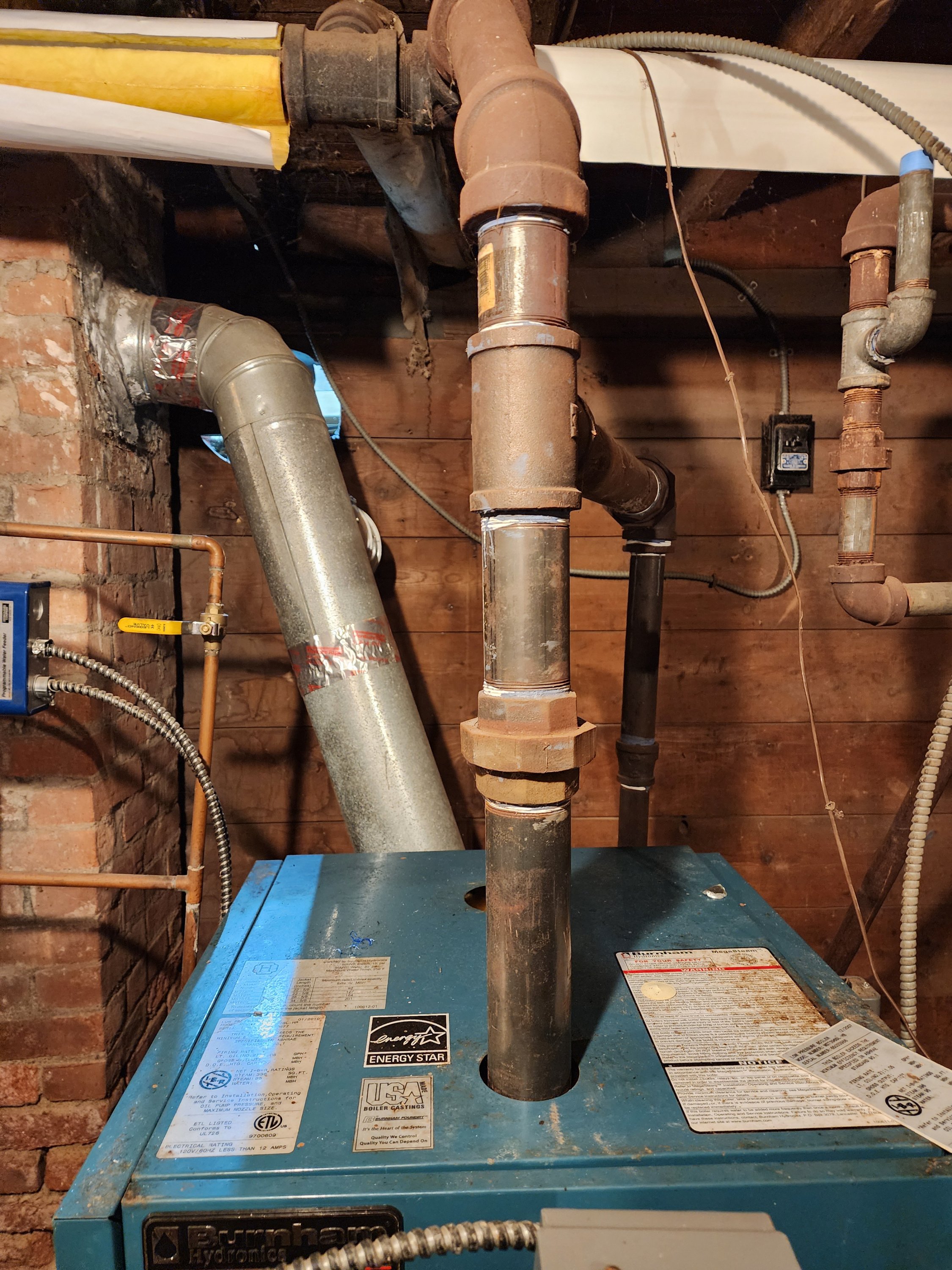

    Here are some pictures, including some of the near boiler piping. I managed to get the pressuretrol off. Also I think I know why it wasn't working. When I went to turn the pigtail to remove the whole thing, the pressuretrol snapped right off. There was definitely some corrosion on it. So I'll be replacing that now 😅

    Get a vaporstat and a low pressure gauge now that you have to replace it. that pigtail is brass.
    109A_5 Member Posts: 3,690
    Looks like it has been leaking for a while. The old version PA404A was brazed at the point it broke at.
    Steamhead Member Posts: 18,322
    That MegaSteam is an excellent boiler, but whoever installed it completely disregarded the piping instructions. Your system will run much better when it's repiped. What model is it- should be MST-something.

    mattmia2Mad Dog_2
  • cobyschaef
    cobyschaef Member Posts: 19
    edited October 2025
    The manual shows how it should be done.
    https://s3-us-west-2.amazonaws.com/catsy.782/MegaSteam+IO+Manual.pdf

    I would note that it is piped very wrong but it might still work ok, if it works ok I wouldn't worry about it.
    I'd fix the venting and see what happens. It could just be lack of venting but it also could be water that isn't being separated because of the improper/nonexistent header keeping the steam from progressing out to the radiators where it can be consumed instead of building pressure.
    If the water line is unstable or there is banging then the near boiler piping definitely needs to be fixed.

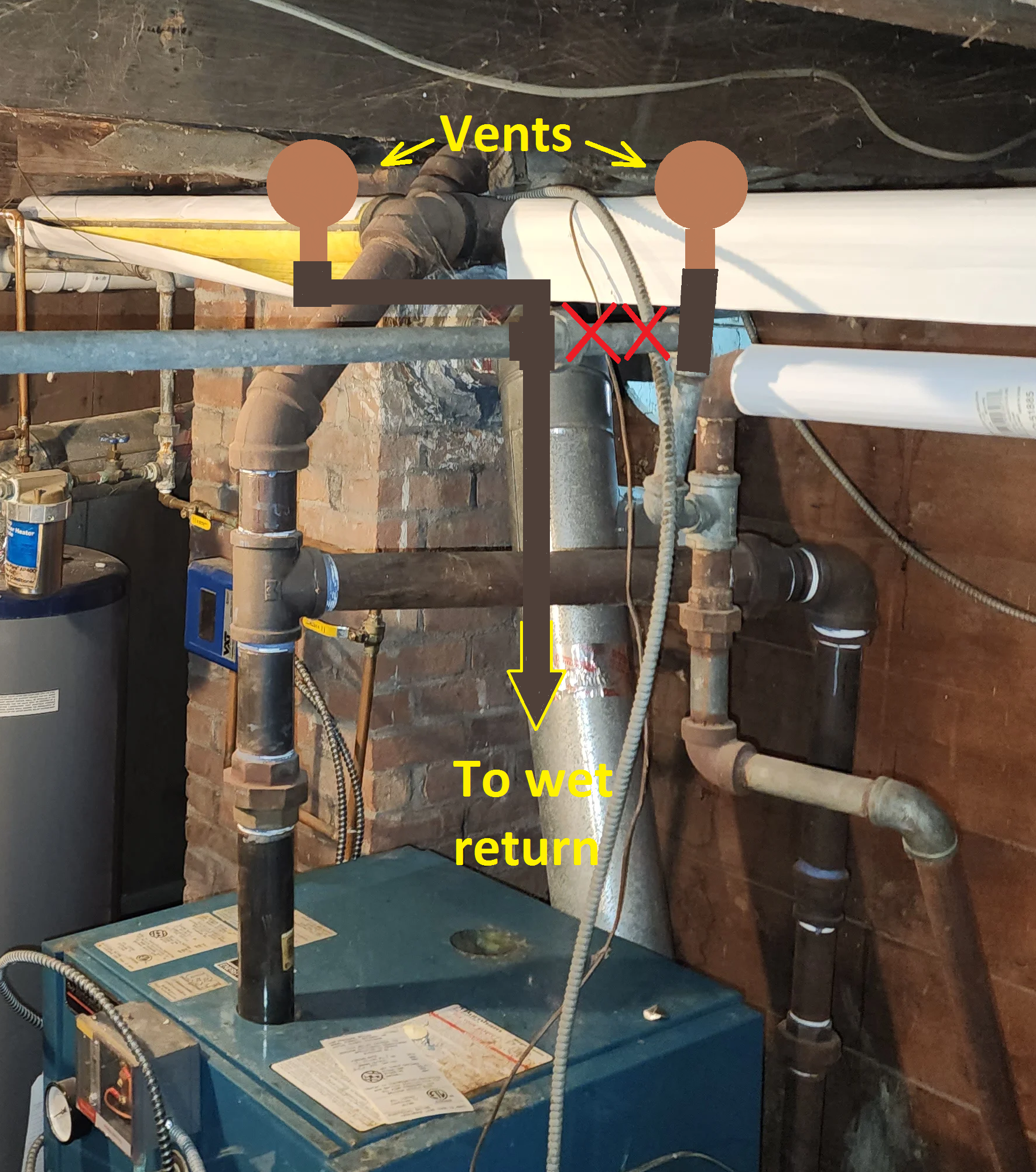

    Does the riser from the boiler split into two mains at the Red box ? Is the other ends of the mains at the Red arrows ? If so, if the two mains and radiator venting are not symmetrically equal as far as air venting and steam flow, air may be trapped in the actual functional farthest part of the system until it is hopefully vented by the farthest radiator(s) venting the asymmetrical part of the system. Not an optimum configuration.
    I believe to avoid this issue the 'steam main extensions' should each have its own main vent (sized to balance the mains) and each (individually) should drop down to about the level of the bottom of the boiler then combined together (as a wet return) to go to the Hartford loop. Presently it is combined way above the water line where steam can flow from one 'steam main extension' into the other.
    mattmia2 Member Posts: 16,016
    didn't notice that but that is probably what happened to the vents, whoever didn't know what they were doing with replacing the boiler removed the vents in the dry returns at the boiler and connected them together above the water line.
  • cobyschaef
    The red box actually splits into 3. One feeds the radiator that is right above the boiler, only a few feet of pipe. The pipe to the right splits at the end and feeds 1 radiator on the 1st floor and 2 on the 2nd. The pipe to the left is the longest run and feeds 3 radiators, one splitting off and going to the other side of the house. And yes the red arrows are the wet returns.

    Did I count right, only 7 radiators ? Unless all your radiators are HUGE, with a boiler of 396 Sq. Ft. you are going to have a pressure issue (IMO). I suspect the boiler is grossly oversized for the connected radiation.

    Yes, only 7 radiators. I have not done an EDR but I suspect it's oversized, too. Unless it's causing major issues I don't plan to downsize until the boiler is truly ready to go. But, I'll cross that bridge when I come to it.

    As far as the main venting and drips for the 'steam main extensions' goes I'd probably do something like this. The longer main should be vented faster.
    as noted they must drop individually down to the wet return otherwise when steam reaches the end of the main and close one vent it will continue on to the other vent and also close it, preventing the slower main from completely venting which will make heating at the end of the slower main very slow.

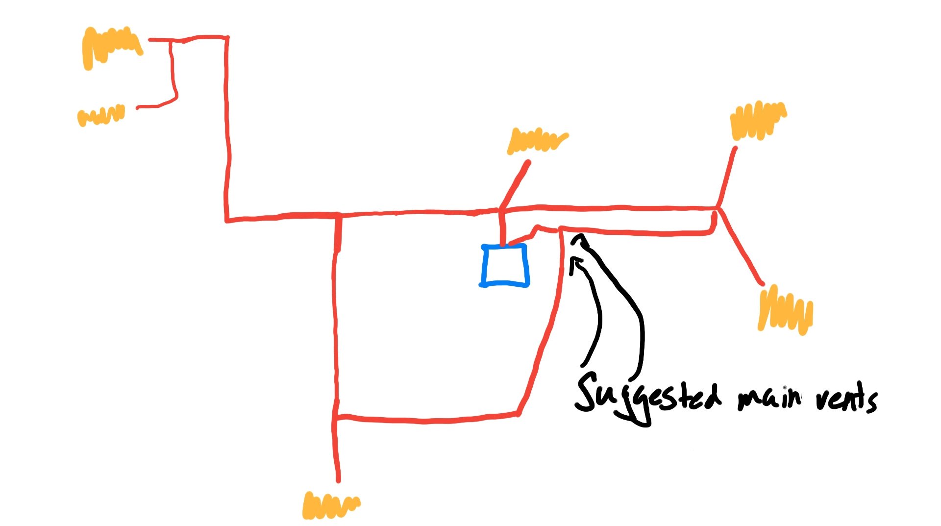

    All right so let me make sure I've got it correct, should those be my only main vents in the system? Here's a very crude rendering of my piping in the basement. The long leg on the top/left has no accessible fittings aside from elbows. And I should take that one pipe noted there and pipe it down to the wet return? In other words, instead of combining them as they are above the water line, combine them below the water line? Thanks for the help!
    edited October 2025
    The vent can be anywhere after the end of the main, they could be in multiple places at the same time but there is no benefit to that. what is critical is that the returns drop below the water line before they join together.
    There is a slight advantage in having the vents at the end of the mains instead of the end of the dry returns because the dry returns won't heat and lose a bit of heat to the basement if the vents are are at the ends of the mains, but i wouldn't worry about that. If the dry returns are vented then steam can get in to them and they will also be steam hot.

    The very end of the mains are steam isolated. The air is vented individually from each main. The main(s) venting (vent rate) is set up so the last radiator runout of each main gets steam at the same time or the main vents close at about the same time. Green path in the image is the air purge path of the mains. Modifying the very ends of the mains is probably the best place to get the most gain for the work.
    cobyschaef
    Here is an example of @EzzyT beautiful work. Green arrows air flow, Blue condensate. The actual vents are hidden behind the main pipes, the vent pipe on the right can be seen the left vent pipe is mostly behind the conduit. Two separate drips down to the wet return.

    Okay so assuming I wanted to correct the near boiler piping to be in line with what is shown in the manual, what would be the optimal way of connecting the main back in? Another crude rendering attached 🙂

    Personally if it was my boiler, I'd not mess with the boiler supply piping this time of year, getting the pipe plug out of the top of the boiler and reworking the mains into a new header may open up a can of worms.
    Presently I'd correct the venting and the gauge issue. Then see how it works. See how long it takes and when it builds significant pressure. If you still want to redo the supply side plan it out over the winter, then in the spring redo it when there it time to recover if something bad happens without being in a time panic with no heat.
    Although not optimum your supply piping may work reasonably well, mine is similar, been that way for 50 years and seems to work just fine. If my boiler failed I would change it then.
    Typically the boilers over a specific size have two or more risers that have swing joints then go into the header. A drop header is even better. Each steam main is individually connected to the header all in the correct order. This method reduces heat related expansion stress on the boiler section connections and helps dry the steam allowing gravity to separate out the water droplets. Review @EzzyT's postings (and others), many header examples.
