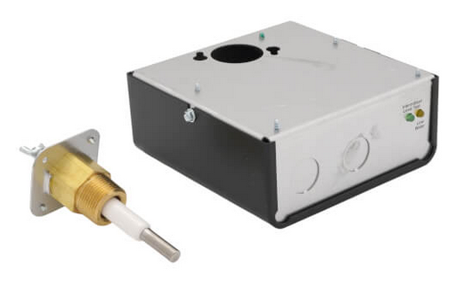

  • I'll have to get a few pictures in the morning. But I believe the LWCO will prevent me from turning the pigtail fully.
    Yes the radiator vents all open and close properly!
    109A_5 Posts: 4,761
    Depending on the LWCO you have, you may be able to remove the unit from the sensor to give you more room to deal with the pigtail. One example:

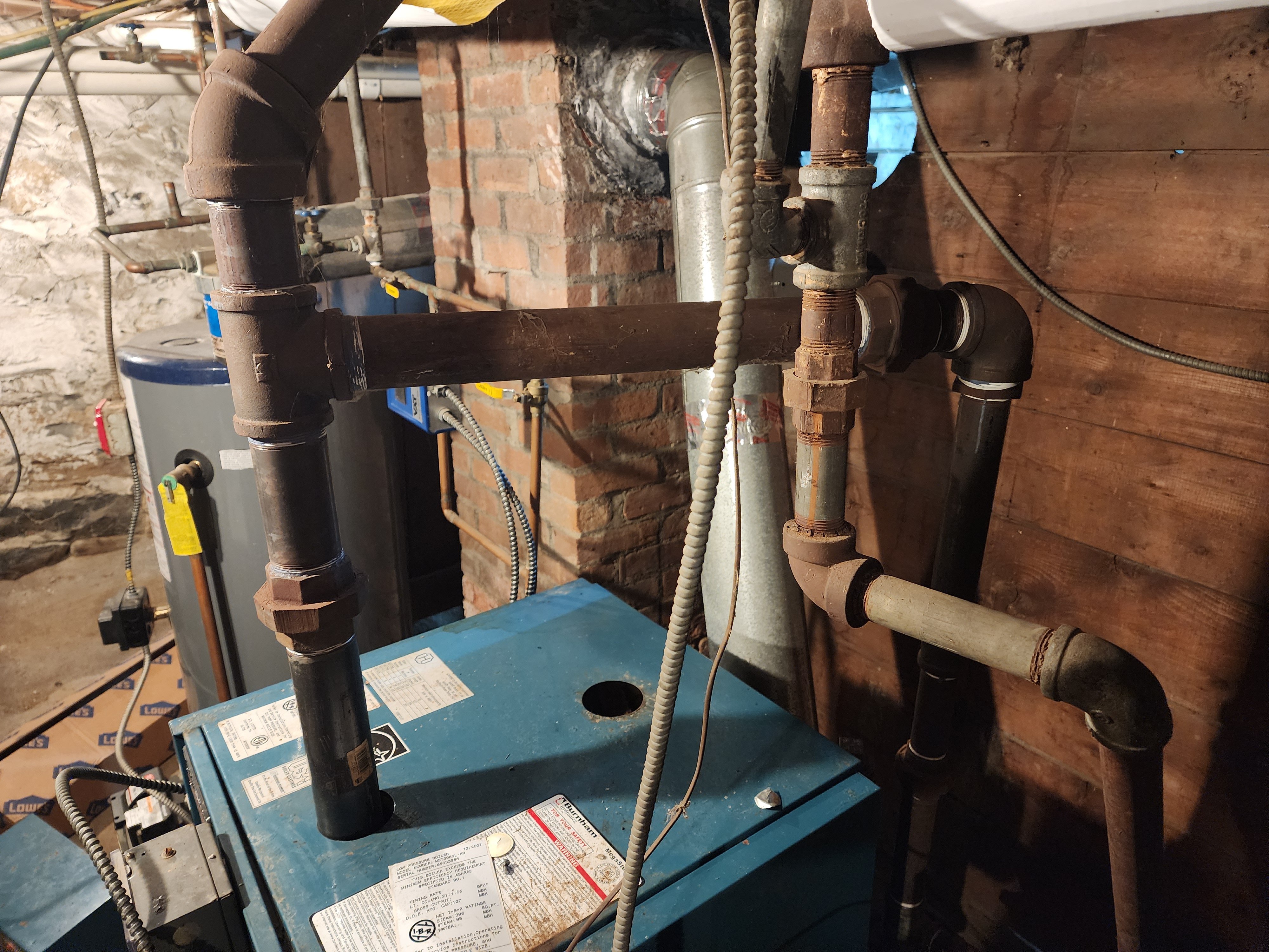

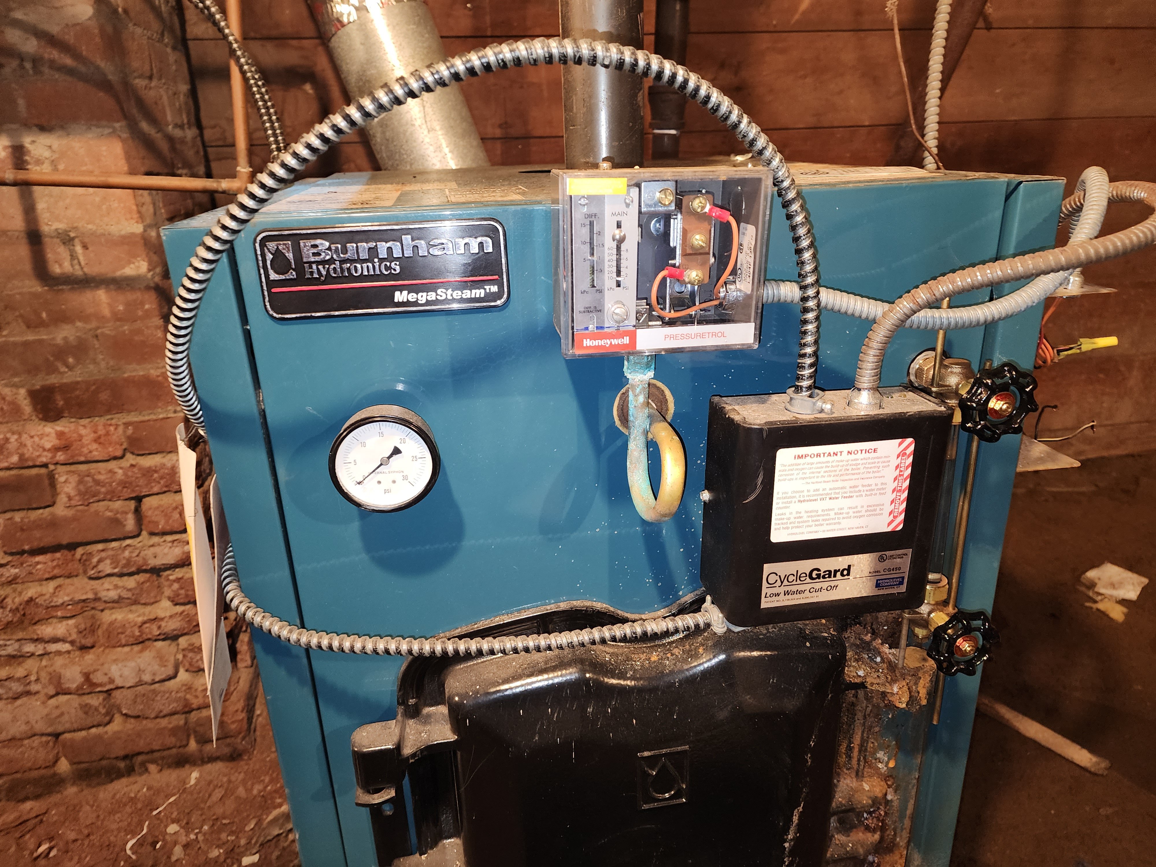

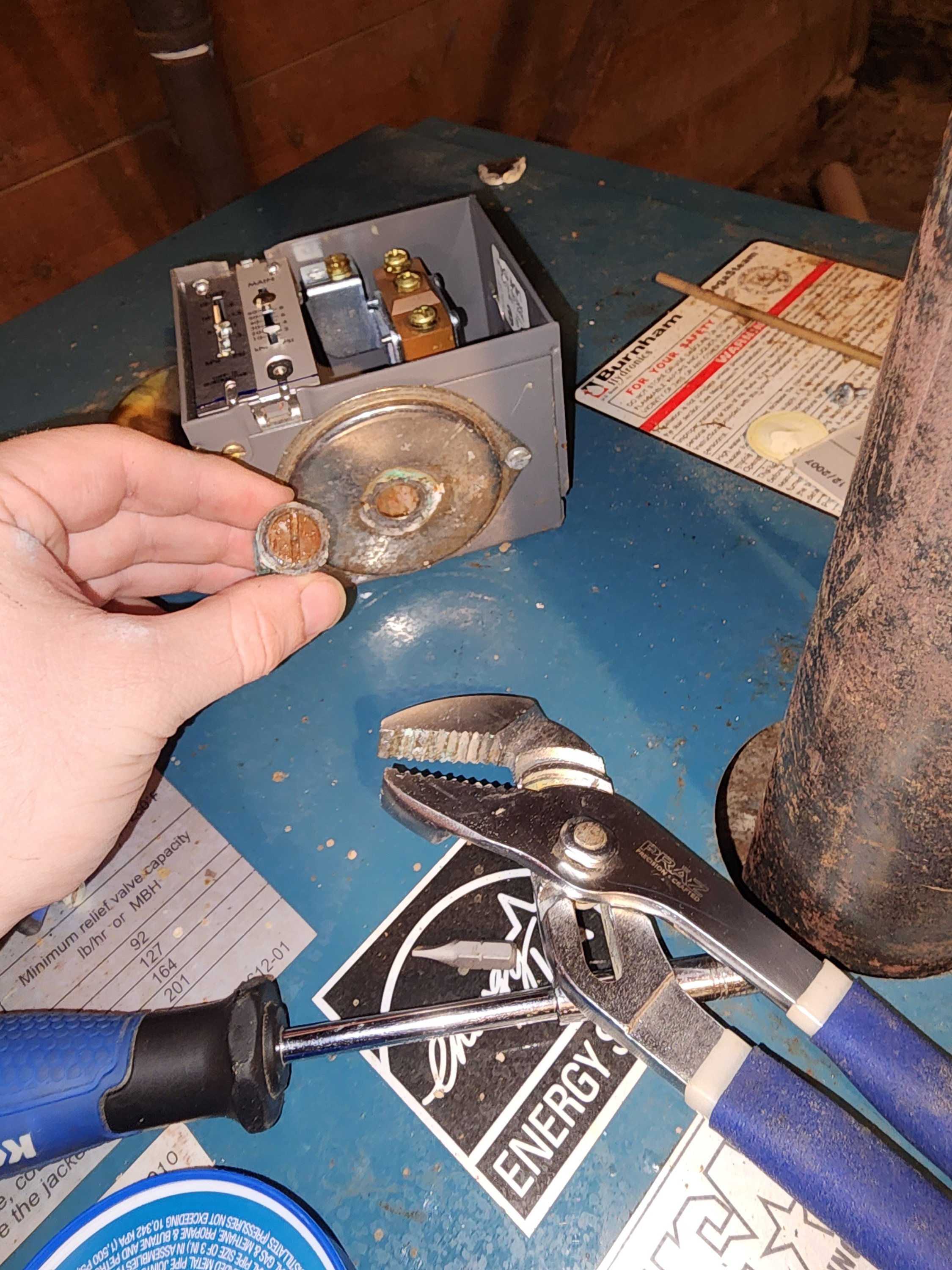

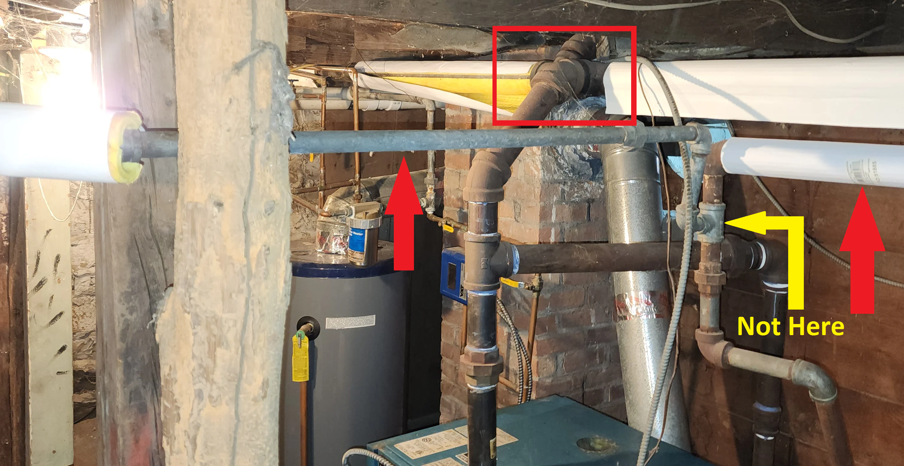

  • Here are some pictures, including some of the near boiler piping. I managed to get the pressuretrol off. Also I think I know why it wasn't working. When I went to turn the pigtail to remove the whole thing, the pressuretrol snapped right off. There was definitely some corrosion on it. So I'll be replacing that now 😅
    20251008_183452.jpg 20251008_131833.jpg 20251008_132009.jpg 20251008_132323.jpg
    Get a vaporstat and a low pressure gauge now that you have to replace it. that pigtail is brass.
    109A_5 Posts: 4,761
    Looks like it has been leaking for a while. The old version PA404A was brazed at the point it broke at.
    Steamhead Posts: 19,007
    That MegaSteam is an excellent boiler, but whoever installed it completely disregarded the piping instructions. Your system will run much better when it's repiped. What model is it- should be MST-something.

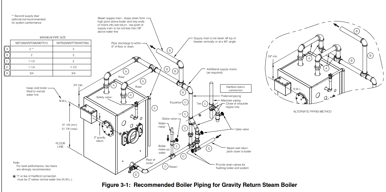

    109A_5 Posts: 4,761
    The manual shows how it should be done.
    https://s3-us-west-2.amazonaws.com/catsy.782/MegaSteam+IO+Manual.pdf

    I would note that it is piped very wrong but it might still work ok, if it works ok I wouldn't worry about it.
    I'd fix the venting and see what happens. It could just be lack of venting but it also could be water that isn't being separated because of the improper/nonexistent header keeping the steam from progressing out to the radiators where it can be consumed instead of building pressure.
    If the water line is unstable or there is banging then the near boiler piping definitely needs to be fixed.

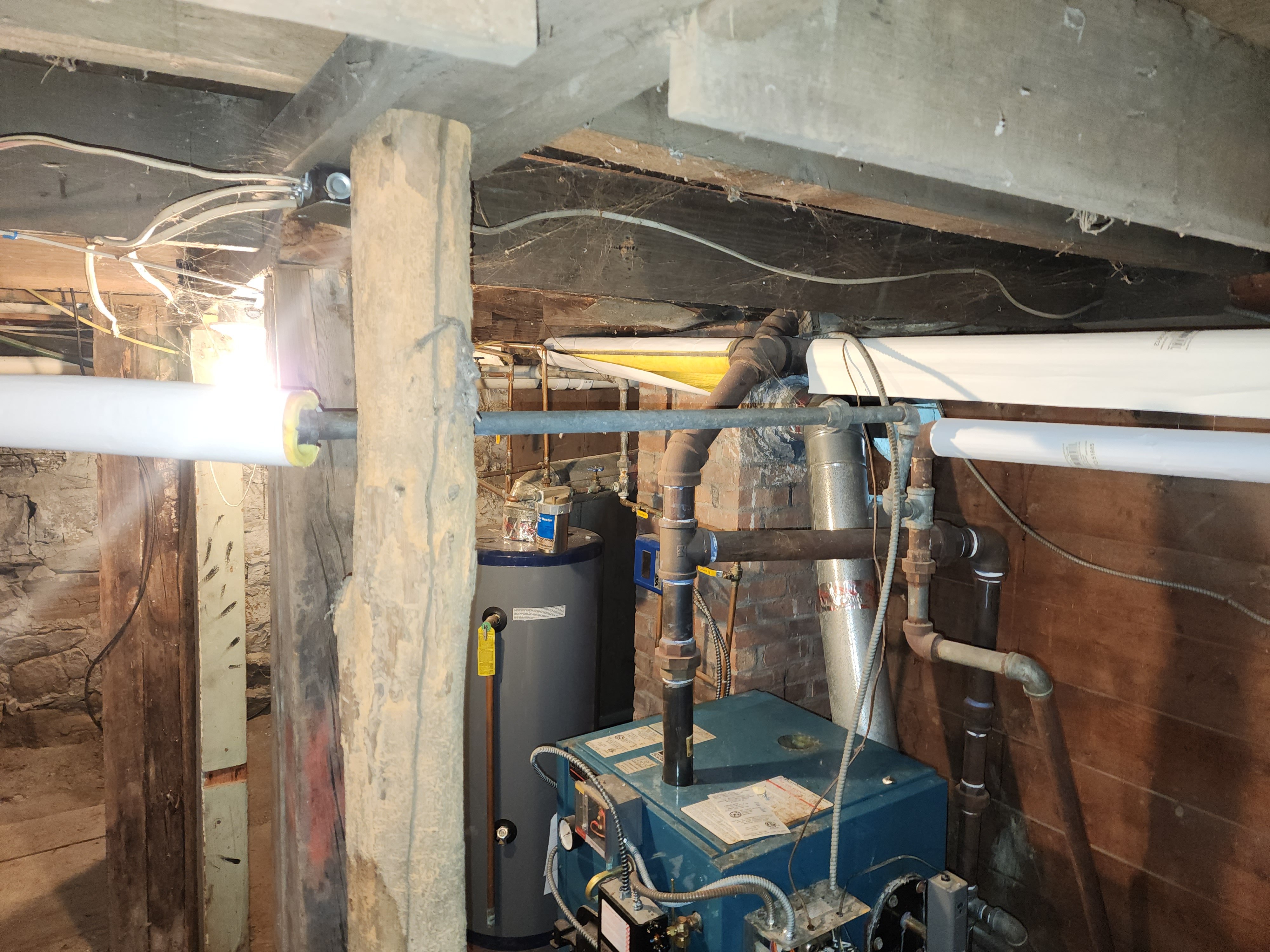

    Does the riser from the boiler split into two mains at the Red box ? Is the other ends of the mains at the Red arrows ? If so, if the two mains and radiator venting are not symmetrically equal as far as air venting and steam flow, air may be trapped in the actual functional farthest part of the system until it is hopefully vented by the farthest radiator(s) venting the asymmetrical part of the system. Not an optimum configuration.
    I believe to avoid this issue the 'steam main extensions' should each have its own main vent (sized to balance the mains) and each (individually) should drop down to about the level of the bottom of the boiler then combined together (as a wet return) to go to the Hartford loop. Presently it is combined way above the water line where steam can flow from one 'steam main extension' into the other.
    didn't notice that but that is probably what happened to the vents, whoever didn't know what they were doing with replacing the boiler removed the vents in the dry returns at the boiler and connected them together above the water line.
  • The red box actually splits into 3. One feeds the radiator that is right above the boiler, only a few feet of pipe. The pipe to the right splits at the end and feeds 1 radiator on the 1st floor and 2 on the 2nd. The pipe to the left is the longest run and feeds 3 radiators, one splitting off and going to the other side of the house. And yes the red arrows are the wet returns.
    those are dry returns. wet returns are below the water line.
  • My mistake. Terminology confusion. I was meaning that those pipes are the primary path the condensate is taking, at least for those mains. They combine and pipe into the wet return.

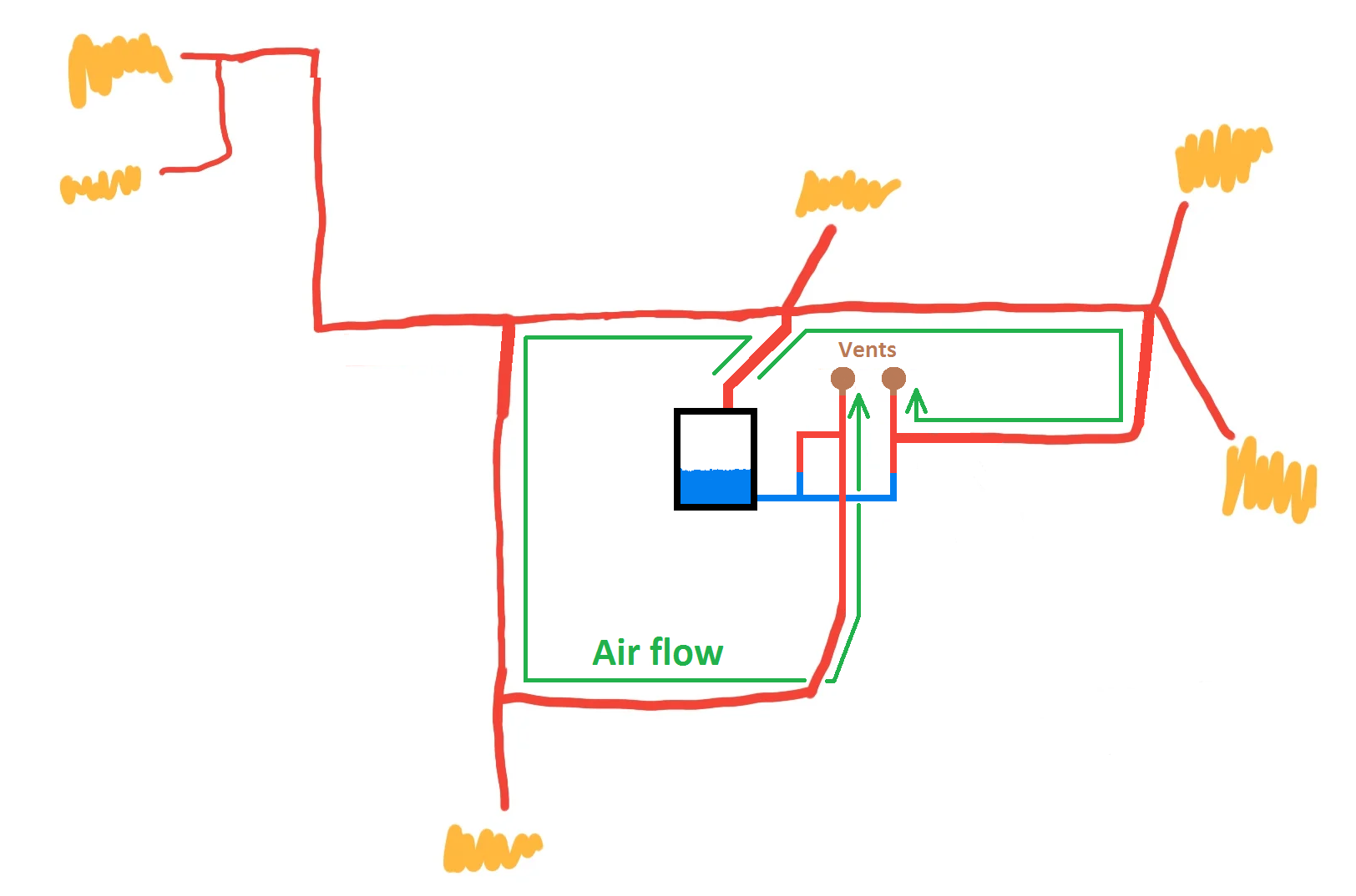

    As far as the main venting and drips for the 'steam main extensions' goes I'd probably do something like this. The longer main should be vented faster.
    as noted they must drop individually down to the wet return otherwise when steam reaches the end of the main and close one vent it will continue on to the other vent and also close it, preventing the slower main from completely venting which will make heating at the end of the slower main very slow.
  • All right so let me make sure I've got it correct, should those be my only main vents in the system? Here's a very crude rendering of my piping in the basement. The long leg on the top/left has no accessible fittings aside from elbows. And I should take that one pipe noted there and pipe it down to the wet return? In other words, instead of combining them as they are above the water line, combine them below the water line? Thanks for the help!
    edited October 2025
    The vent can be anywhere after the end of the main, they could be in multiple places at the same time but there is no benefit to that. what is critical is that the returns drop below the water line before they join together.
    There is a slight advantage in having the vents at the end of the mains instead of the end of the dry returns because the dry returns won't heat and lose a bit of heat to the basement if the vents are are at the ends of the mains, but i wouldn't worry about that. If the dry returns are vented then steam can get in to them and they will also be steam hot.
    On the other hand if the vents are at the boiler rather than off in some dark corner of the basement, they are less likely to get forgotten about.

    The very end of the mains are steam isolated. The air is vented individually from each main. The main(s) venting (vent rate) is set up so the last radiator runout of each main gets steam at the same time or the main vents close at about the same time. Green path in the image is the air purge path of the mains. Modifying the very ends of the mains is probably the best place to get the most gain for the work.
    cobyschaef
    109A_5 Posts: 4,761
    Here is an example of @EzzyT beautiful work. Green arrows air flow, Blue condensate. The actual vents are hidden behind the main pipes, the vent pipe on the right can be seen the left vent pipe is mostly behind the conduit. Two separate drips down to the wet return.
