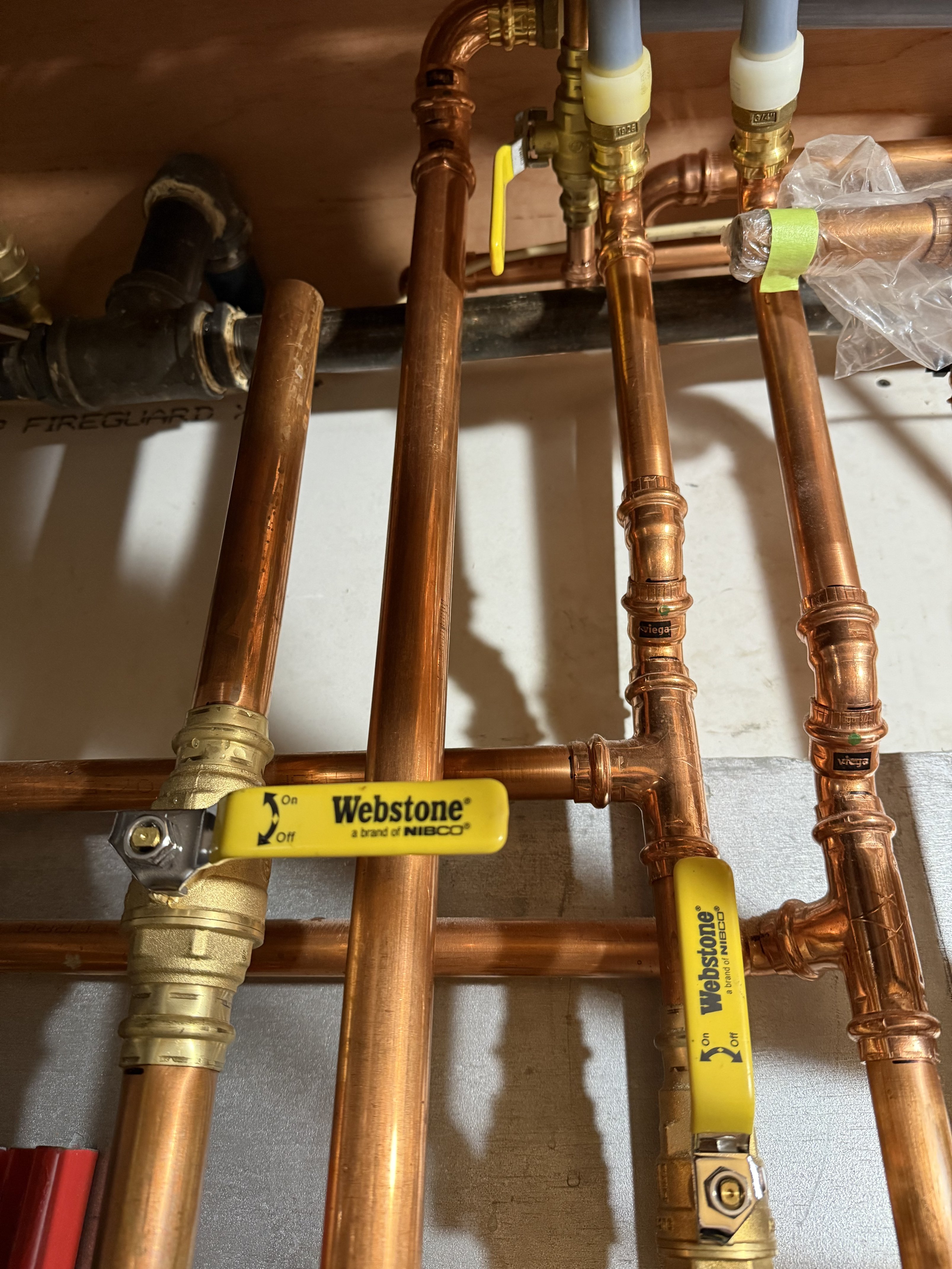

Anyone know about disassembly of these full-port Webstone (Nibco) ball valves?
rossn
rossn Member Posts: 136
edited September 2025 in THE MAIN WALL
I'm repairing a leaking press fitting that was introducing air into the hydronic system.
I cut it out using a Milwaukee close quarters cutter, and want to ream the pipe without fear of a copper shaving falling down into the vertical section and damaging the pump.
I was thinking to disassemble the top and bottom half of the ball, but wasn't sure if that's asking for trouble long-term. Alternatively, I can stuff some blue paper towel down there.
Anyone taken apart the two halves of the valve like the one shown on the left and is it a no-brainer to re-assemble or will I be more at risk for leaks (or be in for some other surprise)?
Tried to reach out to Nibco without any response for 2 days.
    EdTheHeaterMan Member Posts: 11,752
    Why would one need to be disassembled? Are they not a one time use when set with a press tool?
    Intplm.
    Jamie Hall Member Posts: 27,005
    That would surely be doing it the hard way. Stuff. Firmly. Your paper towel in there and you should be fine. Pull it out in a wad, though, not sort of by one corner…
    rossn
    hot_rod Member Posts: 27,072
    ball valves are assembled with Loctite, or a similar “glue” they are not so easy to disassemble without damaging them.
    Higher end valves are being laser welded more often now
    Mad Dog_2GGrossrossn
  • rossn
    @EdTheHeaterMan - in my case, just curious if it's a safer approach to keep out reamer shavings… sometimes I get a single curly-q, but not always, esp. when it's up near that gas pipe and more difficult to do so (vertically). Once one end is cut out, it's only press fixed on one end.
    @Jamie Hall - that's what my gut was saying, but if easy to disassemble/reassemble, didn't want to feel silly doing it a different way. Suffing will be the way I go. I figure someone probably makes some silicone insert that looks like an inverted plunger. If not, there's a new tool. But blue paper towel is readily available :)
    @hot_rod - read you loud and clear… not the way to go. Thanks for sharing that context.
    Saw the wrench flats, and had to ask. Thanks everyone!

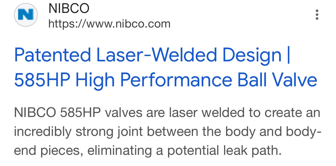

    what would be welded on the ball? It’s a hollow ball with a slot for the stem to engage
    It’s the assembly seams that are welded, according to Nibco

    What I make if this is that the valve is not a Nibco 585HP valve.
    I agree with @Intplm. low on the 2 DO list. maybe a little wire brushing every year or so is all I might do in your case. If it gets worse, then replace it at that time.
