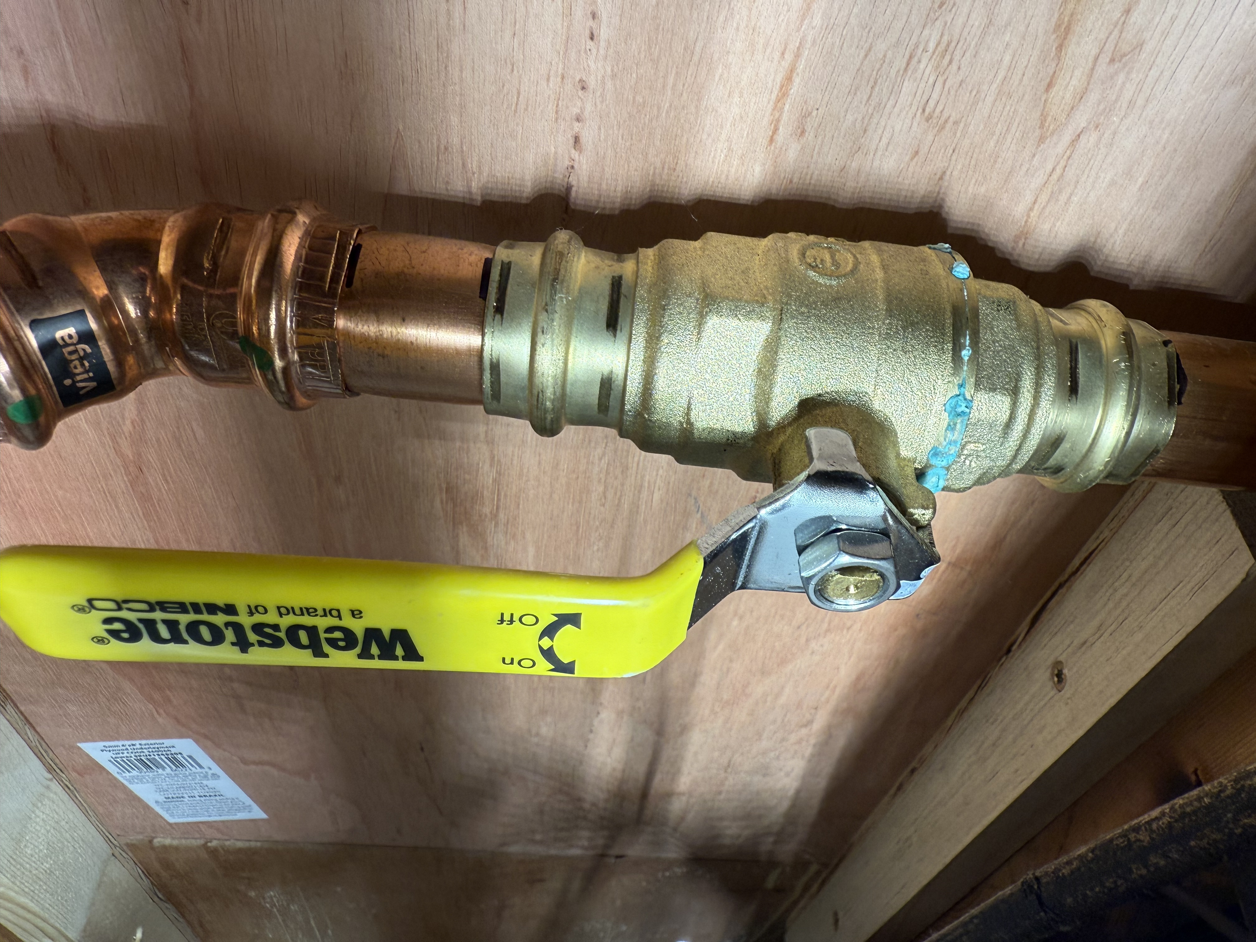

    Ok, so since we started talking about these ball valves, I had an unfriendly discovery. This is on the potable cold water supply - the valve shuts off half of the house.
    What do you all make of this? Maybe 4 years old.
    Obviously leaking at the valve assembly point. Now unfortunately you have an expensive piece of propress junk. With propress its probably $30-$40 worth of fittings to scrap
    Intplm.
    Intplm. Posts: 3,162
    I've seen leaks like this last for decades. The thing will probably heal with corrosion before it begins to drip water physically.
    @rossn Repairing this depends on your comfort level. If it were mine, I'd list it at a lower point on my to-do list.
    Alan (California Radiant) ForbesPC7060rossn
  • What I make if this is that the valve is not a Nibco 585HP valve.
    I agree with @Intplm. low on the 2 DO list. maybe a little wire brushing every year or so is all I might do in your case. If it gets worse, then replace it at that time.

    The valve is fully accessible in the mechanical space, just up in joist space, backing up 1/4" from plywood and over a top plate of the wall - so it's very difficult to do any work without cutting the tubing from the adjacent room.
    if you used an npt valve with press adapters, you could cut the part of the pipe you can get to and unscrew the valve from the press fitting on the pipe you can't get to.

    you had a valve with a bad assembly seam, it happens, maybe more-so with some imports.

    For what it’s worth, green self wicking locktite 290 is approved for potable applications; I’ve used to seal similar leaks is sweated ball valves that were overheated during install. 🥸
    But I think that unit has self sealed and I’d leave alone. No risk of catastrophic failure.

    no problem. Need to take pressure off the line first if it’s an active leaker. Heating the section will speed cure time.

    Most ball valves are assembled with Loctite or a similar aerobic product. I have seen green and blue colored product used. At Caleffi we assemble brass components with red Loctite 545 or 272.
    There is not much of a thread to seal and hold a ball valve together, very little on the "value engineered" valve products.
    To disassemble a Loctite joint heat with a torch to soften and it will come apart easily

    Just had a job where I used use of Locktite to seal slow drip on nibco ball valve. Steps are:
    Drain system enough to remove pressure from valve
    Clean all corrosions off valve body
    Heat valve body with torch for short period to drive off water
    Apply locktite 290 sealant; I find a couple drips on top will flow around entire joint on horizontally mounted valve
    Wait 5 minutes and reheat for short period for to cure Loctite
    Apply pressure.
