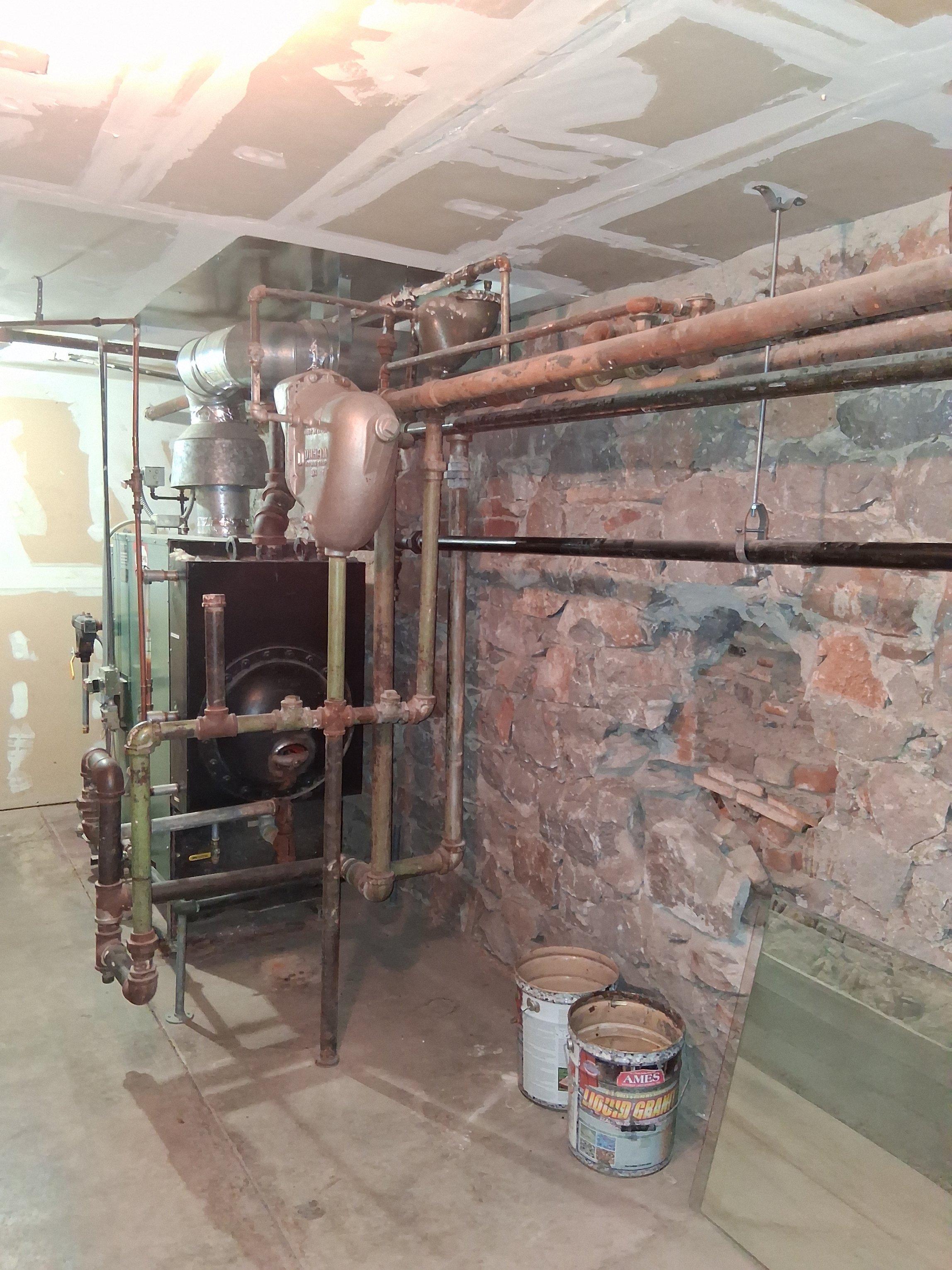

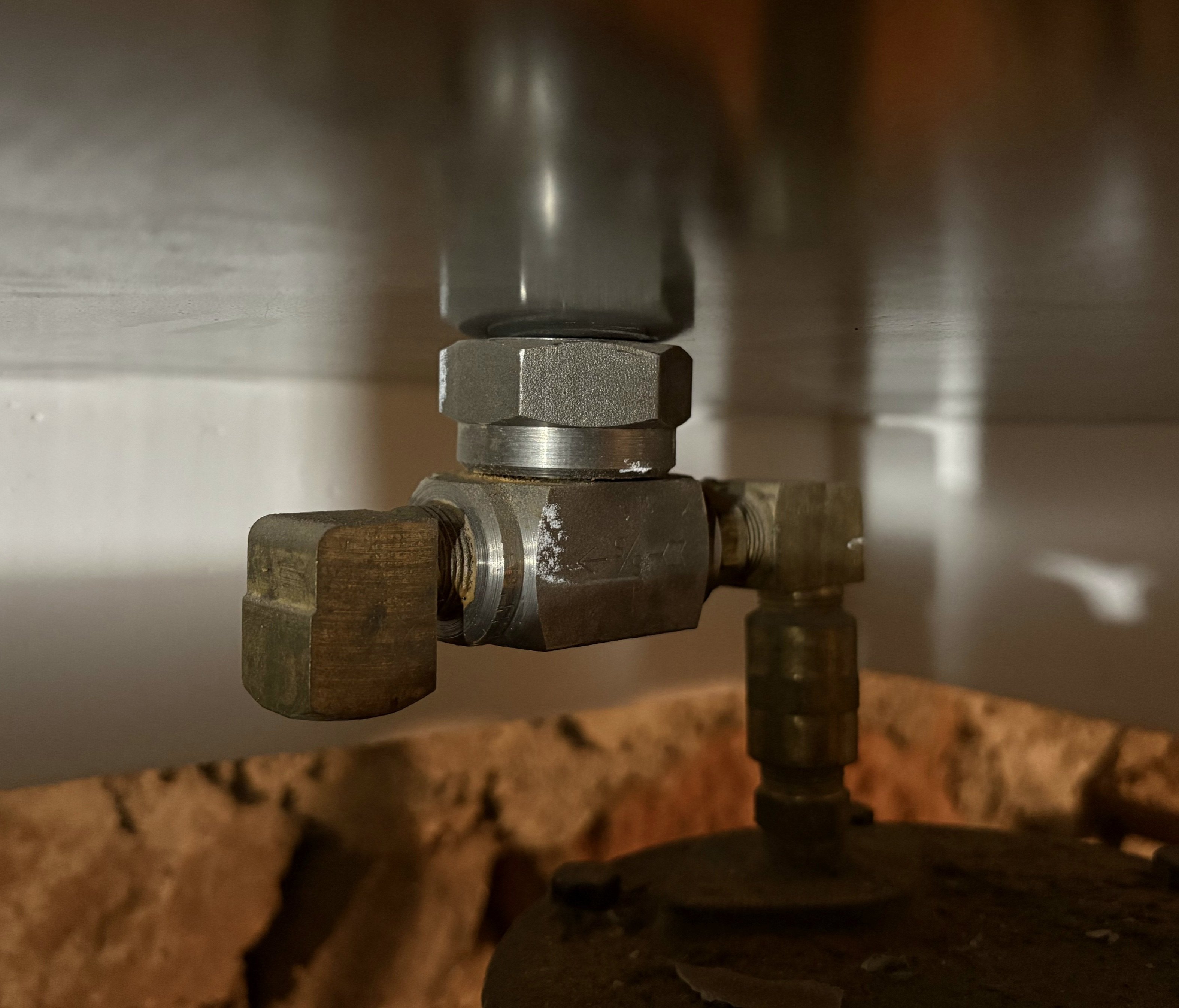

    Not sure what that is. He had to raise that ceiling as part of the boiler recertification

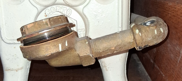

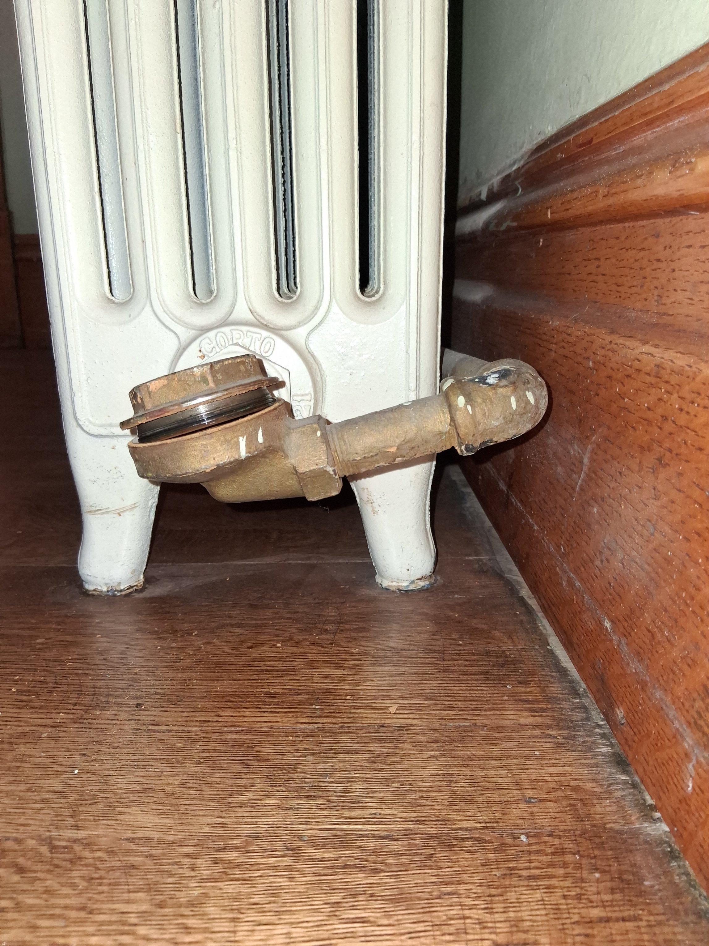

    Look at the return angle on this rad. He says it heats up fine, how is that possible?

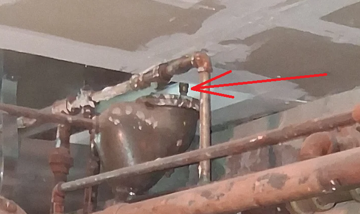

    I think that is a check valve on the vent trap.
    If there is enough differential between the supply and return it will push the air through the water although that won't happen until the boiler heats enough to build pressure so this radiator likely won't start heating until late in the cycle and if the system is building that much pressure the orifices might not limit the steam to what the radiator can condense(although that is only an inch or 2 wc.). I am pretty sure the controls on the boiler are pressuretrols that are not precise enough to limit the pressure to vapor levels.
    All that being said, you can probably tweak that pipe to get it all heading down hill.

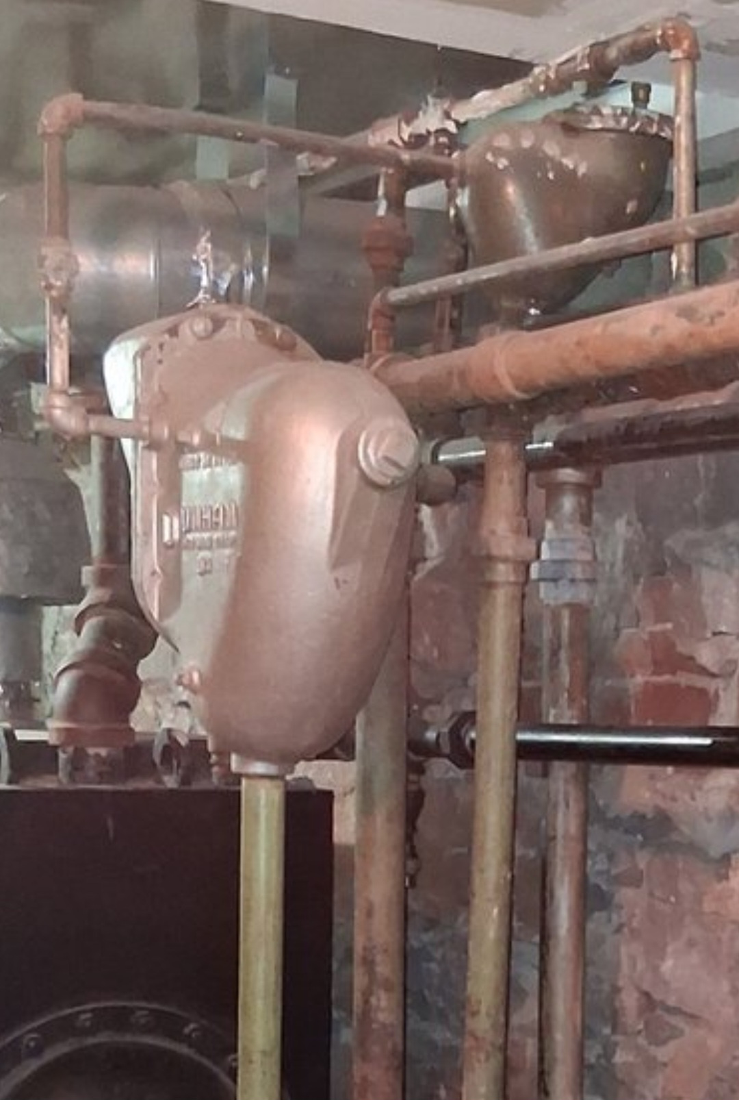

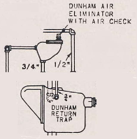

    I believe your friend's system is a blend of the equipment found on page 12 of the document (page 14 of the PDF) and page 61 of the document (page 62 of the PDF) mentioned above and here.
    https://heatinghelp.com/assets/documents/dunham.pdf
    Yes traps should be checked for proper functionality an incorrect pipe pitch should be corrected.
    Upon inspection you may find this is the only vent or vent pipe in the system.

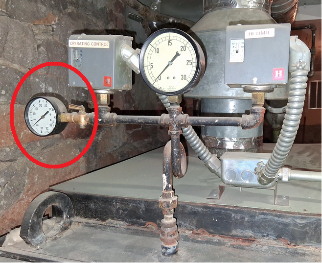

    Does this gauge work ? Notice the vacuum part of the gauge.
    I bet when this system was working correctly (and was air tight) it would fall into a vacuum between heating cycles so the need for significant venting to get the air out with every cycle was not needed. Since between heating cycles the majority of the air is not let back into the system, hence the vacuum generated.
    Does your system still have the Dunham Air Eliminator with Air Check and the Dunham Return Trap ?

    "Does your system still have the Dunham Air Eliminator with Air Check and the Dunham Return Trap ?"
    Pretty sure they're still there and connected. Don't know if they work though. That is not a vent you pointed out with arrow, just a check valve. Regarding that gauge you circled, i will be replacing that with a 0-3 psi unit... that gauge has to be broken. The system has not been on yet this season and all the trap lids have been removed when this was taken.

    Looks like a check valve to me, see the arrow. Hopefully the crack pressure is less than 1 inch of Water column. To purge the air, if fuel is burned to build pressure to overcome too high a crack pressure of an inappropriately high crack pressure check valve, that is a waste.

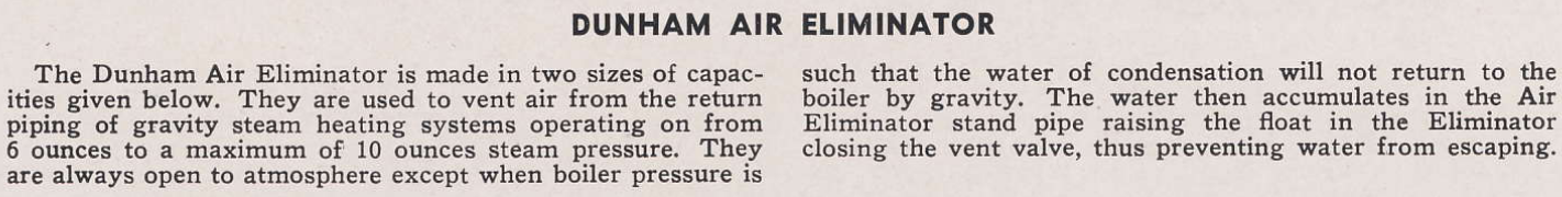

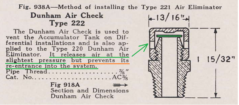

    The Dunham Air Eliminator with Air Check is the functional equivalent of a Vacuum Vent, which lets air out but not back in with a very low vent crack pressure. The air check is on top, however that does not look original. Your Gorton vents (on your system) let the air back in, only to be pushed back out with the next heating cycle, burning fuel to do it.
    I'd replace the gauge with the same type to see if there is any vacuum, if you want to add a low pressure gauge in addition that is OK.

    Yes. That's was Mattmia2 guessed. I'll ask my friend to check that crack pressure rating
    How do we check if the Dunham Air Eliminator with Air Check and the Dunham Return Trap are working?

    Without, disassembly cleaning / rebuilding, etc. system performance and system pressure / vacuum. I would expect to see a vacuum, but if you don't have a working vacuum gauge or a Manometer you can't monitor that characteristic.

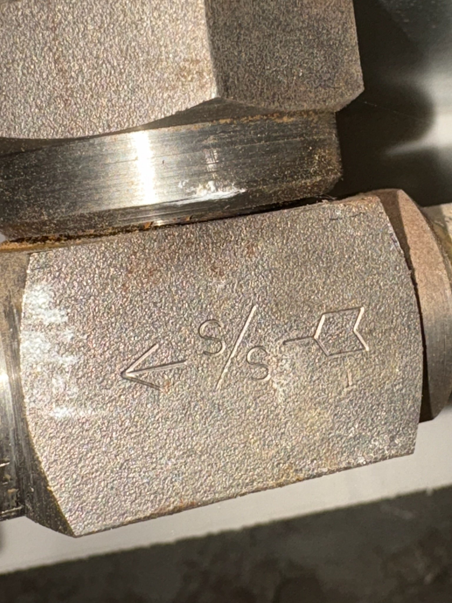

    Was just going to add: i didnt realize, until i zoomed in, that the indicator was pointing to zero on the vacuum dial so it may work. Won't know until we fire it up this season.
    This help? Otherwise need to take it down to look for other markings

    This type of valve takes very little pressure to vent. No spring just gravity pulling down on the weigh of that little disk. I'll see if I can find any info on that check valve in the system.
    Looks like the system may be designed to run at 10 Oz. or less.
    With the design of these systems steam probably never gets to the Air eliminator.

    I found two names associated with a very similar check valve Swagelok and Nupro and the one spec page does mention gravity, but sadly they don't mention the crack pressure, just what I believe is maximum working pressure. I'd see what the system does, pressure / vacuum and heating performance in general.

    If that were true then how did this rad heat up? Wouldn't you need substantial pressure to push through the condensate?
    Bryant 245-8, 430k btu, 2-pipe steam in a 1930s 6-unit 1-story apt building in the NM mountains. 26 radiators 3800sqf
    109A_5 Member Posts: 4,078
    Maybe 1 inch, 2 at the most. 2 inches of water column is not much pressure (1.16 Oz, 0.072 PSIG). The air would push through if the differential pressure was there. Really the air just needs to push through at the arrow
    Still should be corrected.

    Is there a union between the trap and the radiator ?
    If not, I'm having second thoughts. I know I said " Still should be corrected. " and it should…..
    However, if you put the big wrench on it to turn it 15 degrees and something breaks you are probably in for a lot more work. Work that may require some serious finesse.
    Maybe when originally assembled it got to a point where it got real tight so they stopped, and since it worked they left well enough alone. You may already realize that.

    Correct on the Dunham Air Eliminator. It — and a number of other gadgets patented by ingenious folk (like the Hoffman Differential Loop!) did exactly as you say — they worked by ensuring, in one way or another, that the pressure differential between the steam mains and the returns never got over a particular value (usually around 12 to 18 inches of water — half a pound pressure). This ensured that the boiler water never backed into the dry returns, which would have possibly dry fired the boiler. You have to remember that coal fired boilers were susceptible to being over-fired by the enthusiastic, and there was no vapourstat to calm them down!
    But — this is why the only vent on the system had to be at the gadget, because part of the game was allowing some steam into the dry returns if the pressure differential got too high. That vent had to close in that situation (normally it would never close) so that the steam could pressurize the dry returns.

    that valve looks pretty new as does the sheet metal. What’s the purpose of the sheet metal; part of a plenum?
    mattmia2 Member Posts: 16,895
    Probably fire resistance. Some jurisdictions require a fire resistant barrier above central heating equipment, probably left over from solid fuel and very old oil and gas equipment.

    Bingo. Was required for recertification of the boiler room after having sat unused for so long.

    Or it may be this . . . Even though it only needs to be a check valve and this may not have any check valve functionality.

    Today we fired up the boiler for the first time after fixing all of the radiator pitches and replacing all of the rad and crossover traps.
    Pressure stayed steady at about 0.5psi until the thermostat reached temperature. All the rads heated up nicely, no strange noises or leaks. I think we're all good. Thanks
