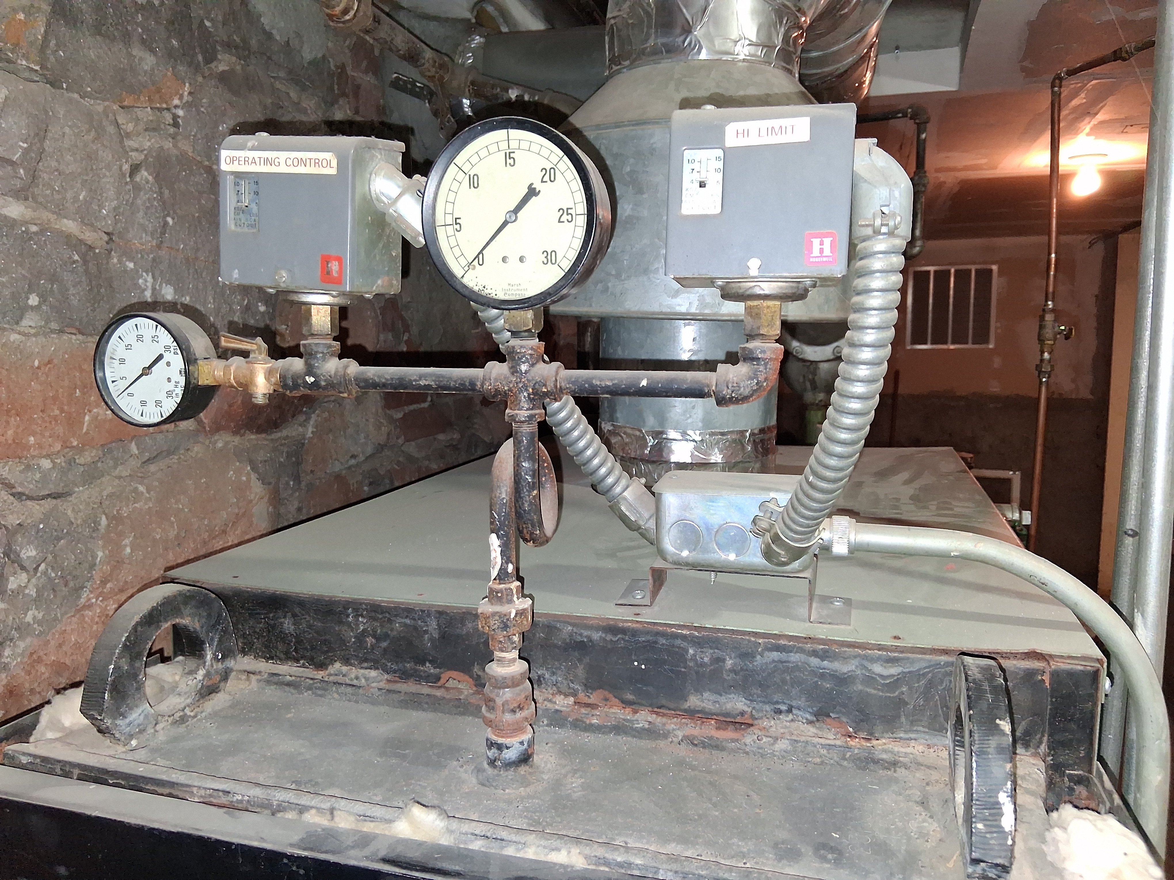

    If the main vent is not at that equalizer device (and that device can just be a loop of pipe of a specific height), if it lets steam in to the returns to equalize the differential pressure and the only vent is not at that device, that steam can follow the returns to other vents and cause all the problems associated with steam in the returns like emitters that don't heat because they can't vent and water hammer.
    This is why you must make sure there isn't an equalizer device at the boiler(or somewhere else in the system, there is no reason it has to be at the boiler, it just usually is) before you add main vents to a 2 pipe system that did not originally have main vents.

    It wasn't the intent of this post but I'll just take some near boiler pics for you guys to look at when I go back to start changing the traps.

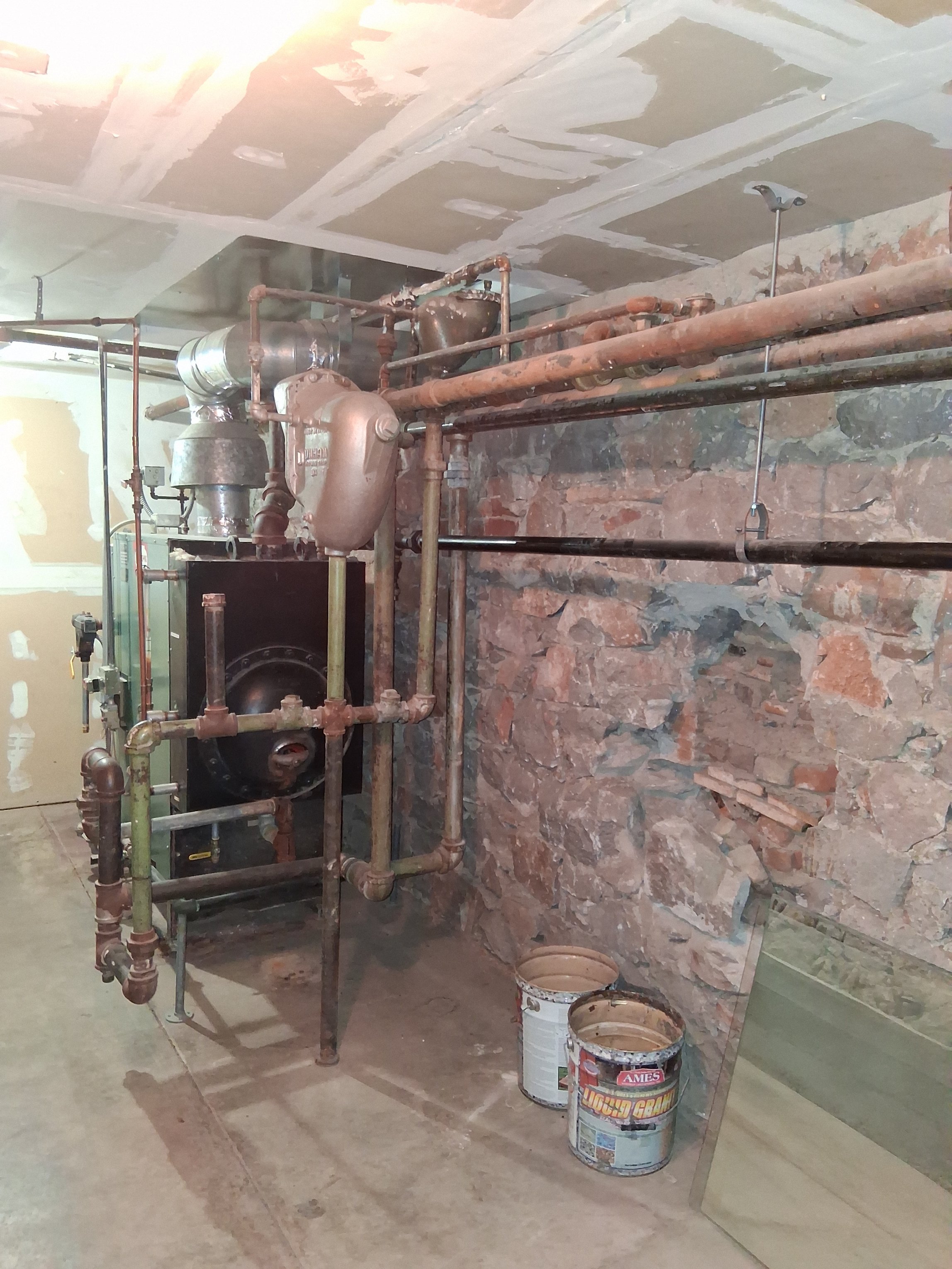

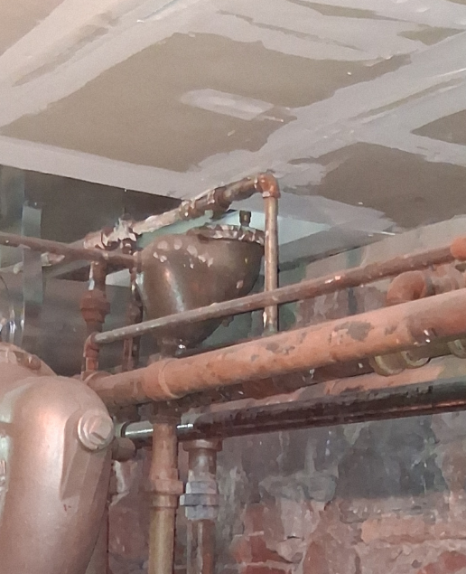

    To me with the picture below is seems something else may have been there, the Tee (other equipment connected, now removed) and the galvanized pipe added as a plug. Or that is just what they had handy to add that vent. Those ball valves are not 100 years old.

    What was this pipe for ? Probably not for venting but it looks abandoned.

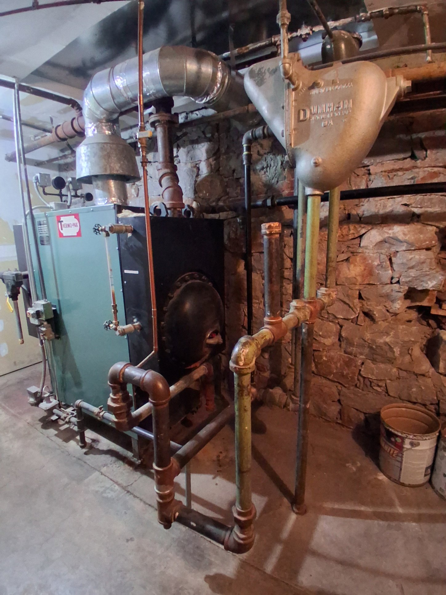

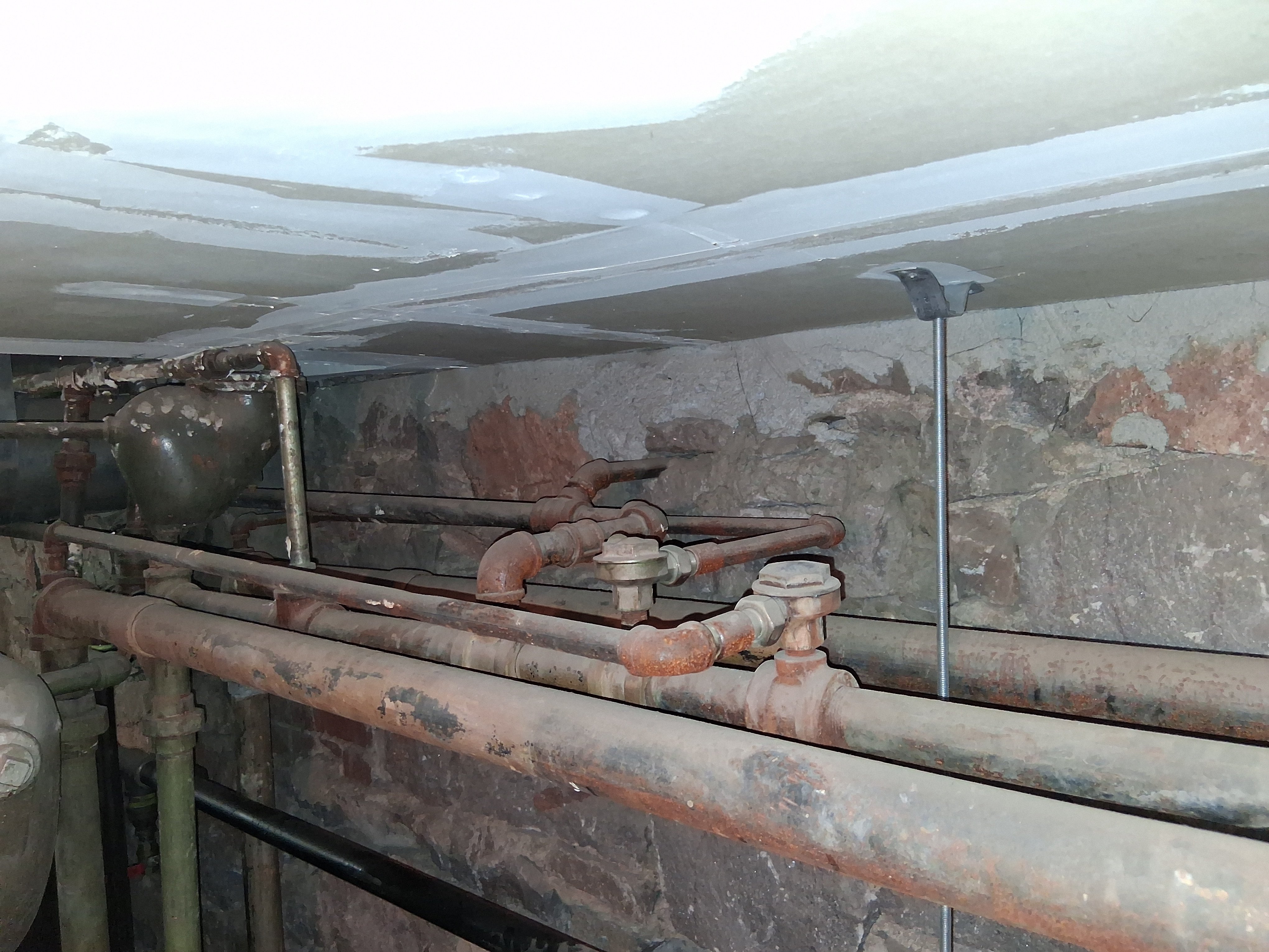

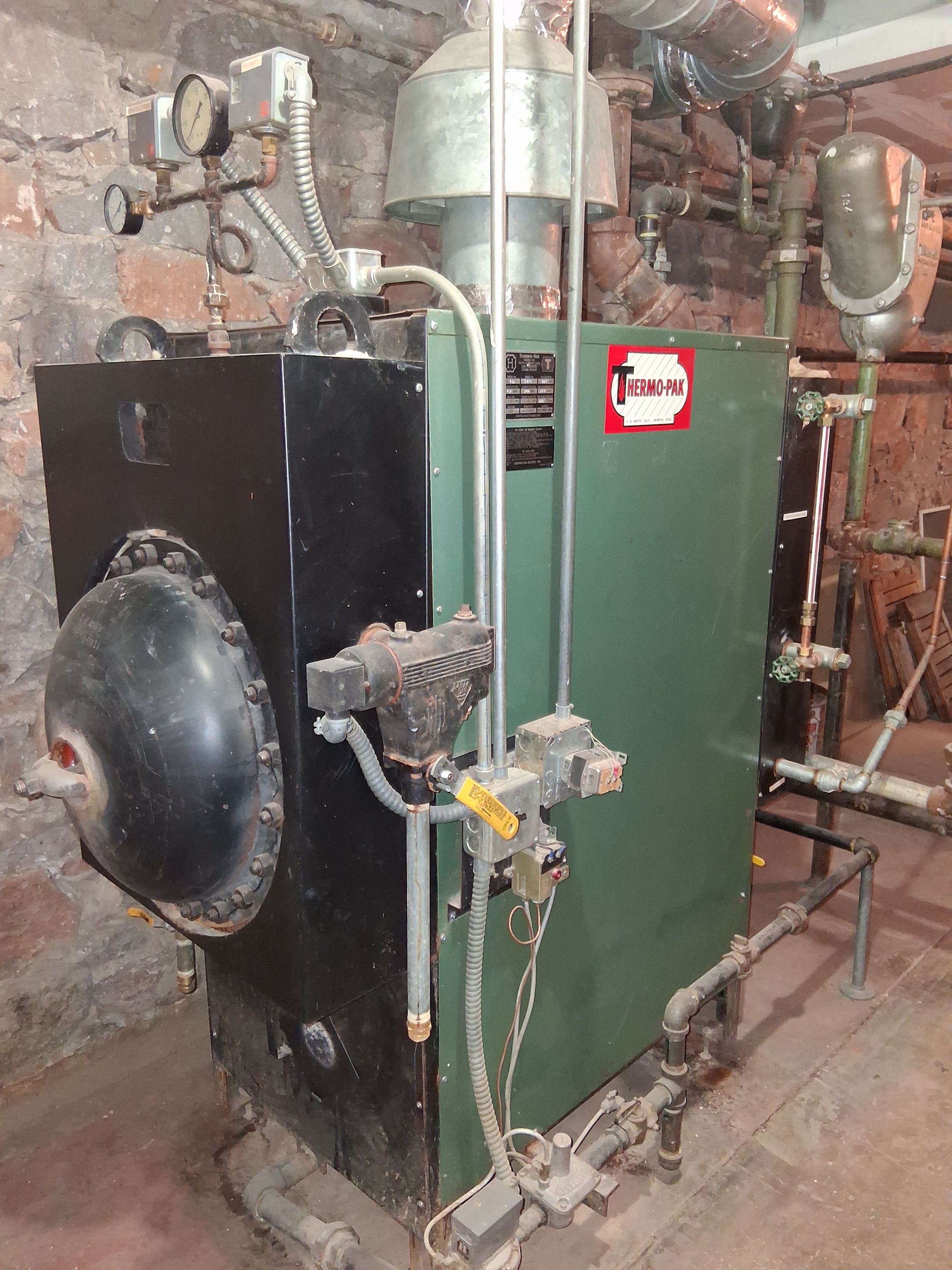

    Taking inventory of the traps today, here are some pics of his beautiful boiler, crossovers etc:

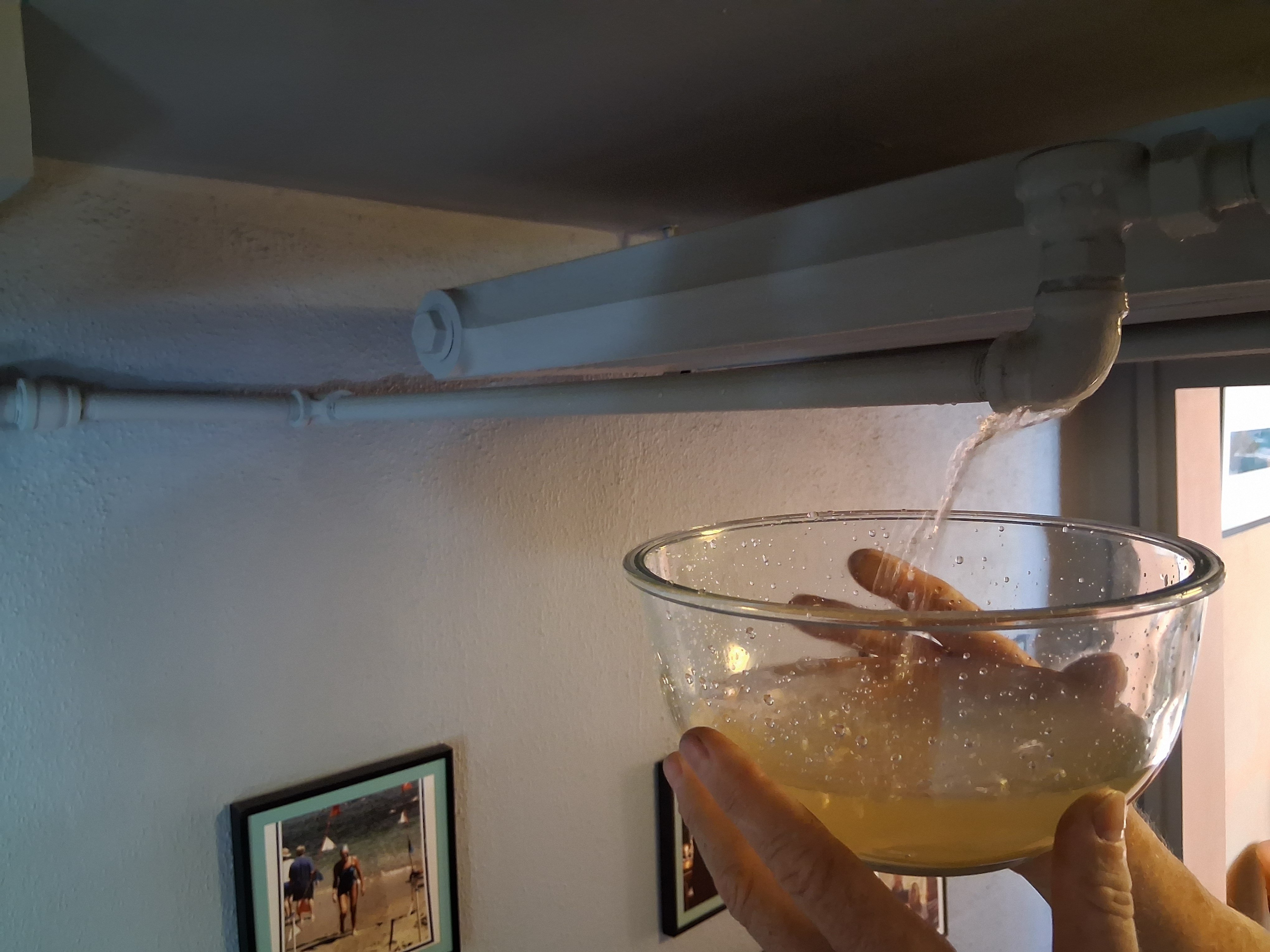

    The return pipe on this ceiling rad was piped going uphill, almost 5 gallons of water drained out of it:
    Taking the valve apart next. Ordering new traps and checking everything with a level.
    Bryant 245-8, 430k btu, 2-pipe steam in a 1930s 6-unit 1-story apt building in the NM mountains. 26 radiators 3800sqf
    i don't think there should be water there….
    Is there a vent in the top of this?
