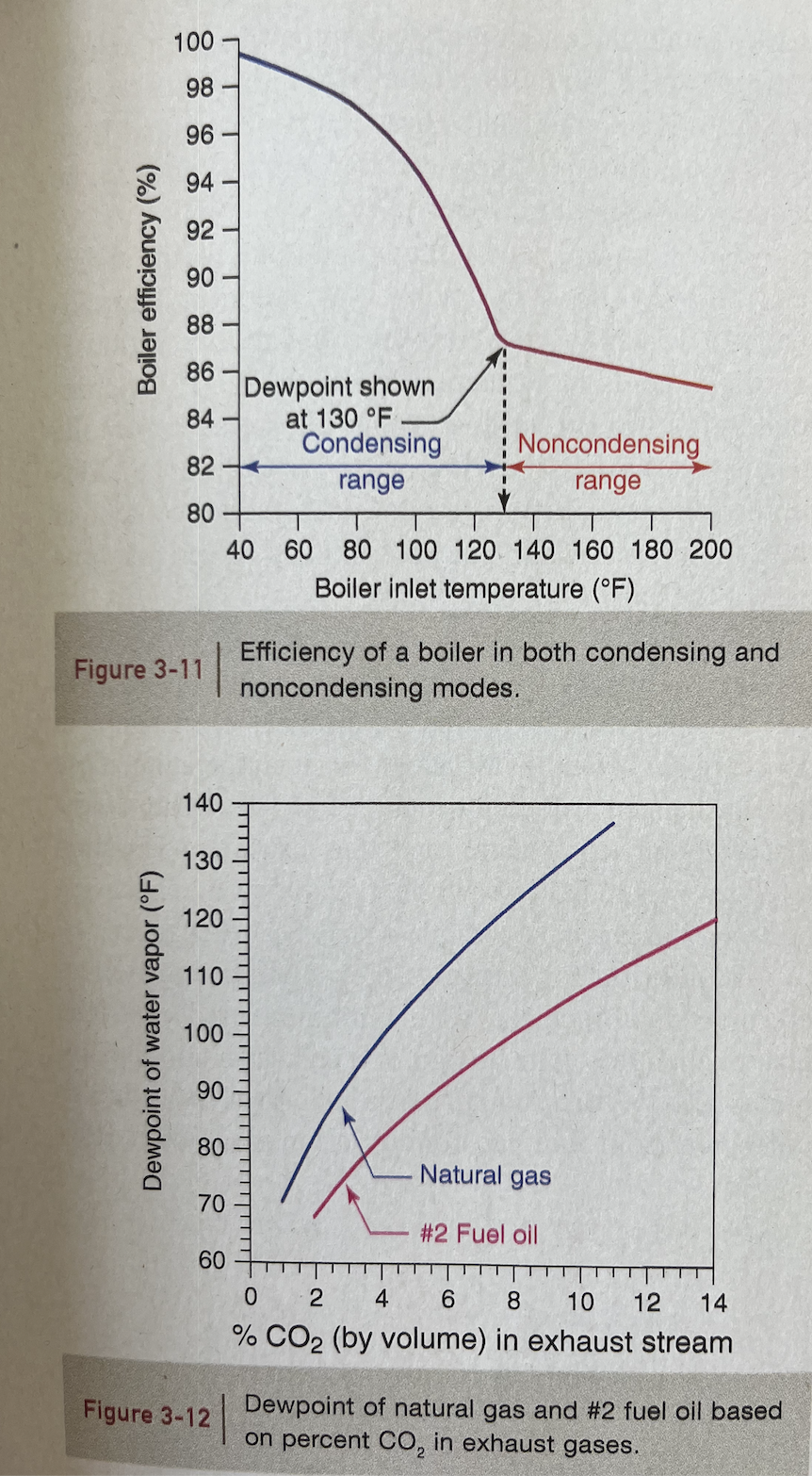

    At the 10 minute mark, boiler at 155, baseboard at 126°. Is that the return from the baseboard? Hopefully you are not leaving the boiler at 155 arriving at the bb at 126°?
    Ideally within 10 minutes or so the return at the boiler should be over the fuel dewpoint. So getting to @130°F within 10 minutes or so is ideal. Burner adjustment CO2 has some to do with dewpoint also.
    If the boiler cycles off before warming above 130, you could be getting condensation in the block.2
    On the indirect call, boiler hitting high limit at 6 minute tell you that you could be flowing more btu to the indirect so it can absorb full boiler output. Not a dealbreaker if you get adequate DHW and recovery time?

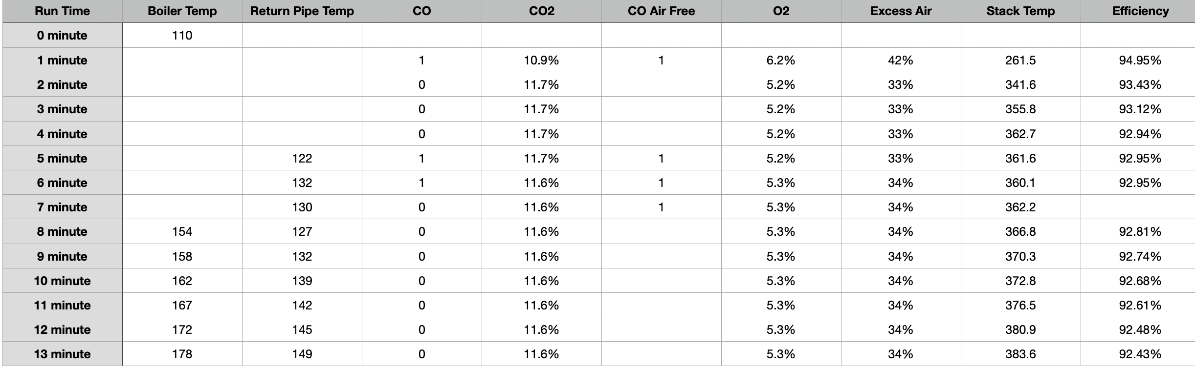

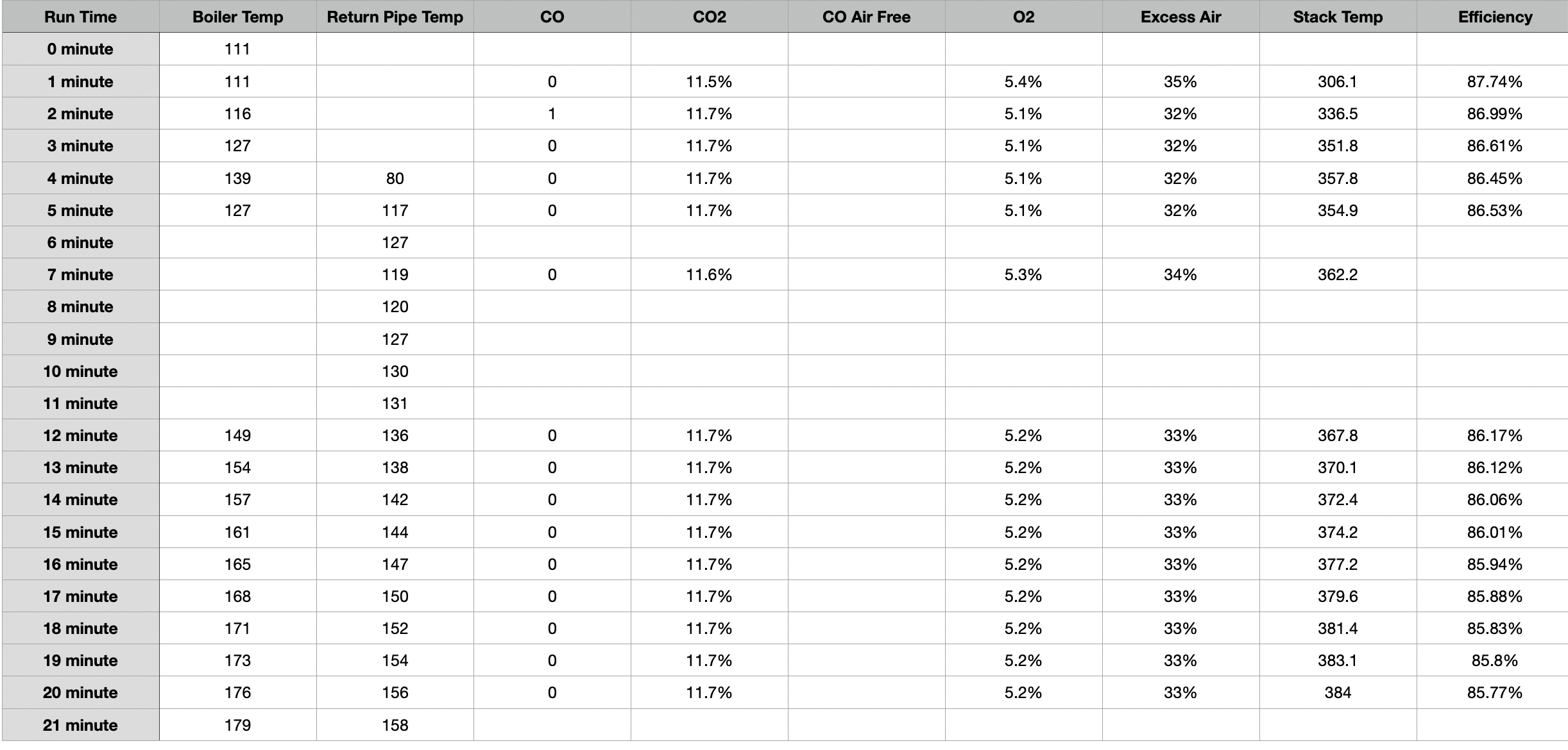

    Hi guys, so I got my new combustion analyzer today and took some measurements. I bought a TPI DC710C1, it's so much nicer than the Testo 310.
    I also put some black electrical tape on the pipes to get a better temperature reading with my thermal camera.
    I setup the airband by eyeing the flame - my smoke test was zero.
    Here are my latest numbers with running the boiler from a cold start of 110 degrees and calling from two heating zones together - note that I didn't capture the boiler temperature and return pipe temperature for every minute run:
    Does this look good? My combustion numbers look good to me, I just want to make sure that the stack temperatures and return pipe temperatures look good.
    Thanks!

    Are you sure you have the right fuel selected for the analyzer.
    Your efficiency numbers can’t be correct.

    #s look too good. O2 looks ok but did you do a smoke test?
    EdTheHeaterMan Member Posts: 11,596
    edited September 2025
    Looking at the 13 minute numbers here is what I might want to look into
    The temperature difference (∆T) between the supply and the return water is a little high. 29°F (almost 30° ∆T) means one of two things. Either the water is staying in the radiators too long, or a new zone just opened and is sending cold water to the boiler and mixing with the hotter return water from the previously operating zone(s). You need to have a more controlled test procedure. Perhaps have all zones calling at once, then check steady state operation after 15 minutes. That will show the real operating ∆T
    11.8% CO2 with a gross stack temperature of 383.6°F does not equal 92.43%. When you look on a combustion efficiency chart for #2 heating oil and you take into consideration the NET stack temperature. (383.6° minus 70° room temperature is a net of 313.6°, for example) you will get a combustion efficiency closer to 85%
    Of course you may get different number if you set your electronic instrument to "LP" or "Nat" gas. Double check your settings

    Yeah, I messed up and selected net instead of gross for the efficiency
    Yes, I did a smoke test before using the analyzer and I had zero smoke.

    Hi, so I did another test today with all three heating zones calling together starting from 111 degrees boiler temp. I also fixed the analyzer to display gross efficiency as I had this set wrong.
    Here are the numbers I got today (some of them are missing as the pictures I took were blurry) - the boiler did drop temp from around the 5 minute mark and then climbed again, and the return temp dropped at around the 7-8 minute mark and climbed again.
    This boiler never ran longer than 5 minutes, so it's a big improvement.
    I want to see how long it will run until it reaches high limit when the boiler is already up to temperature around 145 degrees. I'm hoping it will run around 10 minutes now during those conditions.
    I'll do a few more smoke tests as well to make sure it's still zero smoke.
    Thanks
  • katman
    katman Member Posts: 24
    This was right before the boiler stopped at 180 degree high limit, so I don't know if this has anything to do with the temperature differences.
    Now that looks correct for an oil fired boiler. Your ∆T is close still close to 25° during the steady temperature increase from minute 10 thru minute 17. There is nothing wrong with that as long as your room temperatures are within your comfort range when you are operating under normal conditions. (Not testing conditions). And the fact that you are making all the zones operate simultaneously for this test may indicate that you should not expect your actual burner run times will ever be over 10 minutes. This is because there will be times that only one zone may call for heat at a time with a run time of 4 to 5 minutes before it is satisfied then 5 minutes later another zone may call for 4 to 6 minutes and be satisfied.
    You may be able to use the economy feature on the HydroStat aquastat's economy setting to 3. This may offer you some burner down time if there is enough heat left in the boiler to satisfy the call for heat on another zone by using the left over heated water from the previous call for heat.
