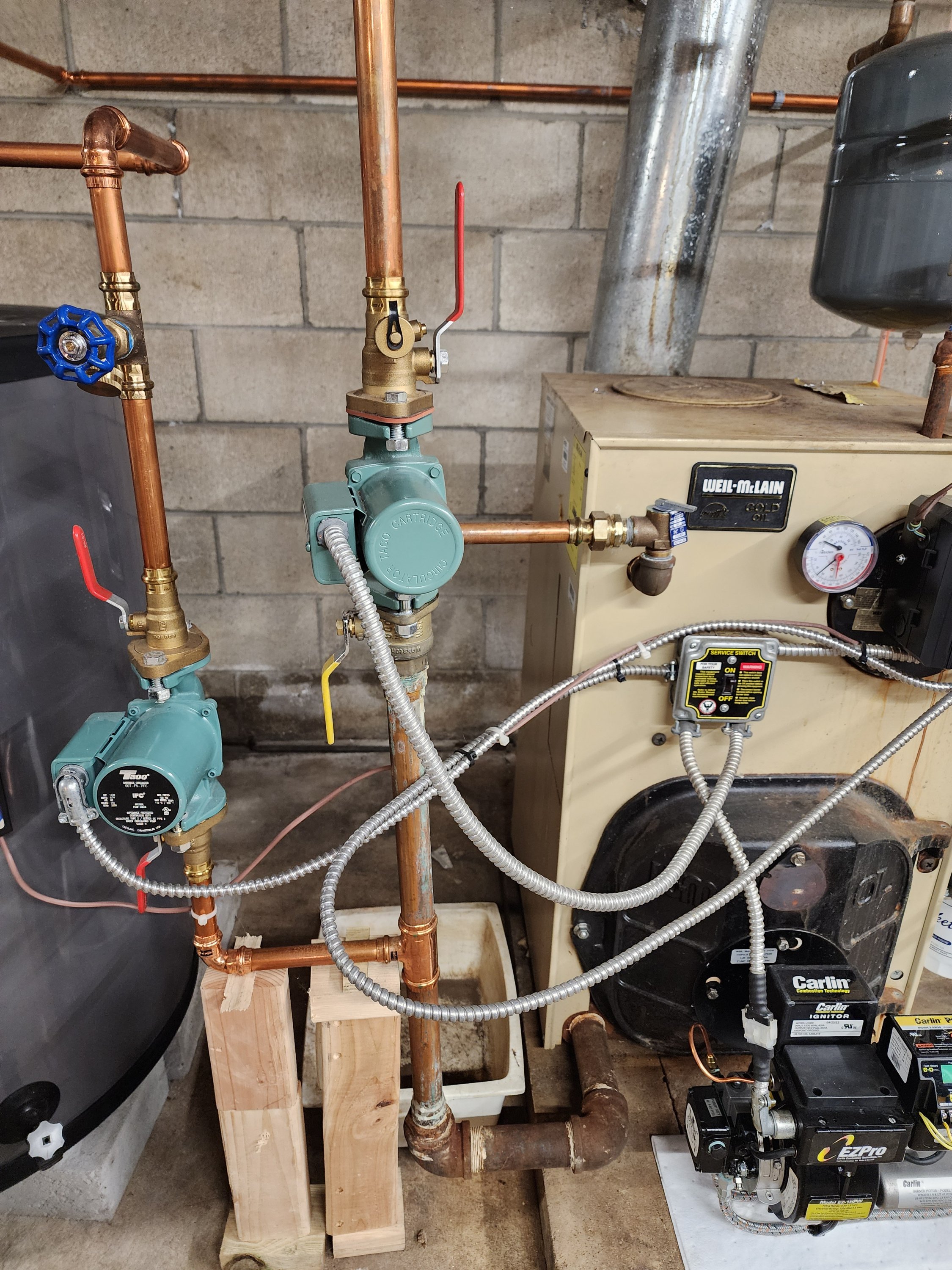

Hi everyone. I have a 20 yr old Weil Mclain 5 section boiler that is oversized for my house.
I'm debating if I should replace it with a smaller boiler such as a Buderus G115WS/3, or keep this boiler and repipe it.

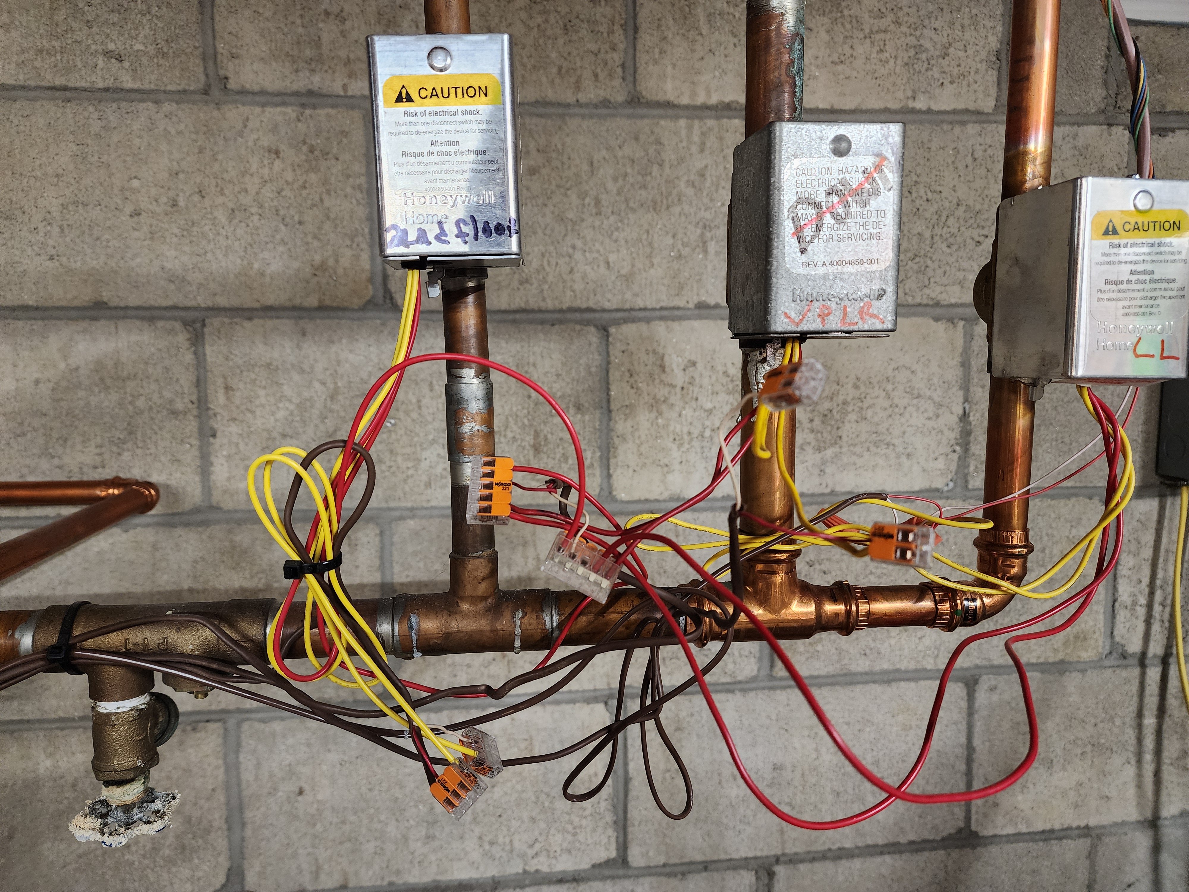

House has three heating zones and an indirect zone. Indirect is wired from the Taco relay to the Hydrostat 3250 using ZC/ZR, and set for indirect priority. Each zone has about 50 ft of fin tube baseboard length. Oil use is about 1,000 gallons a year. House is about 1,800 sq ft.

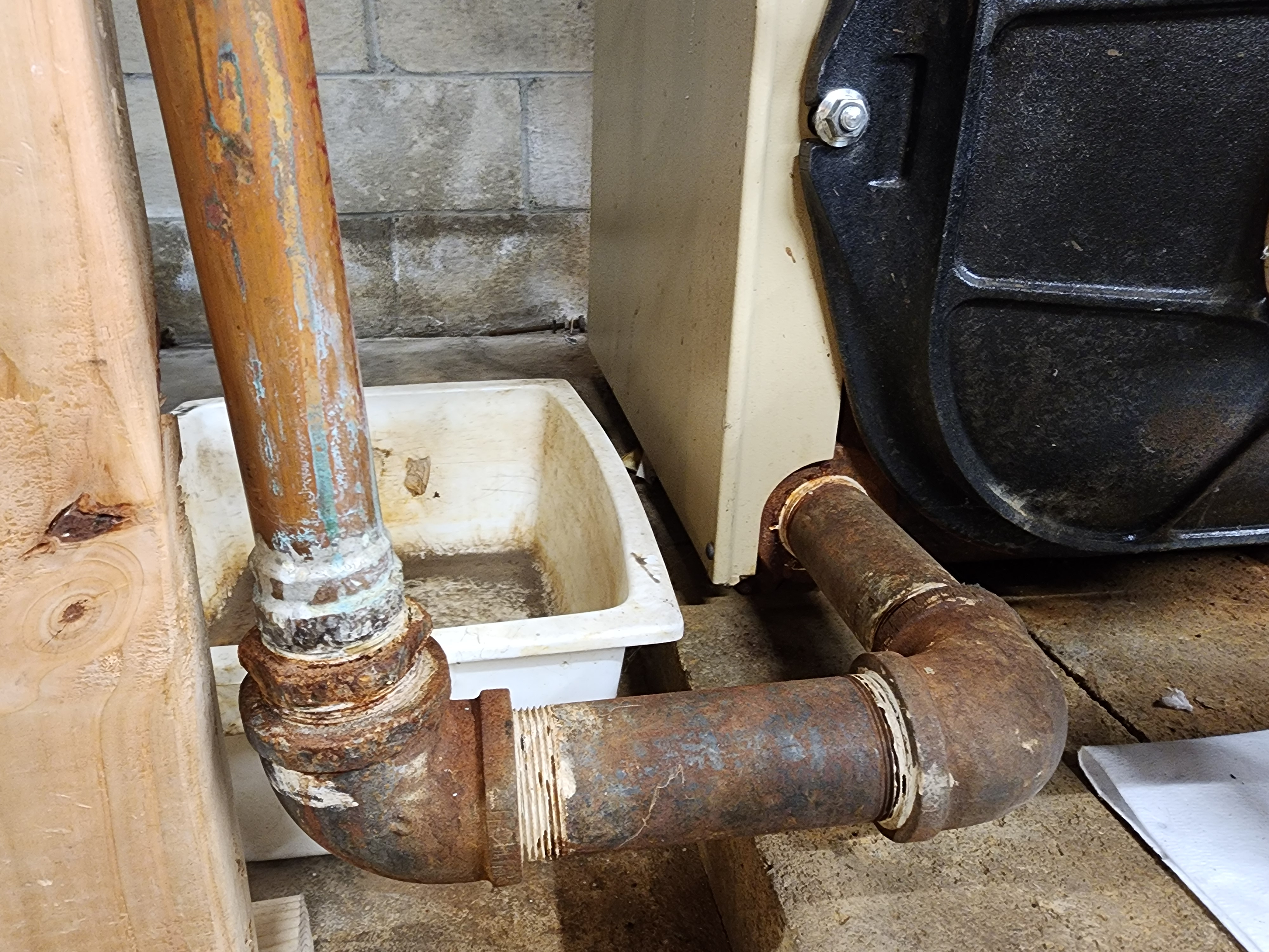

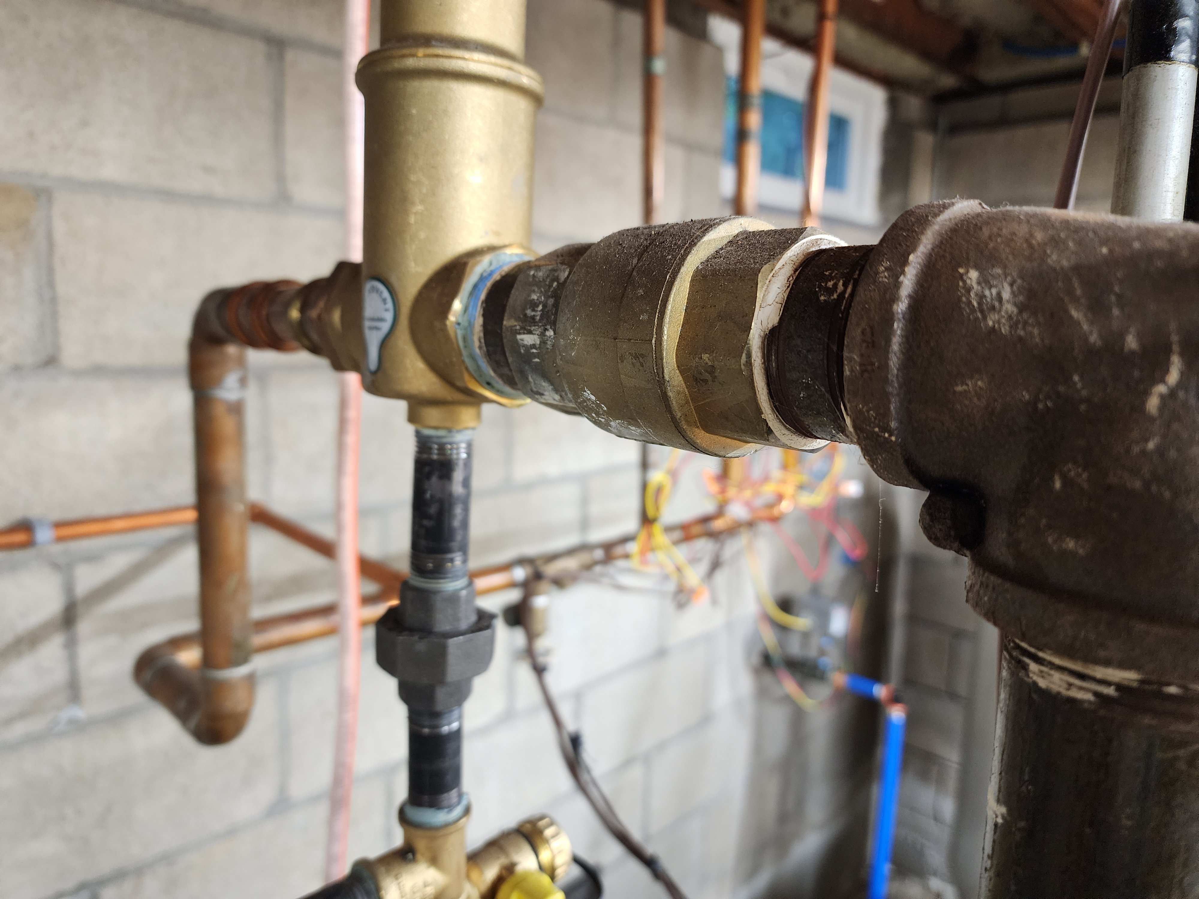

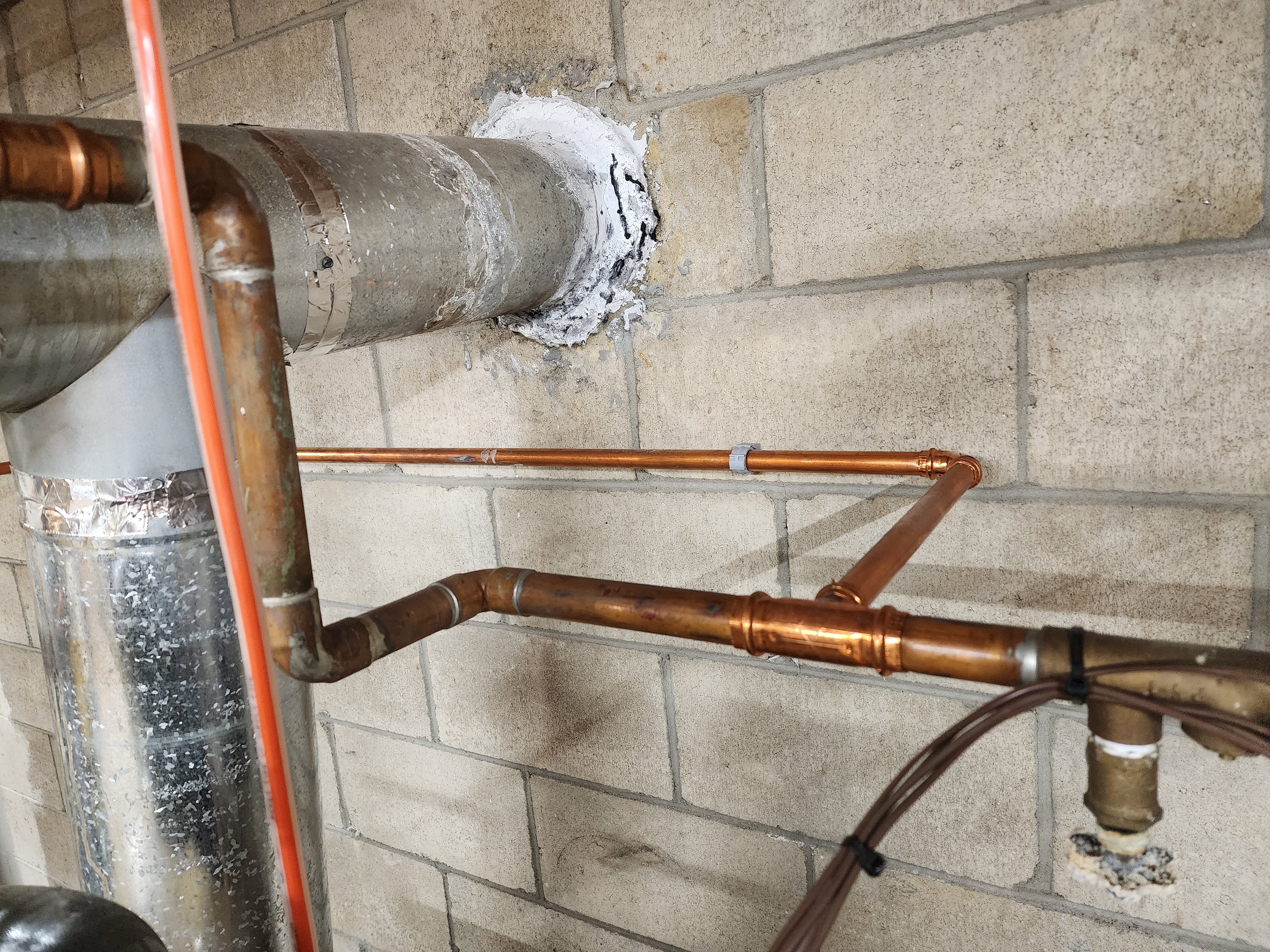

The existing boiler piping has some of the following issues:
- The circulators for the boiler and indirect are both on the return
- The return pipes for all heating zones connect into 1" pipe, then this goes into 1 1/4" after the circulator and into the boiler at 1 1/2"
- The supply pipe reduces from 1 1/2" into 1 1/4", goes into the spirovent and then to the manifold for the zone valves on 1" pipe. There also appears to be some sort of balancing valve in the manifold pipe before the zone valves.
I figure I have a few options:
1) leave everything as is since the boiler works, and nothing is leaking yet.
2) Replace boiler with Buderus G115WS/3, repipe supply to 1 1/4" manifold reduced to 3/4" for each zone and repipe return to 1". I would plan to still use zone valves instead of individual circulators.
3) Keep existing boiler, install circulators on supply, repipe supply to 1 1/4" manifold reduced to 3/4" for each zone and repipe return to 1 1/4" before it goes back into the boiler at 1 1/2"
I've attached some pictures of the current boiler and piping.
Thanks!

    The piping size is adequate for the load you have connected. 100' of fin tube could supply about 55,000 BTU/hr. Seems like plenty for 1800 square feet? No sense in having a boiler sized larger that the fin tube can put into the space. So a 60- 75,000 BTU/hr boiler would be adequate.
    If your current boiler is twice that size, 120,000 or larger it probably short cycles and runs 70% efficiency range.
    katman
  • Three zones with 50'/zone = 150' x ~500 BTU/ft. @ 180° = 75,000 BTU. One inch pipe is fine for that load.
    If you really want to do something, pipe it primary-secondary to keep the large boiler happy.

    Some of the near boiler piping is looking like it's ready to leak, so that's why I was considering at least having a buddy who's a plumber replace some of the piping for me.
    The decision I will need to make is do I just replace what pipes needs to be replaced, or dig deeper by doing stuff such as moving the circulators to the supply, remove that inline purge/balancing valve, and add a 1 1/4" supply manifold to 3/4" to feed the zone valves while the piping is being fixed.
    I'm trying to avoid any unexpected breakdowns of the boiler during the winter and be proactive.
    The circulators are a little sketchy to me with the way that they're piped into the return, so I put the wood under them to take the weight off of that return pipe.

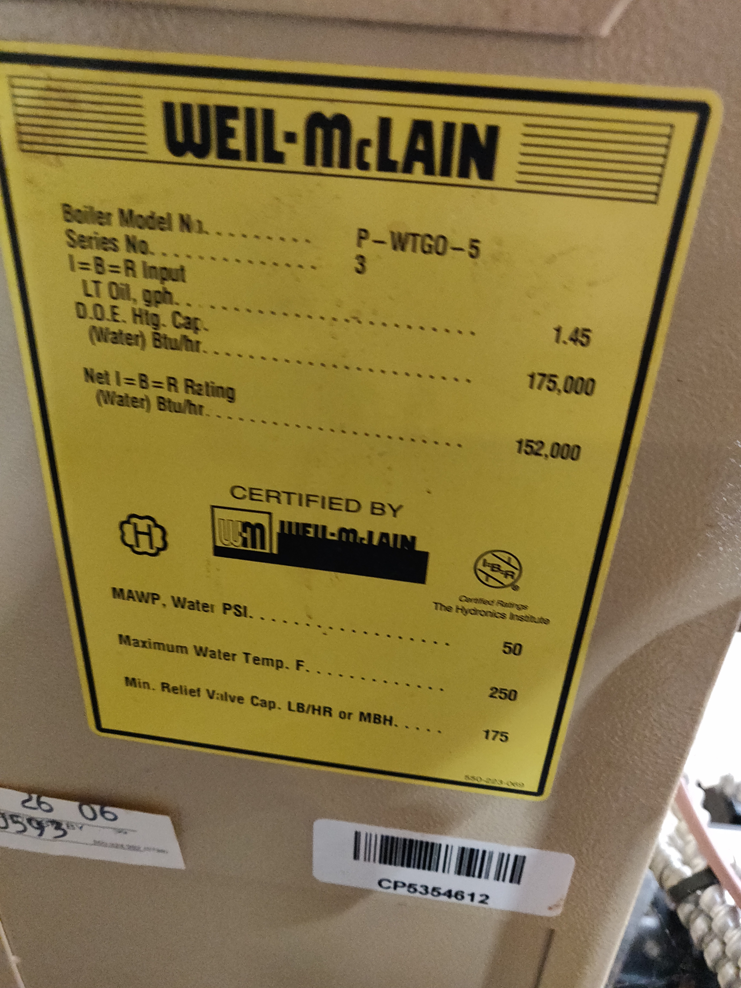

    Here are the specs on the boiler:
    P-WTGO-5
    Series no 3
    I=B=R Input LT oil, gph 1.45
    D.O.E Htg Cap (Water) Btu/hr 175,000
    Net I=B=R Rating (Water) Btu/hr 152,000

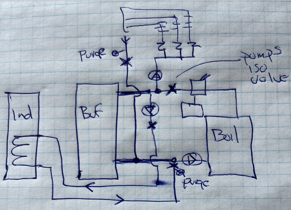

    hot_rod Posts: 28,706
    A heat load would add some more info to the question. 1800 sq ft X 25 btu/ ft guesstimate= 45,000BTU/hr required. That is on the coldest day.
    80% of the heating season the load could be in the 30,000 range. So the boiler 152,000 you have could be 3-4 maybe 5 times what you need.
    While` not hydronically ideal for that boiler, the circs are not causing efficiency issues on the return, unless the system has noisy air issues?
    Here is a simple buffer piping, direct to load method. Indirect on priority with its own circ.

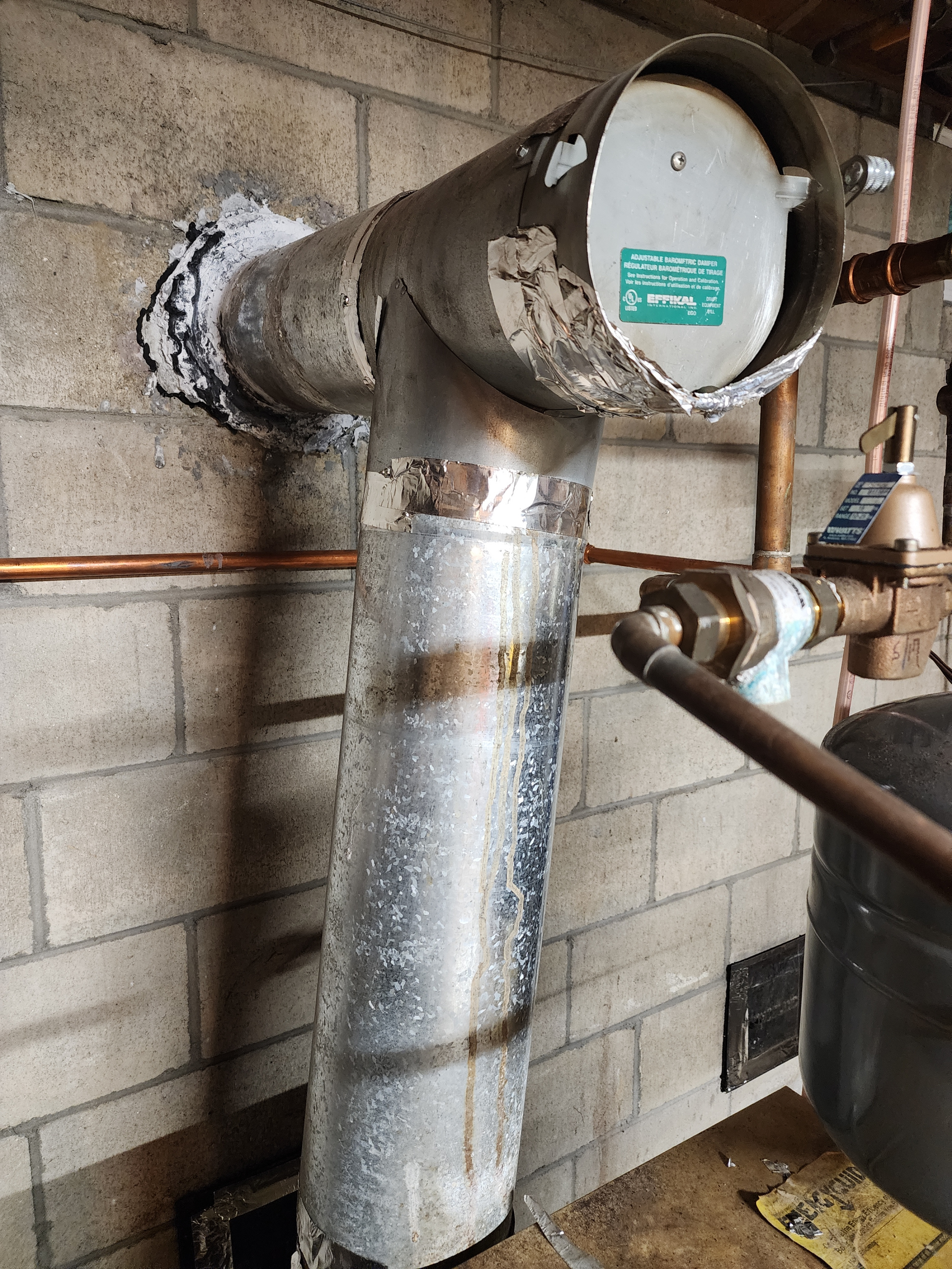

    The WM WGO-5 has a rated input of 1.45 GPH. That same boiler can be fired at 1.20GPH when it has a model number of WGO-5RD. That is a 5 section boiler that comes from the factory with a oil burner nozzle of 1.00 GPH and a pump pressure setting at 145 PSI.
    Weil McLain allows you to reduce the fire rate by 15% and as much as 20% on most of their boilers by adjusting the gas pressure on Gas Fired units and reduced nozzle size on Oil Fired units. I might attempt to use a .85 GPH nozzle at 45 PSI. After checking the stack temperature and other combustion test numbers, you may find that you can get good numbers with the boiler firing at 1.02 GPH which would end up with a AHRI NET output of 107K BTUh. That will bring you from 3 times too big down to twice as big as needed. That will then reduce your short cycling by 30ish%.
    Now you may end up with flue gas condensation as a result of this change, but you may not. If you get the stack temperature to 350° within the first 3 minutes of operation, you will probably be alright. If you can't Then check the return water temperature. Since you are using Baseboard with copper tube/alum fin, you should have no problem getting return water to 140° within the first 5 minutes and the stack temperature should be 350° or more, without a problem. If you end up with Flue Gas Condensation you will notice water droplets that leak out the vent connector pipe and leave rust trails on the vent pipe in a few weeks. If you don't get that, you can leave the boiler operate at the reduced firing rate and save a little on fuel. If you do get the rust trails, then increase the fire rate to 1.1GPH by using a .90 GPH nozzle at 150 PSI.
    Don't forget to paint the rust marks away with high heat aluminum or replace the vent connector pipe with new, so you can monitor for new rust streaks. You should be able to get the firing rate down enough so you can keep that oil boiler in operation for another 20 years. That will give you time to sack away enough for a new boiler later on.

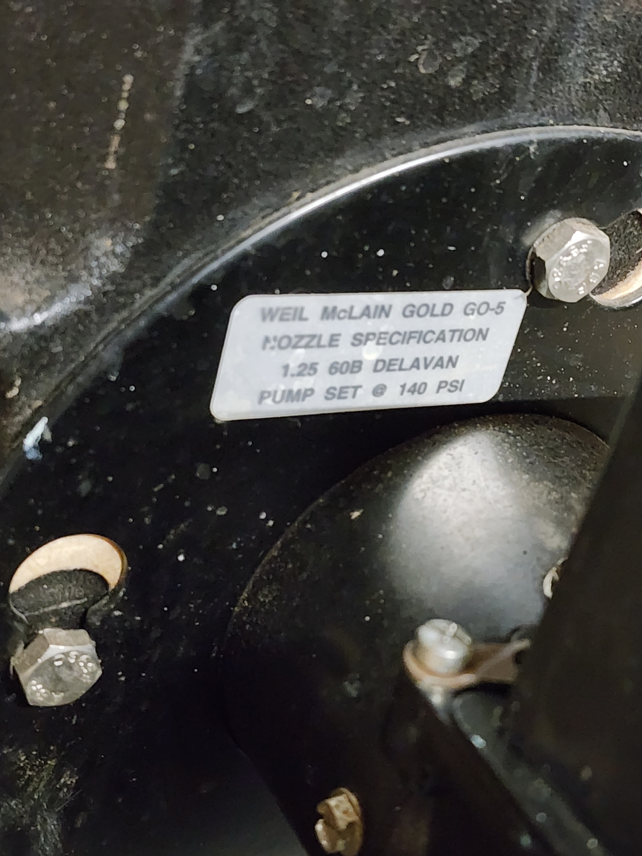

    Thanks Ed. Here's the labels on the boiler:
    Tankless coil has been disconnected and replaced with an indirect.
    I installed a 1.10 60B nozzle, and set the pump to 140 psi.
    I have a Carlin EZ-1HPW burner, so I would have to change the head bar if I go lower than a 1.10 nozzle.
    With the 1.10 nozzle, I was originally using the Hydrostat 3250 Outdoor Reset. This led to the boiler only running for maybe 2-3 minutes since the high limit was typically only around 140-150 degrees. My stack temperatures got up to just around 350 degrees or so in the 2-3 minutes.
    I disconnected the ODR, and set the high limit to 175, low limit to 135 and the differential to 30.
    Once I did this, I could get a burner run time of 5-8 minutes as long as the thermostat stayed calling.

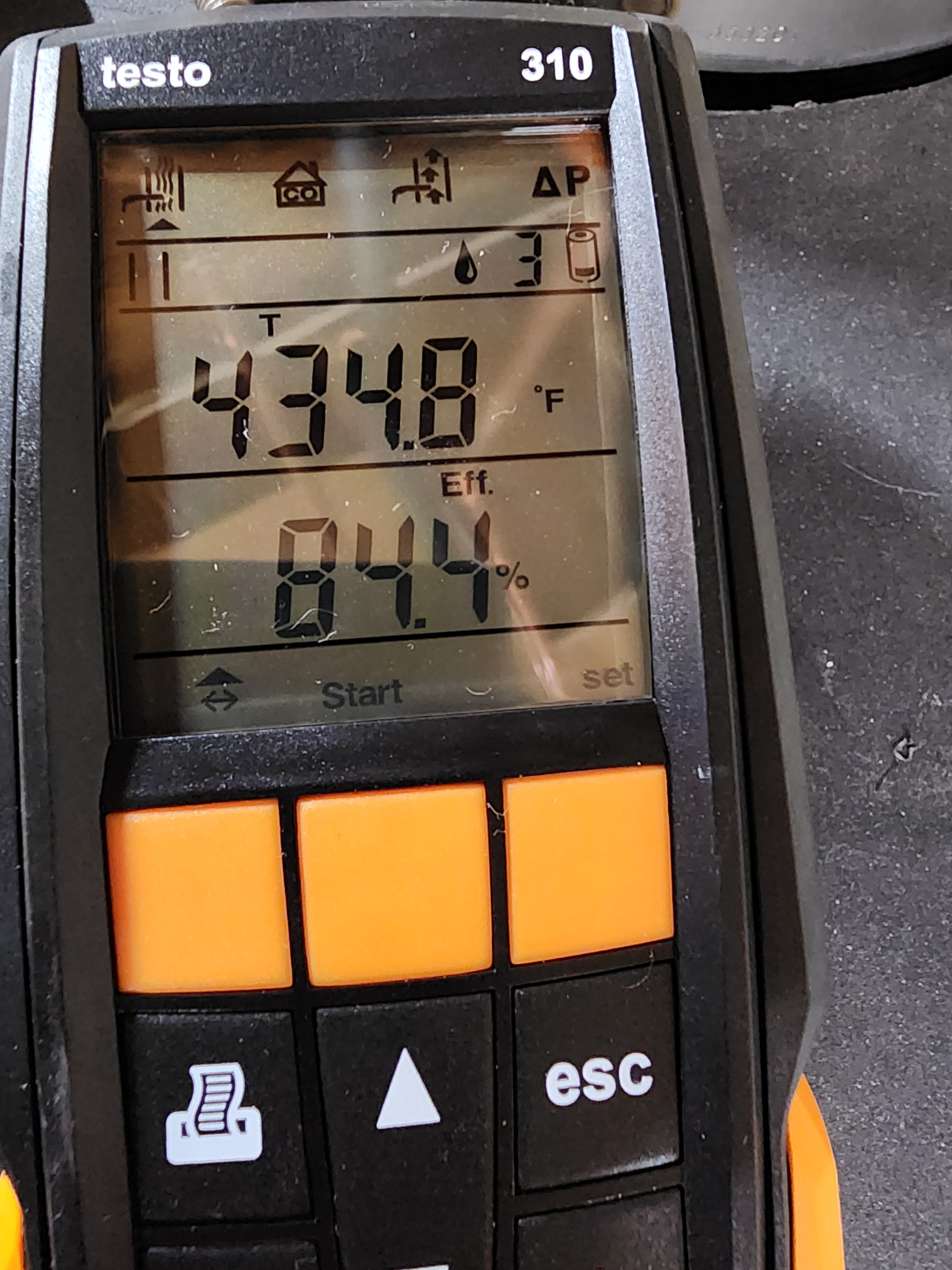

    My stack temperatures also went up to around 420-450 degrees.
    I did notice that I have the rust trails already on my vent pipes. However, they were there five years ago when I bought the house.

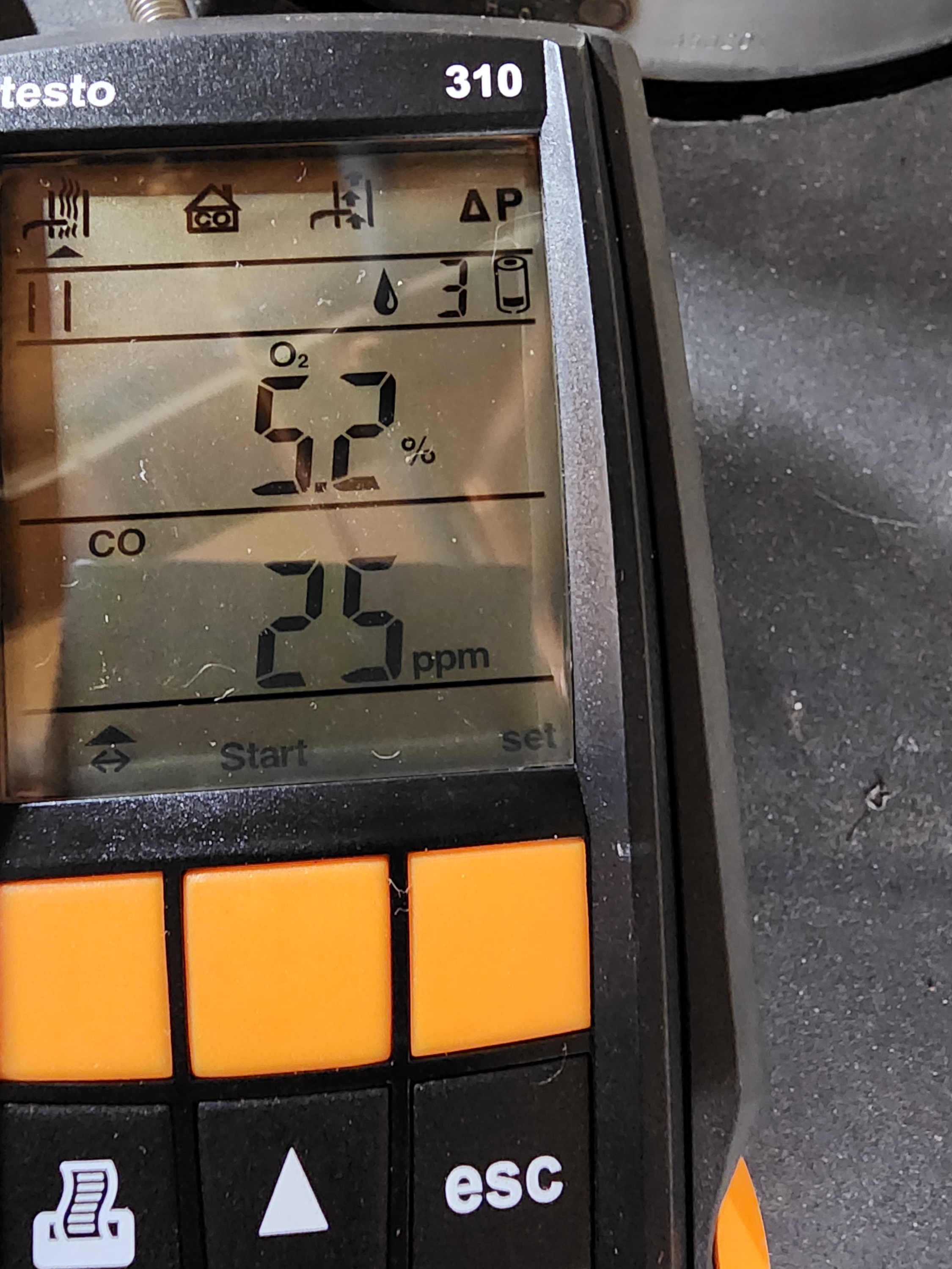

    Here's my combustion readings with the 1.10 nozzle and the 30 differential:
    20250302_121340.jpg 20250302_121346.jpg 20250302_121353.jpg 20250302_121359.jpg

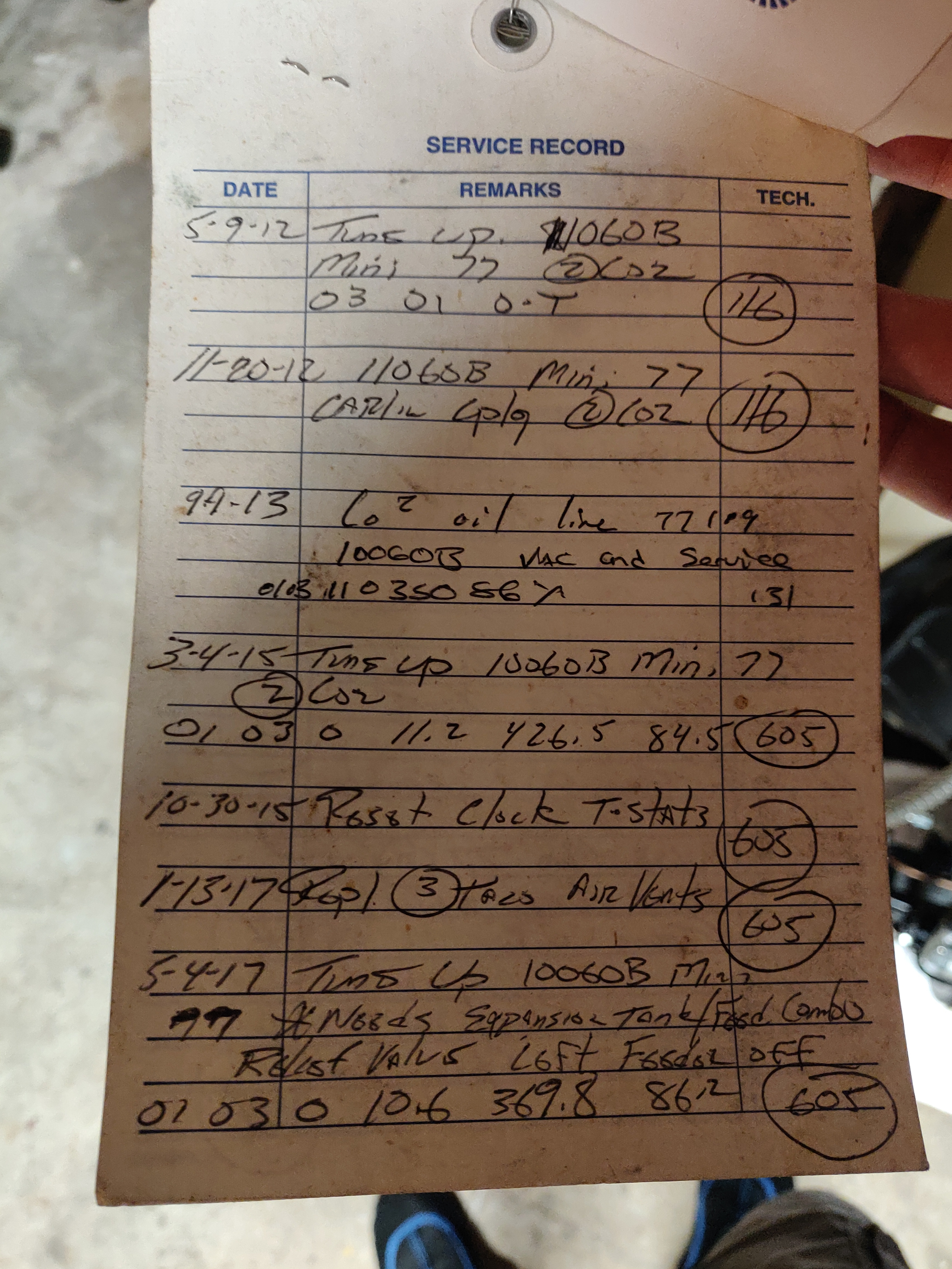

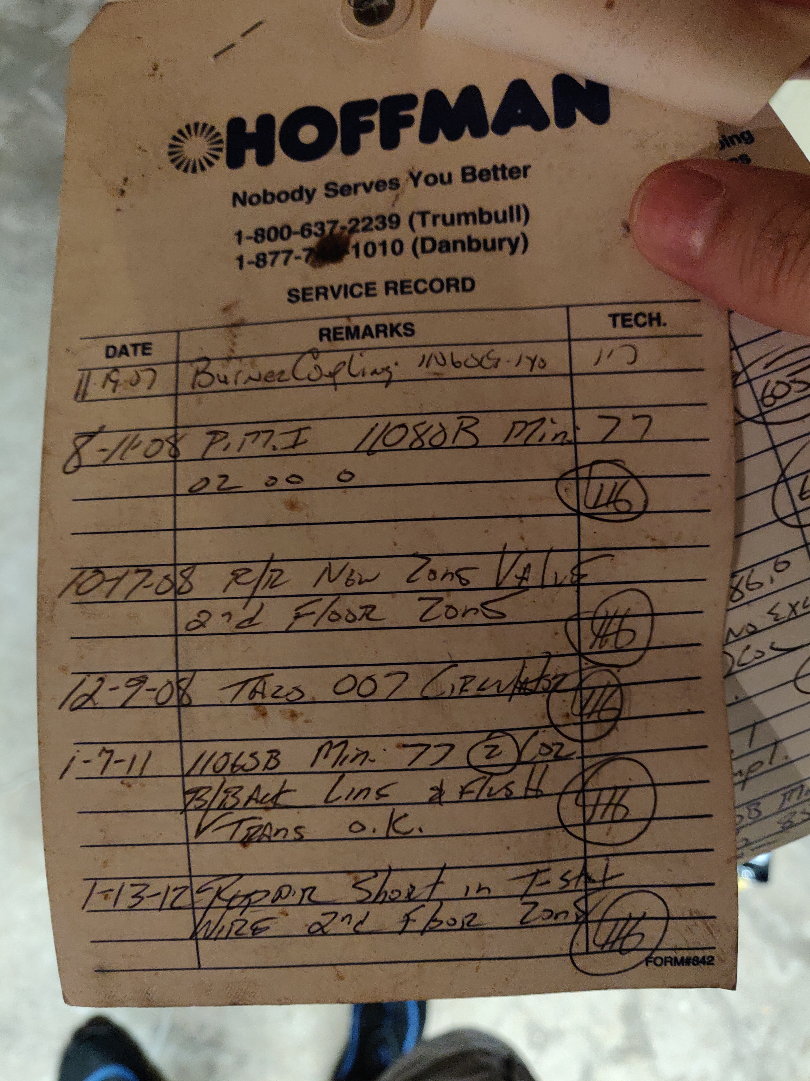

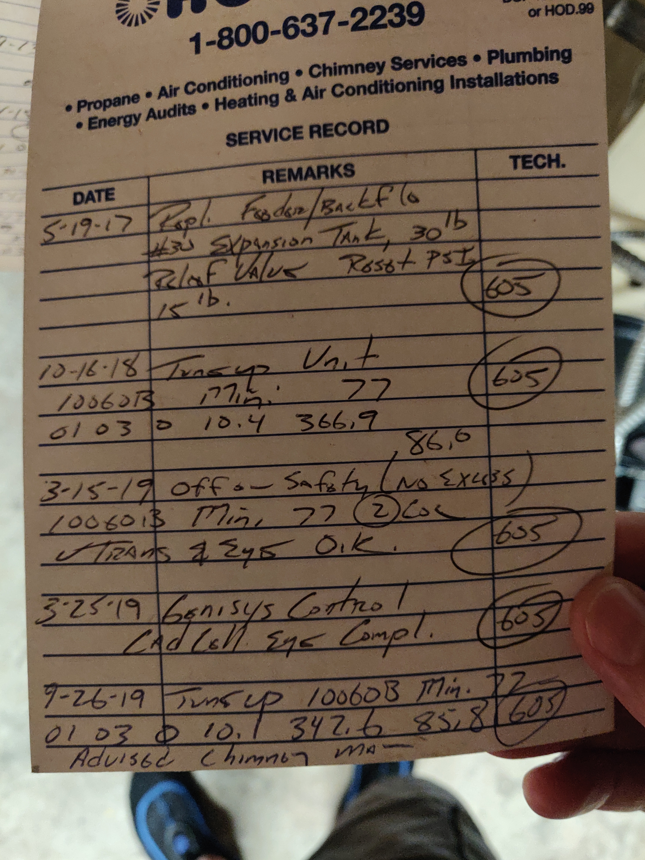

    What's interesting is I just found the original service records, and it looks like this boiler was downfired with either a 1.00 and a 1.10 nozzle since new (strange since the head bar is a 1.10/1.25)
    Do you think I should start off by trying a 1.00 60B nozzle, raise the pump pressure to 145 psi, and change the head bar to the .85/1.00 and see what kind of numbers I get or just go right for the .85 nozzle at 145 psi first?
    Thanks!

    @katman, The Aquastat that you have, may be the Original Equipment Manufacturer (OEM) specifically designed for WM. That control may not have the ability to operate as a WGO cold start boiler. If your system was originally installed with a WGO boiler and an indirect for DHW, then the control would automatically be set for cold start operation. All that said, since you are no longer using the Coil for DHW, there is no need to maintain any minimum temperature in the boiler when there is no call for heat of call for DHW. Set the control to the lowest temperature for LOW LIMIT as possible. If you can go as low as OFF that is the best setting for your situation. that will result in the lowest fuel usage. In the future, if you ever need to replace the Aquastat Control… Use the universal model that can be set to OFF in order to convert this WTGO to cold start operation like the WGO. Except for the tankless DHW coil, the WGO and WTGO are the same boiler in every other specification.
    As far as setting up the burner to fire at 1 GPH with a .85 nozzle, that is where I would start and see if you get the minimum stack temperature of 350° within 5 minutes of cold start operation. If you do, then leave it there and look for signs of flue gas condensation on the vent connector, after several weeks of operating at this lower input. You may be in good shape.

    As far as repiping the boiler so the circulator pumps are located on the supply side of the boiler would be: if you are experiencing air problems. If you constantly need to purge air from your system (more that once a year) because you have no heat in a zone or a radiator resulting from air in the system, then you will gain an advantage in that repipe job, if designed correctly. Otherwise, if it ain't broke don't fix it. Lacking any air issues, there is no fuel savings or thermal efficiency to be gained my redesigning the pipes. The only advantage is to eliminate air problems.

  • Hi all, I just wanted to give you some updates:
    I had some repiping done - supply header is now 1 1/4" and return is 1". Left the circs on the return. Added a Caleffi 573 feed valve. Set low limit to off, so boiler is now a cold start. High limit is set to 180, economy off and differential to 30. Thermal pre-purge is enabled on the hydrostat 3250.

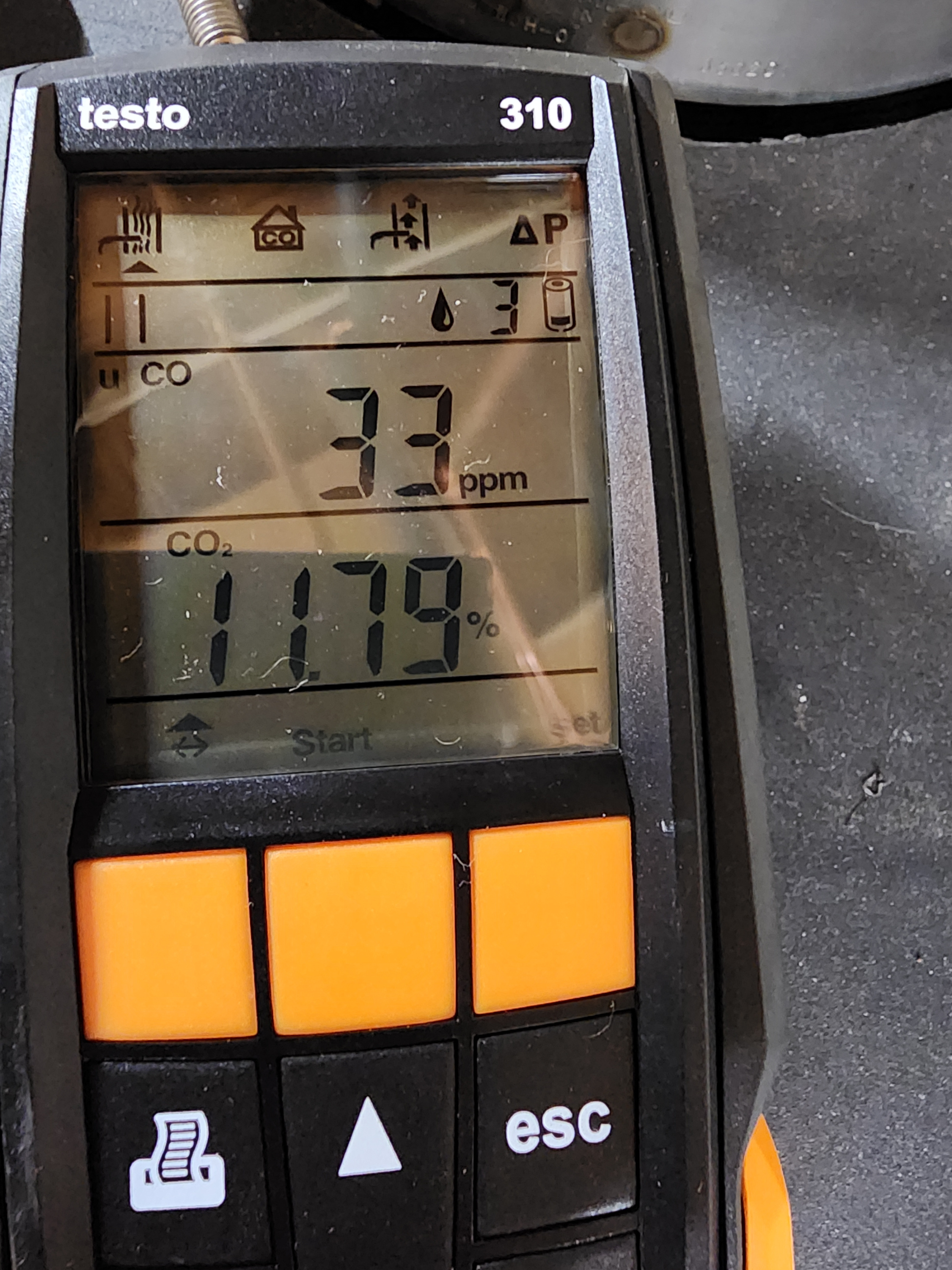

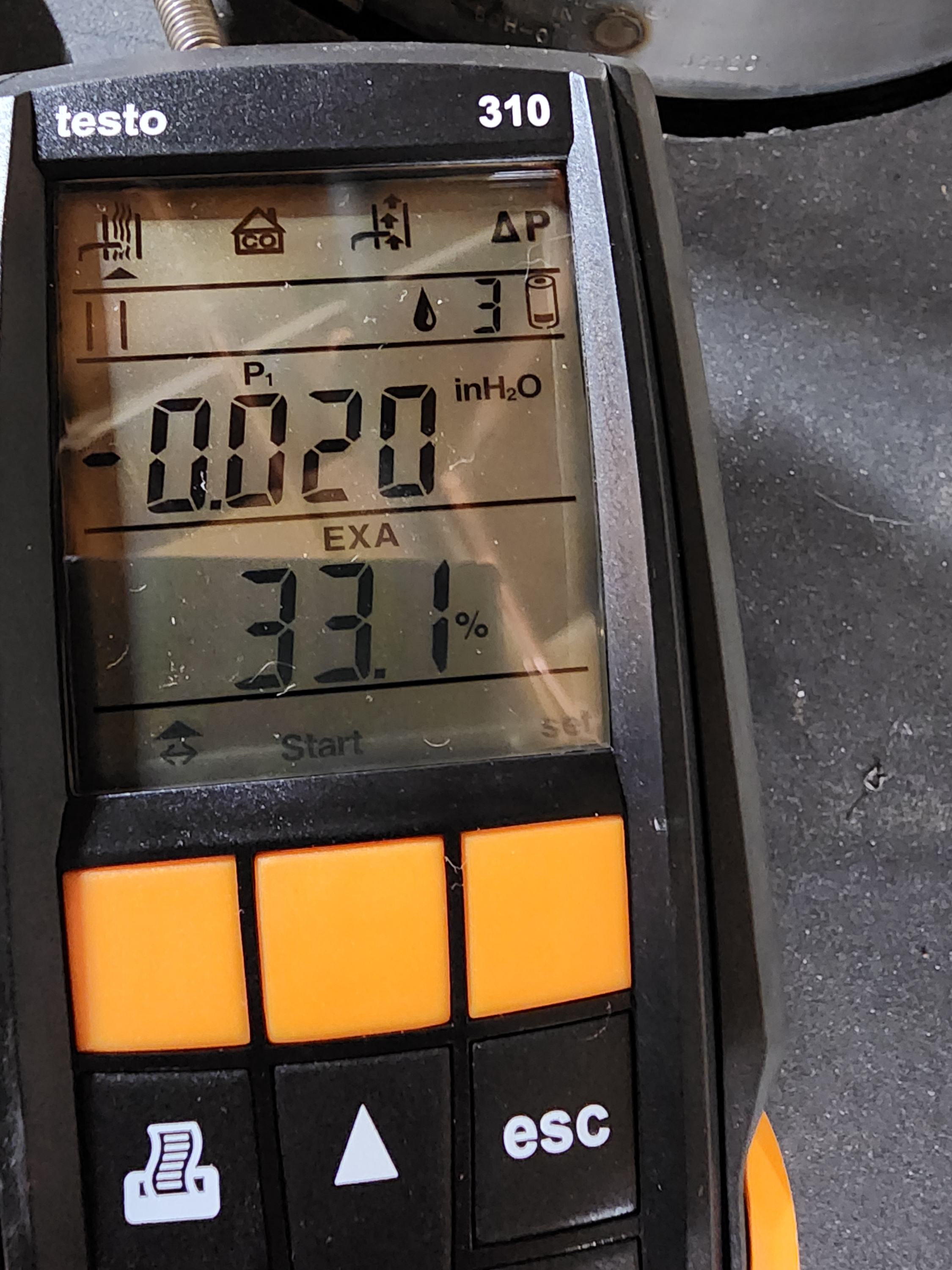

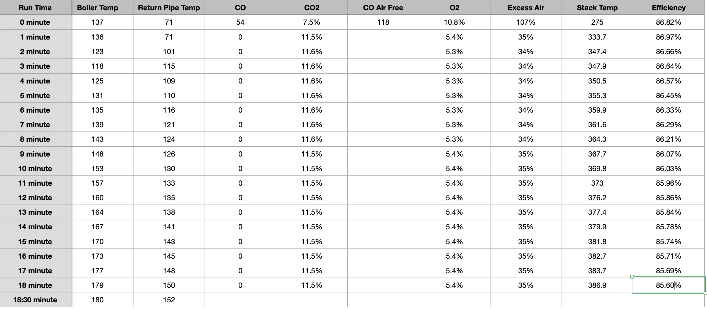

  • Hi guys, so I got my new combustion analyzer today and took some measurements. I bought a TPI DC710C1, it's so much nicer than the Testo 310.
    I also put some black electrical tape on the pipes to get a better temperature reading with my thermal camera.
    I setup the airband by eyeing the flame - my smoke test was zero.
    Here are my latest numbers with running the boiler from a cold start of 110 degrees and calling from two heating zones together - note that I didn't capture the boiler temperature and return pipe temperature for every minute run:
    Does this look good? My combustion numbers look good to me, I just want to make sure that the stack temperatures and return pipe temperatures look good.
    Thanks!
  • Are you sure you have the right fuel selected for the analyzer.
    Your efficiency numbers can’t be correct.
    #s look too good. O2 looks ok but did you do a smoke test?

    Looking at the 13 minute numbers here is what I might want to look into
    The temperature difference (∆T) between the supply and the return water is a little high. 29°F (almost 30° ∆T) means one of two things. Either the water is staying in the radiators too long, or a new zone just opened and is sending cold water to the boiler and mixing with the hotter return water from the previously operating zone(s). You need to have a more controlled test procedure. Perhaps have all zones calling at once, then check steady state operation after 15 minutes. That will show the real operating ∆T
    11.8% CO2 with a gross stack temperature of 383.6°F does not equal 92.43%. When you look on a combustion efficiency chart for #2 heating oil and you take into consideration the NET stack temperature. (383.6° minus 70° room temperature is a net of 313.6°, for example) you will get a combustion efficiency closer to 85%
    Of course you may get different number if you set your electronic instrument to "LP" or "Nat" gas. Double check your settings
    katman
  • Yeah, I messed up and selected net instead of gross for the efficiency
    Yes, I did a smoke test before using the analyzer and I had zero smoke.
  • Hi, so I did another test today with all three heating zones calling together starting from 111 degrees boiler temp. I also fixed the analyzer to display gross efficiency as I had this set wrong.
    Here are the numbers I got today (some of them are missing as the pictures I took were blurry) - the boiler did drop temp from around the 5 minute mark and then climbed again, and the return temp dropped at around the 7-8 minute mark and climbed again.
    This boiler never ran longer than 5 minutes, so it's a big improvement.
    I want to see how long it will run until it reaches high limit when the boiler is already up to temperature around 145 degrees. I'm hoping it will run around 10 minutes now during those conditions.
    I'll do a few more smoke tests as well to make sure it's still zero smoke.
    Thanks
  • This was right before the boiler stopped at 180 degree high limit, so I don't know if this has anything to do with the temperature differences.
