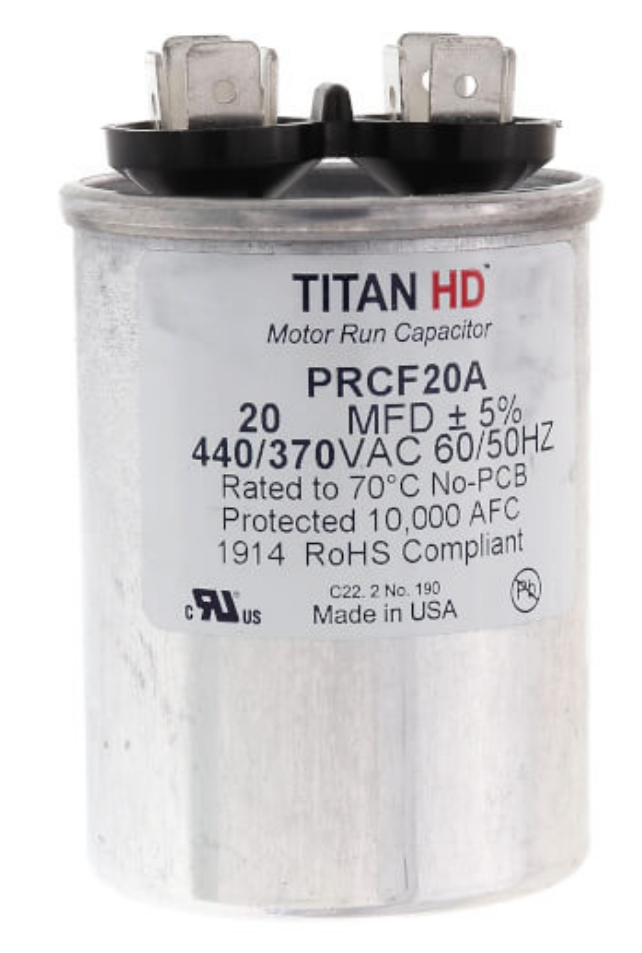

Hello…. My A/C fan unit Capacitor went bad.. Went to the ye ol' A/C supply store, brought the old one with me for the guy to compare… The only difference is the voltage.. My old one has 440/370VAC..
The new one has just 370VAC… Will that make a difference on how the A/C will run?
Thanks!

    No,
    The 440/370V cap is actually just a 440V cap.
    I assume your system is running on 240-250VAC in a residential installation? If so, the 370v cap is fine, but I prefer the higher voltage ones as they should last longer.
    I assume the "uf" rating on the new cap is identical to the old one? That's important. Something like, 5uf?

    If you need a 370 V capacitor you can use a 440 v capacitor. If you need a 440 V capacitor you can not use a 370 V capacitor. So if you don't know if you need a 370 or 440 then you should use the 440. If you can find the original specification in the equipment docs, and it specifies a 370, the you are good to go.

    Compressor, fan, dual? If you went to the supply house & they looked it up from the unit model & serial, I would imagine that's the right one. If you just crossed it over from the existing, I would've expected a 440 volt one, or dual rated. Like @ChrisJ and @EdTheHeaterMan said, a higher voltage rating will substitute for a lower—but not vice versa.
    It's my understanding that the motor design determines the voltage of the cap. (I read that on the Internetz some time in the last few decades, so it must be true!) In any case, you can verify the voltage by simply measuring the voltage across the cap with the unit operating, it'll be around 370 volts, or it'll be around 440 volts. The outdoor fan motor and the compressor both should have a nameplate that specifies the capacitance and voltage of the required cap. Two separate ones work the same as a dual. Oval vs round is merely mechanical, you can use either if you can get it tucked up in there somewhere.

    The voltage rating refers to what voltage the capacitor is rated to withstand, not to what voltage that will be measured at its terminals. If the actual measured voltage is in excess of its RATED voltage, then a higher rated capacitor should be used.
    It never hurts to go up in rated voltage. In fact, it’s a good practice.

    I just automatically buy 440v caps, regardless, specifically Titan HD which say they're made in USA.

    The life of an electrolytic cap is a function of voltage and temp. It will work a bit above its rated voltage for quite a while but won't get its rated life. You can get more life by using a cap with a significantly higher voltage rating than the working voltage.

    This is exactly correct. You can go up in voltage rating as long as you match the uF rating. Also some capacitors are designed as 'start' capacitors and others as 'run' capacitors. 'Start' capacitors are designed for a few seconds of operation at a time, and will overheat if used continuously as a run capacitor. Run capacitors are designed for continuous use, and can be used as start capacitors, but will probably be un-necessarily physically larger and more expensive).
    As a rule of thumb, if this is a 120V motor you will need a 370V rated capacitor (a lower rating would probably work, but they are not commonly made, so you end up with 370V); if this is a 240V motor you will need a 440V rated capacitor. The voltage applied to the capacitor is significantly higher than the supply voltage going to the motor. (See https://youtu.be/rUqL9MqwimA for someone actually measuring the voltage applied to the capacitors when the motor is running).
    In general a higher voltage rating is good because the capacitor will last longer.
    The 370/440V rating is just the manufacturer's way of making it clear that you can use a 440V capacitor in place of a 370V capacitor.

    I had 440/370VAC, the new one is 370VAC… So, I really need a 440 Capacitor, correct? All the other specs are the same..

    unless the motor ratings plate has a spec for the cap on it that says it can use a 370 vac cap.
  • ChrisJ
    ChrisJ Member Posts: 17,077
    Try to look and see what the motor says on it. If the label is still legible it'll tell you what it needs.
    Or buy a 440v cap online and swap it out and you'll know it'll last. Make sure the "uf" spec is identical.

    That 440/370V cap you described is actually just a 440V unit being labelled both ways for clarity. In most residential setups running on 240–250VAC, a 370V capacitor works just fine—but the 440V spec gives you a little more durability over time
    The key here is matching the microfarad (µF) rating exactly—if that lines up, you’re golden. If you're ever unsure which to use, opt for the higher voltage—it's a simple tweak that keeps things running smoother and longer.
