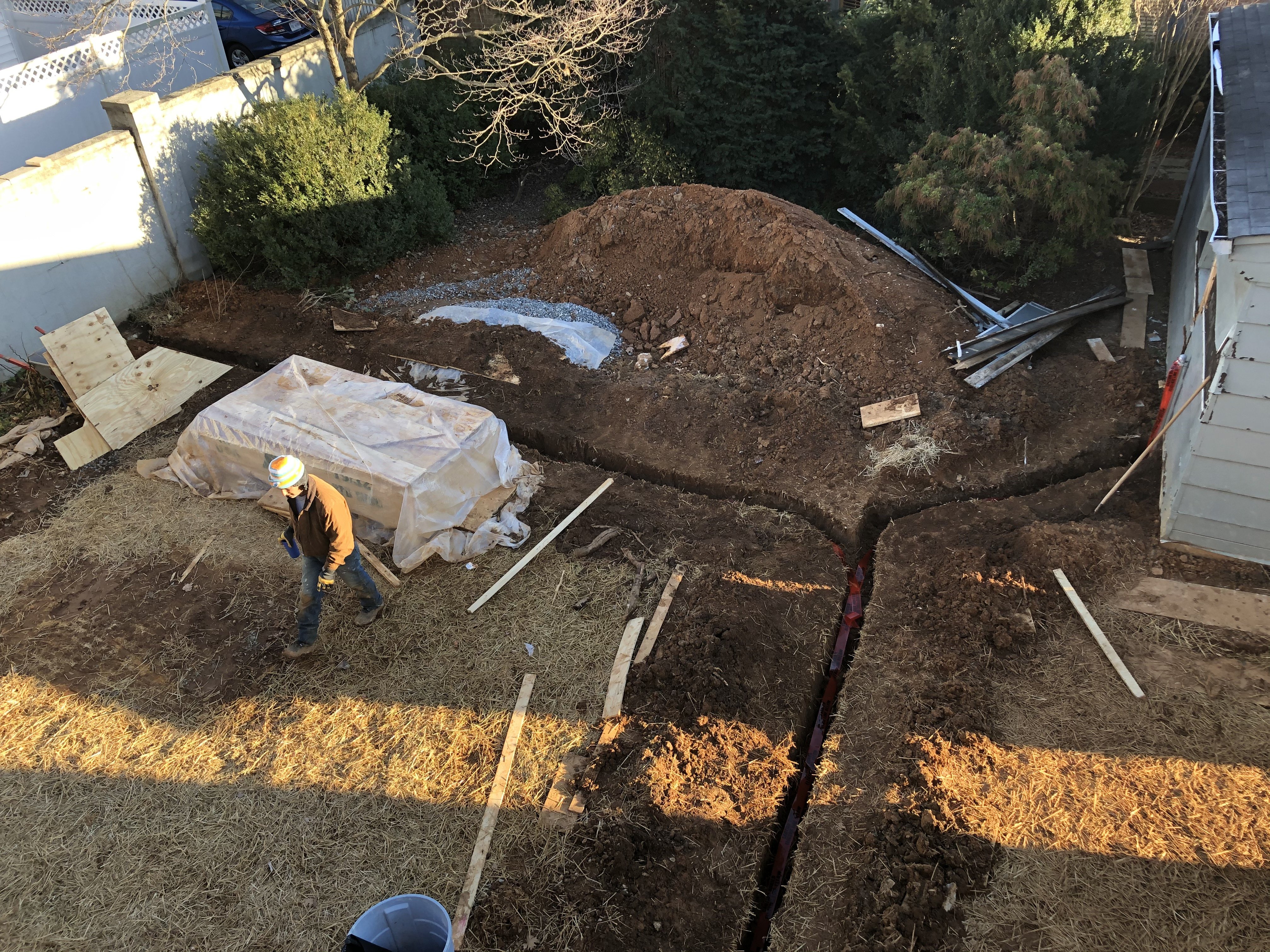

In doing some landscaping we found that the 30-40ft underground electric line from the house to the garage (20amps) was buried less than 12" below grade, so within a week or so we hope to have our landscaper trench out at a depth of 18" at the width of a shovel(?) for a new line. According to code I understand that sand will be filled in first, then the pvc electric conduit, then more sand and then the caution tape to warn any future excavators.
Since this is replacing an existing line the electrician has suggested installing two connecting outside boxes, one at the garage end, and the other on the house wall so that the internal wiring in the house and in the garage can be left as is.
He also gave us the option of installing 2 50-amp conductors for a future car battery charger, while leaving the existing house connectors the same until such a charger is installed—which would save any new owner the cost of re-trenching through the new finished landscaping. That leads me to these questions:
1-Since we intend no such charger and would use only the 20-amp circuit for garage lights and a power outlet, would that 20 line be Y-ed to work with the 50-amp battery charger line which would eventually be a double breaker? Or would the two circuits have to be wired separately? I am thinking the wise option is to run just a PVC 20-amp circuit INSIDE a larger 2-3" pvc sleeve so they could snake a future larger charger line with no re-trenching and let the eventual new owners worry about it.
2-What are the wiring thickness gauges required for the 20amp and 50amp underground lines?

    for the cost difference in the larger PVC, why not leave the option for a 50 or 100A upgrade?
    1-1/2” PVC would be my suggestion
    I believe 18” burial, 12” under driveways is how the code reads
    I put yellow caution tape in the trench a few inches above the conduit

    When I did the construction of an addition for my existing house with new service, I ran a one and a half inch line from house to garage in a 2 inch out to the connection point for the mains.
    If I did it again, I would run a 3 inch out to the connection point for the mains. It was a pain pulling the aluminum supply lines through the 2 inch PVC with two long 90 in line.
    Do yourself a favor and leave a couple pull strings inside the run to the garage
    The inspector required metallic detectable tape to be installed above the lines.

    Deeper than 18". The top of the PVC conduit needs 18" of cover, not an 18" trench. So if you use a 1-1/2" which is the best part of 2" Outer diameter and if it is in sand, you need a deeper trench.
    I would and have done three conduits;
    one high current 1-1/2 or 2" (in your case not populated)
    one 3/4" or 1" for low current branch circuit and
    one 3/4" or 1" for low voltage or communications type stuff.
    With better protection of the wire the burial depth is less.

    @hot_rod Interesting on the spare pvc. So job was done today 1.5" pvc with the 20amp line, and spare 3/4" pvc for future low voltage line. So I'll assume that even though a low voltage and/or ethernet cable PLUS a pex could fit in the 3/4" pvc, it probably wouldn't be legal. But another 3/4" PVC line now would be a very wise choice. Problem is trench is being filled Monday. It has plenty of room for another 3/4" pvc line so theoretically if I run just an empty 40 ft pvc line and bury it at both ends a future connection could be made by just digging it up at the ends. Possible? It's Friday night and I'd probably have to buy and run and join the pvc segments myself. AND my car is stuck in the garage this weekend by construction materials…..

    " So I'll assume that even though a low voltage and/or ethernet cable PLUS a pex could fit in the 3/4" pvc, it probably wouldn't be legal. But another 3/4" PVC line now would be a very wise choice. "
    Even if you intend to put 1/2" PEX through 3/4" PVC you may be severely disappointed. 1/2" PEX has an outer diameter of about 5/8". Between the bend radius and any excessive glue that oozed into the conduit you may never get it through.
    With electrical conduit work they only allow 40% (3 or more conductors), 53% (1 conductor) fill of the conduits available cross-sectional area.
    As @mattmia2 stated you need to think much bigger. And use electrical conduit type radius not water pipe type radius.
