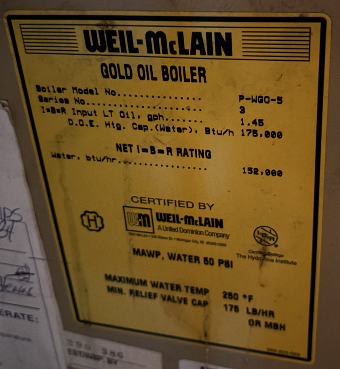

    Here's sticker that's on her boiler - seems to me that it's saying that burns 1.45 gph of oil… not sure what the 175k and the 152k BTU ratings are. 152k is 86% of 175% so I thought maybe that this yields the efficiency but 1.45 gallons of oil isn't only 175k BTU. Can someone clarify? thanks!

    So how do I interpret that nameplate that I posted earlier? Does she really have an 86% efficient boiler?

    Any 90s oil boiler in decent shape should get in the low 80s% combustion efficiency. The net output of that boiler available to heat radiation is 152K
    You could look at the installed baseboard fin tube length and figure it at 550btu/foot. The boiler is probably oversized, and the radiation could be oversized.
    1.45gph will heat a large house and what is on the boiler nameplate may not be what she is actually burning.
