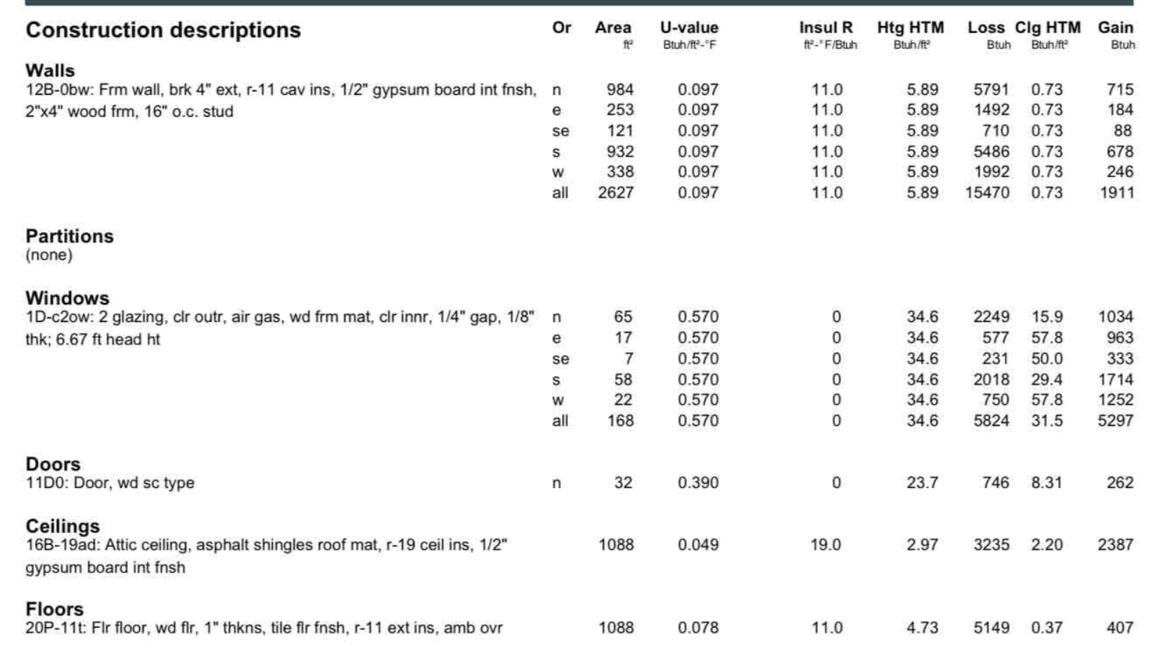

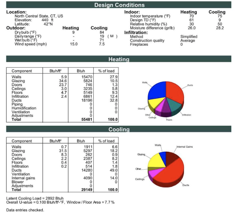

    So now I'm looking into my own home (built 2013 Norfolk County MA). Here's part of the Manual J done by my heat pump installers
    I'm looking at this again so I can do up the spreadsheet provided by @DCContrarian. One thing that I noticed back when I first received it was that it states 2x4 construction which is in error (house has 2x6 construction which I believe was code in 2013 MA ⇒ R-19 vs R-11 insulation) and that the ceiling insulation is R-19 while I believe it's R-30 per code at the time.
    I raised these points to my installer and was told that the R-value "being slightly off" wouldn't matter with the modulating units I have. This seems inaccurate to me since, as I understand it, the ratio of the R values indicate the relative insulating performance of the two materials - is that correct?
    Assuming that's correct - I believe that R-19 is 72% more effective than R-11 and R-30 is 58% more effective than R-19. All and all, heat load of 55K BTU/hr seems high for a 2013 home that's about 2200 sq ft?
    Thoughts?

    It's epidemic in the industry that installers don't trust the Manual J process and put their thumb on the scale to drive the result they want. With combustion appliances it wasn't a big deal, oversizing doesn't really impact efficiency and undersizing is a big problem. With a heat pump you want to size accurately.
    Are your ceilings really only R19?

    18K for the ducts really jumps out at me too.

    Just checked, they're R38 in the attic vs R30 that I thought.
    Here's another heat loss that was done just after we moved in - ducts are much lower @ 6K

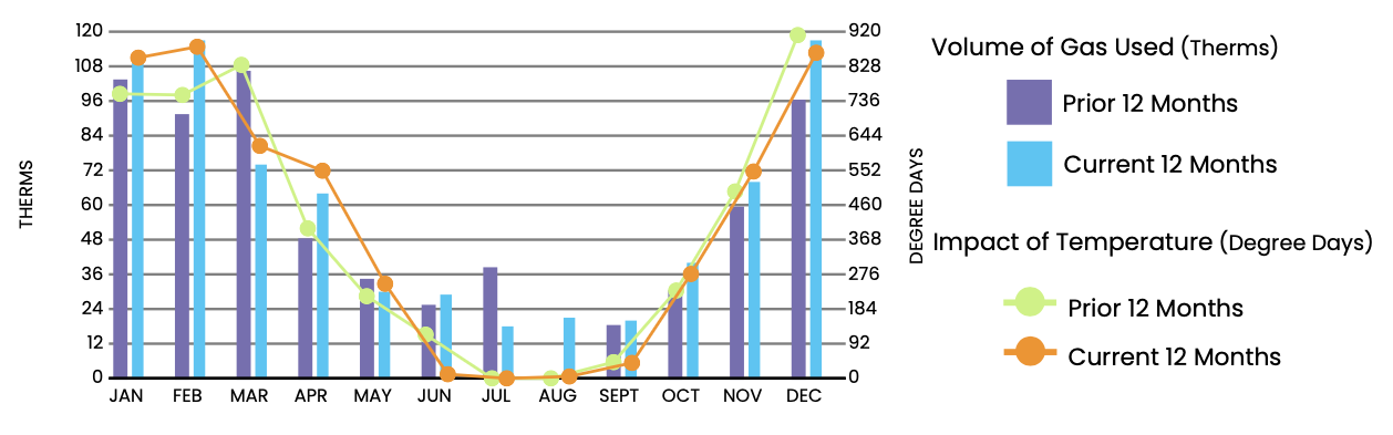

    BTW, can you take a look at my copy of your analysis spreadsheet? I have 2x Lennox EL18XPV and went with 20K heat loss by floor so this spreadsheet is just for one floor which, for simplicity, I assumed 50% each floor.
    If I did it right, what I'm seeing is that it's never more cost effective for me to use my HPs vs the gas boiler. Ultimately, not an issue since I have a good amount of excess solar production. Though, something that's confusing me is that my kWh usage hasn't gone up much since installation (approx 300-400 kWh in winter months which seems to be a good deal less than the 4000 kWh the analysis estimates (HPs used down to 30F)
    Just to clarify, I'm looking at this now mostly to get a better understanding of how much the HPs cost to operate because while my gas bill in 2024 was ~25% less than 2023, my actual usage went up. This seems to be in part to more degree days but still, figured that I should see more of a drop, considering.
    Current = 2024, Prior = 2023 with HPs installed in Nov 2023.

    @JustinS :"BTW, can you take a look at my copy of your analysis spreadsheet? I have 2x Lennox EL18XPV and went with 20K heat loss by floor so this spreadsheet is just for one floor which, for simplicity, I assumed 50% each floor. If I did it right, what I'm seeing is that it's never more cost effective for me to use my HPs vs the gas boiler."
    If the prices you entered are correct, the breakeven COP is 4.94. You don't achieve that until it's 60F and there's zero heating load. So it looks like you're correct.
  • DCContrarian
    DCContrarian Posts: 1,588
    Do your ducts run through an unconditioned attic or crawlspace? Because if they're inside the building envelope there shouldn't be any loss at all.
  • JustinS
    JustinS Posts: 303
    The ducts are all in unconditioned space, either the attic or the basement. Isn't that pretty standard?
    They are well insulated, I believe.
