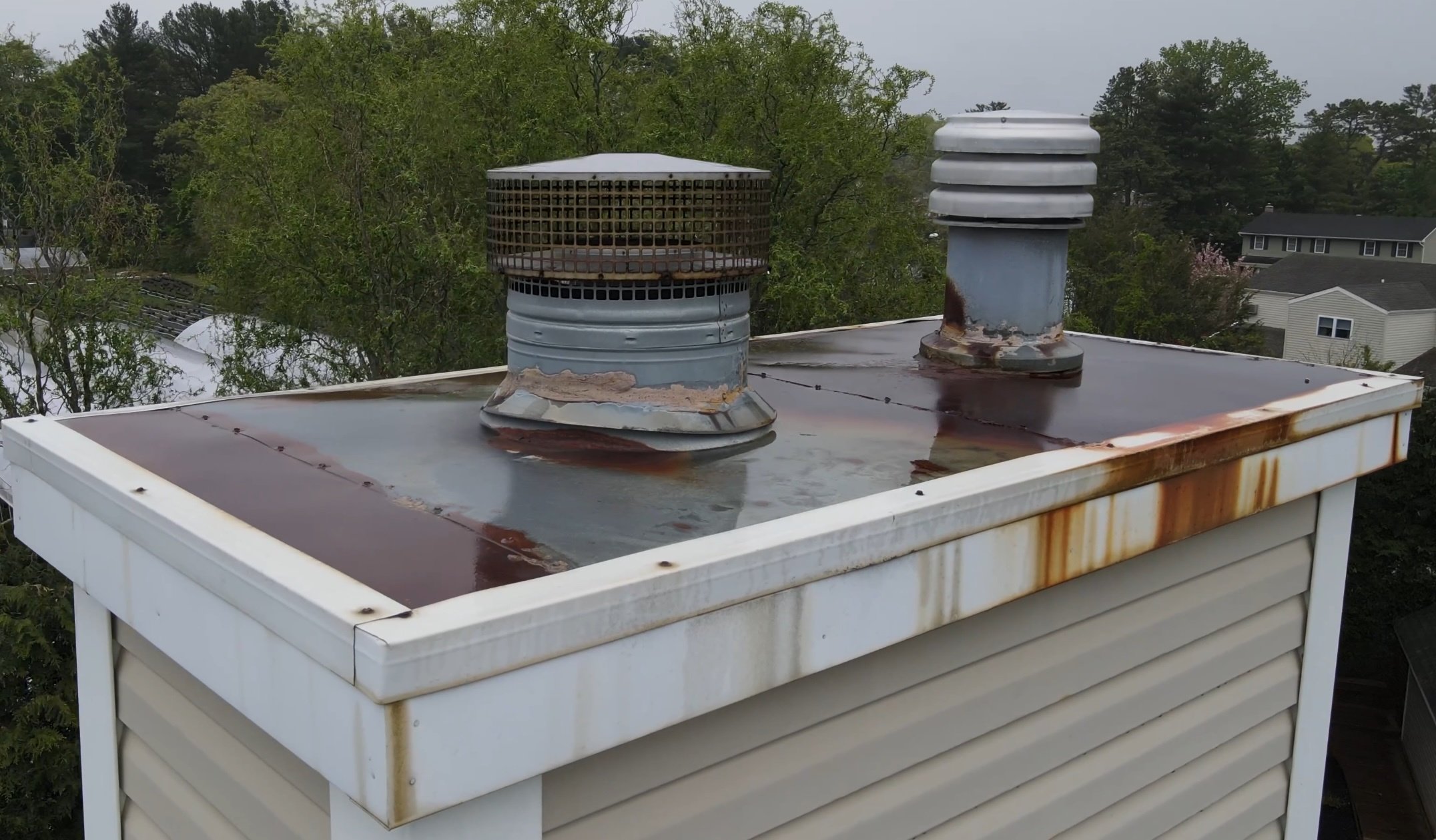

Just moved into a new home and my ES2 keeps triggering the spill switch every so often. The basement is unfinished and spans entire footprint of the home with 9' ceilings. (plenty of combustion air). The boiler is 10 yrs old.
-Took the chimney apart its free and clear (7").
-The boiler came with a flex pipe from the factory I wasn't a fan of so I replaced it with solid smoke pipe with no horizontal, it now has a nice pitch directly up.
-The chimney was showing signs of rust on the flashing which I wasn't a fan of, had this replaced with a fabricated piece of stainless and I was suspecting wind might be playing a role so I got the vacu-stack cap installed as well.
-For good measure I replaced the spill switch
-Gave the boiler a good cleaning each burner etc
-Someone suggested gas pressure might be playing a role, I dialed in the gas pressure which was 4.68 to the factory recommended pressure of 3.5in WC. (didn't believe this was enough off to make any level of difference)
-There are windows in the basement which I had "cracked" but now its open, a month plus has gone past with no events, while I suspected it was a positive / negative pressure issue I have no seen a real method of proving one way or another.
The home has the full complement of exhaust fans, but no active fan triggers this issue. As it has happened in the overnight with nothing on.
A good friend suggested a fan-in-a-can. Like the field control CAS-34U which I am not opposed to buying but is there any definitive method of testing this is indeed my issue, I been living here now over a year and the frequency of this issue makes troubleshooting it a bear
Any help is appreciated

    Ed the basement is unfinished with 9ft ceilings and approx 1500 sq feet. Its one large room no walls. Boiler is Burnham ES2 - ES27 - 210MBH IN 178MBH OUT 85% efficient. Water heater is indirect just swapped that its a HTP stainless. Heating here is hydronic forced hot air. Home is just under 5000 sq ft. Gas dryer is on the first floor.
    I also just ordered one of these, have you guys ever used one? Figured this would put the combustion air needs to bed.
    https://www.fieldcontrols.com/fan-in-a-can-cas-34u-combustion-air-system/
    My original thoughts were, chimney or cap was allowing down draft this is the chimney which was recently all redone and all stainless steel. Boiler is on the left 7" Pipe right is a gas fireplace

    That chimney cap looks pretty restrictive. Does it vent out the sides, or is it open on top but we can't see from the angle?
    jdigangi
  • jdigangi
    jdigangi Member Posts: 15
    The cap is actually not restrictive at all, its built to deflect downdraft.

    The chimney top (flashing) was galvanized and rusting which i didn't like and the cap wasn't great either this was required either way.

  • jdigangi
    Spill switch was tripping since I bought the house (12 Months)
    Steps taken to attempt to correct the issue:
    1- Replaced the spill switch & checked for blockage in chimney
    2- Didn't love the condition of the chimney or cap, had this replaced, suspected down draft was the issue had the best cap to prohibit downdraft installed.
    3- Changed smoke pipe from boiler to chimney from a sweeping flex with a large horizontal run to solid pipe with better slope.
    4- Validated gas pressures - dialed in gas valve
    5- Cleaned boiler
    Each item, "appeared" to make the condition better, keep in mind there is ZERO pattern to when or why this happens. I suspected it was make up air (while I find it unlikely) had the window open for the past 45 days with no events
    I do not own a combustion analyzer, Keep in mind I am NOT a HVAC contractor. Some folks here are very helpful while others are just angry.
    This is the old chimney cap/flashing
