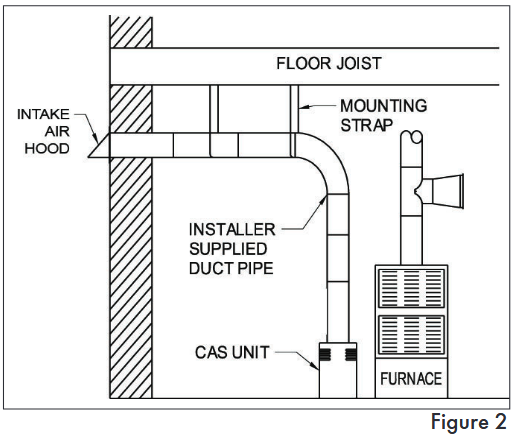

My guess from here, with only the multiple spill sensor failures and the open window test as data. Is an air intake like the image below sized correctly so you don't need the fan (CAS Unit), is what is needed. Combustion analysis could confirm the guess or point to another issue.
One Pipe System2 -
Let me guess it was raining in the basement ?? The CAS34U came today I need to figure out what wall I am going to mount it to. I have a bunch of options to get the pipe lengthy I was shooting for 10-12 feet for good measure. Condensation is the concern with this system they recommend length of pipe based on BTU of the boiler. Length is to allow the air to warm up before it spills on the floor out the can.
