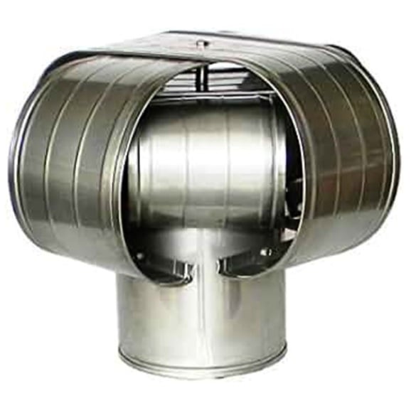

    My original thoughts were, chimney or cap was allowing down draft this is the chimney which was recently all redone and all stainless steel. Boiler is on the left 7" Pipe right is a gas fireplace

    HVACNUT Member Posts: 6,857
    That chimney cap looks pretty restrictive. Does it vent out the sides, or is it open on top but we can't see from the angle?

    jdigangi Member Posts: 11
    The cap is actually not restrictive at all, its built to deflect downdraft.
    https://lindemannchimneysupply.com/vacu-stack-chimney-caps-for-air-cooled-pipe
