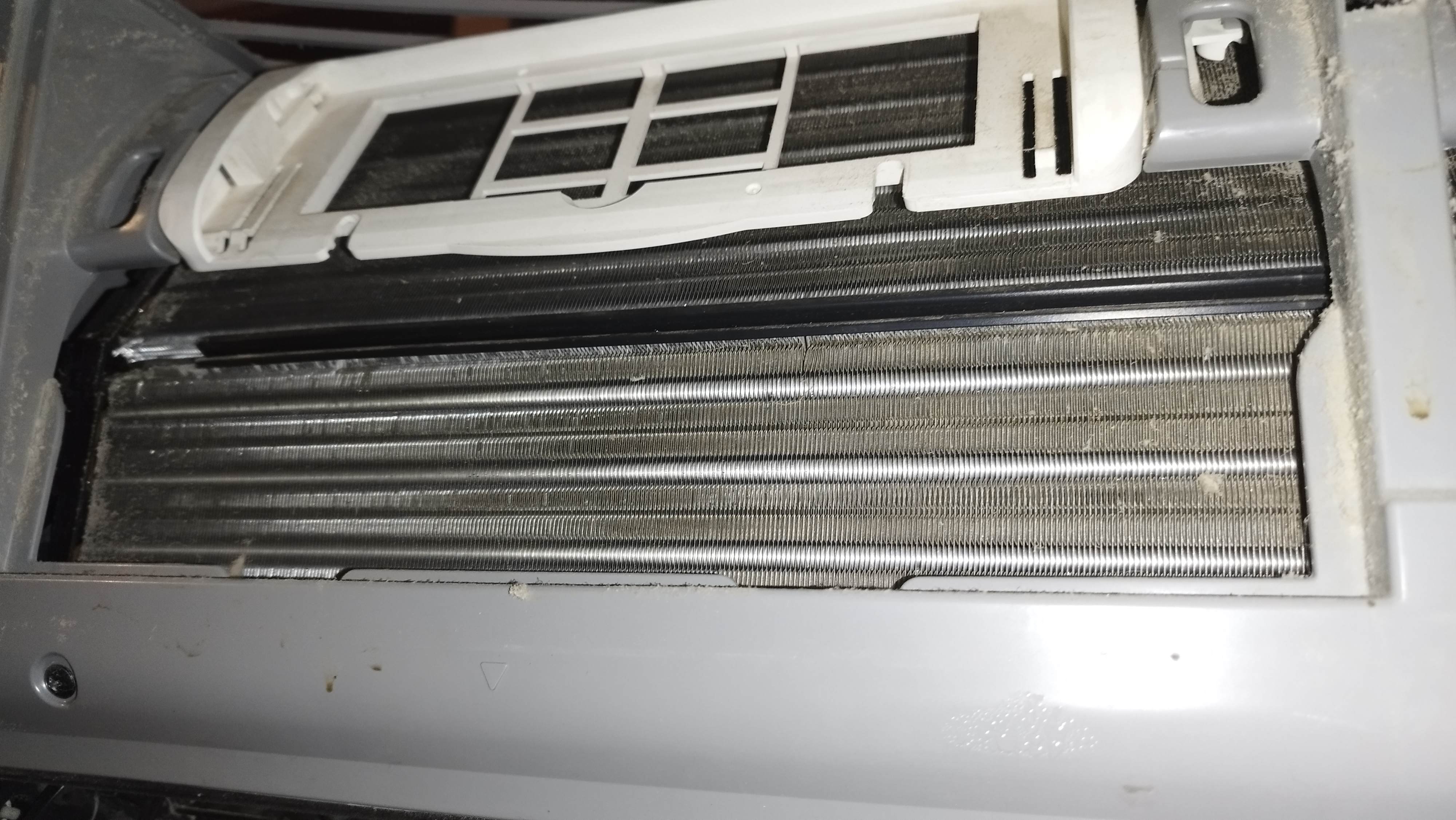

  • Kaos
    Kaos Member Posts: 848
    This is the 10 year old coil on my wallmount. Except for washing the filter, it has never been cleaned. Do get very good runtimes on this head as there are some larger west facing windows.

  • Kaos
    Not the easiest thing to take a picture of but the blower wheel looks like what you would expect for something that sits in pretty much 100% RH most of the time. That is all dust on the surfaces. About 6 years ago the bearing went on the blower and did clean it once when that was replaced.
    Not a fan of wallmount design, they really should have put the blower before the coil like most other units out there.
    @jpm659er The blower not shutting off is by design. There is no way to measure room temperature otherwise and most people won't spend the extra money for a remote.
    This is not really an issue if the unit is sized somewhat correctly and connected to an outdoor unit with good turndown (that is not a multisplit). From the power use on those units, they are cooling pretty much all the time, this means the supply air is bellow 50F all the time.
