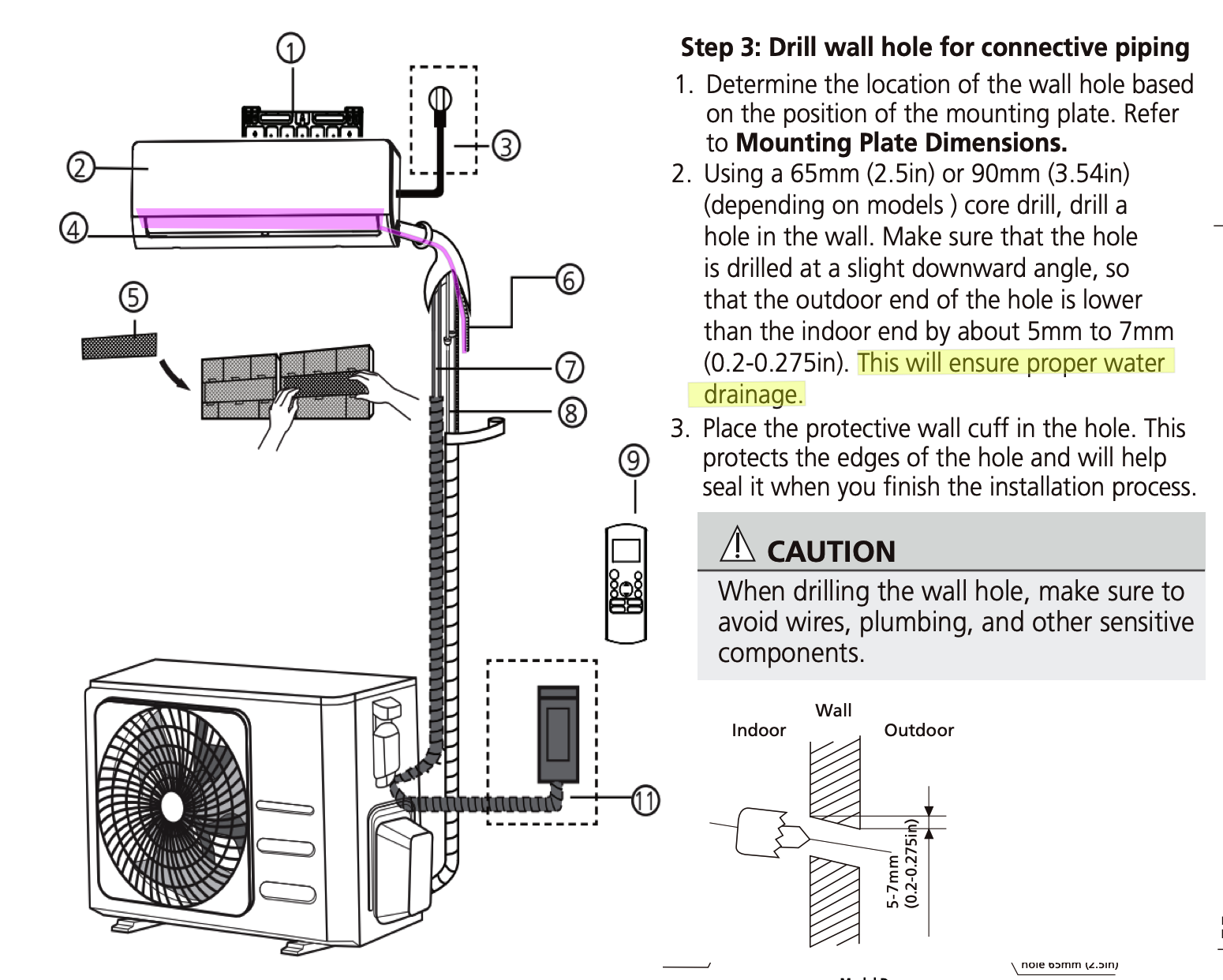

    I have installed a few of the wall mounted units in my day, Never needed a pump unless the unit was in a basement without a proper place to drain the condensate. Then I would add a condensate pump like the one you might use for an air handler in the basement with the same problem.
    The drain pan (violet) is gravity drained in most cases.

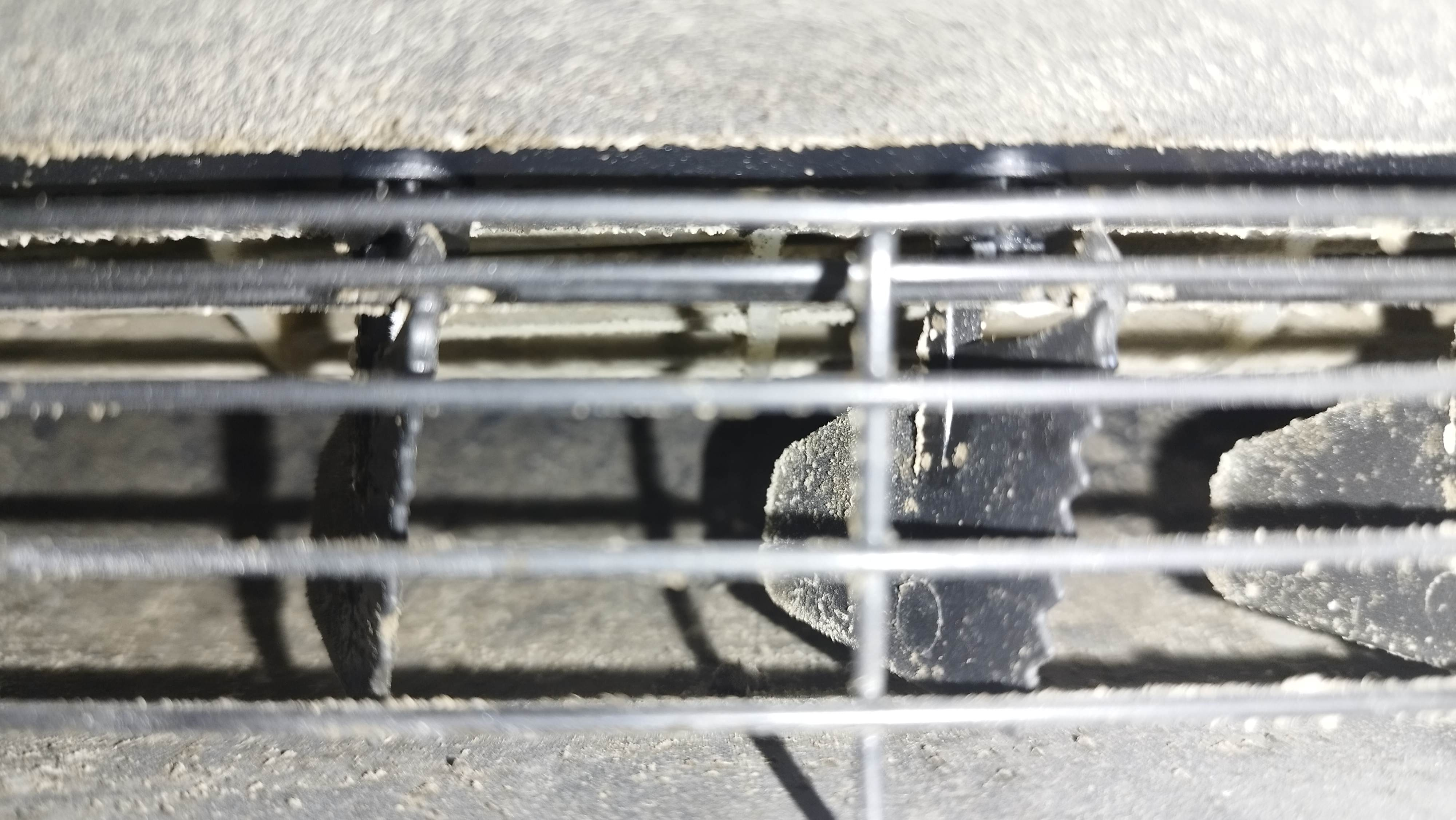

    Not the easiest thing to take a picture of but the blower wheel looks like what you would expect for something that sits in pretty much 100% RH most of the time. That is all dust on the surfaces. About 6 years ago the bearing went on the blower and did clean it once when that was replaced.
    Not a fan of wallmount design, they really should have put the blower before the coil like most other units out there.
