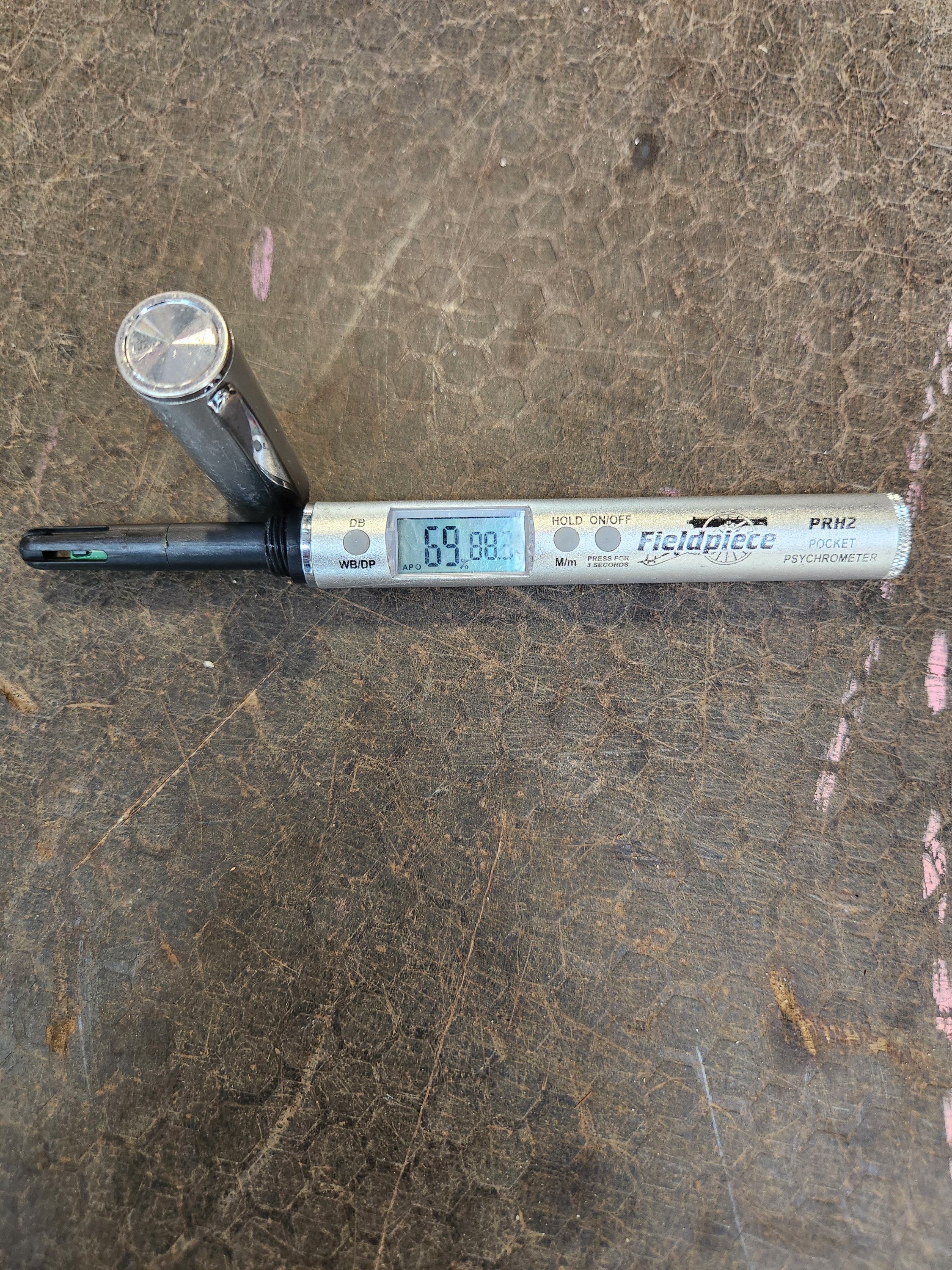

    I've been using this for years. The only accuracy tests are comparing it to the display on dehumidifiers or humidistats I work on. Its always within a percentage or 2, so for the +/- range I need, to me its DOBA. I don't need wb or dew point often. It does take some time to acclimate when you first turn it on. About 5 minutes. After that it registers fairly quickly when taking supply and return readings or something.

    +1 for the Fieldpiece. I've got a couple of 'em (improves the odds since I can only ever find one), plus a dual input and a single input psychrometer, both of which connect wirelessly to my manifold for calculating target superheat.
    None of them are calibrated. I should probably look into doing that.

    I have the same psychrometer that @HVACNUT uses. It doesn't get used very much since I got the Fieldpiece Bluetooth probes

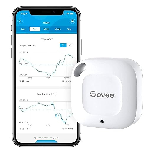

    from Amazon
    govee bluetooth works very well for $12.00. Battery lasted for several years.
