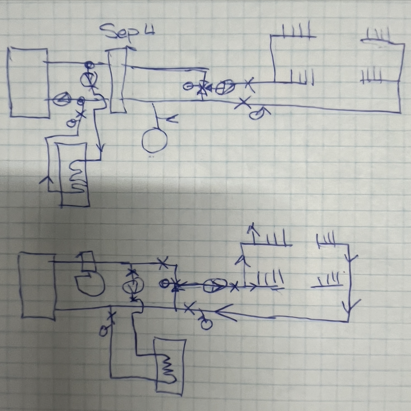

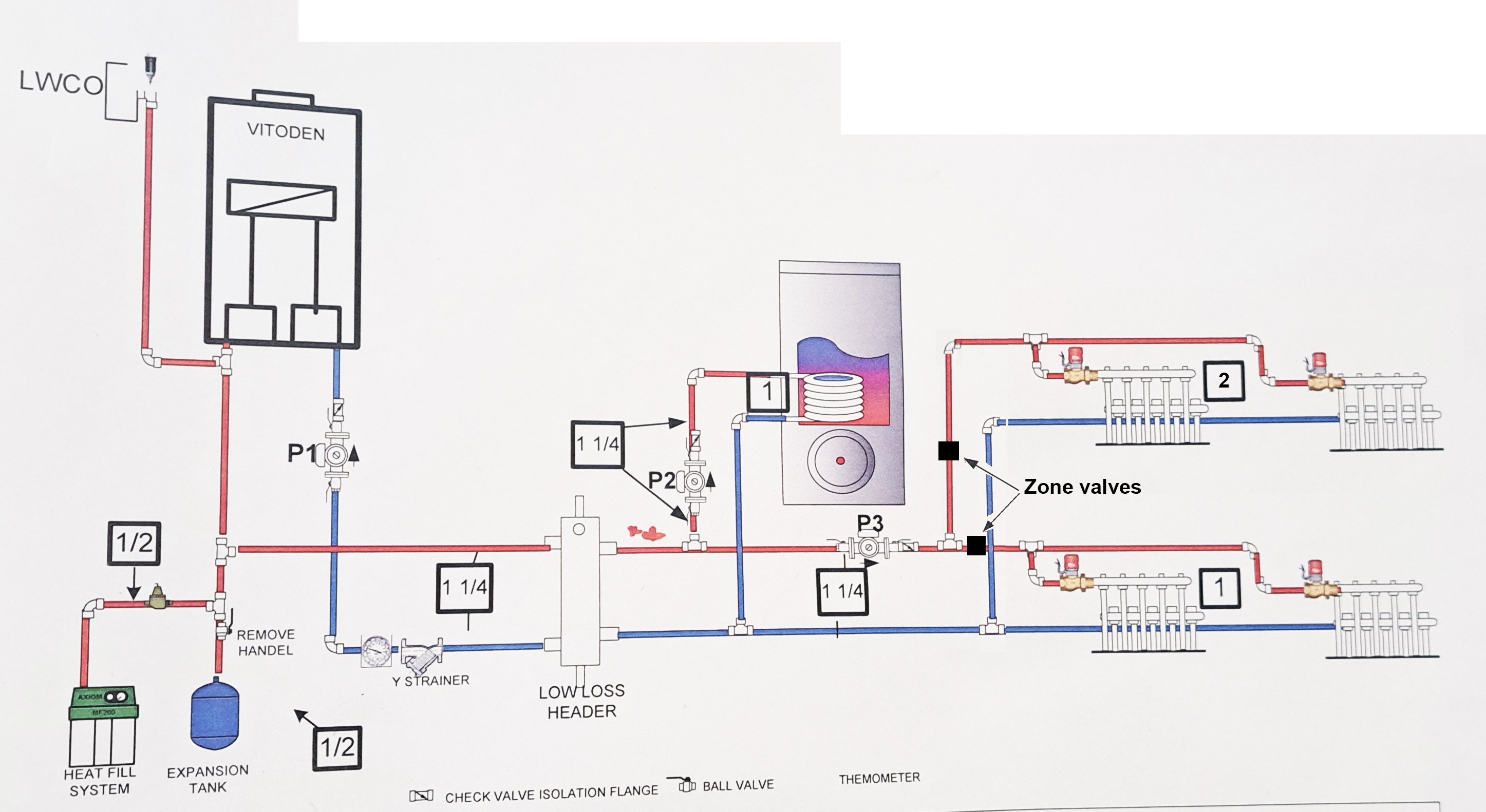

    Your last paragraph is likely where my confusion comes from. I have attached below a diagram of the propane boiler system in my parents house. One zone for basement, one for garage, and one for DHW tank. There is no mixing valve that I can see. It does have outdoor control, which I assume is just varying the temp of the boiler water. Is there an implicit mixing valve or something I am missing here?

    hot_rod Member Posts: 25,710
    Use a 4-1 type hydrosep for air, dirt, magnetic and hydraulic separation. Eliminates the y strainer
    P 1 is the boiler pump, it runs on any heat call. Needs a check valve
    P2 is the indirect circ, it runs for DHW, P1 is off. Needs a check valve
    P3 is the low temperature, always pump away from the 3 way mix valve.
    The boiler runs on outdoor reset, 135 minimum for boiler protection.
    The lower drawing is without a separator, if the manufacturer allows direct piping.
    P1 indirect
    P2 radiant mixed down via 3 way
    Expansion and fill connect at the separator into either of the bottom ports.
    Depending on the pressure drop through the boilers, you may not need a hydraulic sep. Unless the manufacturer requests it? The smallest zone needs to assure enough gpm through the boiler.
    Bottom drawing is a two temperature system with indirect
    Screenshot 2025-07-08 at 9.57.01 PM.png Screenshot 2025-07-08 at 9.41.12 PM.png

    @skippy_ said: Your last paragraph is likely where my confusion comes from. I have attached below a diagram of the propane boiler system in my parents house.
    I don't see in that diagram how the radiant floor water temperature can be different from the DHW tank high temperature without a mixing valve of some type. The only way this might work is if the DHW has priority and can send the boiler to 160° or above to make DHW. When there is a call from the lower temperature radiant zones during the DHW high temperature, the higher temperature boiler water must drop quickly so the floor does not get the 160° (or higher) water so not to overheat the floor. That can end up working with the proper control system. There may be some short bursts of higher temperature water to the radiant loop(s) but that will dissipate in the radiant floor concrete quickly and the lower temperature water from the boiler will take over heating. There can never be a simultaneous call for radiant and DHW.
    I don't see that same design working on an oil fired boiler system, as of this date there are no ModCon oil fired boilers on the market. Oil boilers are either on or off. There are 2 stage flame burners for oil, but those burners are only offered in commercial sizes. Also, the nature of Cast Iron boilers indicates the minimum return water temperature of 135° to prevent flue gas condensation and ultimately premature boiler failure, means that the supply temperature must operate above the maximum water temperature of the radiant zones. A mixing valve is a must for the oil fired systems.

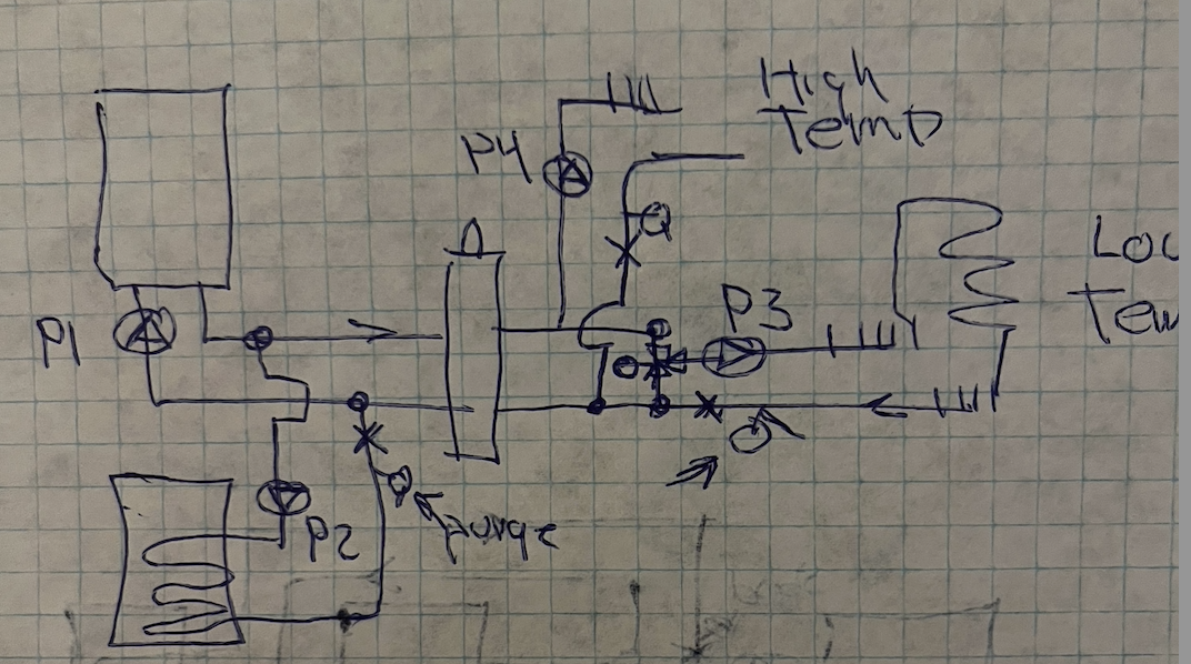

    I do not see how P1 can be off if P2 is on. I assume this is a typo unless I am missing something.
    For 2 low temp zones, would I tee in before the mixing valve and add a second mixing valve for the other zone, or would one mixing valve serve two zones each with their own pump?
    @EdTheHeaterMan said: I don't see in that diagram how the radiant floor water temperature can be different from the DHW tank high temperature without a mixing valve of some type. The only way this might work is if the DHW has priority and can send the boiler to 160° or above to make DHW.
    This must be what it is doing. I double checked the boiler piping and the diagram is correct - there are no mixing valves. This is what was confusing me as I never realized it must be doing some kind of control scheme in the background to allow different temp water to the floor and DHW tank.

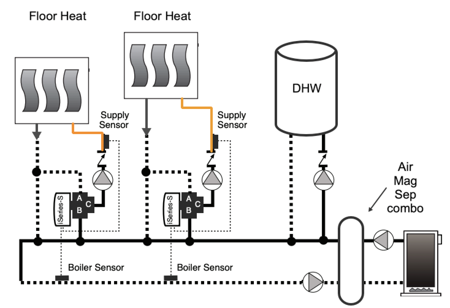

    EdTheHeaterMan Member Posts: 11,130
    edited July 12
    A fixed temperature mixing valve will not track with the boiler's ODR. A fixed temp mixing valve will take the changing boiler temperature and add more or less return (cold in) temperature water to create the set temperature of that mix valve. In order to get true ODR for the floor heating slabs you might consider using something like this: Taco I-Series ODR valve This will do the mixing from the higher temperature Boiler/Buffer Tank/Separator water. I don't know if @hot_rod's company has a similar product but if they do, then He would know the best Hydraulic separation/air elimination/pumping away/mixing valve design for your situation. I might start here:
    • 2 Taco iSeries mixing valves
    • 5 pumps (boiler, system, basement, garage, DHW)
    • hydraulic separator if needed to maintain boiler temperature and/or reduce short cycling
    • oil boiler with hydrostat
    • Taco iSeries valve motors or equivalent controller
    You can place the mixing valves near each floor system.

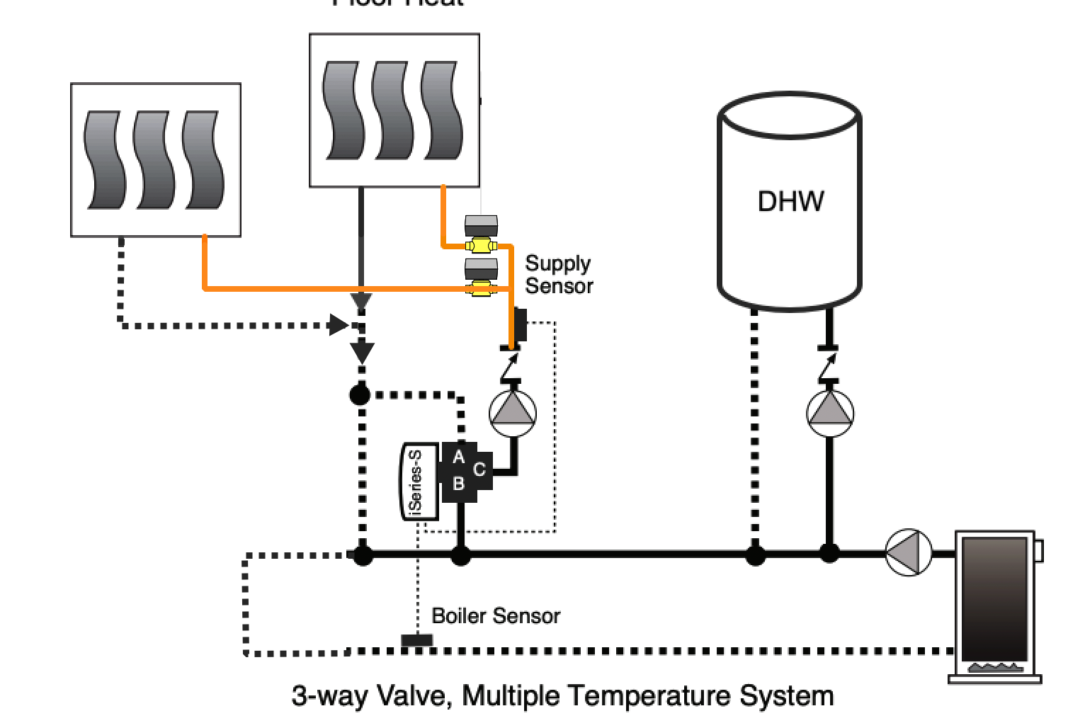

    EDIT: To save on pumps and on iSeries valve you could eliminate the Separator and use one mix valve for both floors. The mixed water can be made in the boiler room and lower temperature water piped from the boiler room to the two different floor locations.
    • 1 Taco iSeries mixing valve
    • 3 pumps (boiler, low temp, DHW)
    • 2 Zone Valves

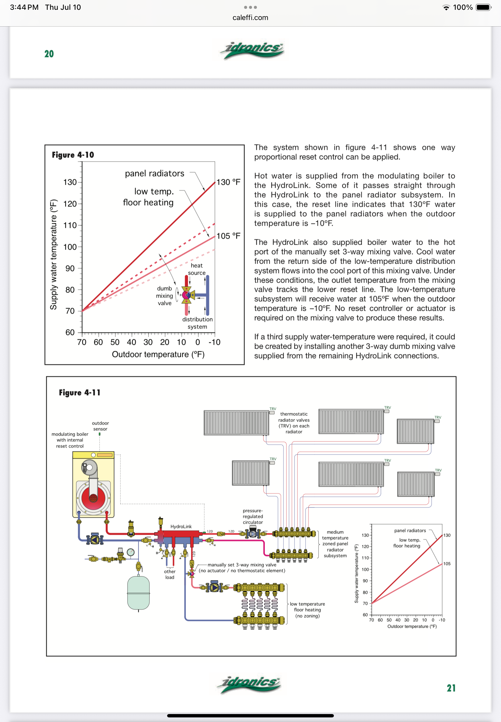

    If you use a hydraulic separator you could pipe the indirect on the primary side of the sep and you only need to run 1 circulator when the tank calls as a priority zone. Also you get full boiler output to the tank. The indirect on the secondary side requires you run the boiler pump and the indirect. You get some temperature blending in the separator, so the indirect may not get the full boiler temperature.
    Proportional reset uses a boiler with ODR, then a manual “dumb” mix valve supplies low temperature zones. So that manual mix valve tracks along with the ODR reset. I had this mixing option my last home.
    Here is a better explanation from Idronics #7
    This example has a mod con modulating on ODR feeding a panel radiator system, the radiant is via a manual valve.
    Thr HydroLink is not required to make it work. A hydro sep or close tees works IF the boiler needs a dedicated circ
    I made an edit to the Taco Mix I-series Mix valve. I did not select the outdoor reset offering. this is it:Taco I-Series ODR valve here and it is corrected above. I also agree with @hot_rod Bob on piping the indirect before the separator. Good call on that one.
    edited July 18
    The forced air runs off the boiler as a high temperature loop? Or is all the hydronics low temperature. If so a mod con lp boiler would be my choice, running ODR.
    the manual mix valve will in fact track with the boilers changing temperature. As the boiler drops so will the mix from the manual valve. The manual valve does not have a sensor, it is a fixed blend.
    On the mix down manual valve you can also adjust the offset, dotted red lines, how it tracks with the higher temperature.
    This shows the relationship with a 130 panel rad system, but it could be a 160, 180 or higher zone also.
    There is no reason to have ODR on the boiler and also on the low temperature zone.
