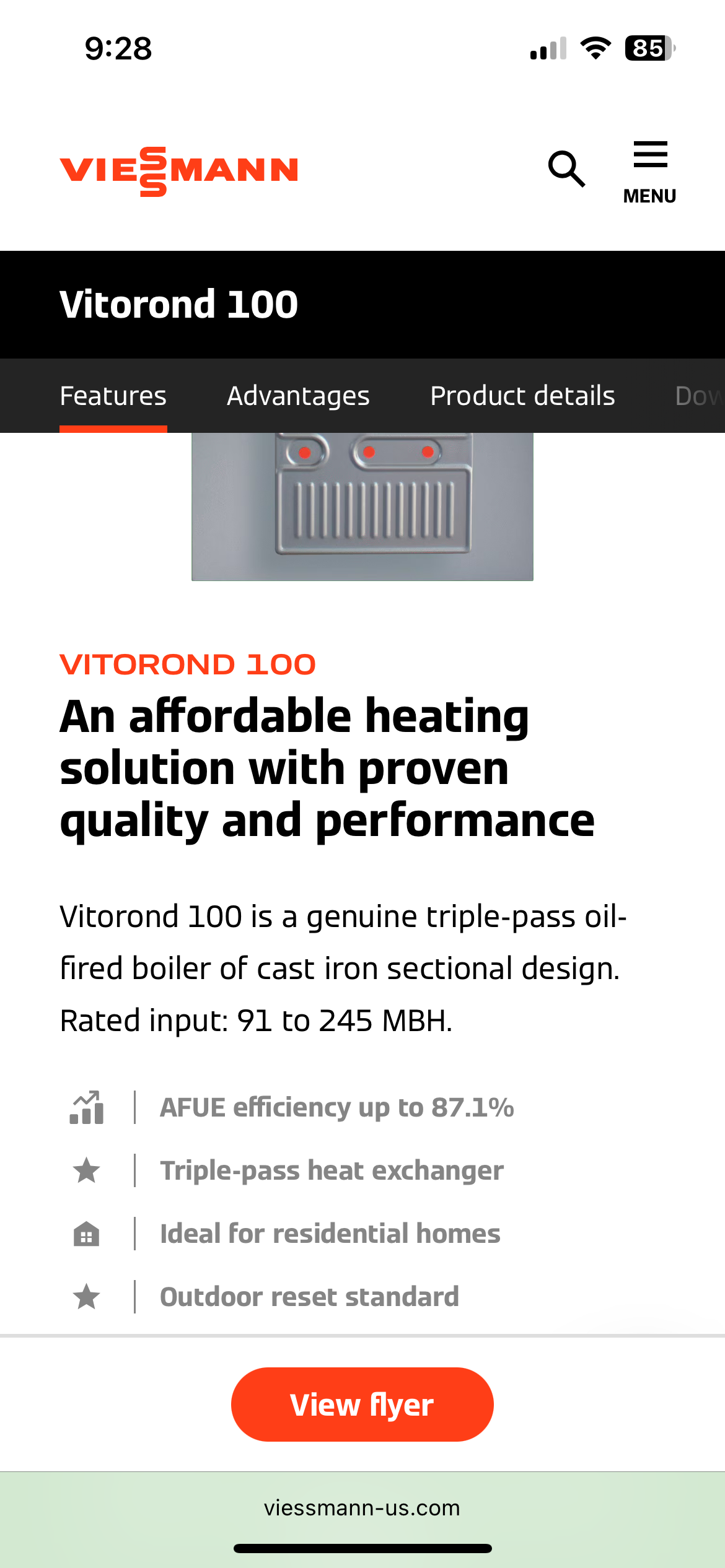

I have been looking at an NTI Caprice oil boiler or a Viessmann Vitorond oil boiler. I've been told by the plumbers that due to the higher temp of oil boiler vs propane, I will need to have mixing valves installed in the loop to reduce the temperature enough for the floor heat.
However, the marketing materials for both boilers talk about using a hydrostat and outdoor ambient temp sensor to lower the boiler water temp and account for varying heating loads. I'm having trouble understanding how this would be any different than a propane boiler. I understand that oil has more heat per volume than propane, but shouldn't this just cause the oil boiler to come up to temp quicker and run less than a propane boiler?

    I guess the first decision is which fuel is going to be used?
    If it is LP a mod con is my suggestion, I believe they all have ODR
    If it is oil, the Viessmann oil also includes ODR. Some. Viessmanns have a basic return protection function, a simple aquastat that holds the pump off if return drops too low. although the ODR control may include return protection also.
    Download the manual, Viessmann usually has top notch control logic onboard
    What is the heat load for the completed project? The smallest Vittorond may be too large? Another reason to consider a mod con on LP. The modulation alone is worth the consideration

    A WAG of 25 btu/ sq ft for the house and solarium = 37,500 btu/ hr
    A well insulated 1,000 shop maybe 20,000
    So a 50- 60,000 boiler would probably cover it. You could let the garage drop if you come up short on below design days
    Im not sure what the smallest oil boiler you can buy is?
    That Viessmann may be twice what you need 95K
    Since the oil will not modulate, on mild days it may cycle a lot. So the efficiency number takes a hit. So for comparison oil at 80%, lp 87+
