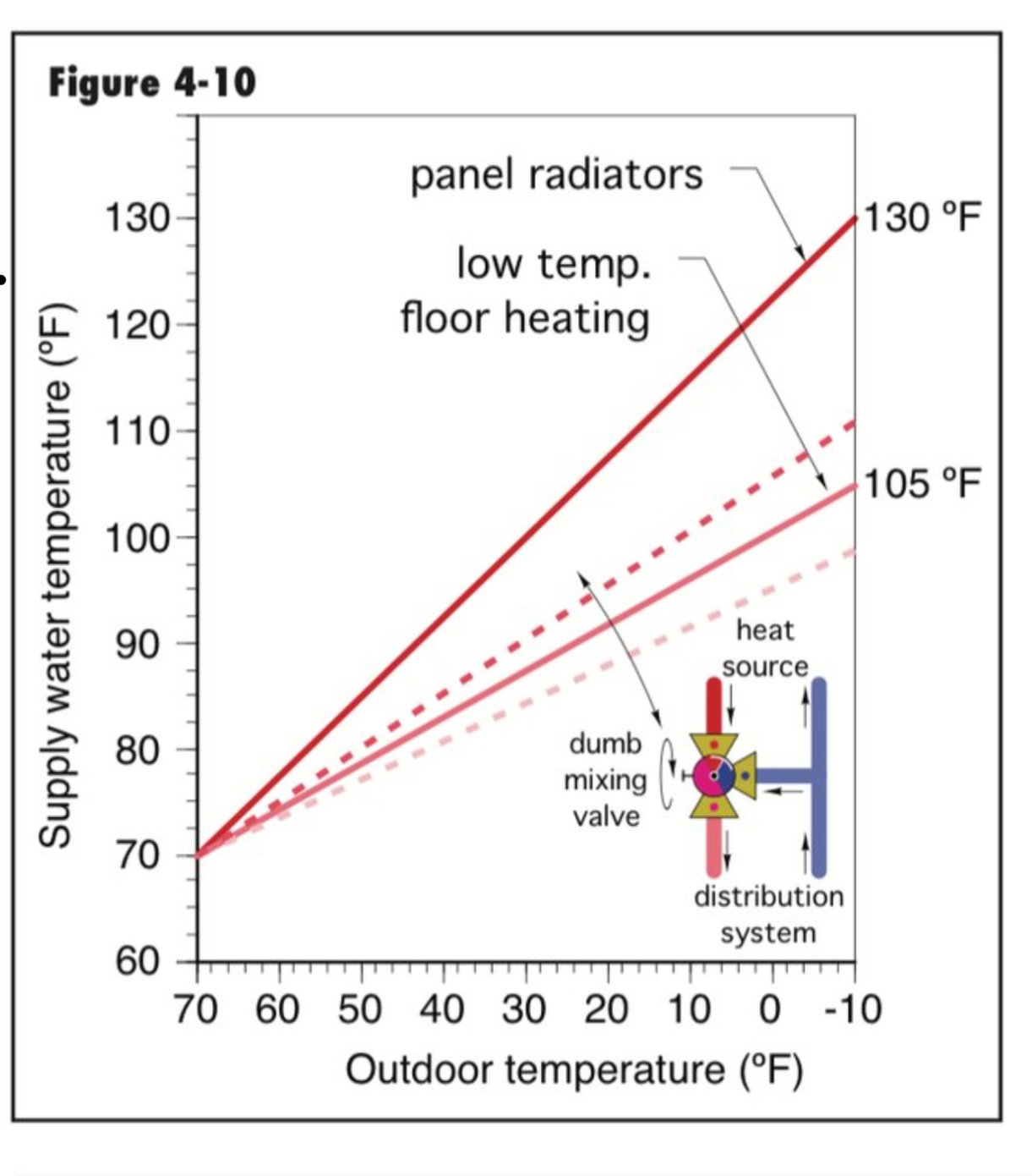

Proportional reset uses a boiler with ODR, then a manual “dumb” mix valve supplies low temperature zones. So that manual mix valve tracks along with the ODR reset. I had this mixing option my last home.
Here is a better explanation from Idronics #7
This example has a mod con modulating on ODR feeding a panel radiator system, the radiant is via a manual valve.

the manual mix valve will in fact track with the boilers changing temperature. As the boiler drops so will the mix from the manual valve. The manual valve does not have a sensor, it is a fixed blend.On the mix down manual valve you can also adjust the offset, dotted red lines, how it tracks with the higher temperature.
This shows the relationship with a 130 panel rad system, but it could be a 160, 180 or higher zone also.
There is no reason to have ODR on the boiler and also on the low temperature zone.
