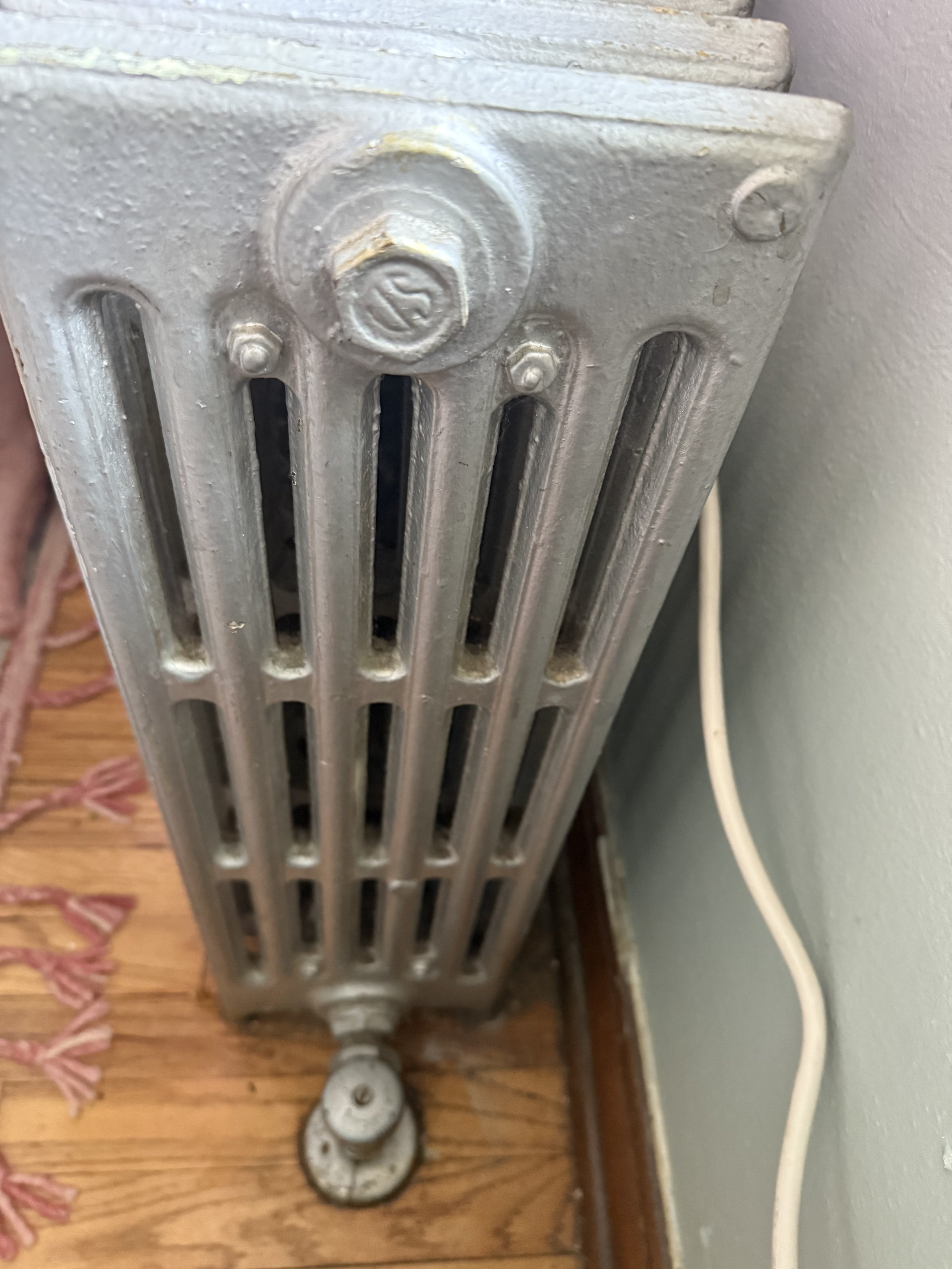

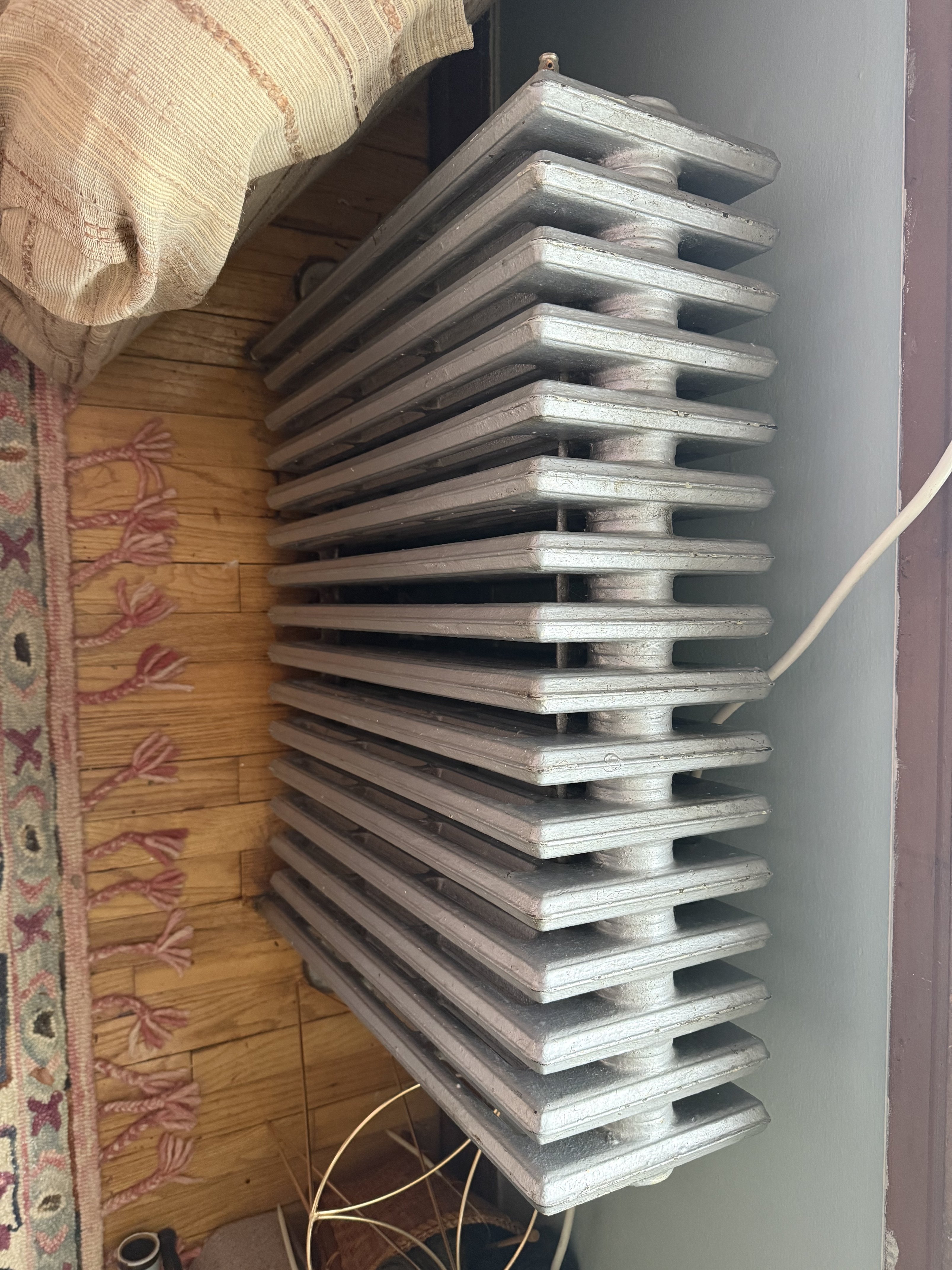

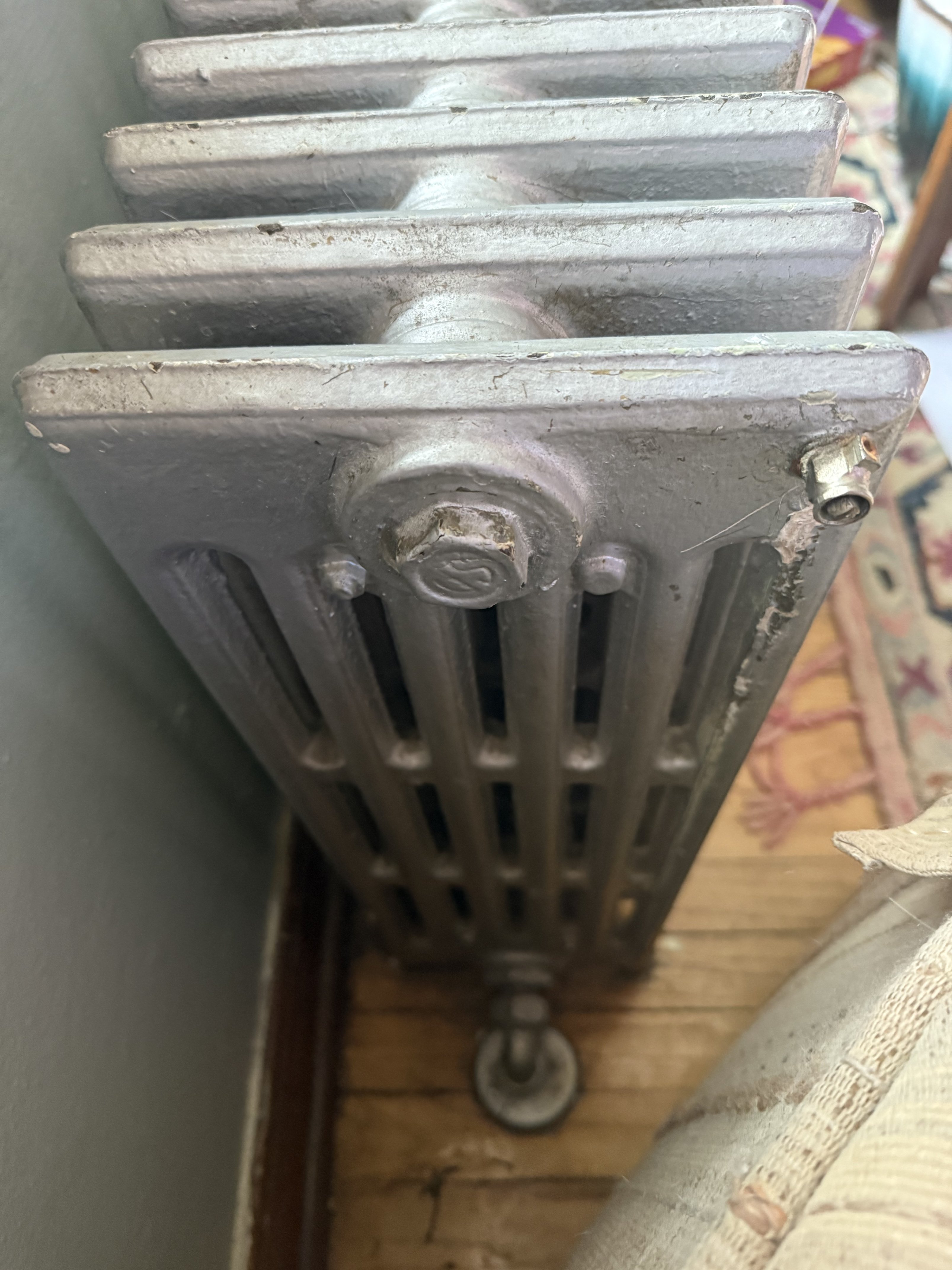

    I’m not sure if it’s steam or water. I’m thinking water because the landlord had people come into bleed the radiators before turning them on the first year. Looks like there’s plumbing on both sides of it. I’m uploading pictures with this comment.
    I’ve looked at covers, but most seem to be purely for aesthetic and that would be only as a last resort.
    The other tenant on the third floor of our side of the building also experiences this but treats it as the norm. He also claims to be the “manager” of the building and receives close to free rent due to a mental disability of some sort in exchange for putting trash on the street and is supposed to salt the driveway, sidewalks, and stairs but will only use sand. He would not say anything to the landlord.
    I’ve made the case of saving money to the landlord. His response if I ask too many times is for me to move out. He is lucrative and owns many buildings privately. I think he would rather just not be bothered. Getting him to fix my sink faucet was a nightmare.
    He did have people come out to check the thermostats which are in the hallway on the first and second floor, but said there was nothing more he could do as the heat was already set at the lowest legal temperature of 67 degrees Fahrenheit. I brought up replacing the valves and never heard back.
    I hate having to be persistent on this and really don’t want to cause trouble. I like my apartment very much, but the winters shouldn’t cause me grief year round by just the thought of the heat.
  • wisco
    wisco Member Posts: 15
    From the logo, I’m guessing it’s from the United States Radiator Corporation. It looks like the 6-tube Capital thin-tube radiator but it also looks wider than the pictures of models I’ve come across.

    Looks to be hot water heating.
    The valves are designed such that even when off completely, there is still a small port to pass water thru to prevent freezing……it is working isn't it.
    I would go for the blanket or heavy rug draped over the radiator. The max temp should be 180 or less. Use cotton or wool IMO.

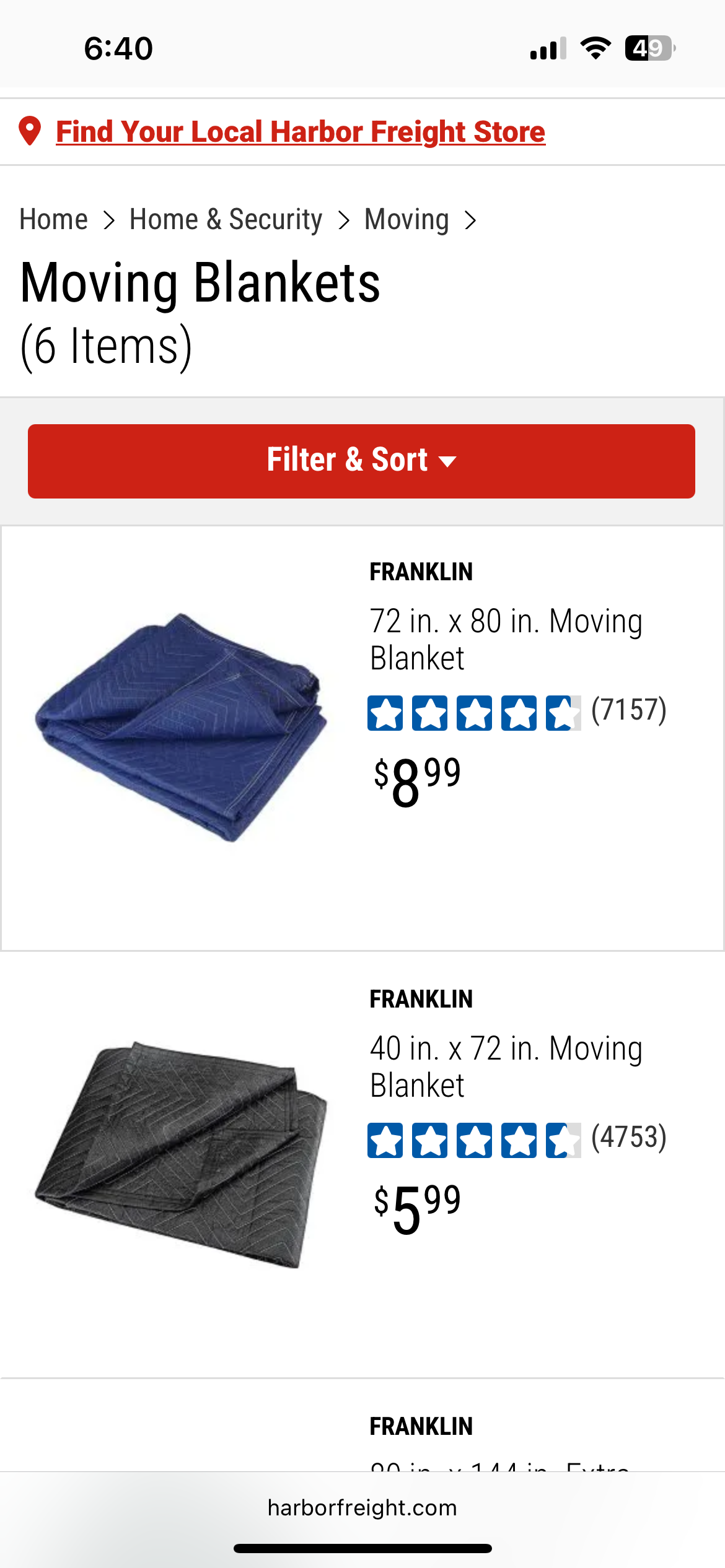

    EdTheHeaterMan Member Posts: 10,869
    Can I say this again? Or am I being redundant.
    Untitled Image
    You might be able to get some quilted blankets at a Goodwill store or other second hand shops for $10.00 each. If you have 6 radiators, then you problem is fixed for $60.00
    The other route is to call the local department of health, or equivalent government agency and show then the problem when it is happening. That means you will need to wait until next December or January to file an official complaint. The Government will not just take your word for it. The Government needs to send a civil servant with a clip board and a thermometer to verify your claim. And it needs to be excessive. like 90 or higher for there to be a real violation. Just complaining about 85° may not cut it because 85° is higher than the minimum 68° required by the health department and the rental laws on the books. I doubt that there is a maximum that is too high.
    I wonder if a window air conditioner might help in your situation. Do you pay your own electric? If the electric is included in your rent, then plug in several window AC units to be comfortable.
    hot_rod Member Posts: 25,486
    quilted moving blankets are inexpensive at Harbor Freight
    UHaul sells them also
