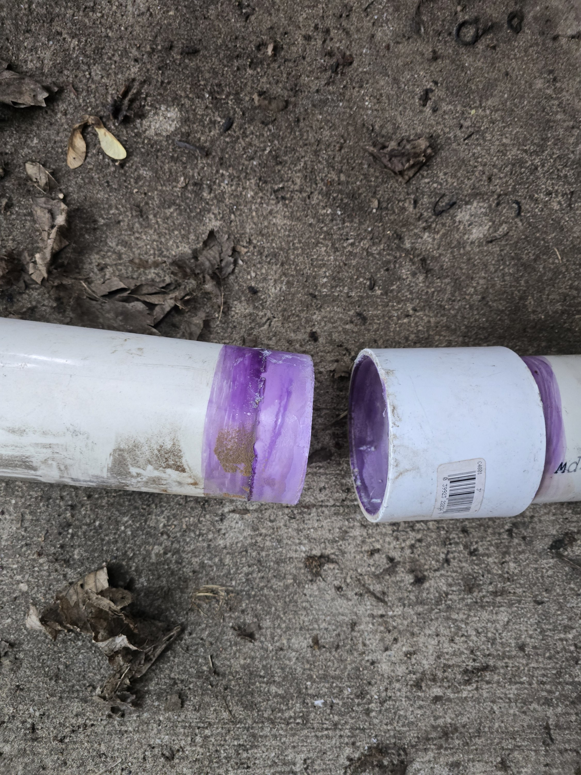

Installed approximately 17 years ago...glue joint pulled apart easily. Mad Dog
    EBEBRATT-Ed Member Posts: 20,070
    Obviously from what we have learned PVC for flues is not a good idea unless approved and the only one I know that is is Ipex,
    It looks like the glue and primer is good but who knows.
    Dis they sand the fittings and pipe?
    was the glue old?
    did they let the primer dry tooo long b4 gluing?
    It doesn't look like the PVC was overheated, it usually turns brownish.

    yeah, that looks like the glue was allowed to dry too long before assembling or they went over it a couple times because it dried

    This Installer, whomever it was, was neat, conscientious and thorough...using plenty of primer and glue. I'm not supporting installer error. Mad Dog

    That PVC pipe and coupling was not pushed in all the way. There is no way that pipe bottomed out in the coupling. My guess is the installer didn't notice it was pushing apart before it dried. The PVC is still white like its relatively brand new.
  • LRCCBJ
    LRCCBJ Member Posts: 1,043
    I am a bit curious on how you came to that conclusion. How can you know if it bottomed out or not by looking at the two photos? You certainly cannot judge this by the length of the primer.

    very first picture looks like it could have gone in a little bit further, maybe 1/4 to 1/2 inch but kind of hard to tell. my unprofessional view is operator error but again, what do i know. thanks matt for the topic. i learn something new all the time.

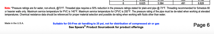

    What I find is
    PVC 140°F max

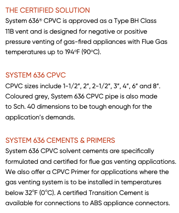

    IPEX 636 CPVC (flue gas certified) 194°F, with their solvent and glue

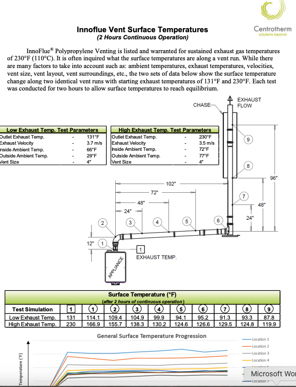

    Centrotherm PP 230°F continuous

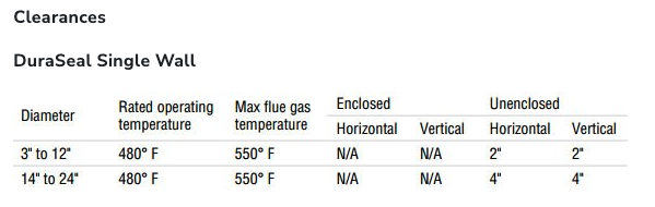

    DuraSeal single wall stainless 480° operating, 550°F max
    Flue gas sensor on my Lochinvar Knight is 225°F to shut down burner. So essentially only the Centrotherm and SS vent pass the potential flue gas temperature question
