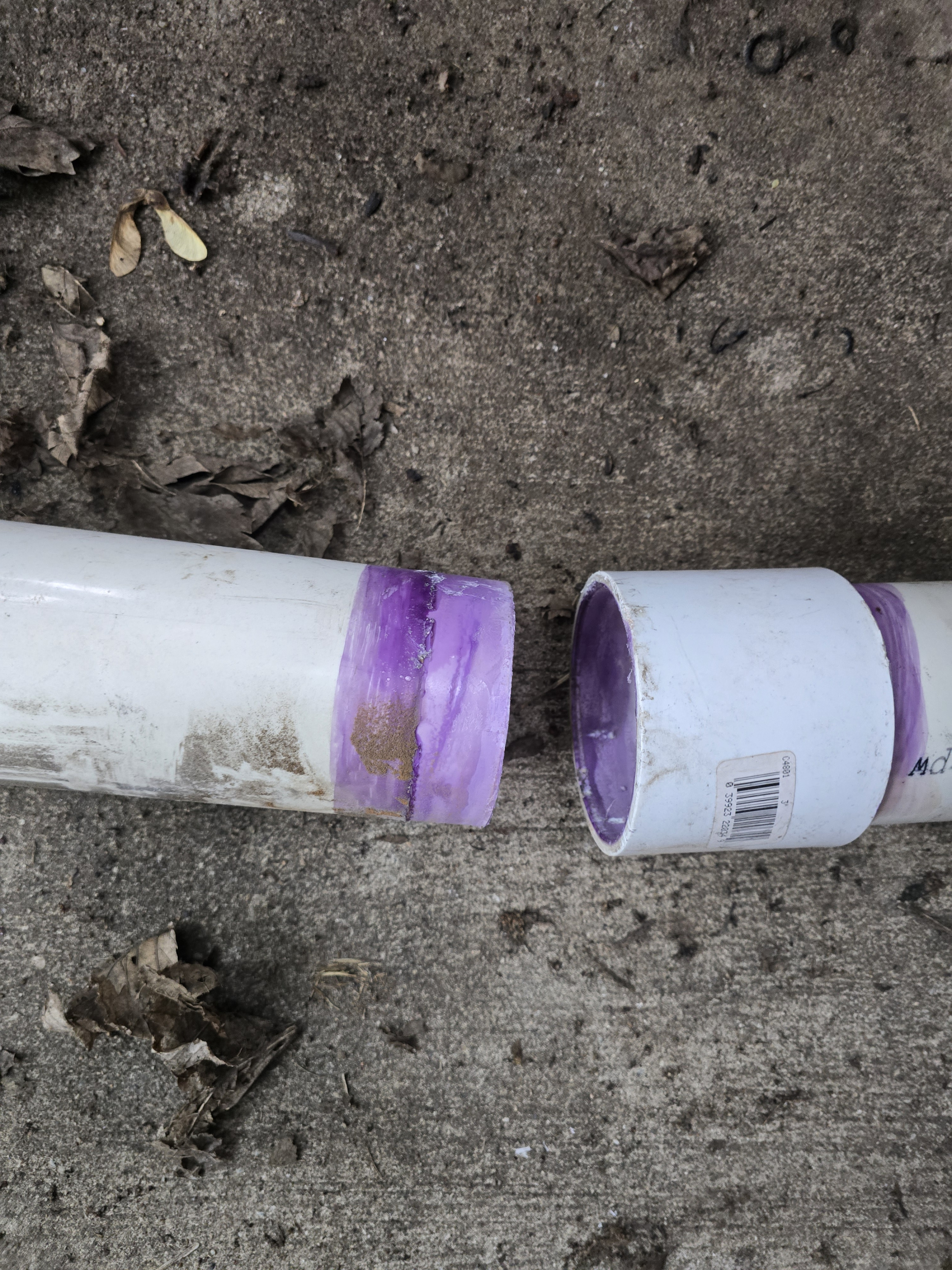

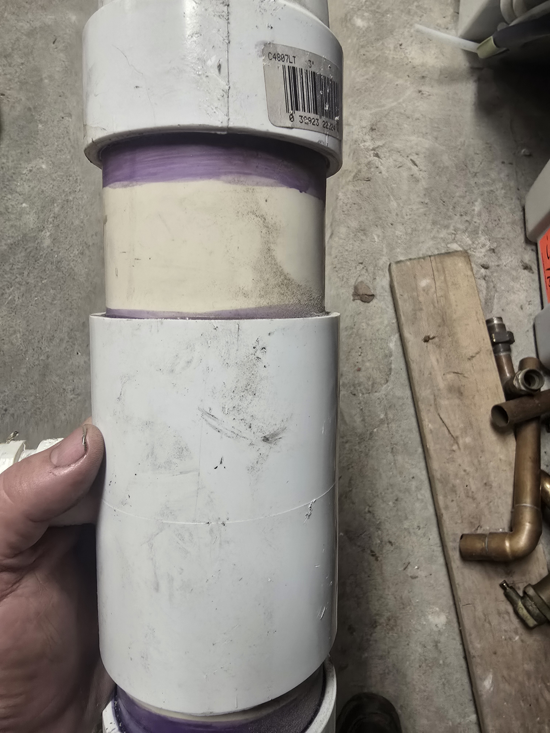

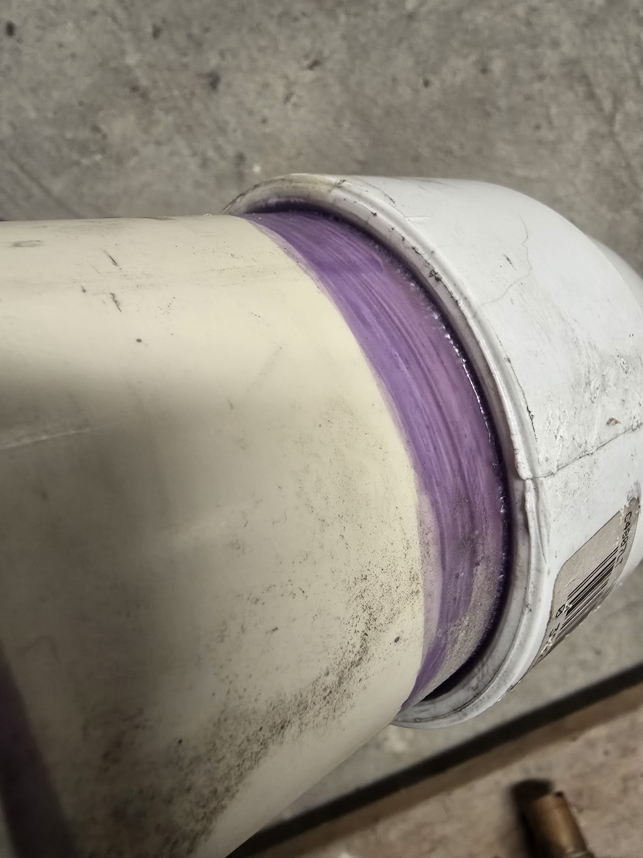

Installed approximately 17 years ago...glue joint pulled apart easily. Mad Dog
    Obviously from what we have learned PVC for flues is not a good idea unless approved and the only one I know that is is Ipex,
    It looks like the glue and primer is good but who knows.
    Dis they sand the fittings and pipe?
    was the glue old?
    did they let the primer dry tooo long b4 gluing?
    It doesn't look like the PVC was overheated, it usually turns brownish.

    yeah, that looks like the glue was allowed to dry too long before assembling or they went over it a couple times because it dried

    I installed dozens of GB- 142s with PVC exhaust before they banned it in NY. Never seen it be an issue, but apparently "they" decided it was. Mad Dog

    This Installer, whomever it was, was neat, conscientious and thorough...using plenty of primer and glue. I'm not supporting installer error. Mad Dog

    It doesn't have that toasted marshmallow look. Any other joints come apart that easy?

    pedmec Posts: 1,488
    That PVC pipe and coupling was not pushed in all the way. There is no way that pipe bottomed out in the coupling. My guess is the installer didn't notice it was pushing apart before it dried. The PVC is still white like its relatively brand new.

    I am a bit curious on how you came to that conclusion. How can you know if it bottomed out or not by looking at the two photos? You certainly cannot judge this by the length of the primer.
    Mad Dog_2
  • very first picture looks like it could have gone in a little bit further, maybe 1/4 to 1/2 inch but kind of hard to tell. my unprofessional view is operator error but again, what do i know. thanks matt for the topic. i learn something new all the time.

    That looks like 2" PVC. 2" couplings are a poor excuse of connection IMO.
    I Have always used pressure couplings for 1 1/2 and 2" venting and DWV…..over twice the bury and better stability.
    The ratio of bury to circumference gets better at 3", 2" is the worst.

    I have used PVC venting on scorched air systems for over forty years. That is clearly a poor installation job. A proper connection is actually a solvent WELD, impossible to disassemble after curing.

    You can armchair quarterback your opinions and guesses as to the failure but without lab analysis you are still just grasping at straws. Was it installed per the mfrs. listed instructions as well as those of the PVC pipe mfr, the primer and the solvent cement? Was the pipe used within the approved applications by the pipe mfr? Was the pipe properly supported? Was it leak tested prior to use? Was the appliance inspected and tested including gas pressures, orifices, firing rate, MUA, intake air obstructions/ sizing/ pressures? Flue gas outlet temperatures? Any signs of overfiring in the unit or historical evidence such as tripped safeties? Was the heat exchanger ever replaced? Lot's of questions in a forensic investigation.
    I don't like PVC for a number of reasons: The pipes out there were never listed for this use but specifically forbidden per most pipe mfrs. While the pipe itself might withstand short term temps upwards 170F, the solvent cement routinely fails at 140F or lower. I've never seen an HVAC tech properly cut, chamfer, deburr or join PVC for venting. Never. I see pipe cut with a Sawzall held with one hand and the pipe with the other. The end of the pipe resembles a hole saw with all its jagged edges. The end is never chamfered nor deburred and there is no way to tell externally once the joint is made. Meanwhile, inside, the rough joint plows the cement pushing a dam of it ahead while scraping cement from the outer walls. The result is a very weak, often leaky joint.

    when glue gets old and starts to gel it doesn’t work so well
    PVC that turns beige is an indication of over heating. If the boiler runs 140f continuously it is exceeding the temperature rating of pvc.
    boilers running 180 tend to stress the pvc quickly, color turns dark

    This was 3"pvc... .I agree with Bob Harper...we're all just taking a stab at why...only a lab analysis can possibly determine why it pulled apart. Let's just keep an open mind....could the manufacturers have very sound reasons for disallowing pvc in flue exhausts?
    Could acidic flue gases cause this is as well? Mad Dog
