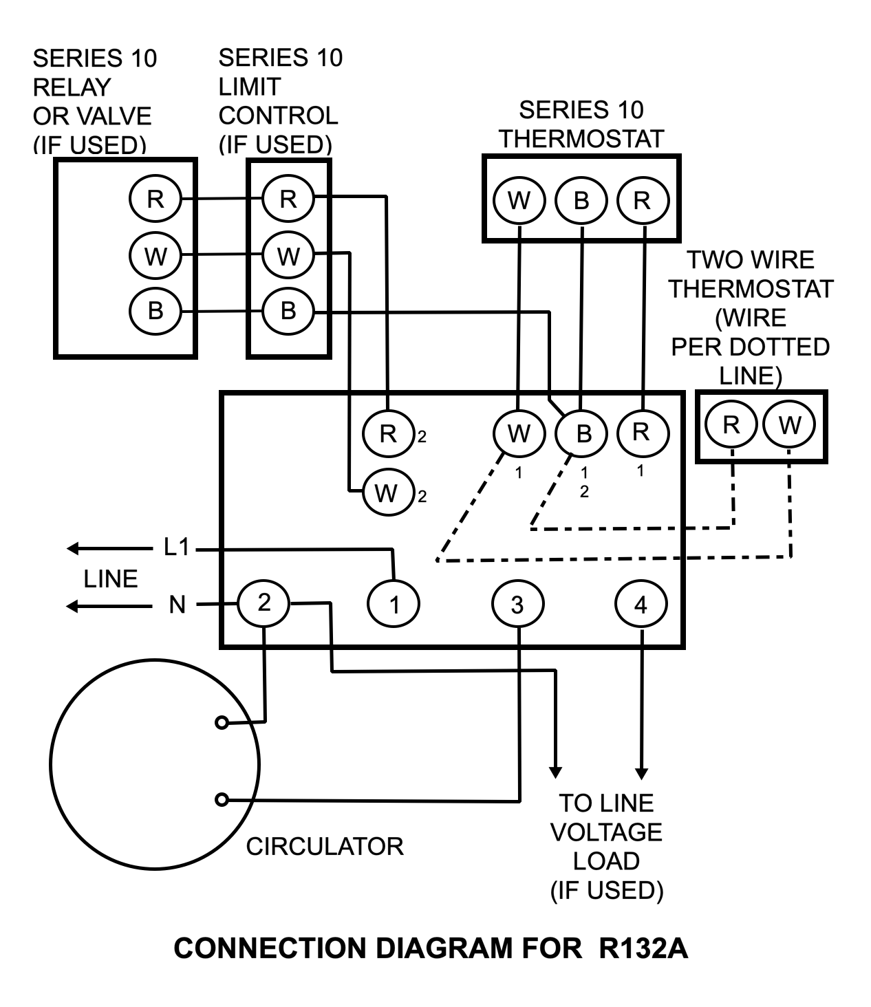

    I have discovered that boiler guys and gals may know piping systems really well but ask them to wire up 3 zone valves on that boiler job and you can loose them for the rest of the day. When they resist using the ZVC type relays from Taco, and other manufacturers, there often is a disconnect from understanding the concept to actually applying the principals of basic electricity.
    Taco series 570 zone valves are the most problematic for many techs. That darn #2 common terminal. It ain't always the same as the Common (C) terminal on the transformer.
    This has been the source of smoke being released from many a transformers across the industry. As a joke I offered this idea as often as I can and one person actually wanted to pay me for the fuse and wires. LOL. I told him it was cheaper at the auto parts store.
    Back to the 3 wire zone valve. This is how it works:
    Power from the 24 volt transformer is sent to the thermostat. On a call for heat the power gets forwarded to terminal #1 on the valve head. That is connected to a heating coil that is then connected to terminal #2. Viola a completed circuit.
    The heat from the coil will cause wax in a piston to expand and force the valve open. A cam on the valve stem will then close a set of contacts (the end switch) connected to terminal #2 and #3 to complete a circuit. Those contacts can then be used to do what the thermostat on a single zone boiler to do. Make the burner operate and make the circulator operate.
    There is the basics that everyone will say they understand in class but when you get to the job with a problem, all that stuff just gets lost.
    And here is one of the reasons. There is more than one way to follow the instructions.
    All three of these diagrams along with several others, will work by themselves. And as long as you follow the same diagram on all the valves connected to the boiler, you should have no problem. Where the problem happens when is when someone tries to mix and match the different wiring diagrams on the same system. That is when you end up back at the supply house to buy a new transformer. Or even worse, a new expensive control because the transformer in the control lost the fight to the more powerful zone valve transformer.
    Here is the diagram on the Taco instruction sheet: Next to it I have added R W and C that I memorized
    This keeps me on the same page when I troubleshoot zone valve problems. If the valves are not wired this way, I quote the customer a Flat Rate fee to rewire the valves from scratch. If I find a bad transformer or valve that needs to be replaced during my rewire, then I will stop and quote the price for that additional repair. That way I can figure it out during the rewiring and usually solve the problem along the way.
    If they are already wired this way, then it is easy for me to find the problem.
    Now lets look at what can go wrong when you mix and match the different wiring diagrams. Remember each of the 3 above diagrams will work by them selves.
    DO NOT USE THIS DIAGRAM FOR YOUR ZONE VALVE SYSTEM
    Now they are all in the same system. Should be just fine don't you think? But look what happens when you power up that zone valve transformer and the oil burner primary at the same time. The Green Highlighted circuit happens and you let the smoke out of the transformer in the oil burner control because your 40 VA transformer is more powerful than the tiny transformer on that expensive control.
    When you follow the green lines above, you will basically get this to happen even before you have any calls for heat:
    SMOKE
    Look at what you just bought for your customer.https://www.supplyhouse.com/Resideo-R8182D1079-Combination-Protector-Relay-Hydronic-Heating-Control-w-High-Limit-10-F-fixed-Low-Limit-Circulator-10F-to-25F?_br_psugg_q=r8182d if it is still available
    SO TO SUM UP ZONE VALVE 101
    Wire every zone valve on the system the same way
    MEMORIZE this:
    R on transformer goes to R on thermostat
    W on thermostat goes to #1 on the Taco 570 series head
    #2 on the Taco 570 Series head goes to C on the transformer
    #2 on the Taco 570 Series head goes to all the other #2 on all the other zones
    #3 on the Taco 570 series head goes to all the other #3 on the other zones.
    All the #2 and all the #3 wires then go to the boiler T T terminals (or wherever the thermostat would go if there was only one zone)

    I have made a detailed explanation of Taco zone valves getting connected to NEST and other smart thermostats. This discussion came up in October 2022 regarding honeywell (and other 4 wire ) zone valves. Where do I connect the C wire from a smart thermostat when I have zone valves connected to a L8148 aquastat?
    If you have a separate transformer for the zone valves then it is easy.
    User: ""
    1. R is connected to R on the transformer and all the thermostat R terminals
    2. C on the valve is one of the yellow wires. It gets connected to the thermostat C and the transformer C
    3. W on the thermostat is the other yellow wire
    4. The RED wires are connected parallel to T and TV on the L8148, plane and simple
    Then in October 2024 this happened to come in on the same control… But the zone valves use the transformer inside the L8148E 1265. You can only have 2 Honeywell zone valves on that control because all the other stuff already on that control. Here is the diagram and commentary
    The L8148E has 4 additional numbers after the letter E. This will determine if you have a standard 24 VAC with15 to 20 VA rating or if you have the 24VAC with a 40 VA rating. Also a photo of the inside wiring will also indicate if you have a 40 VA transformer. If you have the larger capacity transformer, it can handle 2 zone valves, and you do not need a dedicated transformer for the zone valves.
    These two photos show the difference between the L8148 with a standard transformer and two thermostat terminals marked T T (black and white photo) and the L8148 with the larger transformer with four low voltage terminals marked T, TV, W and Z. (color photo). See the difference in the size of the transformer? (Green arrow). If you have the control on the right, then you may not need a separate transformer for the zone valves.
    In order to find the C terminal for your Smart Thermostat, you may need to change the wiring on the thermostat and zone valves. With a 2 wire thermostat (labeled R and W) it does not matter if you place the R on T or TV on your control in which case the from the thermostat will be placed on a Yellow of the zone valves. When using a Smart thermostat it is important to put the R from the thermostat on the TV of the L8184 ONLY and the from the thermostat one of the Yellow wires of the zone valve, that will make sure that you can use the W on the L8184 as the C for the thermostat and the zone valve other Yellow wire.
    It is important to wire both zones identical or you may connect a dead short by accident. I recommend this device to be placed on the TV terminal of the L8148 control then connect all the TV wires to the other end of the fuse.
    I do not actually sell these, it was presented as part of another post as a device that does not let the factory installed smoke out of the control transformer
    Assuming you have the L8148E 1265 or similar control, here is the diagram for using the internal transformer of the L8148E 1265 to operate 2 zone valves and 2 smart thermostats. That is the maximum load you can place on this transformer. That is because this control transformer is powering 2 zone valves, one vent damper motor, one ignition control, one gas valve, one (burner and circulator) K1 relay coil, and now two smart thermostats.
    TV on the L8148 is connected to the R of both thermostats and also gets connected to one of the Red wires of each of the zone valves.
    T on the L8148 is connected to the other Red wire of both zone valves
    W on the L8148 gets connected a Common to both zone valve motors and both thermostat by connecting it to C on both thermostats and the other Yellow wire of both zone valves. Leave the factory installed jumper on the L8148 connected to Z
    MikeAmann
