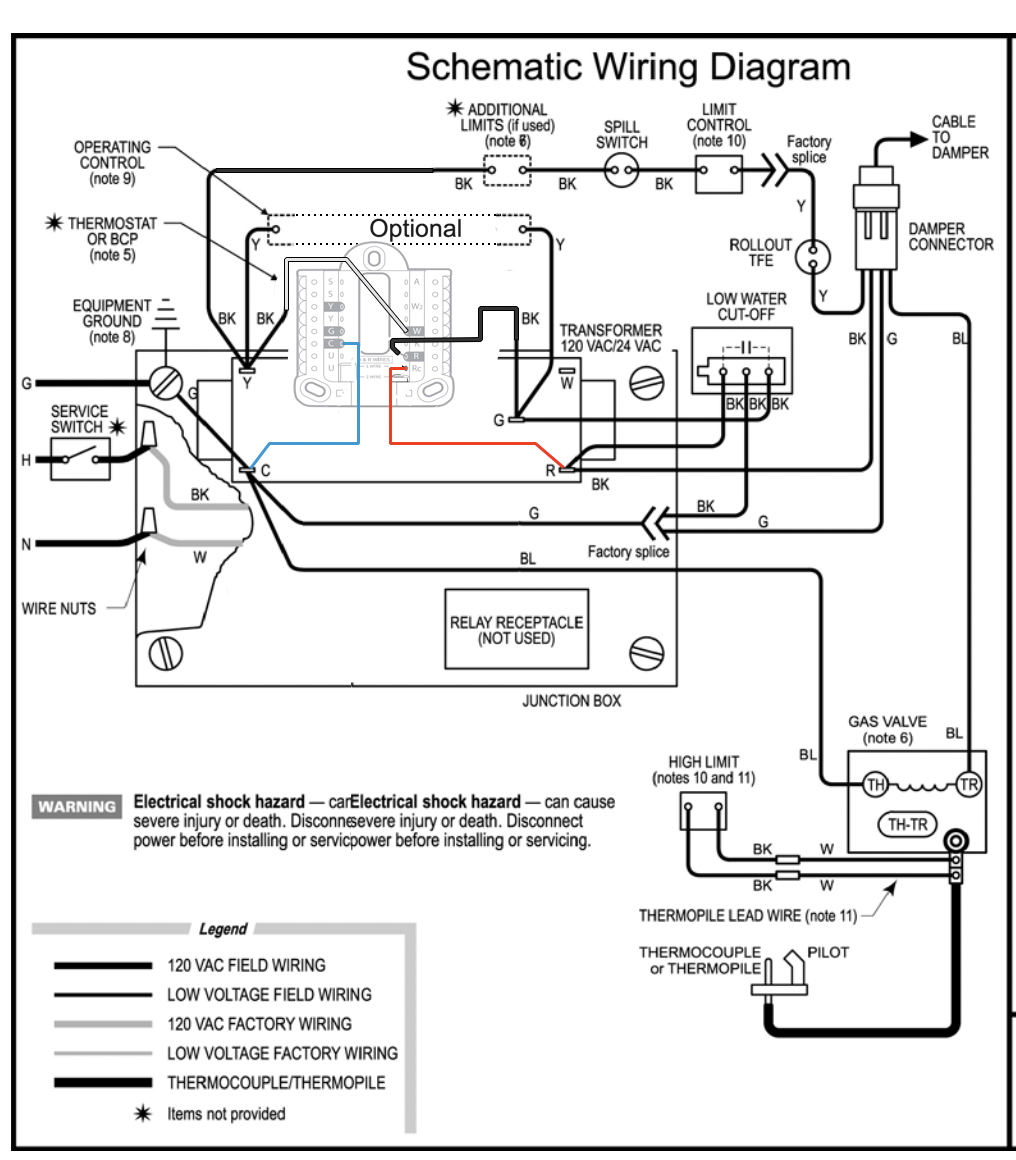

    Hello,
    I am having the same issue trying to install a Honeywell T9 smart thermostat. I was wondering if would it be possible to just run another 18/2 and connect to the R in parallel of the 24V transformer and the C terminal and connect to the Rc and Common at the thermostat without touching the thermostat internal wiring (Y and G) that are going to the R and W at the thermostat? Why the need for an external transformer.
    Thanks.
    edited February 21
    Rc and C need to be connected to opposite sides of the transformer to power the thermostat. Connecting them together will blow the transformer!
    EdTheHeaterMan Posts: 12,948
    edited February 21
    @mb23 I just chatted with Resideo Homeowner Tech Support. According to Resideo (formerly Honeywell) "As long as you remove the jumper tab, there should not be any contact between Rh and Rc."
    So this wiring diagram should be OK. However you will want to check the LWCO circuit to be sure.
    My fear is taht somehow the R and the RC will make contact internally inside the thermostat. If that happens then the LWCO will not longer be able to stop the burner. If you follow my logic on this the R from the boiler control transformer will then be connected thru the thermostat to G on the boiler control transformer. If that happens then when the LWCO terminals open as a result of a low water condition the R and the G will still be connected thru the thermostat. That is Not a Good thing. So you will want to test the LWCO function during a call for heat to make sure that when the LWCO switch contacts open, that there is not a connection between R and G on the control transformer
    Please try this and return to this post with your findings. I can no longer get into basements to test this for myself.

    Thank you Ed, the schematic you showed is exactly what I was trying to describe earlier in my write up. I will wire it up and test that during a call for heat and the LWCO contact opens, it shuts the boiler off and there is no connection between R and G on the control transformer.
    Thanks again!
  • mb23
    mb23 Posts: 18
    Sorry for the confusion, I didn’t mean to connect Rc and C together. I meant connect Rc( thermostat) to R of the transformer and C (thermostat) to C (24V xfmr).
