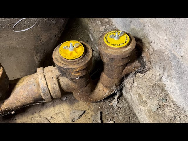

    It is a metal pipe coming out of the ground about 5 feet away from the house in the backyard. Could that be it, but if that's the case it could be down about 6 feet deep. The house doesn't have any other two cap openings.
    hot_rod Member Posts: 27,826
    There are both single and double type house traps.
    My dad called the two pipe version a double hand hole type. That is how he taught me to carry them when I was a lad. A hand in both openings.
    I remember the supply house calling then single or double hand hole traps also. Maybe that was local to the Buffalo area :)

    That was helpful. Do you think is probably what I have?

    Is there a pvc pipe that can replace this as a straight pipe?
    mattmia2 Member Posts: 17,462
    edited April 2025
    you can replace it with pvc and the type of fernco rated for burial. cutting the cast iron isn't super simple.
    i would put a cleanout there to shorten the distance that has to be cleaned and make it less likely something will happen to that section in cleaning.
    you can either figure it out with a camera or a ton of extra labor.
