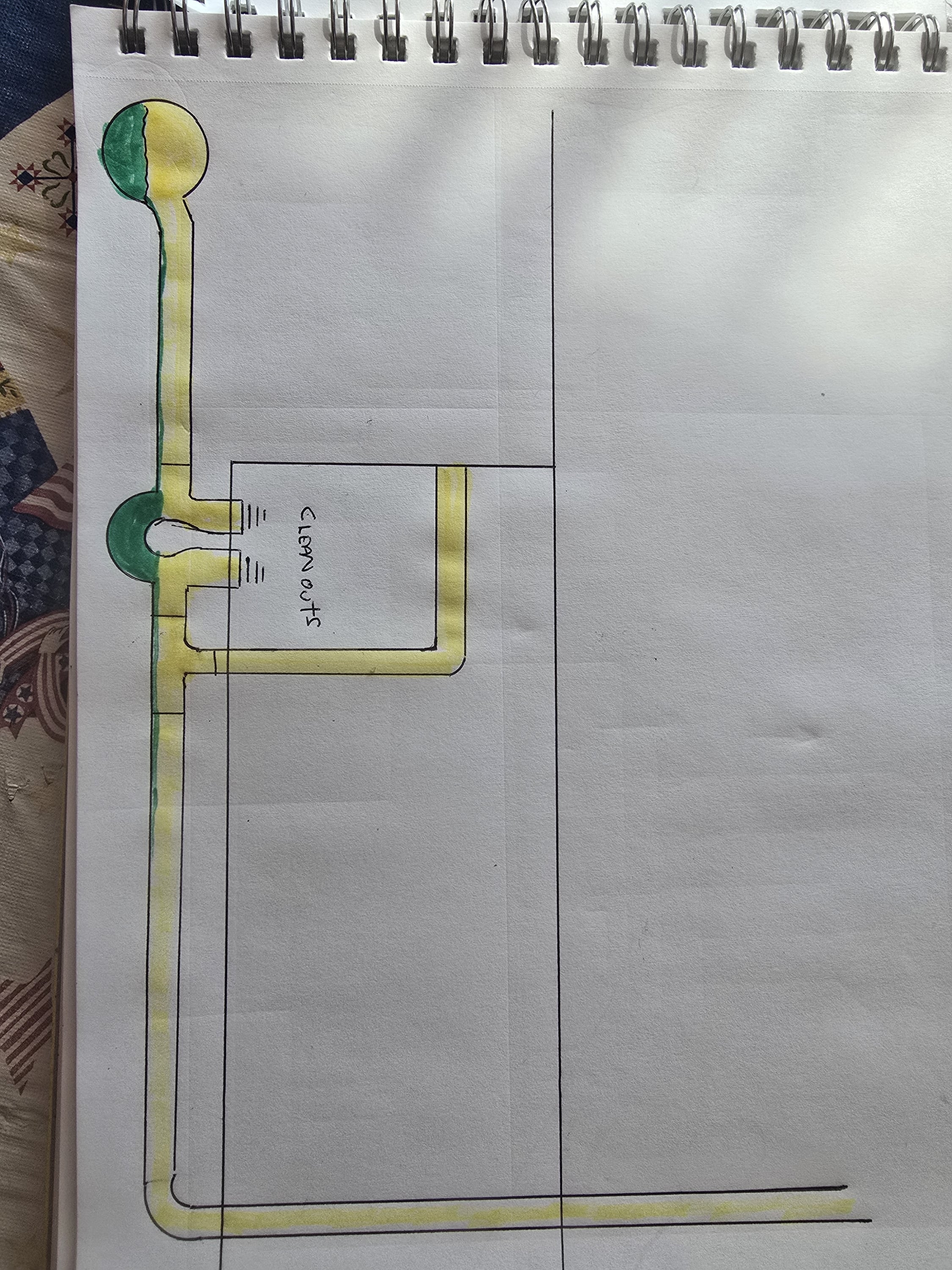

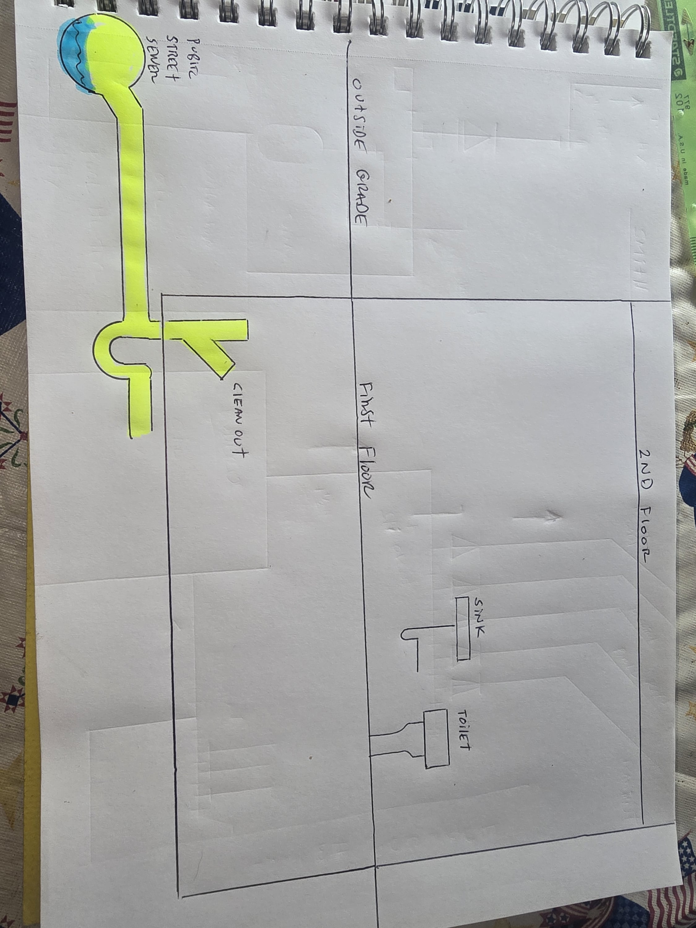

Is this a house trap?
24
    hot_rod Posts: 28,705

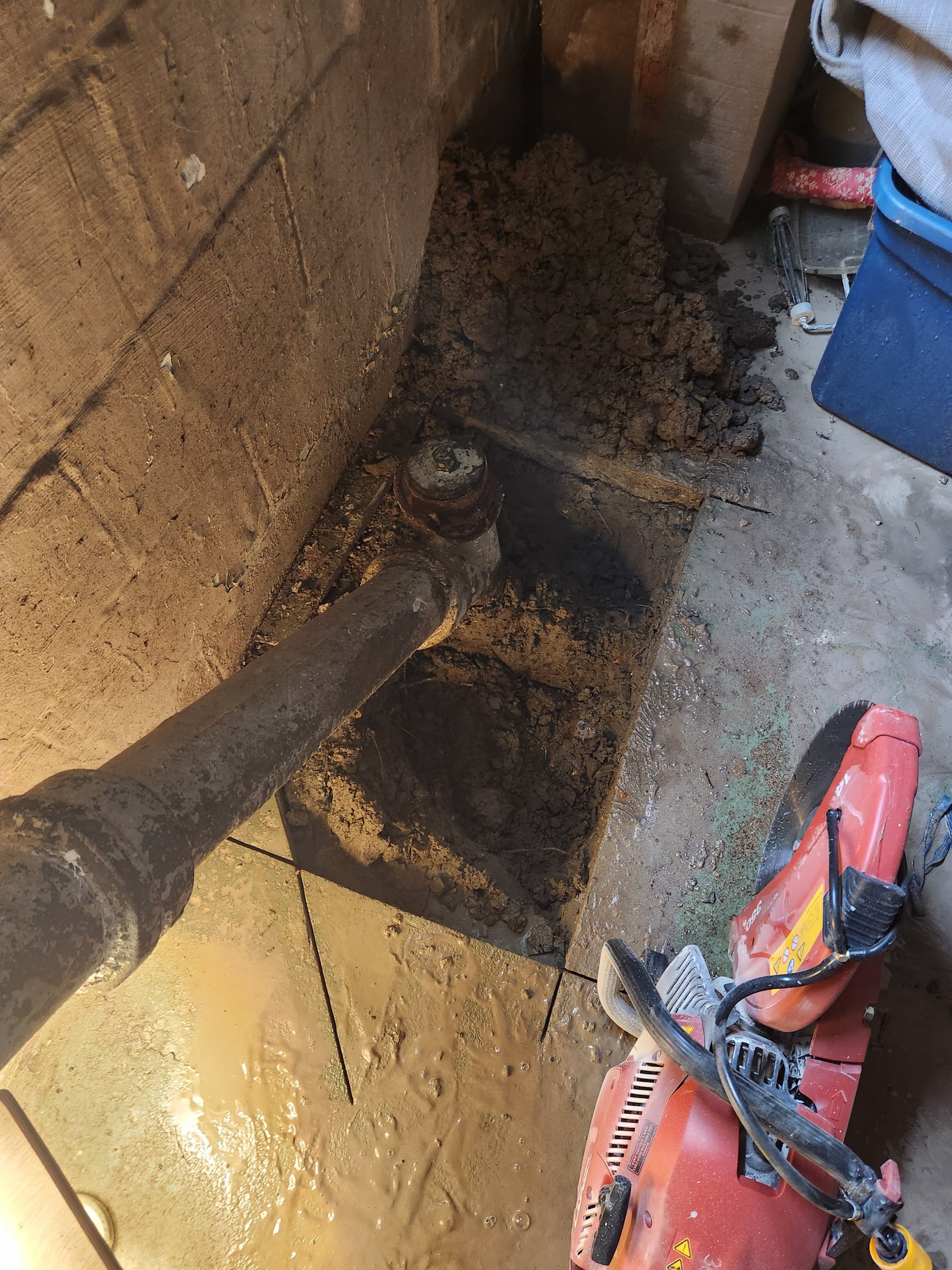

    The trap in the yard will be as deep and deeper than the basement floor, since the clean out pic you posted shows the sewer pipe under the floor.
    I would think a camera would go through that yard trap, if in fact it is a yard trap?
    It could be another clean out like you have in the basement.
    Local plumbers or drain cleaners should know what is typical in your neighborhood
    If the line is getting roots, I would think they would dig from the building to the sewer main and replace the entire line?
    though it is pretty common to stop at the street if there are no roots in that part because opening up the street to get to the main is far more expensive.

    So are camera and jets able to go through traps or do they need to be removed and replaced with straight lines?

    Yes, they are designed to do exactly that, you need a plumber that does trenchless residential sewer rehabilitation work as well as plumbing to look at this and go from there.
    It may require pipe bursting to install a new lateral sewer line if the trees and stumps cannot be removed.

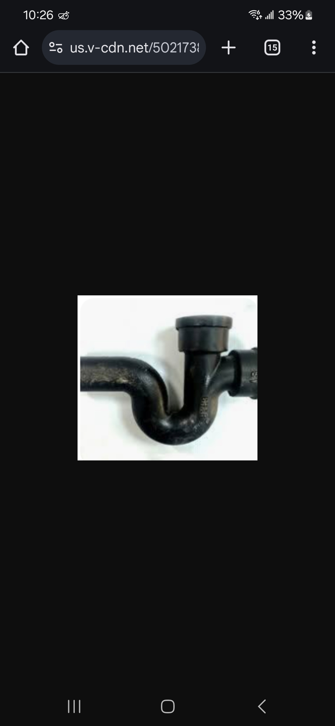

    Cutting out a trap in another house too.
    no, no one thought that was a trap. if there is a house trap it is somewhere else.
    Mad Dog_2
  • bdp1999
    bdp1999 Posts: 60
    edited May 2025
    The 2 plumbers that came out said it was a single trap.

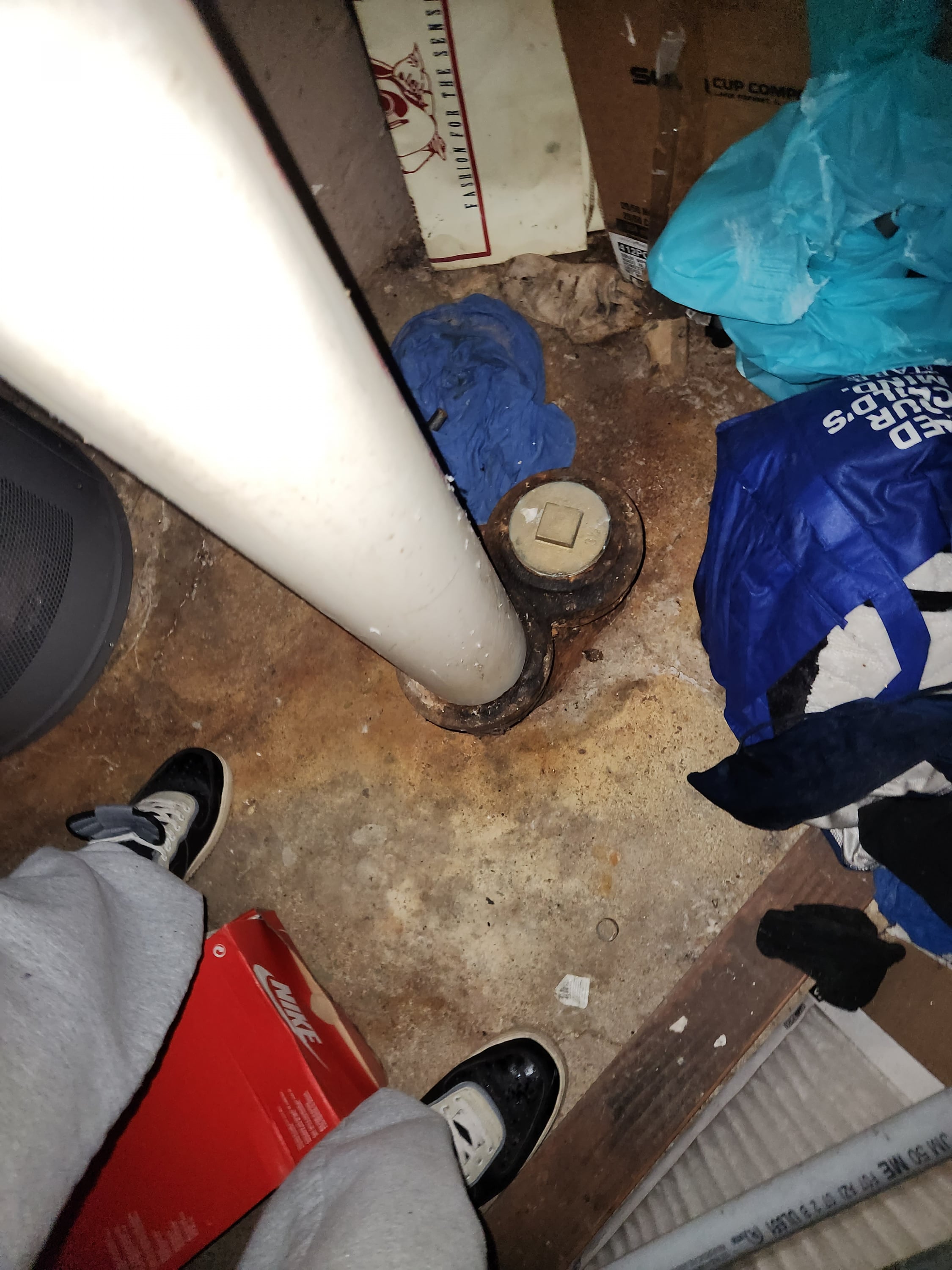

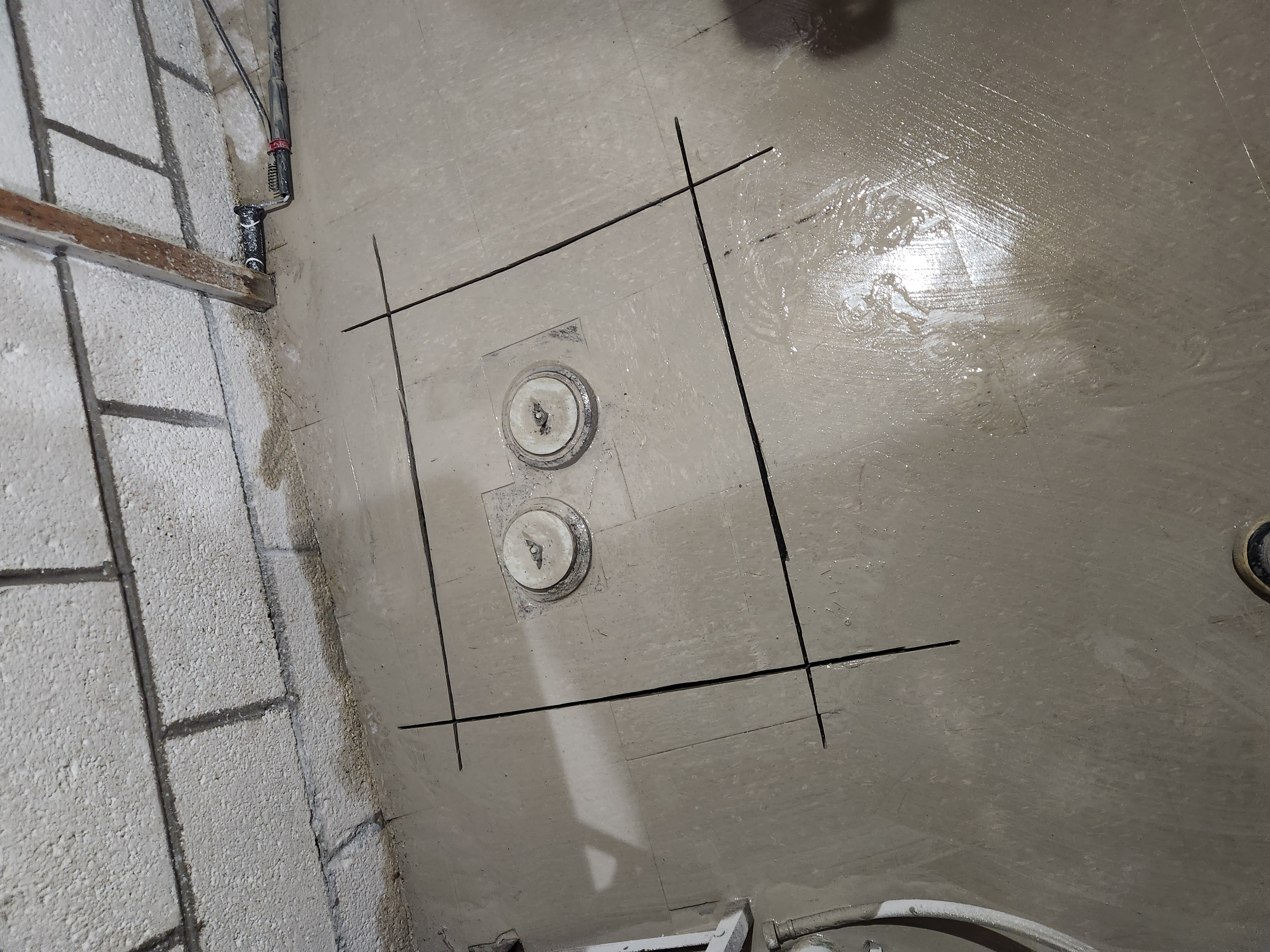

    This is the only other opening in the basement.
    pecmsg Posts: 7,634
    Not impressed with your plumbers!
    The second shot is more likely the trap. Open it and what do you see?

    I'll take a photo of it today. Did you see the single trap?

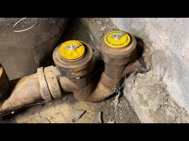

    Mad Dog_2 Posts: 8,755
    If that is the vent or Cleanout were are seeing in your photo, I'd like to see the belly of the trap that would be attached to it. From what we can see, you just may be a clean out fitting, not a "Running Trap with single Vent"(Charlotte Pipe).
    Its common to see them used where a yard or storm drain tie in to a soil or Sanitary pipe to keep odors out. Any chance you can excavate a little lower to expose the connection? Mad Dog

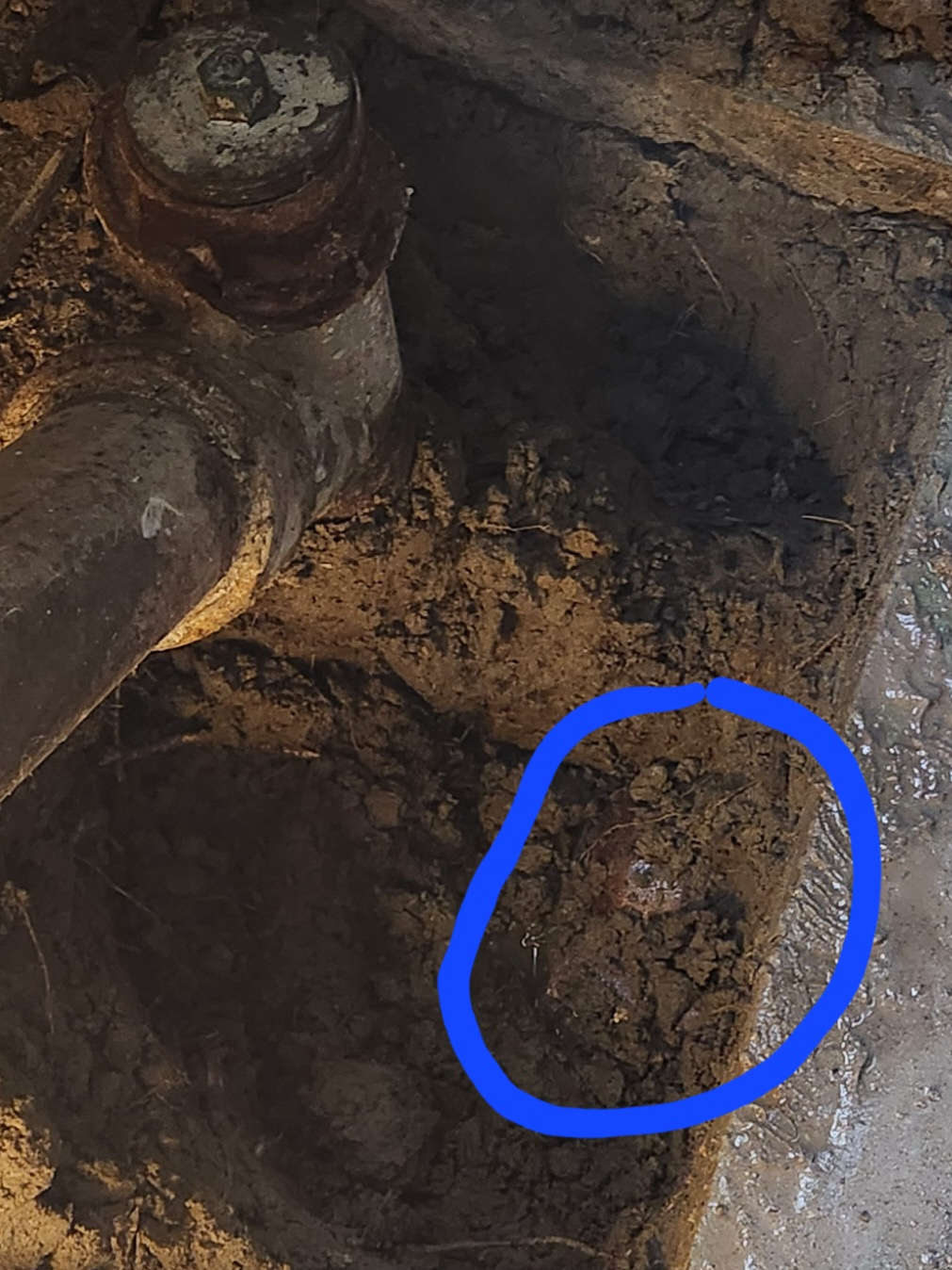

    Yes, I'll be digging the pipe out more in the next day or two. Wanted to wait untilnthe dirt dried up a bit. It also seems to be some copper color container in the bottom right of the cutout. Any idea what that is?
  • Mad Dog_2
    No Idea ...looks like oil.
  • Mad Dog_2
    I've never seen a Single Clean Out Running Trap with a Wye fitting, but that doesn't mean it's not possible. I'd be very surprised if that's The Building House Trap under there. Mad Dog
    where is the water service in relation to that? could be just some debris they used to hold the pipe in place while they were building it.

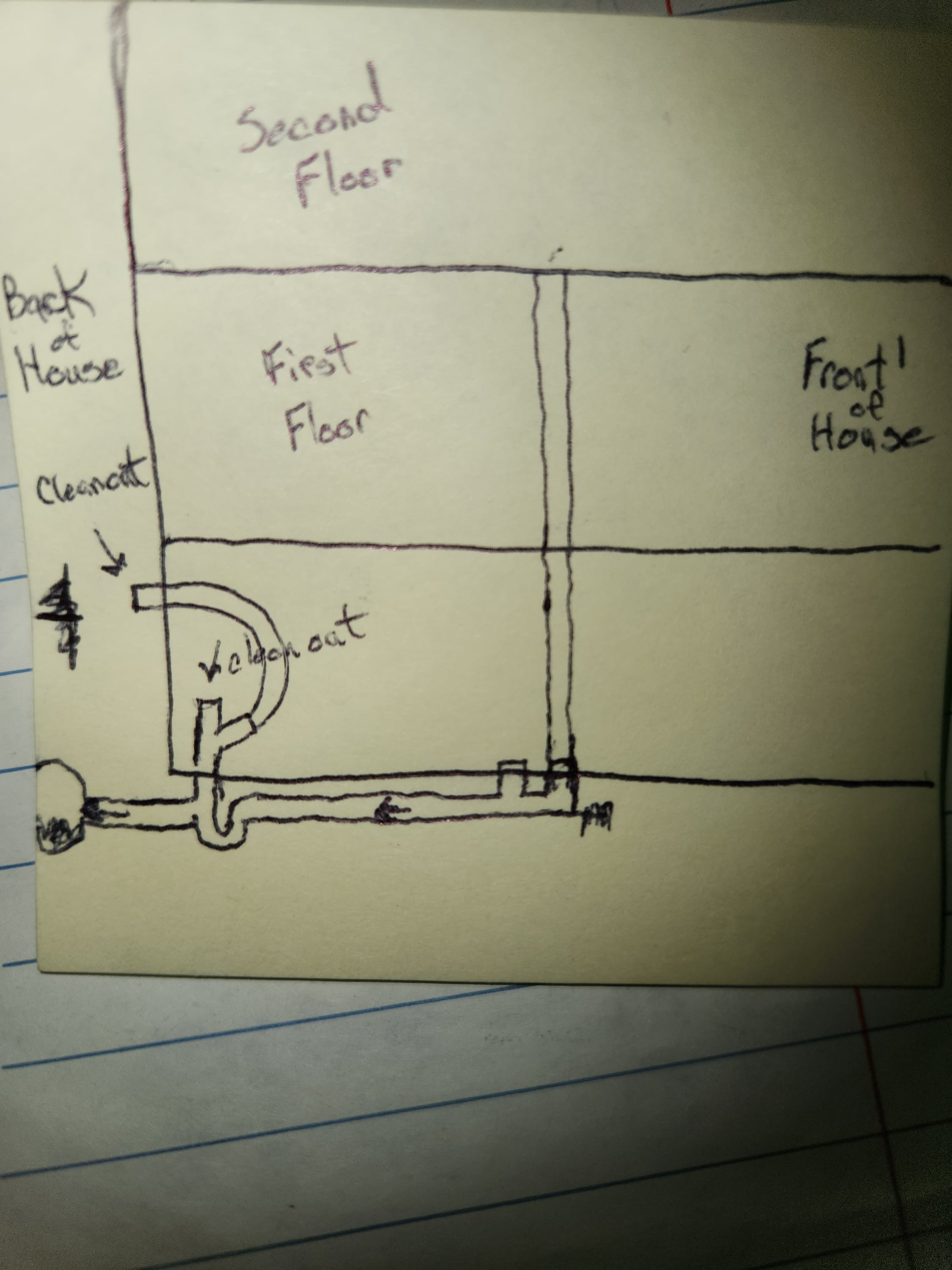

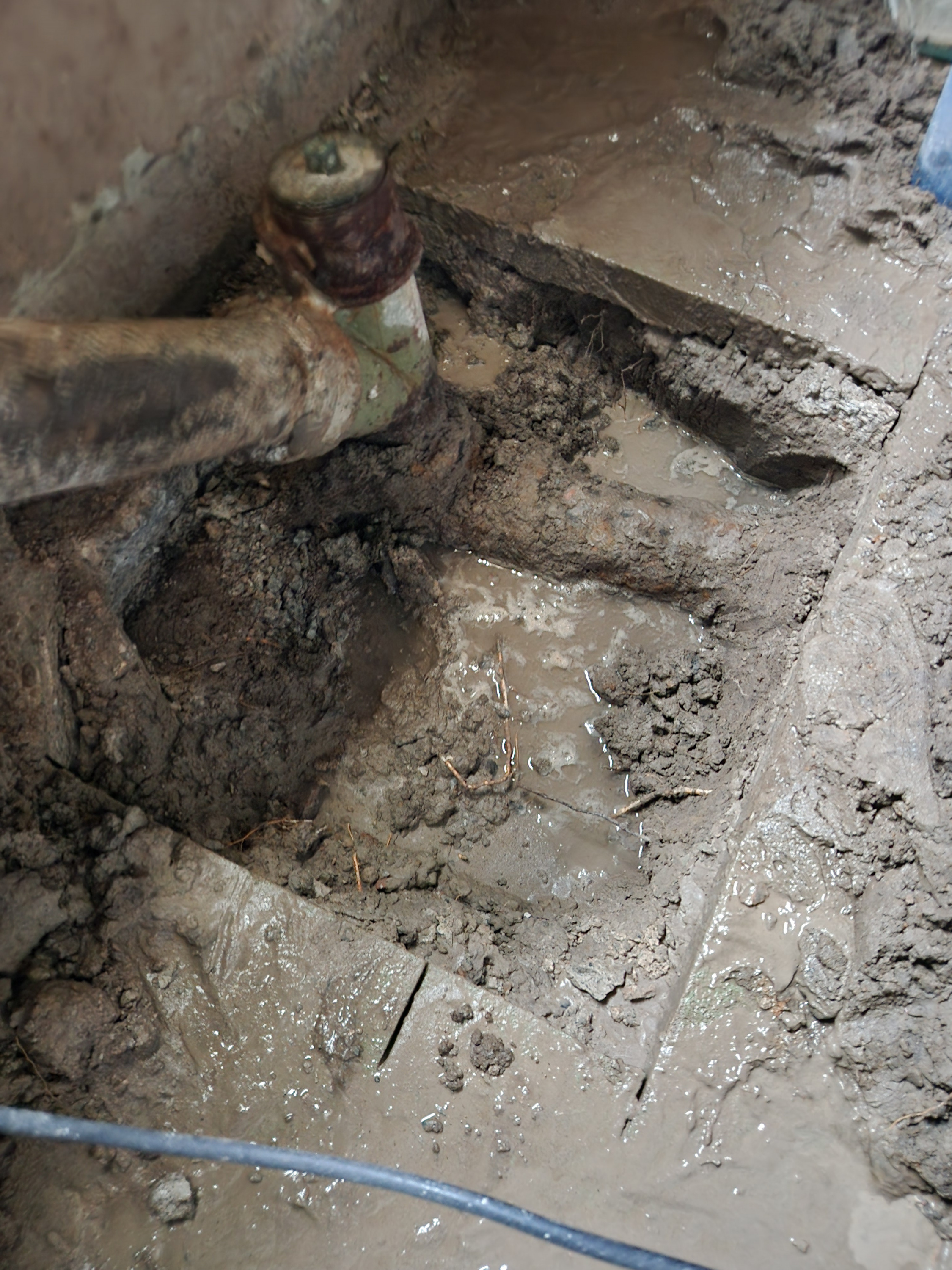

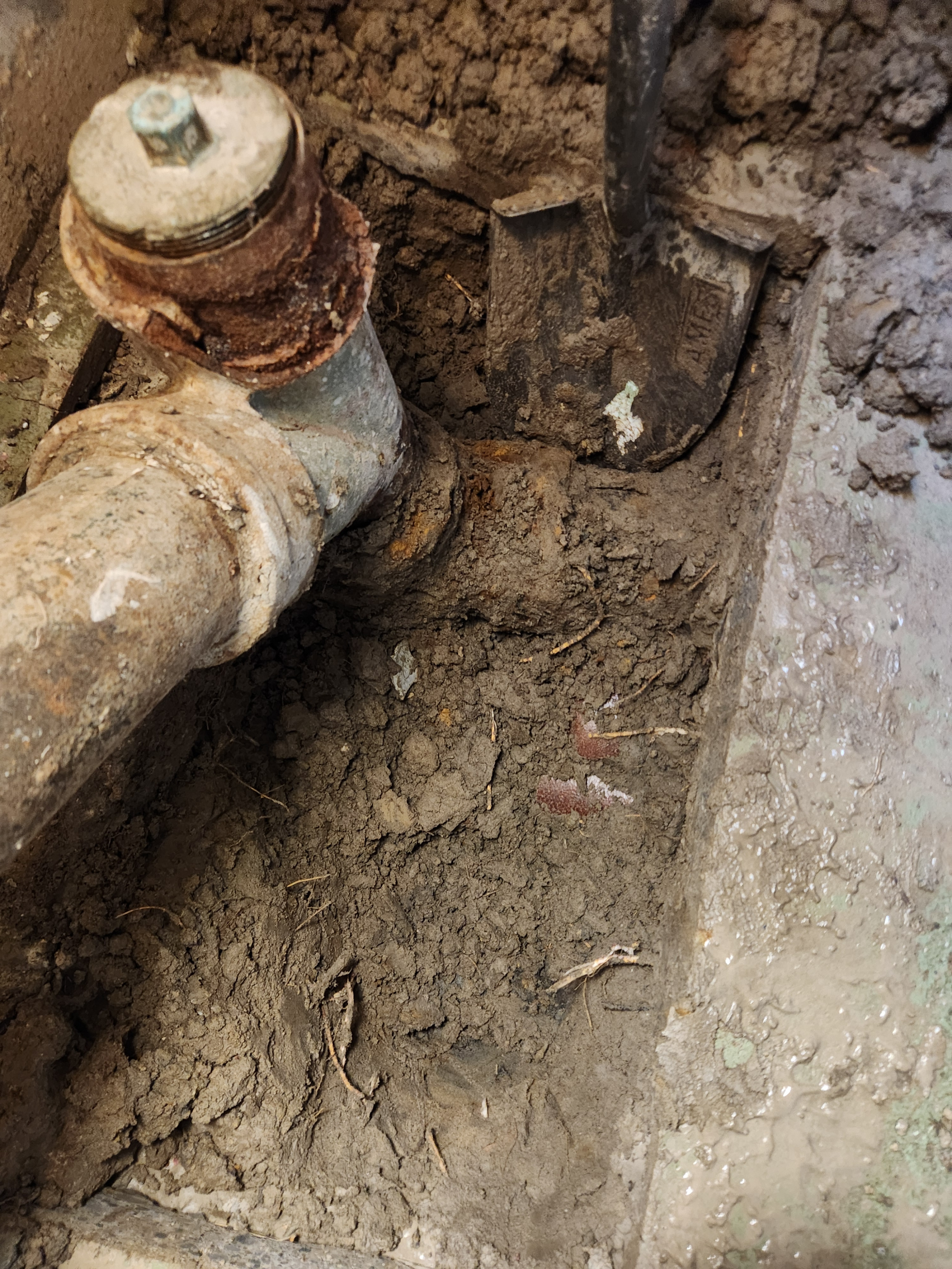

    NEw pictures
    Water runs to the back cleanout. Looks like the is just an extra cleanout and the pipes join.
  • Mad Dog_2
    That's what we were saying. Once again, the sewer & drain company SHOULD know this. What's the next step? Mad Dog
  • leonz
    leonz Posts: 1,994
    Shades of the Coors brewery in Golden, Colorado! You have broken clay tile under to the cast iron pipe.
    Please call someone that can inspect, clean and then reline or pipe burst and push new pipe into the home in one job.
