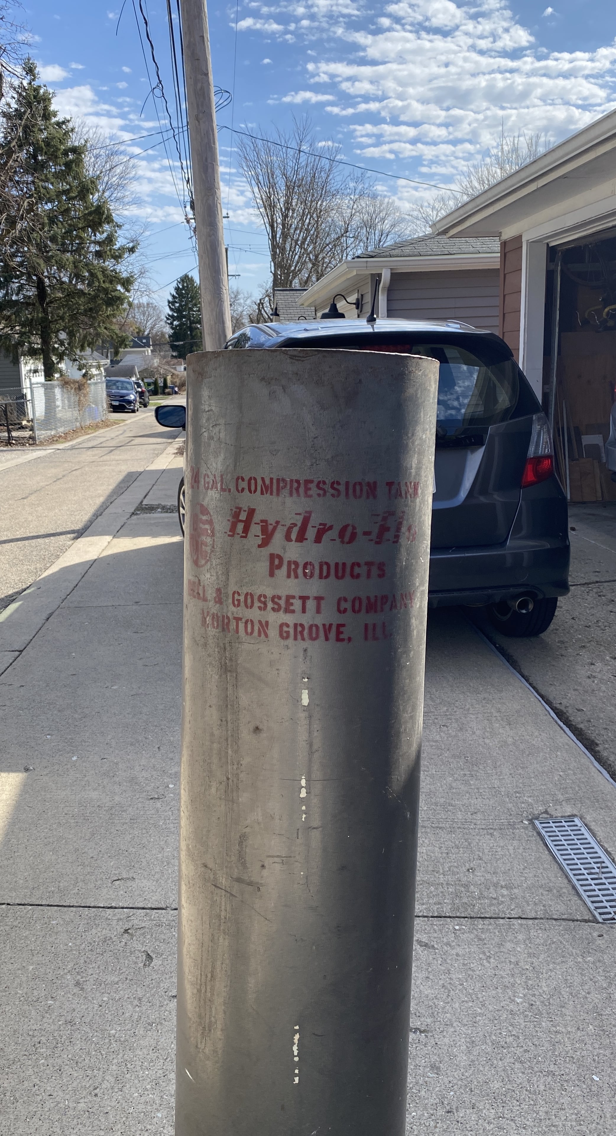

  • EricPeterson
    EricPeterson Member Posts: 307
  • EricPeterson
    Nice installation! I may consider switching to diaphragm tanks in the future, but that will probably only be when I replace the boiler. I have limited space for such tanks and the compression tanks fits nicely between the floor joists. Plus my air management setup is for compression tanks (Integated Air Separator, ATF-12) and is working very well right now.
    It was quite inexpensive procuring a second compression tank and an ATF-12.
    —Eric
