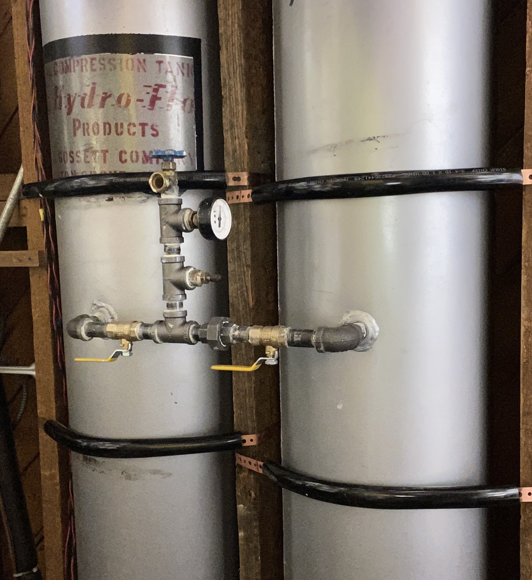

    Here's an update and summary of figuring out the size of compression tank I need.
    First I had to estimate the # of gallons in my system, then use a tool for required tank size.
    Radiator Volume
    Since I have a mix of radiator types, I had to use different methods. I have:
    • free-standing column radiators (Kewaunee) of various sizes
    • baseboard radiators (Burnham: 7", Weil McLain: 9")
    • Radiant radiator (Burnham)
    For Burnham and Weil McLain I was able to find information from the manufacturers.
    Burnham baseboard data was only for 9" model so I had to interpolate to 7".
    For the old Kewaunee radiators, it's a two-step process:
    • Calculate the EDR
    • Convert the EDR to water volume
    For the EDR calculation I found a couple of sources (GreenBuildingAdvisor, ExpressRadiant) that provided the EDR based on the number of columns and the height. For the volume I used what seems to be a commonly accepted formula: 1.5 pints (0.1875 gallons) per square foot. So for example, our dining room radiator is 18" tall and has 24 sections, which worked out to:
    • EDR: 108 sq ft
    • Volume: 20.3 gallons
    Piping Volume
    This was based on visible configurations plus my recollection of how I added pipe for two additions, and split the original gravity piping into zones. I then used numbers from Table D (Page 42, Xylem Air Management
    Sizing And Installation Instructions
    ) for the volume per foot of all the different sizes.
    The final numbers work out to:
    • Radiators: 146.8
    • Piping: 56.9 (including boiler)
    • Total: 203.7 gallons.
    Compression Tank Sizing
    I used a couple of different sizing tools. Taco has a web version of a calculator. Xylem has a downloadable program called ESP-TANKS.
    These two tools provided very similar recommendations:
    • Taco: 44.66 gallon
    • Xylem: 44.60 gallon
    For these I used
    • Initial Temperature: 65
    • Max Temp: 170
    • Initial Fill Pressure: 18
    • Max Pressure In Tank: 28
    • System Volume: 204
    So bottom line, adding a second 24-gallon compression seems to be just the ticket. I'm prepping it now and will install it in the off-season.
    Thanks for all the comments and feedback. This was quite a lively topic.
    —Eric

    edited April 2025
    Hello Eric,
    I am coming in to your discussion late but I wanted to make sure that you plumb in the new steel compression tank correctly for your heating system.
    If you have ordered a steel compression tank with end tapping's for a gauge glass all the better as you can be assured of the water in both tanks as the water levels will be equal when you fill them again.
    The piping for the first and second steel compression tank should be parallel to allow the proper orientation of the airtrol valves.
    Page 4 of the Bell & Gossett AIRTROL installation sheet illustrates how parallel steel compression tanks need to installed correctly with larger header pipes.
    The drawings on page four shows how the plumbing should be oriented with the new piping.
    According to the information on page 4 Bell &Gossett wants the trunk line feeding both steel compression tanks to be one size larger than the tapping in the Airtrol tank fitting so that means a one inch truck line is needed. I am not sure whether a 3/4" nipple to 3/4" to 1" bell reducer would be advisable to create the 1" riser that would meet a 1" elbow to create the header pipe to be used to connect to the two steel compression tanks in tandem.
    The one inch trunk line/horizontal header must be pitched up to both steel compression tanks. in your case with 2 tanks the tee and elbow must be pitched up to the ATF-12 Airtrol valves in both tanks.
    The instructions do not state what reducing fitting should be used to do this coming off the tee and elbow of the one inch header pipe, perhaps a 1" short nipple and a 1" inch to 3/4" reducing bell coming from the elbow and the tee in the header pipe would be the more ideal way to let the air bubbles migrate more swiftly to both steel compression tanks. The drawing on page 4 illustrates a 3/4" short pipe nipple coming from both the elbow and the two tees which are connected to unions that are connected to the airtrol valves but there is no mention of the ideal type of 1" to 3/4" reducer whether a bushing or bell fitting and pipe nipple is preferably used to connect to the short nipples to the unions and the next short nipple that meets the Airtrol valve.
    I do not know how to upload the page illustrating the diagrams showing how the piping is done for multiple steel compression tanks.
    I hope I have not made any mistakes in describing this to you and I would certainly appreciate any corrections made by the members.
  • EricPeterson
    EricPeterson Member Posts: 307
    @leonz - thanks for your concern. I am following the instructions per the B&G document you reference.
    The pipe from the boiler to the compression tank is already 1" and pitched 3/4" in 2 feet, then reduced to 3/4" to connect to the Airtrol fitting - so I believe I meet the requirements mentioned in that document.
    —Eric
  • EricPeterson
    Twinsies - ready for final piping and testing.
  • leonz
    leonz Member Posts: 1,877
    YAAYYYYY,
    May I address you as Eric?,
    I am impressed with your using tubing to cover the copper coated pipe strap to prevent galvanic corrosion.
    Will you be plugging the existing tapping's or creating a common boiler drain line for the tanks by installing elbows and pipe nipples to a single tee where a boiler drain is installed?
    Leon
  • EricPeterson
    Hey Leon,
    Sure call me Eric.
    The tubing also made it easier to position the tanks, and avoid scratching the paint on the tanks.
    To answer your question, yes there is a common drain, as well as a gauge and a Schrader fitting for charging the system if needed. That stuff was all installed this morning.
    —Eric
  • leonz
    Hello Eric,
    Once you isolate the tanks-shut the valves off top the tanks from the system before you fill them you can open the drains on the airtrols and open the fill valve you should not have to push air in the system at all. After you fill the tanks and have only water falling from the drains you can shut the drains and then open the valve to the system and fire the boiler to get rid of any microbubbles.
    I always start the season with 180 degree high limit for a day or so and then back it down to 160 to assure the system is balanced and the sight glass is half full to start the heating season with my stoker.
    I only bring it back up to the 180 high limit when the weather gets really cold on my mountain.
    Please do not forget that your altitude above sea level is also a factor-with me my place is 1,140 feet above mean sea level and in my case I had a huge vacuum condition and until I isolated everything and found that the packing gland nuts were loose I tightened them 1/4 of a turn and the vacuum condition disappeared and the water level in the steel compression tank was back to normal.
