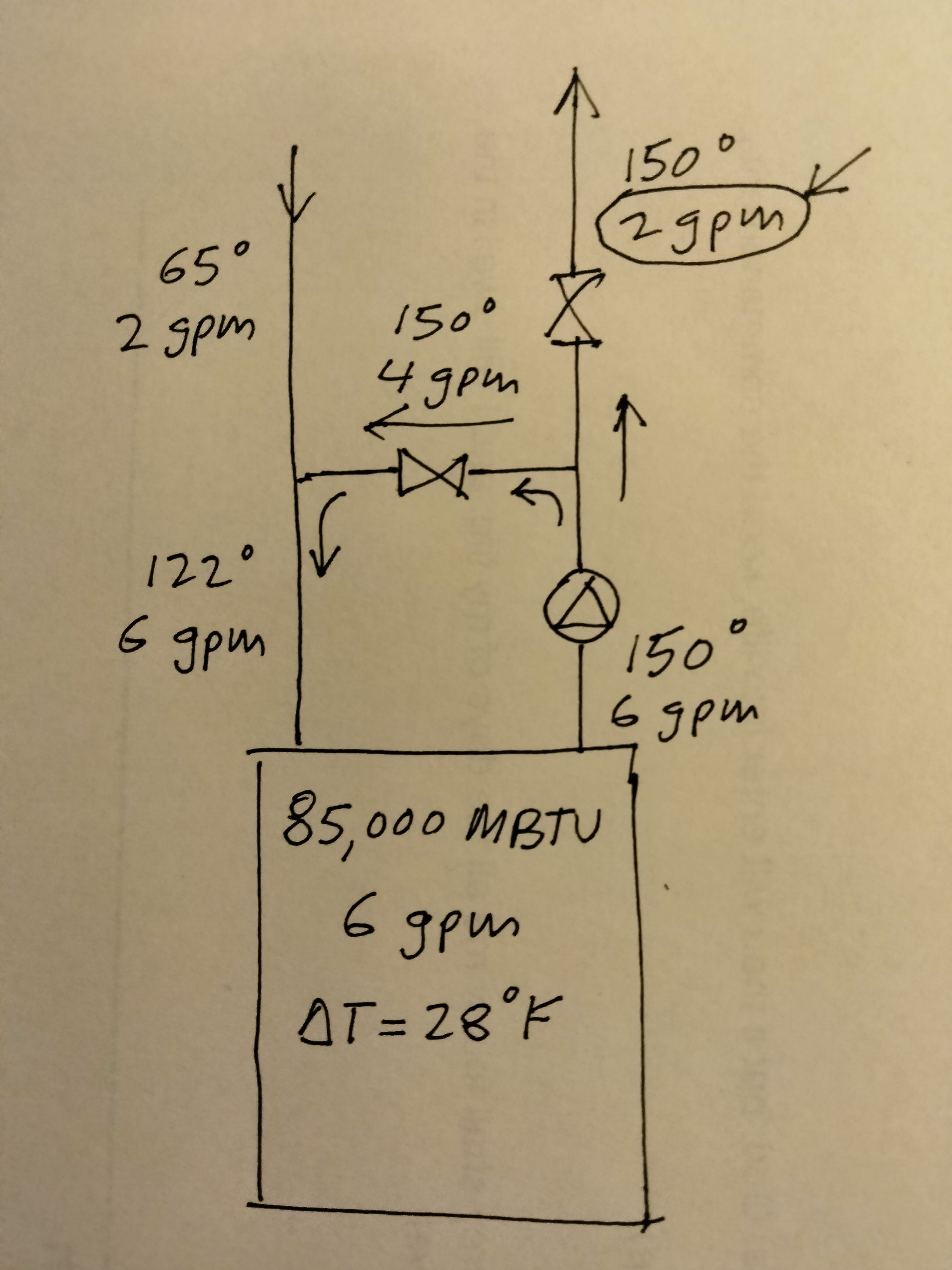

    OK thanks, but I'm still trying and perhaps failing to understand your suggestion above where you said:
    "Circ turns on at say 150F, off at 80f. Heat call resets circ aquastat. Bypass is set so when circ is running with your expected low RWT (probbly around 80F), the boiler sees 130F. That will get you a supply swing from 150F to 180F and return swing from 80F to 110F. This gets you quick boiler warmup and should keep it from bouncing off the high limit."
    I understand the concept of circ holdoff until the boiler hits 150, but as soon as the circ turns on, it starts pumping 65 degree return water towards the boiler. If I have the bypass set to mix 2 gallons of 150F supply with, say, 1 gallon of 65F return, that's a mixed return temp of 122F.
    So now the boiler needs to maintain a delta T of 28 (150-122) to keep the mixed return temp from dropping too low. For a delta T of 28 across an 85,000 BTU output boiler, that's about 6 gpm through the boiler.
    Then to maintain the 2-to-1 flow ratio through the bypass for high return temps, I want 4 of those 6 gpm going through the bypass, and 2 of those 6 gpm going out to the system and coming back into the return.
    So in order to maintain a minimum 122 mixed return, I'm flowing 6 gpm through the boiler, 4 of which goes through the bypass and into the mixed return, and only 2 gpm goes out to the system.
    So now I have only 2 gpm crawling through a system of 100+ gallons. It would take almost an hour for one complete circuit, which means high temperature gradient and poor heat distribution.
    My situation seems to support @Ron Beck 's opinion that CI boilers sometimes should be piped P/S because of this bypass problem and the resulting flow mismatch. He talks about it here:

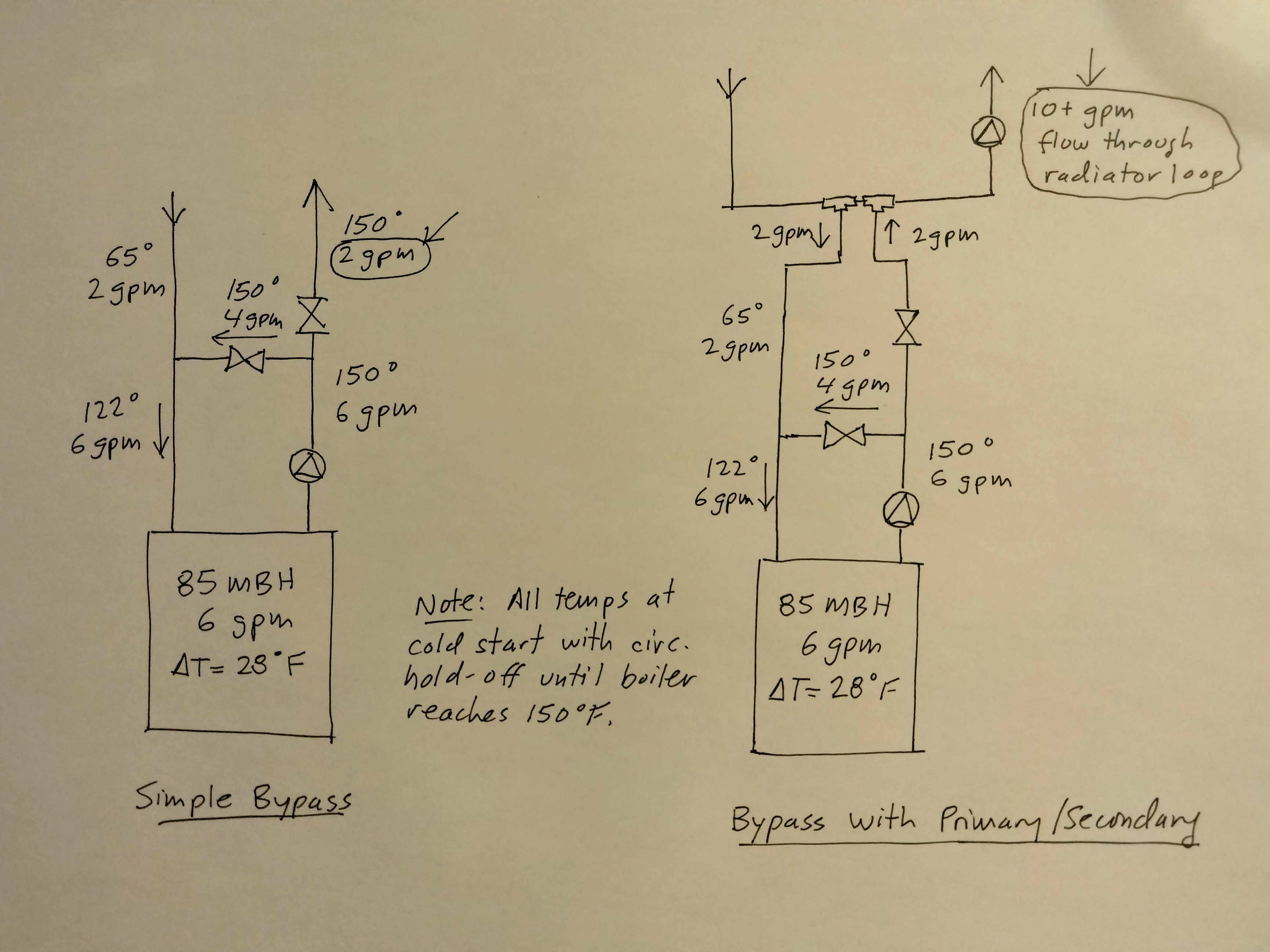

    Here's a better diagram that compares a plain bypass with a bypass plus primary/secondary. The plain bypass only puts 2 gpm through the radiator loop, which seems too low for a system with 100+ gallons of water and 10 large cast iron radiators. That flow problem is solved by the addition of primary/secondary piping, which allows a higher flow rate through the radiator loop for better heat distribution, without upsetting the temperature balance through the boiler loop.
    All temperature are shown at cold start with circulator hold-off until the boiler temp reaches 150. At that point, the circulator starts, and the mixed return temp is 122. The average temp through the boiler is 136. These temps will climb slowly throughout the burn, so condensation is no longer a concern.
    This bypass diagram with primary/secondary is based on a diagram I saw on @Ron Beck 's comfort-calc.com website, so I don't take credit for it. But it seems to solve my problem with the flow mismatches that would result from maintaining a high enough return water temp.

    Normally there isn't so much water so the RWT gets up to above 100F pretty quick so you don't have to mix that much.
    In your case, with the large volume and oversized rad, your proposed PS makes sense. If you want to get fancy, you can do continuous circulation on the secondary loop and run outdoor reset on it (ie outdoor reset and thermostat control boiler fire). This will keep the water temps there more even which eliminates pipe expansion noises.

    What is missing in those bypass drawings is the fact that the water temperatures are mot fixed in the boiler or distribution loop.
    So you set the bypass when the system return is 65F? Then if the system rises to say 150F then your bypass is not blending the same.
    Which is why dumb mixing valve or pump, for boiler return makes little sense.
    If you have a copy of Modern Hydronic Heating, it goes into great detail about boiler return concepts, as well as options for piping and control.
    On a system like yours a mod con along with a conventional boiler would have been an option, for those low SWT conditions.
