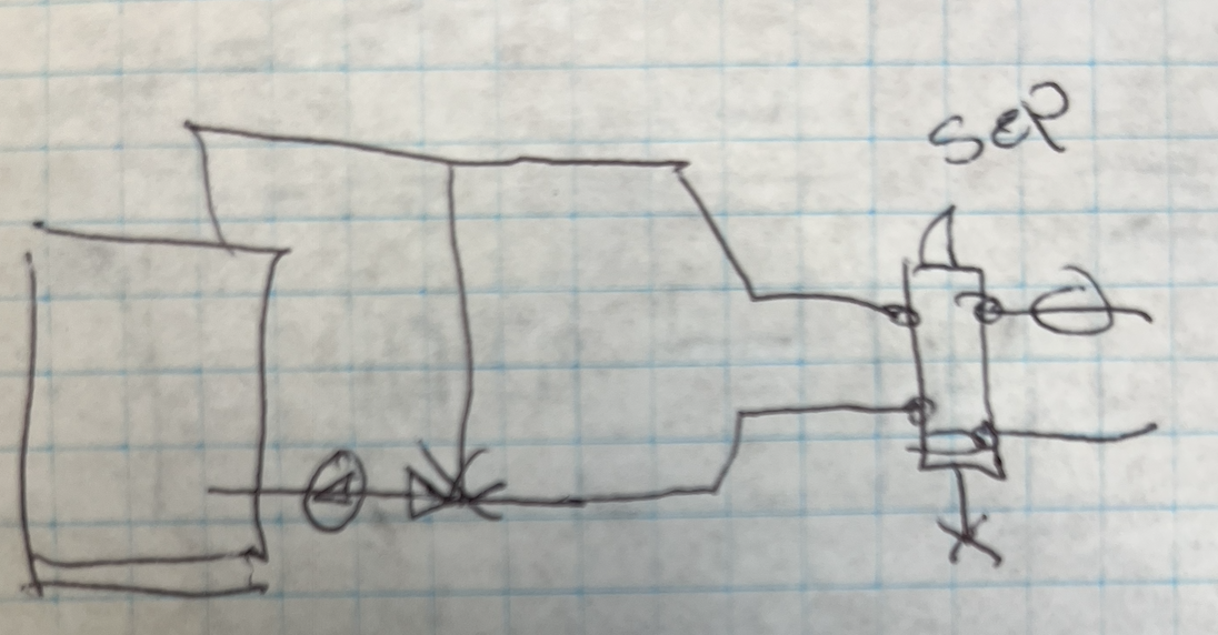

    Perhaps a hydro separator could work? The boiler will have its own circulator and the zone circulators will only be energized when the temperature is above 130-135⁰.
    Maybe a variable speed injection pumping setup would work as well?

    The hydro separator might work, but the zone circulator (only one zone) might run very stop-start every time a slug of cold water from the secondary loop hit it and reduced the water temperature?
    The thing I like about the ESBE schematic is that the secondary circulator runs continuously regardless of temperature, which means there will always be a very even distribution of BTU's throughout the secondary loop, no matter what the primary loop is doing.
    The variable speed injection pump could work too, but a Taco variable speed controller is $500, and I don't like the idea of relying too much on electronics for the bypass protection. I like the ESBE valve because it's all mechanical, and should be very reliable. So all I need is the ESBE valve and a second circulator. Both circulators run continuously, and there are no electronics involved, which appeals to me on the KISS principle.
    If you want a sure fix I would use a motorized 3 way valve (like a Belimo) with an accurate control (like a Johnson A350) with a sensor on the boiler return water. Its a few bucks more $ but is a bulletproof fix.

    With a mix valve, you won't be able to do a shutdown thermal purge. I guess a motorized one could be configured to allow flow when the boiler is off.
    I'm a fan of KISS, simple bypass. One pump, no valves, no electronics. You will need more than 3/4", I've run into this before where the bypass was not big enough and had to restrict to house feeds to get enough flow through it.

    I would like to do a simple bypass as you suggest, but here's the problem. Buderus wants 122 degrees in the boiler within 10 minutes. If I set up a simple bypass to do that, it's about a 60 degree temperature rise (from a cold start of about 65 degrees) in 10 minutes. But because the simple bypass has only one "setting", the temperature rise is going to be roughly linear. So in another 10 minutes, the temperature in the boiler will rise another 60 degrees. Now it's 180 degrees, hitting the high limit after just 20 minutes.
    But because we have such high water volume and this will be a relatively small output boiler, it's going to take 1+ hours for the Tstat to satisfy. So for the last 40 minutes of the boiler run, the boiler will be bouncing off the high limit, which doesn't sound like a good idea.
    Maybe I'm missing something, but that's why it looks to me like we need some sort of active control over the bypass, be it the ESBE thermic valve or an eletronic valve control.

    You could simply use a hydrostatic with circulator hold off and/or a 3 way valve

    If that set up requires two circulators , Pipe primary secondary would make the system sing . If you have the room for the pipe work..
    If you don't have the room .The return on the 115 is 1" , 3/4" system bypass will be fine.. You may not need it but still put it in ..
    The system will run in long cycles and will only heat up to the temperature needed for that time ..

    looks to me like the circs are in series. Why wouldn’t the second circ just pull from the boiler not the bypass when the valve starts to open. And when the 3 way is wide open, or closed to bypass, seems you just have two circs doubling the head?
    I don’t see it being a P/S piping? Why do you need two circs on a low pressure drop boiler on a low pressure drop gravity system. Seems like it will be grossly over-pumped piped like that.
    Bypass piping alone has no way of knowing or responding to temperature changes. That’s the whole point of a 3 way thermostatic, it has the intelligence to do the right blend.
    edited March 2025
    @jesmed1 that why I like the Belimo valve with the Johnson A350 control. It can put out 0-10v or 4-20MA. On start up with cold boilers that valve will modulate the return temp to 120 or whatever you set it at. It will take a while to heat on a cold start. I would use a two-stage thermostat to control the boilers or maybe 2 Ecobees if you can switch them to alternate the lead boiler and keep 1 boiler on lag.
    After a little adjusting of the modulation rate in the 350 control this will track perfectly smooth, This works great with MOd Cons.
    As long as your not going to exceed the temp rise from the return to the supply that the boiler MFG wants.
    The only way to really do boiler protection is to have a valve with a sensor on the return water. Johnson makes a well for the 350 control sensor or you can strap it on the pipe.

    What @HydronicMike mike said. Bypass with circulator hold off. Use a digital aquastat for thermal purge as those can be set with high differential. Circ turns on at say 150F, off at 80f. Heat call resets circ aquastat.
    Bypass is set so when circ is running with your expected low RWT (probbly around 80F), the boiler sees 130F. That will get you a supply swing from 150F to 180F and return swing from 80F to 110F. This gets you quick boiler warmup and should keep it from bouncing off the high limit.

    @hot_rod… Getting the boiler hot enough to close the mix to the return does not seem like that is going to happen with the way @jesmed1 explains the current system. So I don't believe that the individual pumps will ever be pulling from a closed valve. And each boiler has its own pump so the boiler that is not operating will not get any return water from the system or the other boiler as long as there is a IFC in each pump. (not shown)
    The system will operate by gravity past the boiler. If there are no zone valves to separate the units and the system is balanced properly (some valves may be needed to do that) then I see no reason for any other components. If @jesmed1 wants to keep the existing expansion tank with the Airtrol® tank fitting, all he will need is a central location to remove the air from the two boilers to direct it into the PONPC tank. I thinks this is very simple. The pumps are parallel to each boiler separately, not in series. The only time both pumps will operate is when there is extreme low temperatures. There may be a lot less cycling of the burner and the circulator(s) with this simple design.
    The oil burner(s) should operate less with smaller firing rates that the existing. This is the KISSest of all KISS designs.

    hot_rod Member Posts: 28,077
    I don't know that your system wants or needs P/S, but here is an option w
    ith a 4-1 sep.
  • jesmed1
    jesmed1 Member Posts: 1,500
    @hot_rod OK thanks.
    Is this a "4-1" separator? I assume the "1" is the end port for the air eliminator?
    https://www.supplyhouse.com/Caleffi-548007A-1-1-4-NPT-Union-Hydronic-Separator
    I don't think we have room for a vertically mounted. What is the benefit of the hydro sep vs. closely spaced tees, which would be easier for us to fit?
    A 4 in 1 sep gives you air, dirt, magnetic and hydraulic separation in one device.
    I don't see any air removal other than the auto vents?
    These show as mod cons, but same piping concept for multiple boilers into a hydraulic separator. With zone pumps.
