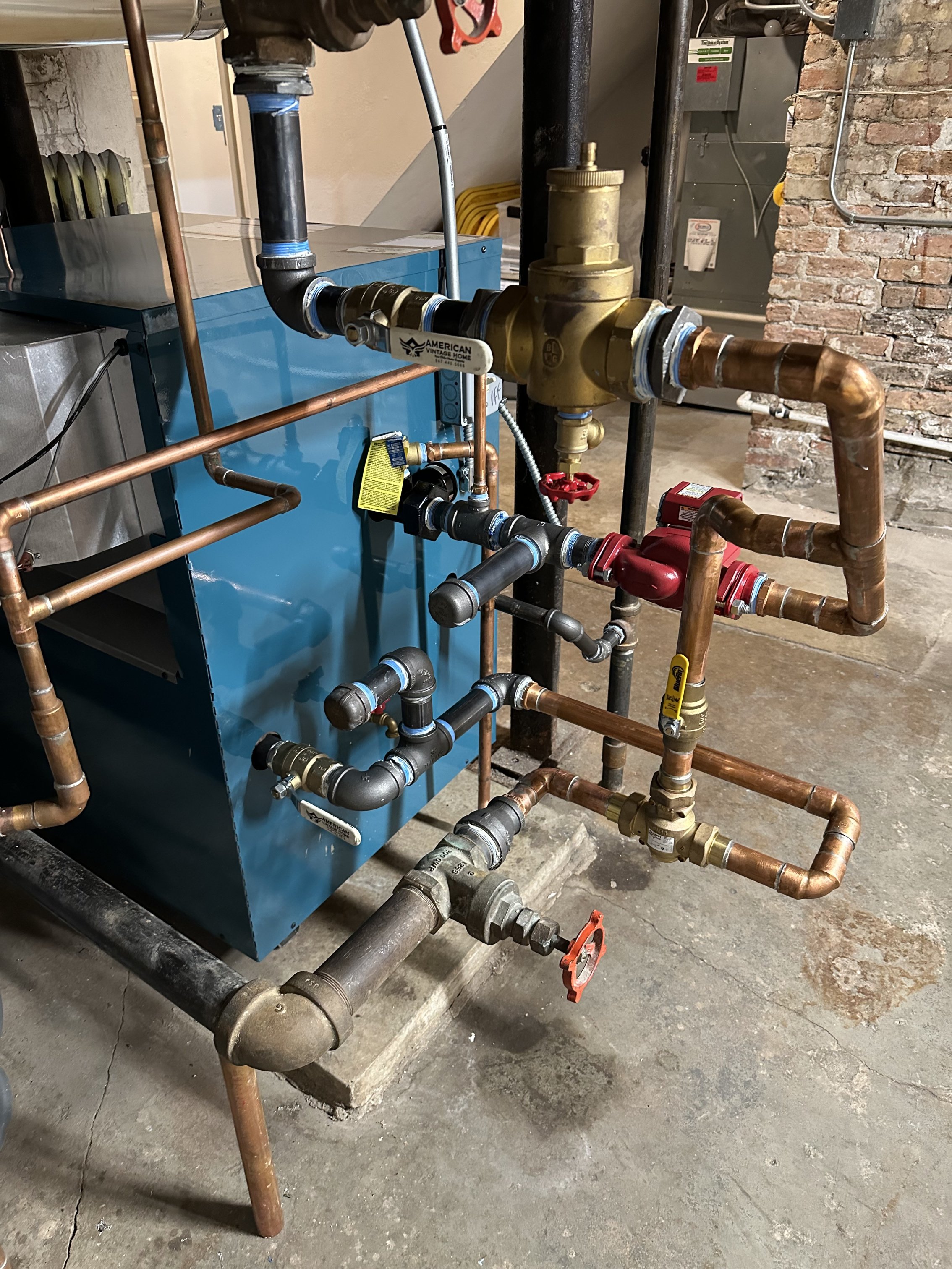

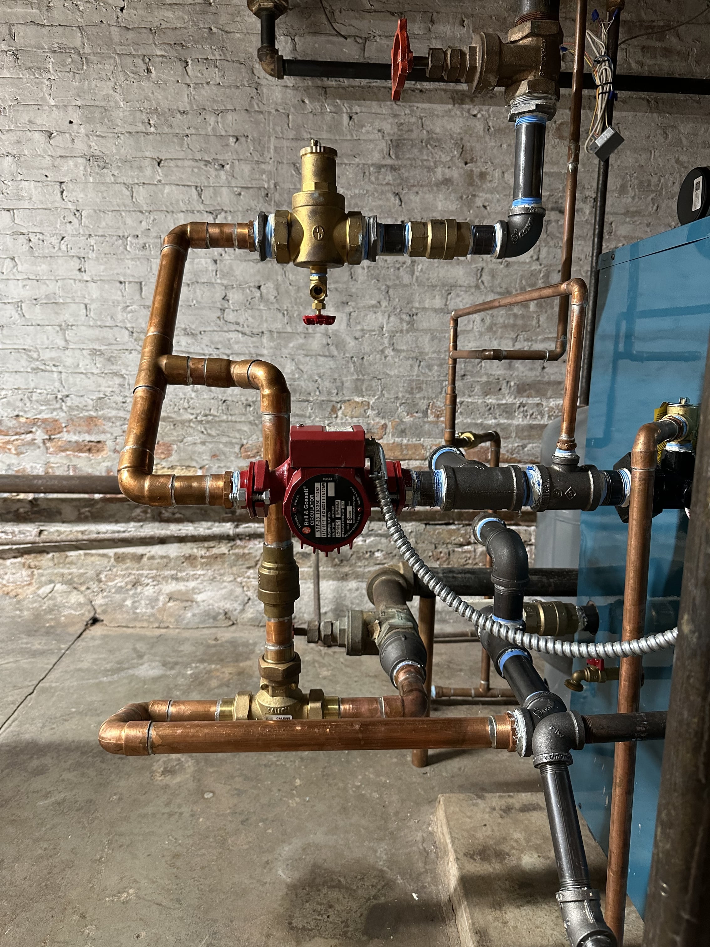

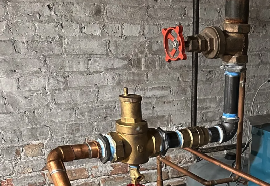

  • Here's before and after photos.
    The before photo also shows the Series 100 that was replaced in 2013.
    The after photo has the Caleffi valve installed. I still have to hook up the water supply.
    Eric Peterson

    Good that you have access to the cap at the bottom of the valve, that is where you change to a different temperature sensor.
    Remove slowly so you keep track of the parts and the order they go back in.
  • @hot_rod - yeah I piped it so I had easy access to the valve for any maintenance or issues.
    It seems very solid and well made.

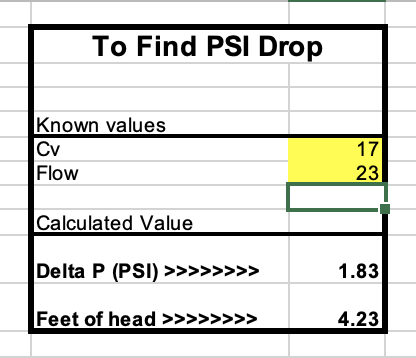

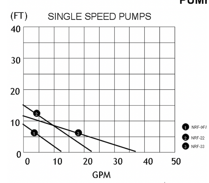

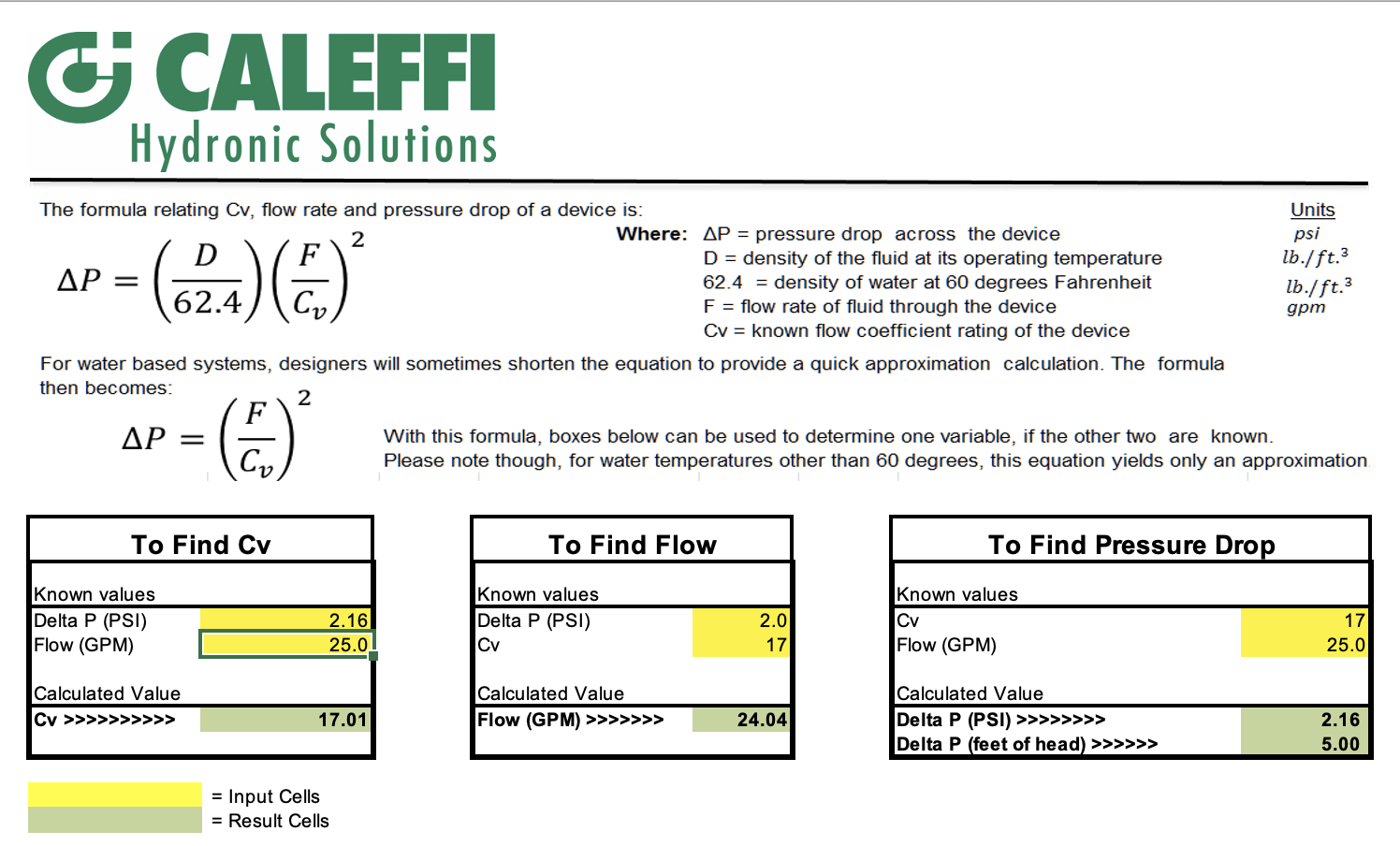

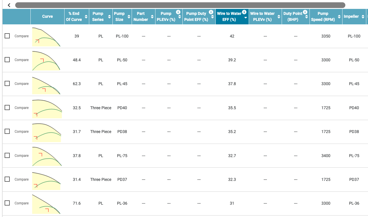

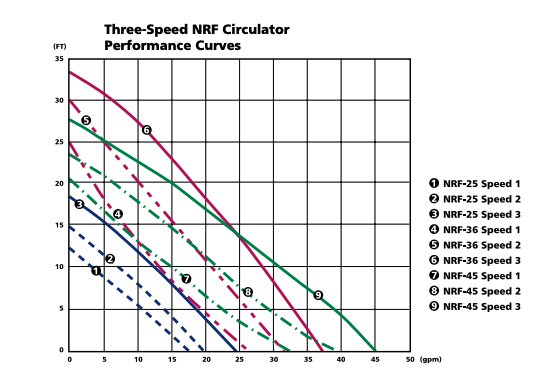

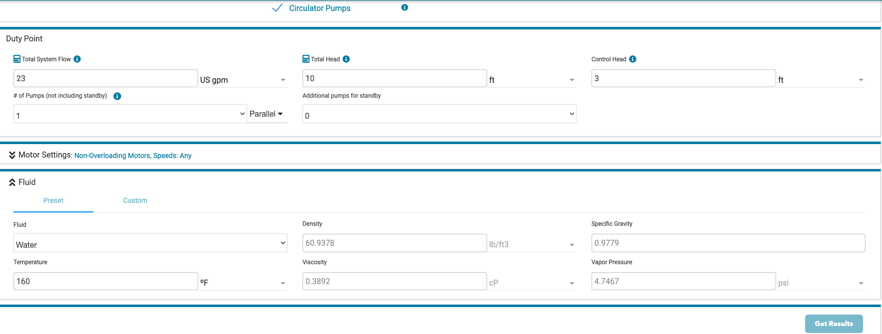

  • @hot_rod - you're right in that the Series 100 pump curve is a better match for my system, which I've calculated in the past as:
    • EDR: 908
    • GPM: 24-25
    • Head: 3-3.5
    I have a Series 100 on the shelf, but I think I will see how the NRF-22 works with the Caleffi valve. I can live with a little startup noise. I don't know that I wouldn't get the same noise with the Series 100, which is bulkier and overall not as quiet as the NRF-22.
    My best best would probably be to go with the NRF-25!
    Eric Peterson
    hot_rod Posts: 28,708
    edited October 2023

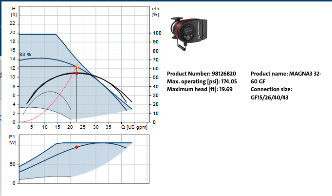

    A system like yours want gpm, but low head. The NRF 25 come closest to that. Plus you have some adjustability with the speed selector.
    If you have the desire and $$ the Grundfos Alpha 15-58 has some very customizable features and would use 1/2 the electrical energy.

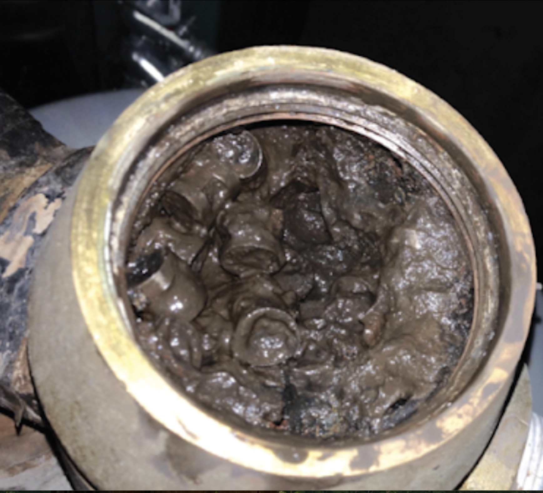

    This will be my lifelong soapbox. The water quality has the most to do with hydronic valves, failing, sticking, mis-behaving.
    Rare to see that copper element fail, but certainly any manufactured product has the potential to break or fail.

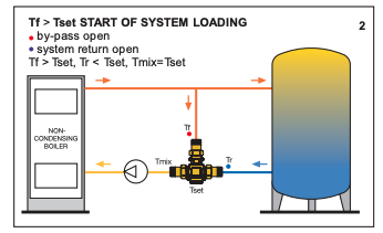

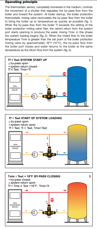

    @OldawgBryant - Below is a diagram. First an explanation:
    • V1 and V2 are closed when the Caleffi valve is operational.
    • V3, V4, and V5 are isolation valves and also serve as labels for my explanation. They are of course open for the Caleffi valve to function.
    • All these valves are full-port ball valves.
    Normal operation
    1. When the system starts cold the Caleffi valve directs supply water through V5 back to the boiler through V4 until it reaches the setpoint temperature. During this time no water is flowing to or from the system.
    2. When the setpoint temperature is reached, the Caleffi valve starts to mix in return water through V3. As return water comes in, supply water also starts flowing out to the system.
    3. Once the temperature reaches 18 degrees above the setpoint, the Caleffi valve no longer accepts supply water though V5. When this occurs water is flowing through the system from the supply and then back through the valve via V3 and V4.
    Maintenance Operation
    When the Caleffi valve needs maintenance, the following is done:
    1. Open valve V1. This allows a direct path for water from the system back to the boiler return.
    2. Close valves V3, V4, V5. This isolates the Caleffi valve from the system.
    3. Valve V2 can be opened as well to provide a system bypass and allow some to the heated water to mix with the return water from the system.
    It is important to note that V1 must be open if the Caleffi isolation valves are closed. Otherwise water will not flow through the system.
    It was a bit challenging to fit all this (and the air separator) in to the space I have next to the boiler.
    I can try and take a better photo now that you get the general idea.
    It would have been easier to sweat-solder copper pipe but I went with threaded pipe.
    Eric Peterson

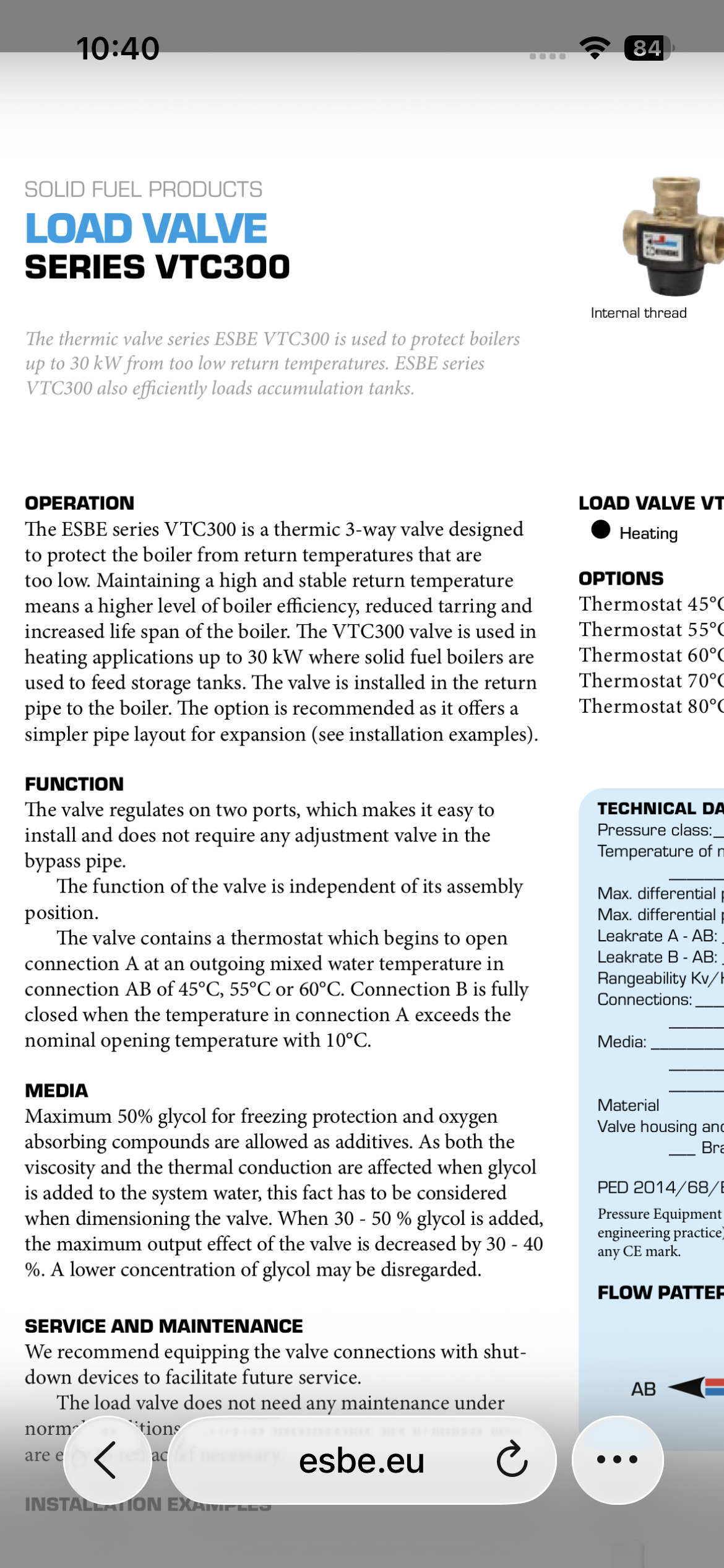

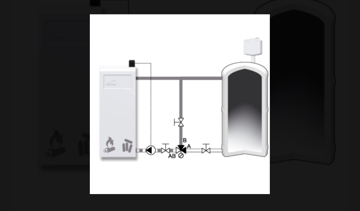

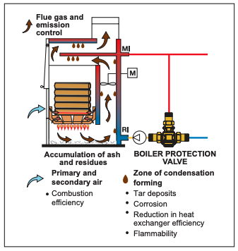

    Good explanation on how the valve works, here is a visual and some additional sizing info.

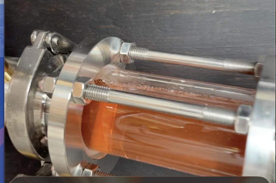

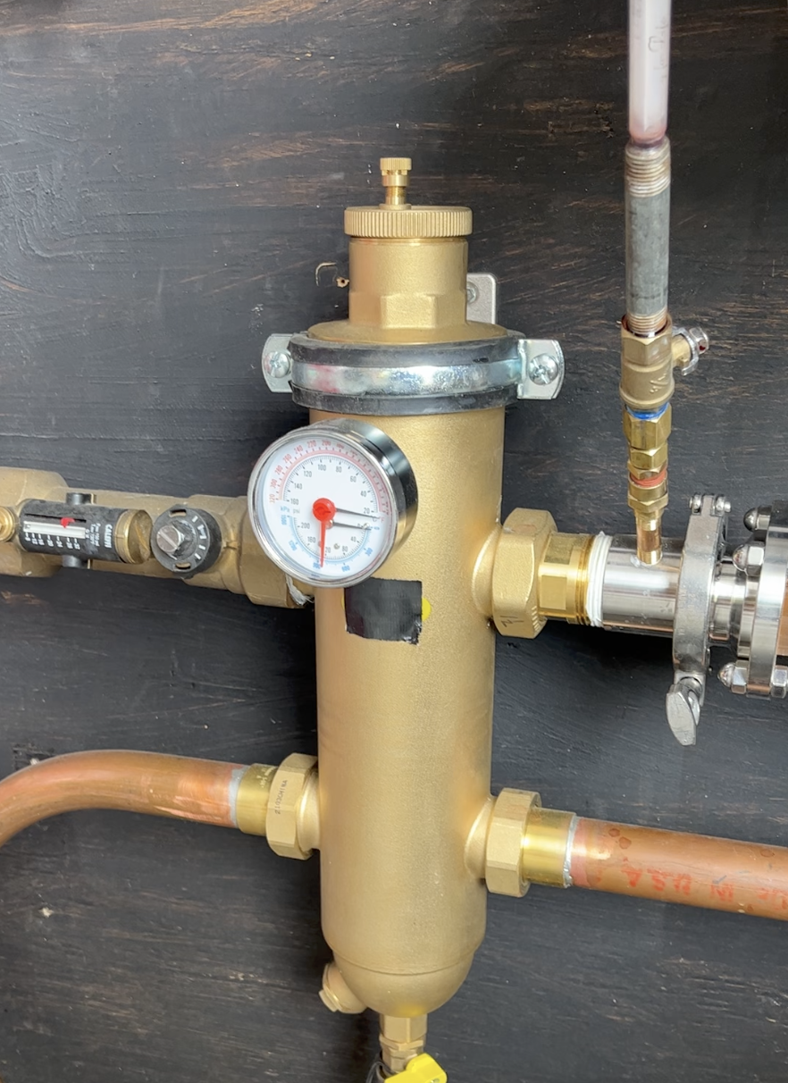

    Water quality, two things about water the physical and chemical make up.
    The physical part we deal with by using strainers, filters, dirt separators. getting particles down to a 5 micron size with a good dirt separator.
    The chemical part gets more involved. First testing the fill water to see what undesirables you should remove. A water hardness test kit only tells part of the story. Better to use a TDS, total dissolved solids test meter. It reads everything in the water, positive and negative ions.
    Ph is another good number to know especially with glycol fluids.
    Actually an ohm meter can tell some of the story, the conductivity of the water.
    The chemical side of water can get very complex. The wrong or mis-used chemical treatments can make problems worse.
    This journal does a good job of explaining the basics for hydronic water.
    Problem water really needs a pro to analyze. the conditioner manufacturers have labs to do a deeper look.
    https://old.caleffi.com/sites/default/files/coll_attach_file/idronics_18_na.pdf

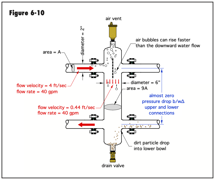

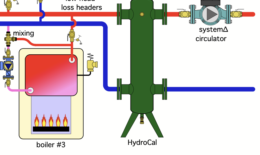

  • @EricPeterson Many thanks, it makes more sense now, as I couldn't see from the photo exactly what was going-on. On your normal operation, I think you meant that return was going through valve 3 & 4 (not 2 & 4) correct? What is the red thing in the photo? does that go to the expansion, or the fill/air vent?
  • @OldawgBryant - good catch on the diagram. I corrected my earlier post.
    Now I know that you understand it ;-)

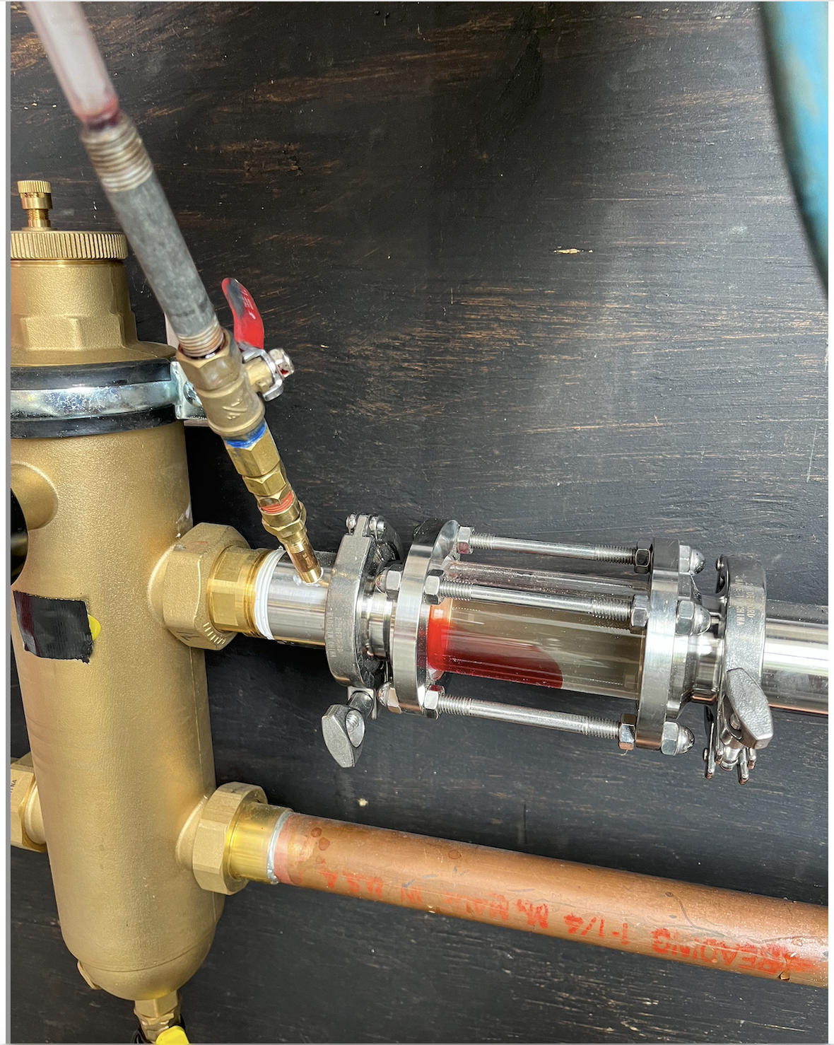

    The red thing in the photo is the B&G IAS (Inline Air Separator). It's piped to a compression tank above, and the fill valve connects underneath (not yet connected).
    Below is the photo I sent to @OldawgBryant in an IM,
    Eric
    There is very little pressure drop through the valve the 1" is a 10 Cv, the 1-1/4 is a 14 Cv.
    The valve works around a 18° differential. The graphic below helps explain the operatio. at various temperatures.
    So with the 140 sensor, the lower right port in these drawings starts to open and allow a % of the system return to blend with the supply from the boiler. The valve is similiar to slipping the clutch in you standard transmission vehicle. It is not an on/ off type valve, it modulated as the temperatures change
    With the 140 sensor the return needs to reach 158° before the upper, bypass port closes 100%. So you will not get 100% flow to the system until the return is at 158°.
    Actually on my own system I changed to a 115° sensor, part # (F29633) so 115 + 18 = 133° boiler return. That should be adequate to protect gas or oil fired boilers. Thie will get you to full system flow quicker and at lower return tem[erature requirement.

    What size boiler, how many radiators?
    What temperature is the boiler set to? Does the boiler ever cycle off?
    Got a pic of how it is installed?
  • The boiler is a Burnham X-209 (280,000 btu/hr in, 84% efficient, running nat gas), and the circulator is an NRF-33. There are about 30 cast iron radiators (about 2,100 sq ft of EDR), and I'm my system was originally gravity fed, as the supply and return pipes closest to the boiler are enormous (4 inches? 5 inches? I can't be sure). The boiler's current max temp is 180F, and yes, I do see cycling now that the protection valve is installed. I've attached some pictures.
    working some numbers, you have about 235,000 actual btu to move thru the system. At a 20 delta that would be 23.5 gpm required
    23 gpm thru that 14 cv valve is about 6’ head, with piping fittings valves, call it 8’
    The pump you have at 8’ head is giving you 8-10 gpm. So 500x 8 gpm x 50 delta = 200,000 btu delivered. with a 50 delta you are moving a lot of btus, so expect a cold return until all that mass warms up
    When were the TRVs added? With the 280, piping, valves ,etc you are up near the top of that circ.
    The 33 is a high gpm low head circ. With little pressure drop in a gravity system it is a good match. As you add components (pressure drop) your gpm will go down
    Any idea what the heat load of the home is?

  • @hot_rod - I think you picked up the bit about TRVs from a comment by me regarding my system, not from @tcovert83. Perhaps he has them but I don't think he mentioned that in this discussion.
    Since I have a Grundfoss I can tell you the circulator is currently pushing 5 ft of head @ 10.5 GPM (zones 1 and 3 calling for heat). ☺️
