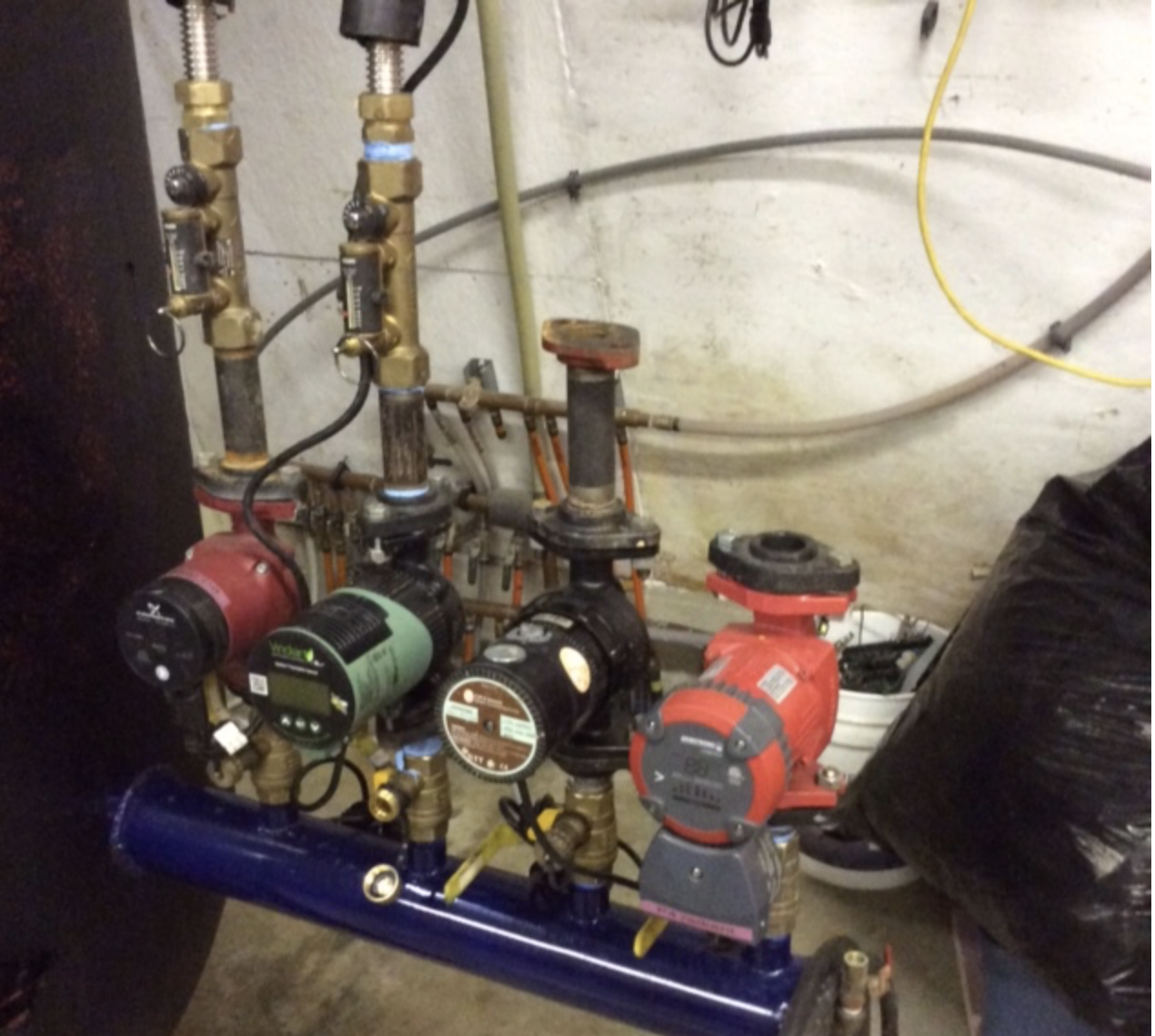

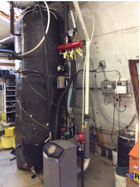

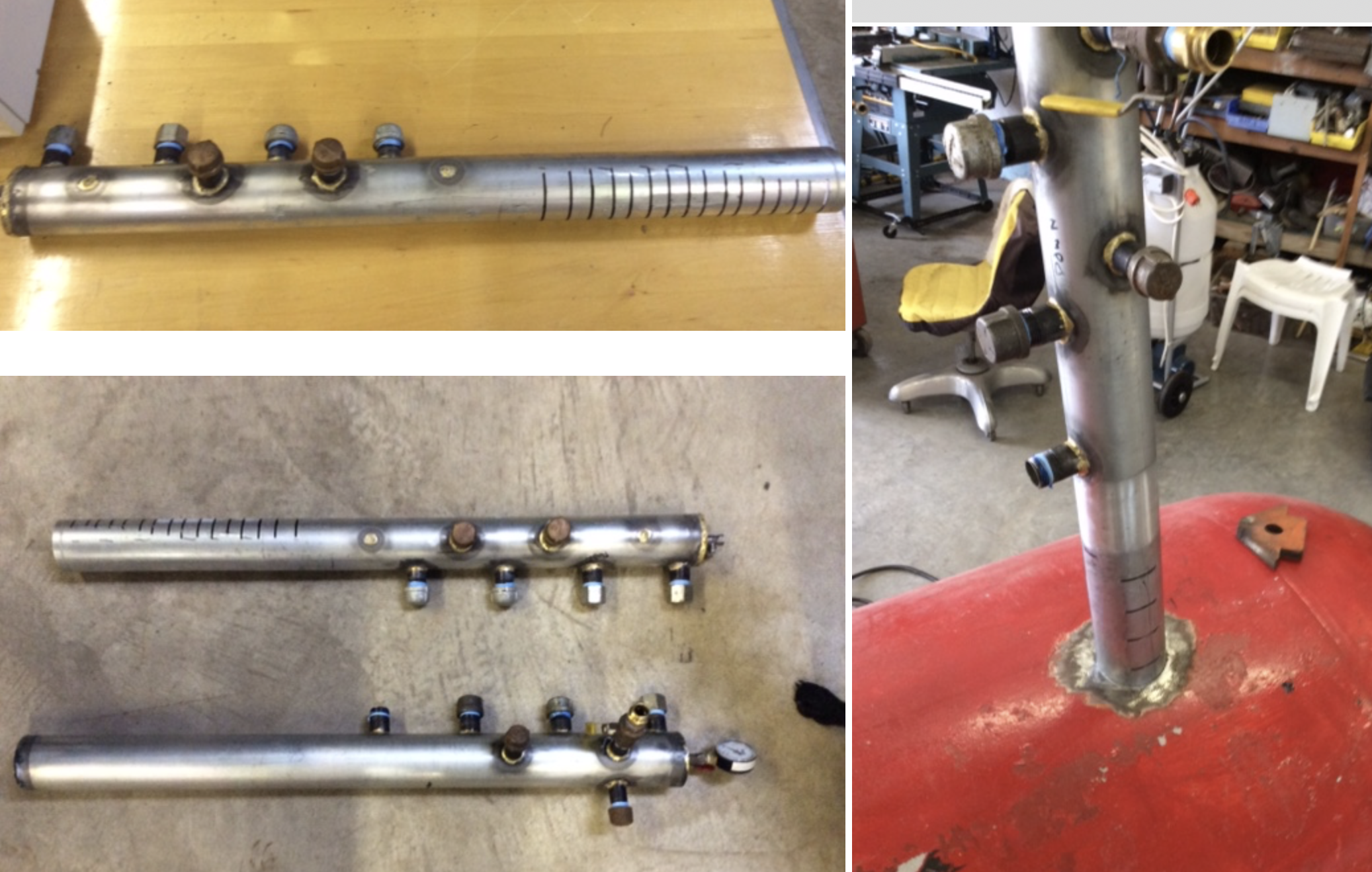

    hot_rod Member Posts: 28,078
    thus Swiss company specializes in large solar tanks for year around heat and dhw
    Multi thousand gallon tanks that the buildings get built around
    https://jenni.ch/publications-448.html?file=files/jenni/inhalte/pdf/Publikationen/Artikel_CompactThyssen_english.pdf&cid=2910
    Ive used old lp tanks. 500 gallon tanks are common. I use to pick them up for a buck a gallon
    Ill bet they are common in rural Wisconsin
    This tank was installed vertically in my last shop
    Input from 160 sq ft solar, wood gasification boiler
    The top was an expansion space and the air bubble for the solar drainback

    This was the motivation for that 500 gallon repurposed tank in my shop. The air sep on the hydronic side needs to be piped into that air space so you don't lose the air bubble.
    A pressurized tank like this makes it easy to use "one" water, no heat exchangers needed for the hydronic and solar fluid.
