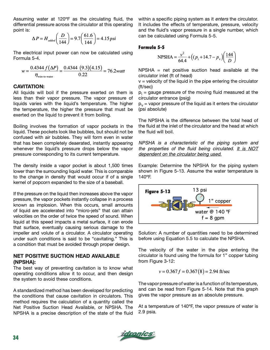

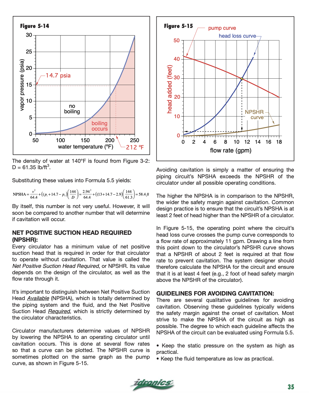

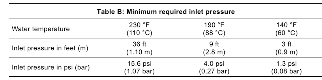

    hot_rod Member Posts: 26,580
    Here are the numbers that Grundfos show for the pressure required to prevent cavitations If the boiler doesn't present that then just the water level above the pump is providing pressure on the circ. So the lower the pump the better.
    Not a great application for a circulator.

    Hi Jamie, I believe according to your formula my circulator inlet is too far away from the boiler, and where it elbows into the inlet it would need to be 8" of straight pipe and it is less than that.
    I referred to the manual's instructions for hooking up the indirect. I will attach the screen grab. They have the circulator pumping from the top of the boiler, so in that sense the installers followed the instructions. However, they did not use the tapping on the bottom back side of the boiler, they used the front tapping on the bottom which I have circled in red. The other place they deviated from instructions was to not run the the supply piping downward first before going to the water heater, it basically goes straight across to it. Strangely, the manual says the upper rear tapping it is 1". It's actually 3/4".
    I did some more tests running the water heater cold to trigger the circulator. I listened more closely this time. The majority of the cavitation sounds like its happening inside the water heater more so than the piping and the circulator. After it runs for about 5 minutes it stops making noise. Could the problem actually be the relatively cooler water inside the tank causing the boiler water in the coil to cavitate, but then once it gets uniformly warmed up, it stops? I don't have a thermostatic mixing valve for output water temperature. Do you think if I had one of those and ran a higher indirect tank temperature it would reduce cavitation as well?
    PXL_20250131_142644593.jpg PXL_20250131_142610467.jpg PXL_20250131_142625251.jpg BoilerA.jpg
    This type cavitation is about dropping below the vapor pressure of the fluid. So temperature and pressure are involved. More on this below.
