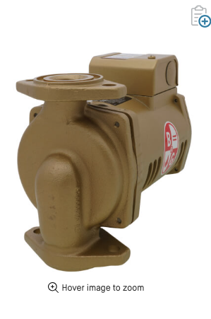

    While not a cheap date, this type of circulator, a B&G PL series, would keep the motor out of any dirty water. This is an air cooled motor as opposed to a wet rotor design., 225°f rated
    The B&G series 100 is another option.
