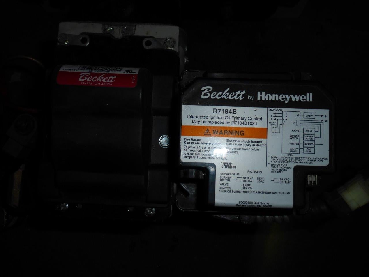

  • Some photos. The flue pipe photo is old; t
    he pipe was replaced 1 year ago. I will post the new pipe tomorrow.

  • Some more photos
