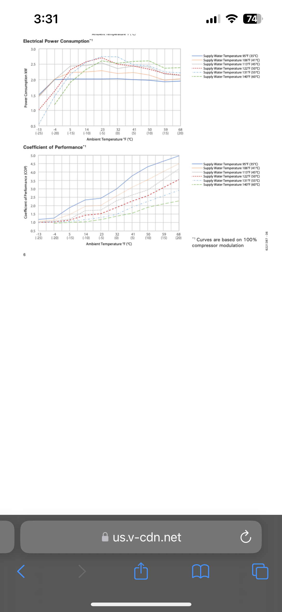

    I'd like to offer an analysis, the data is in a spreadsheet at
    https://docs.google.com/spreadsheets/d/1KmnOjq_MEQ2fNqj5AZvLSXHkNx3dwDPvn_SNBV2iHMA/edit?usp=sharing
    @John Ruhnke had sent me a performance sheet for the 5-ton Arctic (050ZA(BE)) I used that for performance curve of COP and output vs. outdoor temperature. I used weather statistics from Boston Logan Airport for the hours per year at each temperature. I assumed an electricity cost of $.27 per kWh and an oil cost of $3.50/gallon, maybe someone closer to Boston can check those for me. I assumed 80% efficiency for the oil burner.
    I modeled a building with a heating load of 35,000 BTU/hr at a design temp of 13F, based upon the discussion above.
    I calculate that this building needs 80,115,978 BTU of heat for the winter.
    To get that 80 million BTU using fuel oil would take 731 gallons and cost $2558 per year.
    To get that 80 million BTU using only the heat pump, and supplementing with resistance electric when the capacity of the heat pump is insufficient would take 8471 kWh and cost $2287 per year — savings of $271 or 11% over oil.
    I then modeled three other scenarios:
    Scenario 1 is the oil burner is only used to supplement the heat pump at times when the heat pump output is insufficient, basically the oil burner is used instead of resistance electric. This saves $24.33 per year compared to the all-electric scenario.
    Scenario 2 is the oil burner is used for all heat when the temperature is so low that the heat pump costs more to run than a boiler. In this scenario, the break-even temperature is 10F. This saves $34.18 per year compared to the all-electric scenario.
    Scenario 3 is the oil burner is used for all heat below a certain temperature where the heat pump is assumed to be unable to produce hot enough water to meet the heating need. I used 25F because that was what John had assumed in his hypothetical. This saves $21.92 per year compared to all-electric and $293 per year compared to all-oil.
    Some conclusions: in this climate, for this building, a heat pump will save money compared to an oil burner. But it's modest, 11% of annual fuel cost. It's probably only worth considering when the boiler is due for replacement anyway. Other improvements, like weather-sealing and regular maintenance of the boiler, may be more cost-effective ways of seeing savings.
    The payback period of any scheme to combine a boiler and heat pump is going to be decades if not centuries. If the existing radiation is insufficient to meet the heating load with the temperature water that a heat pump is capable of producing, it's hard to justify a heat pump for part of the heating load, you're better off sticking with the boiler. Alternately, it may be worthwhile either to increase the radiation or improve the weather-sealing in the building to the point that a heat pump becomes effective.
    I welcome criticisms of my methodology. Some notes on that. First, I came up with 731 gallons of fuel oil used per season for my hypothetical building, which is significantly different from the 1200 gallons that was reported. So something isn't being accounted for. Is the boiler also used for hot water?
    I am probably over-estimating the amount of electricity used by the heat pump. I set up my spreadsheet for air-to-air heat pumps, which provide part-load capacity and efficiency numbers. Arctic only provides full-load numbers, and heat pumps tend to have higher COP at lower loads so actual COP is probably higher than what I'm seeing. Also, I'm assuming a constant water temperature of 122F, in reality outdoor reset would be used which would give better performance at warmer outdoor temperatures.
    But I don't feel that any of those issues affect the conclusions.

    hot_rod Posts: 28,196
    nice data, thanks
    What type of heat emitters would be use with 122 SWT.
    How would you get to the 4 plus COP that Heat Geek claims?

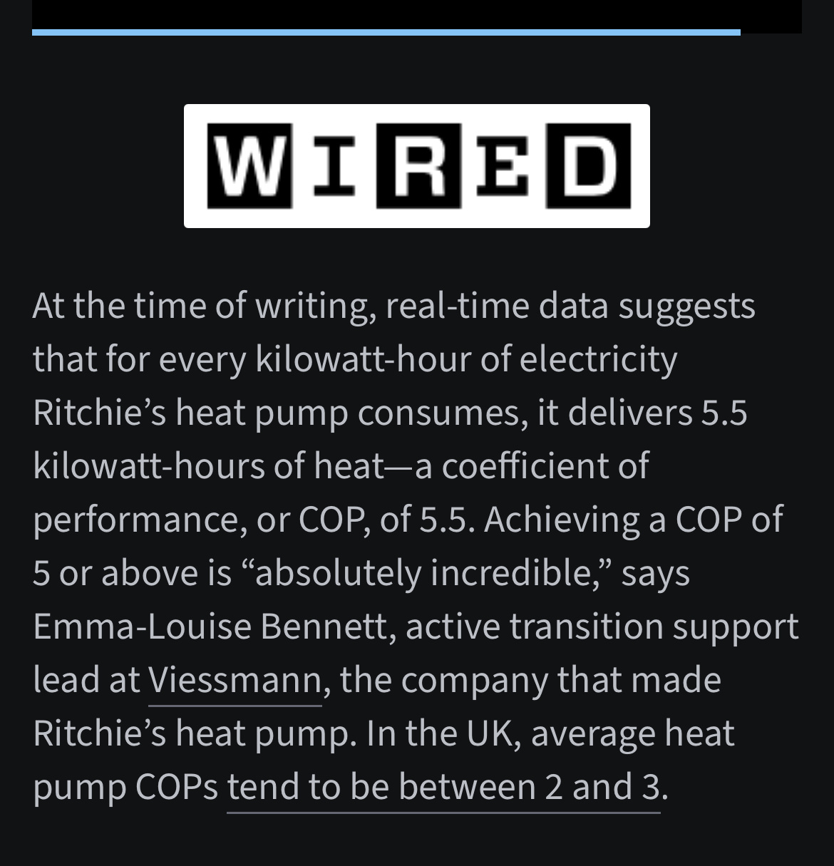

  • DCContrarian
    DCContrarian Posts: 1,560
    "What type of heat emitters would be use with 122 SWT."
    That comes from @jesmed1 in the first response in this thread: "Because we have so much cast iron radiation, I believe we could heat the building on a design day with 110-120 degree supply water." I'm just assuming that he's correct.
    "How would you get to the 4 plus COP that Heat Geek claims?"
    From what I've read, there really isn't much more to it than having lots of radiation and really low water temperatures.
    Note that they're claiming SCOP, seasonal COP, which is normalized to exclude the effect of climate and not directly comparable to the calculated COP I'm showing.
    Apparently guys who are really good at it get SCOP's in the 5.5 range. This article has some details:
    https://arstechnica.com/science/2024/07/the-hunt-for-the-most-efficient-heat-pump-in-the-world/?fbclid=IwY2xjawH2VwlleHRuA2FlbQIxMQABHfKALOmCjmEXQAGBtiNnsnbf-oHDPA7H6uxXmaPQyAuTPi4CPuwMTkgKpw_aem_Oq4kXweijwakCFct0PrJFA

    Id like to find out which Viessmann product they are talking about in that link 5 COP??
    To get 5 COP on the VitoCal it would be 95 SWT with 68 ambient?
    I don’t even start my system until it is 65.
