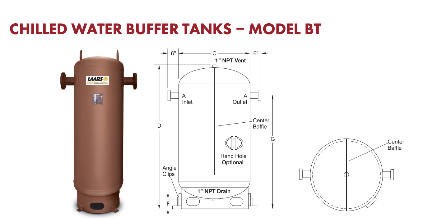

Chiltrix recommends 17 gallons for their two-ton nominal units. The unit is capable of modulating to 25% of output, or 6,000 BTU/hr. When cycling, they have a default of 7.2F swing. 17 gallons is 141 pounds, swinging 7.2F means a flow of about 1,000 BTU, which is one sixth of an hour or ten minutes worth of runtime with zero load.
That seems like a reasonable size, I don't see any reason to go bigger.
A thirty minute run time is better than a ten minute run time. So again why would anybody say that a smaller buffer tank is better? You will get better COP's with a larger buffer tank and the HP will last longer.

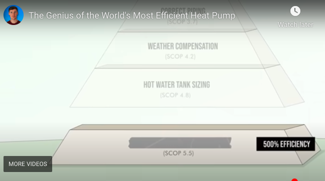

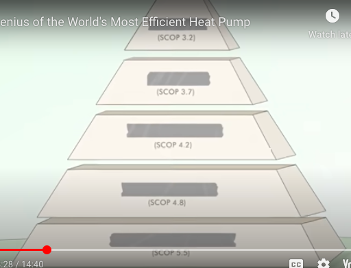

From what I learned in the Heat Geek courses is that they like to size the HP to the system and have the HP run as long as possible. There is a loss in energy or COP right at start up. As the HP has been running for a little while the COP gets better. It takes a little time to get warmed up. This has been observed through monitoring. Less cycles are better thus longer cycles are better because it reduces the amount of cycles. I will have to go through my course videos again. I can't remember exactly how long the HP needs to run for to get to that optimal level. It not very long though. It is better to avoid this start up period. Thus reduce cycles.
I am the walking Deadman
Hydronics Designer
Hydronics is the most comfortable and energy efficient HVAC system.0 -
Closest I have found is this video:
If you look at the graph here:
There is no major changes in power when the unit cycles. I guess there is a bit lost at startup and shutdown doesn't look like enough to matter.
That is a great video. John Cantor is considered by the Brits to be great with hydronics. He is someone to be learning from. I do know that in general turning things on and off a lot reduces the life of things. Adam Chapman talks about this loss of power at start up in his training. So Adam has seen this. The Heat Geeks are definitely designing to avoid unneeded cycling. At 13.28 in this video John Canter talks about the loss of power at start up with a ASHP. In this video the HPs are running at 40F which is pretty warm out, a mild winter day. What happens at 10F? I still need to do my network phase of my training. I need to talk with some of these Heat Geeks in the U.K. I have my first live video meeting February 4th. I would like to see more videos like this. We don't have anything like this here in North America. From this video it seems that some HPs aren't effected much by cycling.
He talks about a thermostat adding unneeded cycles. I have seen this a lot with boilers in my hydronic projects from the past. It is a good reason to avoid using hot air thermostats in hydronics. In that case the cycles from the thermostat was ruining performance and is something a buffer tank would avoid.
I am new to studying graphs like that. I have a lot more to learn. The courses in the U.K. from the Heat Geeks were intense and I learned a lot. But I also need to ask a lot of questions and I need to get into a network with Heat Geeks. I have not gotten that far yet.

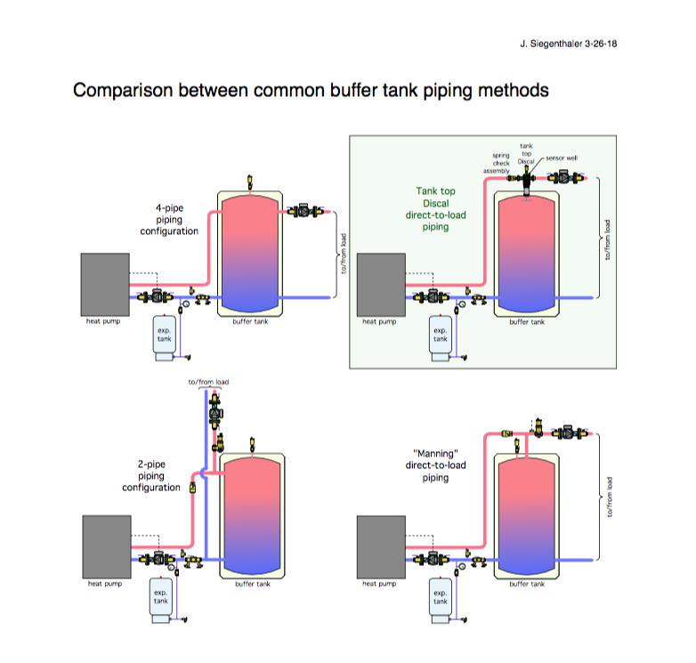

@Kaos : I want to make sure we're all on the same page.
My preferred plumbing is a three-pipe system like this:
The buffer tank is there in case the load presented by the emitters is smaller than the minimum modulation of the heat pump, so the heat pump can cycle on and off. In particular, if all the zone valves are closed the buffer tank provides a bypass to keep the heat pump from dead-heading while it finishes the cycle.
With TRV's, it seems you would need to have a similar bypass, or you would have to keep them from shutting off and have a minimum flow level through all the emitters all the time. With passive emitters that would mean a minimum output level. I think you'd see a situation similar to what is often seen with multi-splits, where there is a similar minimum output requirement, which leads to complaints when unwanted heat is being put out.
A layout like I've drawn above works fine with a heat pump. You want to have at least three zones so that you get variation in output and not just on/off behavior. I could see that TRV's would help because they would provide more variation in output.
Like this:
Two port buffer tank if needed in series so there is no mixing. Diff bypass in case all TRVs are closed.

The buffer tank in this application is called a volumizer. It is better on the return piping than the feed piping. Its job is to add volume to the piping and radiation when you don't have enough volume. If you have multiple zones and a small baseboard zone comes on you will have the system volume for this to work. Also the volumizer can be sized big enough to handle the defrost cycle. It will keep the HP at lower temps and allow you to control the cycles to the system as the load. This is the best way to pipe up a buffer tank. To use the buffer tank as a volumizer. Again you need to understand some advanced U.K. hydronics to make sure things are right.
Hydronics Designer

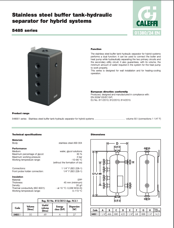

I've heard Dakin is suggesting a minimum of 18L between the monobloc and distribution. They are working with a 5 gallon under counter tank. If you can fine small tanks with large ports it would be nice. Well insulated if used with chilled water.
3 pipe brings the best of two and four pipe options. 3 pipe with the header across the top of the tank for direct to load. I modified one of the Discals to go into the top of a 2" port. If you find a tank with a center top tap.
Living the hydronic dream0 -
According to Heat Geeks. If you use a three pipe tank design with the bypass on the return it allows for lower HP temps and increases the cycle length of the tank. Higher COP and less cycling. The Heat Geeks like to pipe it such as below.
